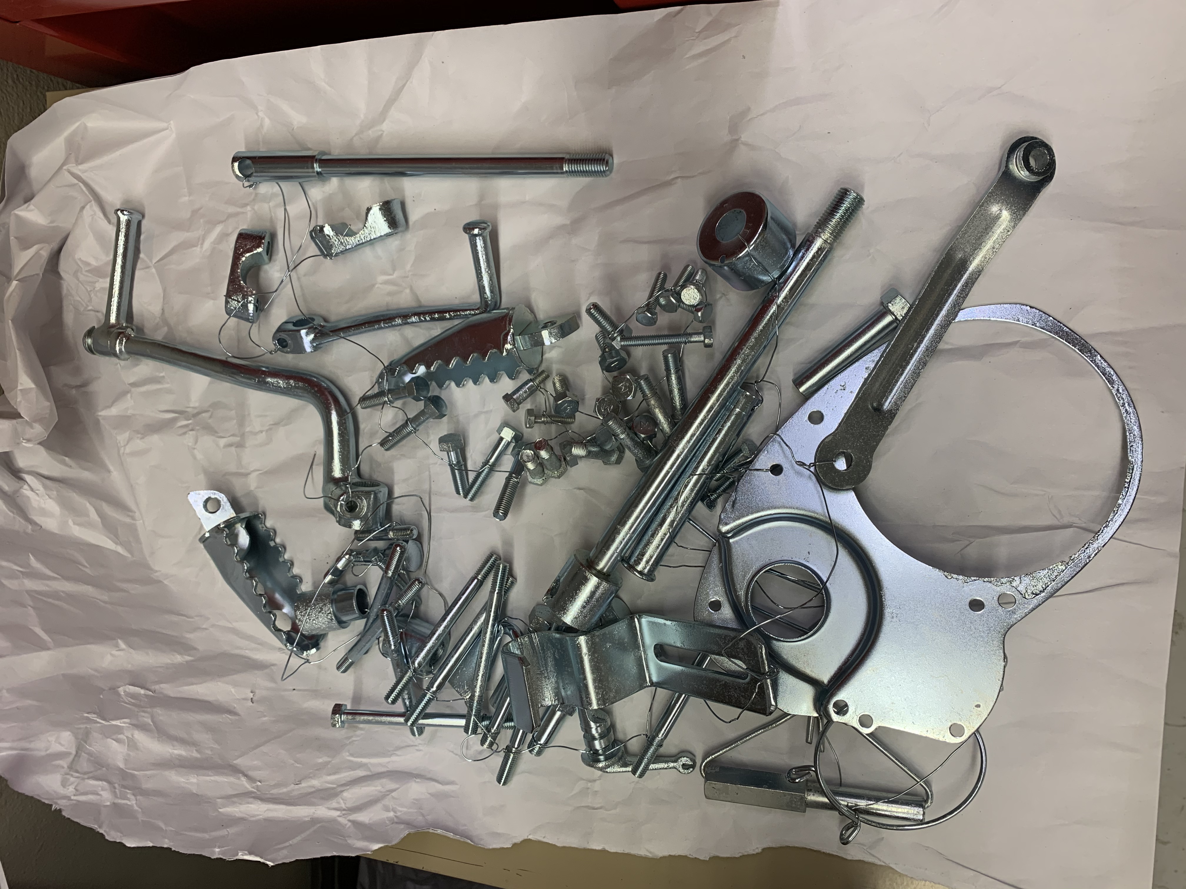

I sent most of the parts that were originally zinc plated to Active Plating in Santa Ana, CA. They did a nice job. It was more expensive that the shop recommended by Roger above, but my parts were sent to an additional shop for tumbling, which added to the cost. Attached pic of some of the parts.
Chris
Chris

What kind of prep did you do to the parts before sending them?AKwombat wrote: ↑Sun Aug 29, 2021 7:49 pm I sent most of the parts that were originally zinc plated to Active Plating in Santa Ana, CA. They did a nice job. It was more expensive that the shop recommended by Roger above, but my parts were sent to an additional shop for tumbling, which added to the cost. Attached pic of some of the parts.
Chris
Re: Zinc Plating Shop
All I did for prep was degrease them in the solvent tank. I could have bead blasted everything, but the shop
told me they were going to send them out for tumbling & cleaning either way. We discussed the issue of added thickness to parts during re-plating, and they assured me it wouldn't be a problem. I've had to chase the threads on some of the bolts in order to get a nut to thread on smoothly. We will see what happens when assembling the bearings. I've had that problem before on hardware that was re-cadmium plated.
