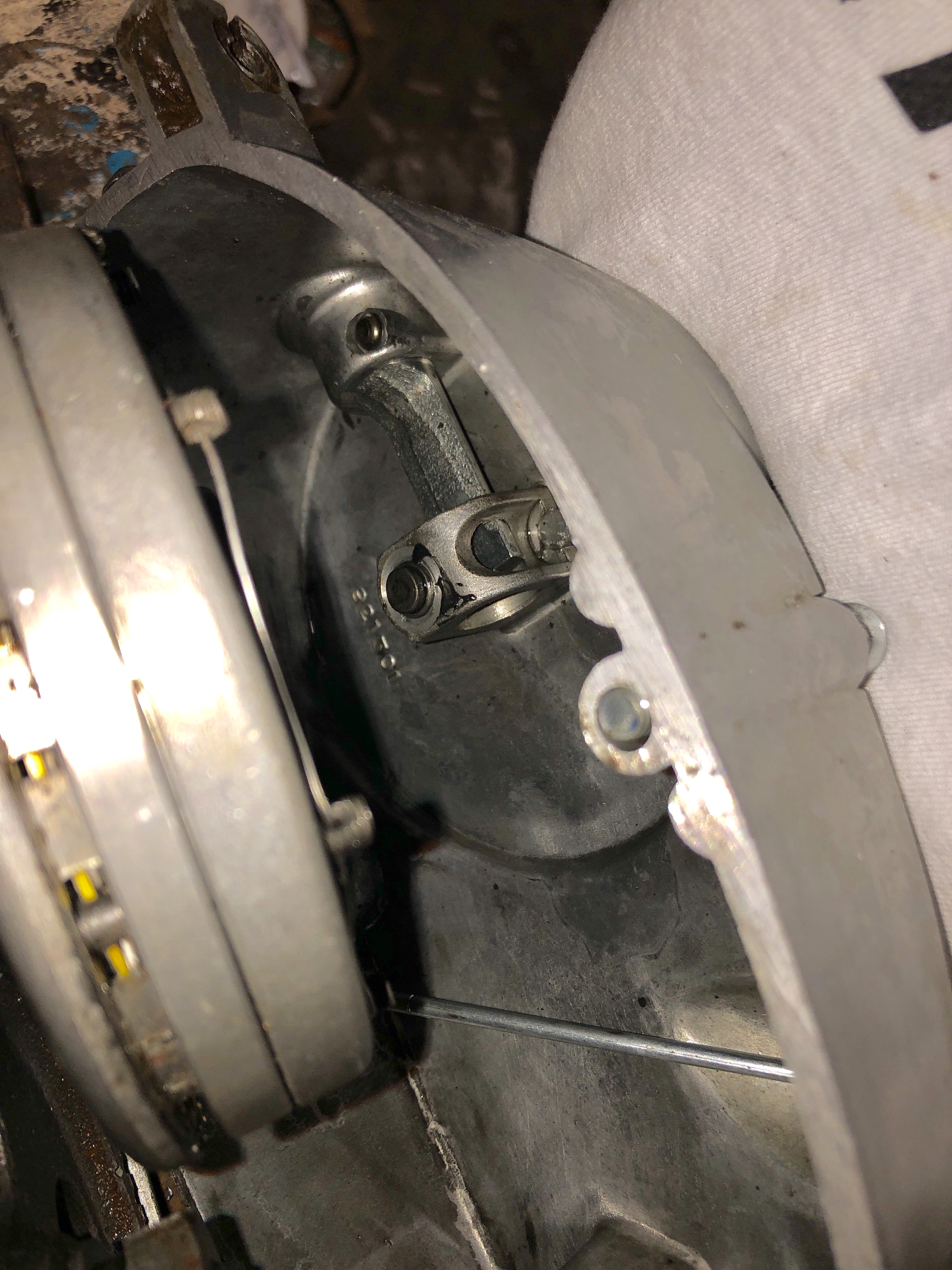

Posts: 4835
Re: B+ clutch pressure piece
You can see my Ace B here. The cover is pulled back just enough..... Zoom in. You can see it’s just a bit proud of its hole! :ugeek: Victor
Nice shot Victor.
