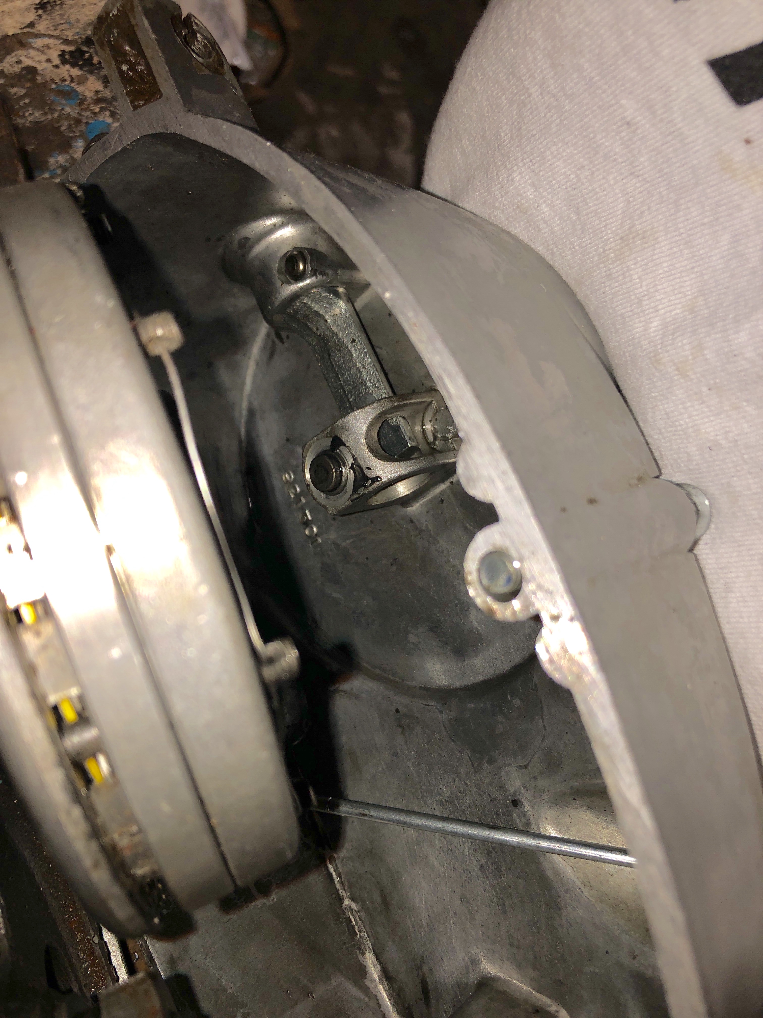

You can see my Ace B here. The cover is pulled back just enough..... Zoom in. You can see it’s just a bit proud of its hole! :ugeek: Victor
Re: B+ clutch pressure piece
Nice shot Victor.

Thanks guys, yes the long one sits just proud, short one flush. I have to check again, but the long one allowed NO shims yo be used. Thanks. I just wanted a confirmation.
