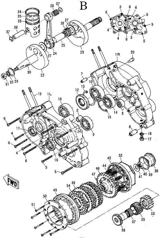

Al Harpster
Posts: 308
Re: Clutch won’t disengage
Post by Al Harpster »
This may be of some help.
As an aside, the Ace Shop Manual mentions flushing the transmission/clutch cavity with kerosene.
Might be worth considering. Could help de gum what's gummed up.
Al. You might want to post the corresponding descriptions to the part numbers as well, so that he knows that part #X is part “Y” and not just a picture with numbers. Some may know but it’s always better to refer to the part names so that people can also know what to call them when asking about a part. If you don’t know already that #39 is a clutch disc spacer, then just seeing a picture may not be as helpful as seeing the part descriptions along with the image & part numbers. Just a thought... :ugeek: Victor
Al Harpster
Posts: 308
I copied this diagram from the Hodaka_parts.com website.
Dozerash: if you find this diagram helpful you might like to check the website noted above and click the Search By Schematics button.
