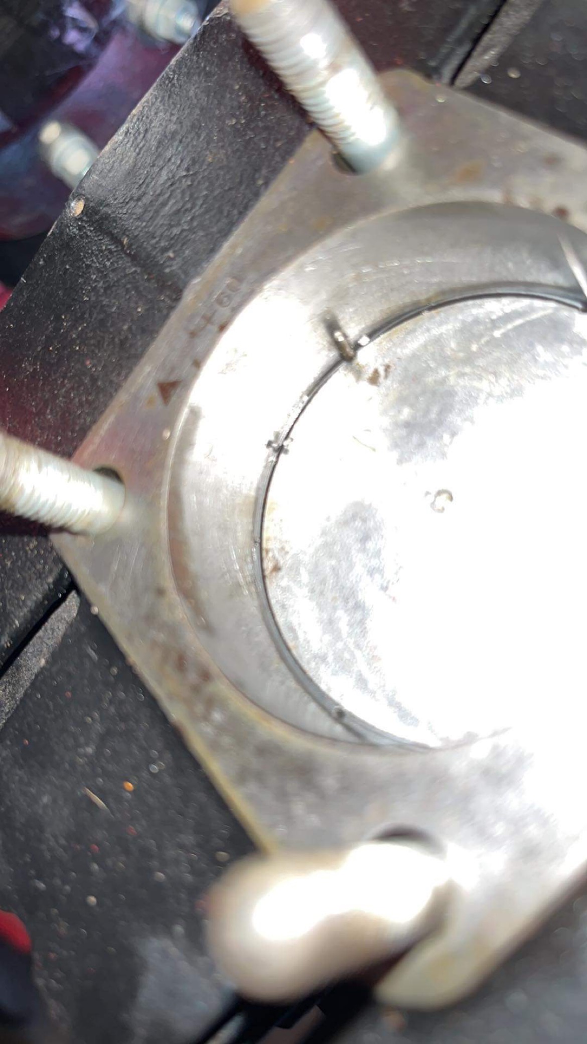

Today I pulled the cylinder, piston & ring from the unit which was giving me only 85 psi on my compression gauge.
Here’s the measurements I got.
It’s a .020 piston
Piston to cylinder gap is .005
Ring gap was .012
(about 1/4” down from top of cylinder)
Ring gap .011
(With ring just above exhaust port)
Cylinder taper .002
As I stated early on, it seems everything is within clearance tolerances. Minimal taper, good piston to cylinder gap, and a little higher than best for ring gap but not unacceptable.
Any thoughts? :ugeek: Victor

Well, I pulled it all apart today. Some of the measurements don’t make sense. It seems to be within tolerances based on the measurements I posted. However, I think the big issue is irregular tapering of the cylinder. This is causing the piston to stick a bit.
So, I packed the cylinder, piston & ring up for shipping & im sending it to Terry tomorrow for a Hodaka Dave inspection and whatever work Dave says it needs. I’m sure it will come back from Dave ready to run, just as stuff always has. Then I can get this bike shipped to Florida!
Never again! I will not do this backwards again. First build a bike & work the bugs out. Then, once it’s running consider a buyer and not before.
I tried to short cut this Rat and it came back to bite me in the A$$!!! Never again! I let this get the better of me & then I got pissed off with it & didn’t want to work on it. I should have pulled it apart 3-4 months ago and sent it to Dave. Lesson learned! :ugeek: Victor

I got the cylinder back from Terry on Monday. I put the piston on while the bottom end was still on the bike. Cylinder on, head on. Head nuts torqued.
Motor kicked over much easier now that Hodaka Dave did his magic. Kicked it several times. After about 5 kicks Brup Brup. Kick again. Brup, brup, brup. Kick again. Brup, brup, berrring-a-Ning-a.Clunk!
After all that, I knocked the top rod bearing off when mounting the piston. Didn’t see it fall into the crank. Smashed the bearing and bearing needles trapped between the piston & cylinder….
This was a fresh .020 bore and new piston.
I hate this bike…

Today is a good day. I got the cylinder & top end kit from Terry a couple of days ago. Everything is back together and….
The Rat started up!!! Yeay! The big issue was the condition of the cylinder first go around. After honing, it began to start until “you know what” happened. Cylinder bored with a new top end kit and the top rod bearing installed properly & she runs!
Looks like I still need some minor adjusting of the throttle cable and the slide is sticking a bit, but it’s nothing I can’t work thru!
With persistence & being able to discuss things here, I was able to work it out. Thanks to all who contributed!!! But especially to Clarence who spent a lot of time on the phone with me! :ugeek: Victor
