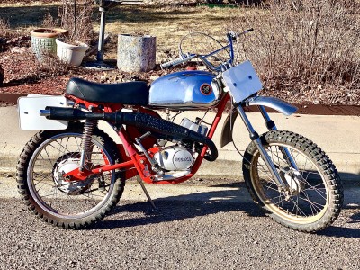

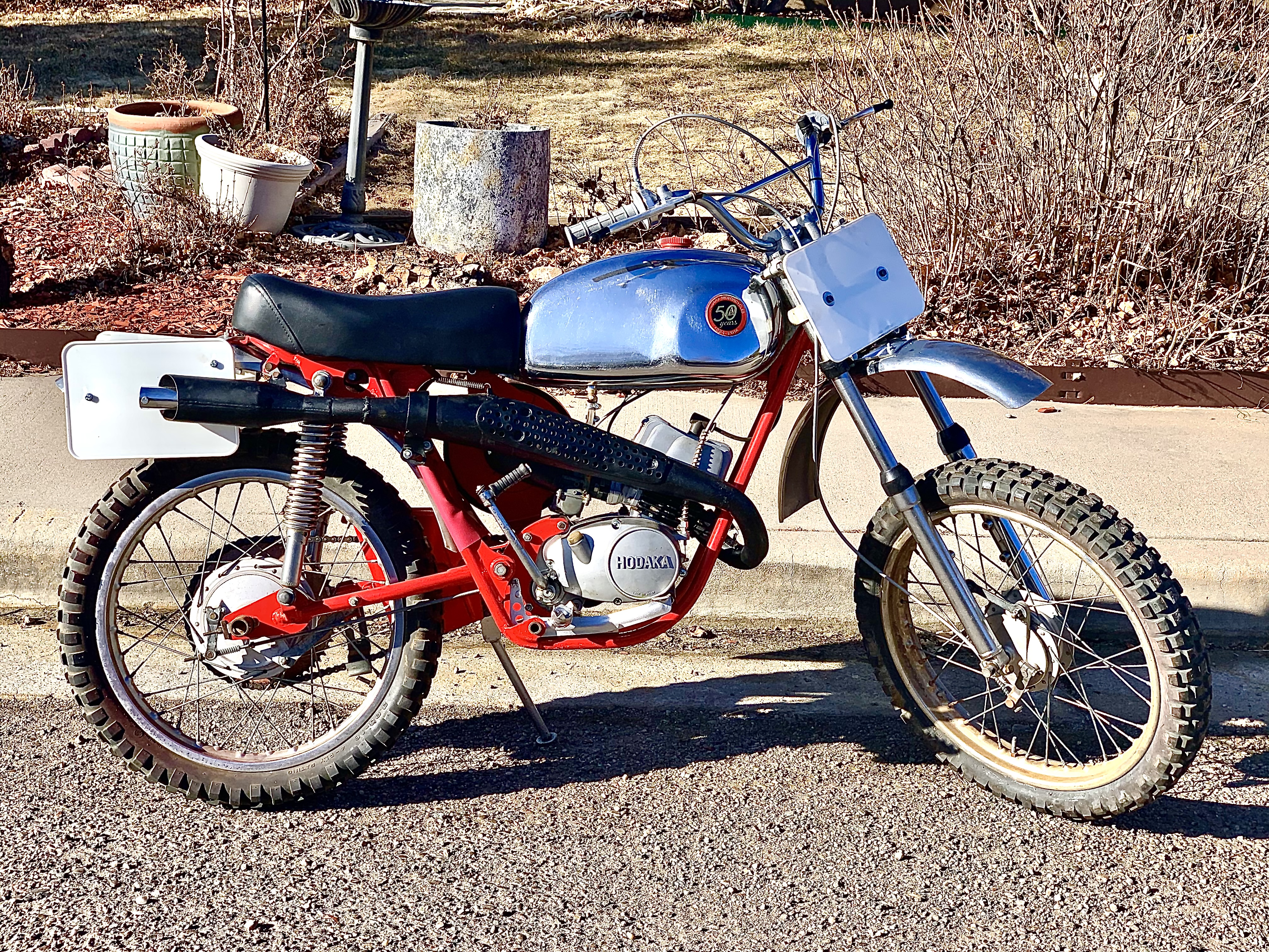

93A Super Rat
93A Super Rat
93B Super Rat
93B Super Rat
