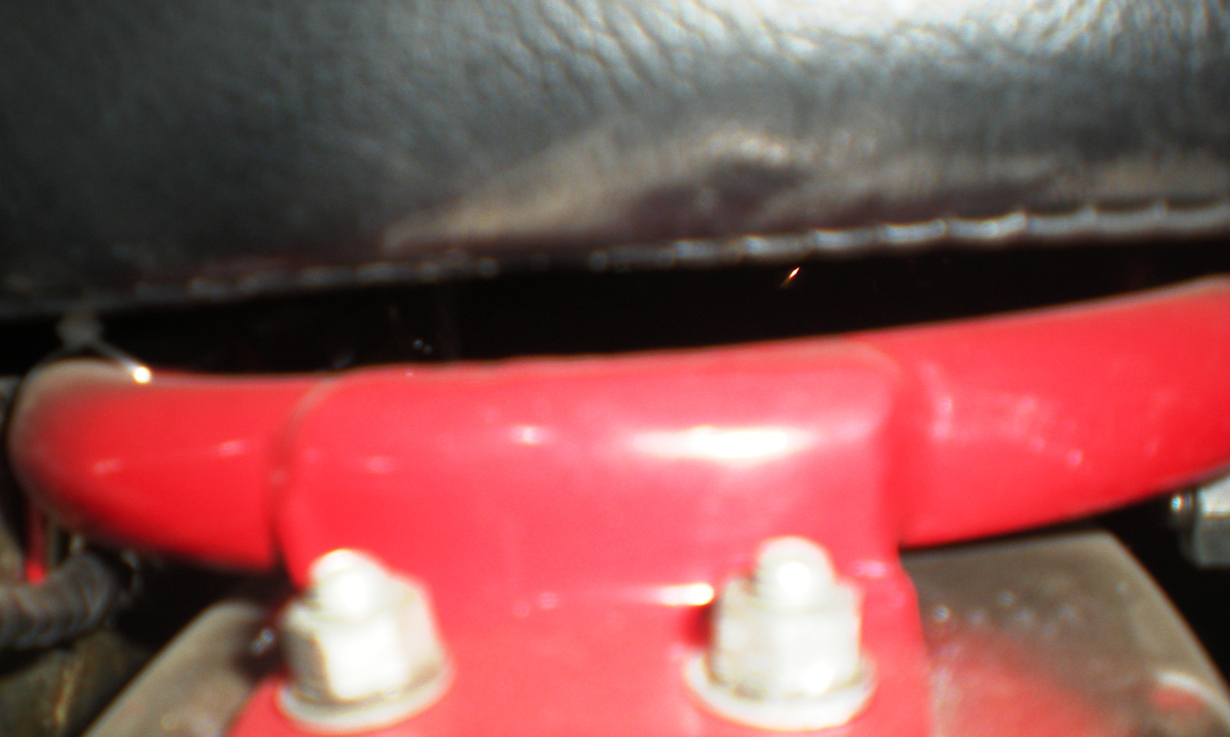

Also, when the seat pan is installed, is the pan suppored only by the brackets or does the seat pan also get supported by the rear of the frame loop. IE does the rear of the seat pan sit low enough to contact the rear of the frame loop?

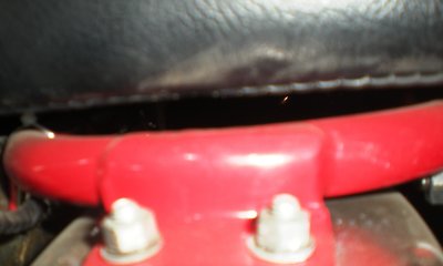

As for your seat loop, I checked my model 92 Ace 100 and the rear of the seat does not make contact with the loop. There looks to be about 8 mm clearance. I tried to get a picture of it. Hope that it helps.
Model 92 Ace 100
Model 92 Ace 100

I made the seat pan out of ABS and have a couple really rusted pans and mounts for examples. When I made up the mounts, I couldnt decided if they needed to be long enough to keep the seat off the loop, or shorter so that the loop also supported the seat.
Makes sense and I will make them a bit long, so they keep the pan just above the rear loop, similar to the picture you posted.
