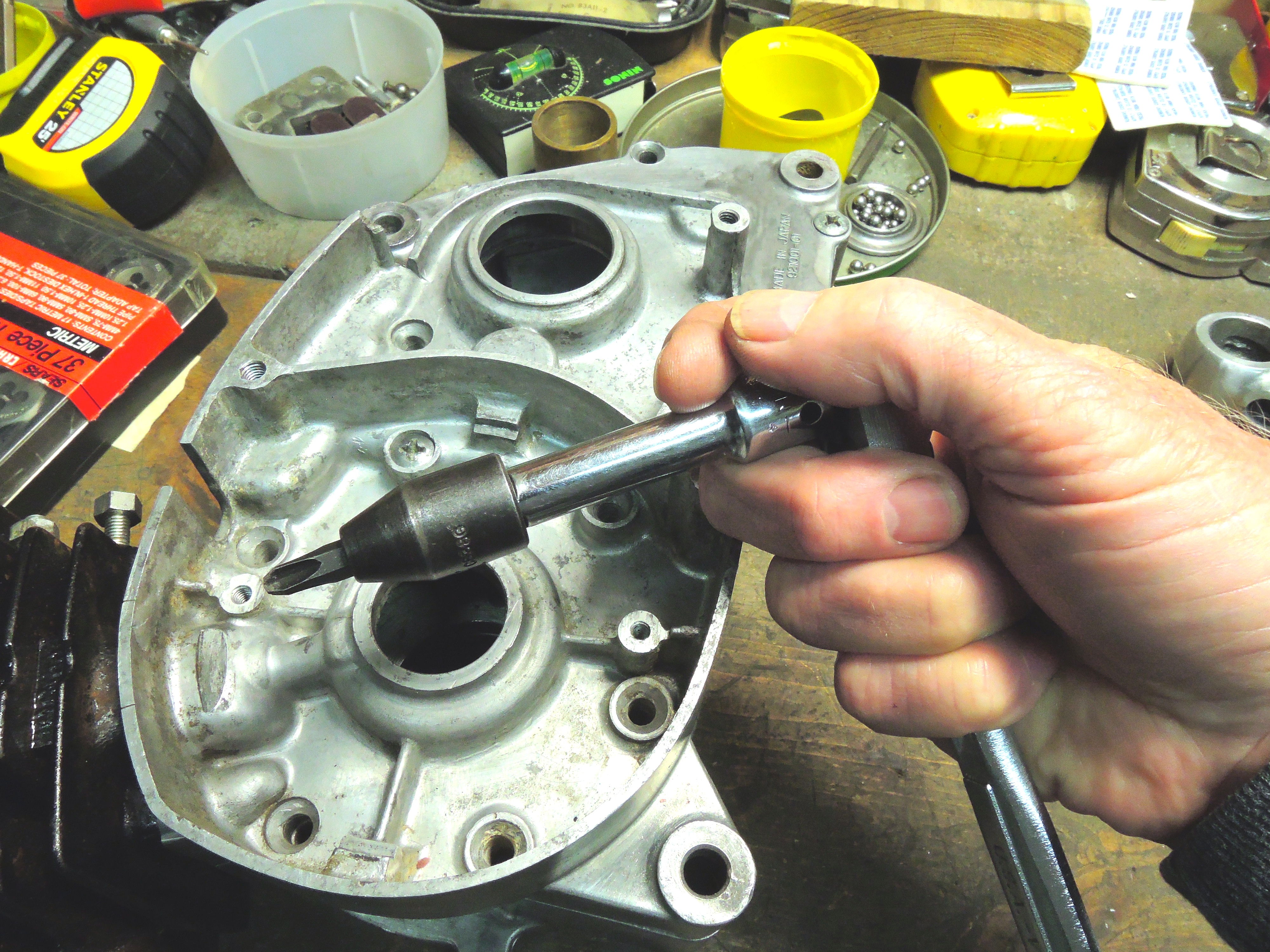

OK, Dr. Science wants to get in on this discussion. I always tighten case screws with a ratchet with my hand as shown. I've never had a problem in any way in 50 years. After reading all this I did several tests checking myself with a torque wrench and all examples were in the 55-76 inch pounds recommended and fairly consistent on the low side at 55-60 range. If you are new at this a torque wrench would probably be in order but common sense has worked well for all of us for many years. I personally would avoid using a hammer driver to tighten anything because of the unknown torque pulses.
Dr. Science and Max's opinion.

Ah, but Dr. Science is not easily fooled on measuring torque. He not only took readings tightening and loosening screws, he noted rotation of the screws on both torque wrench on hand tightening and loosening and taking many averages and comparisons along the way. He estimated that he was within plus or minus 5%.

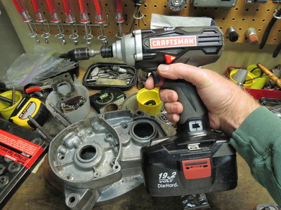

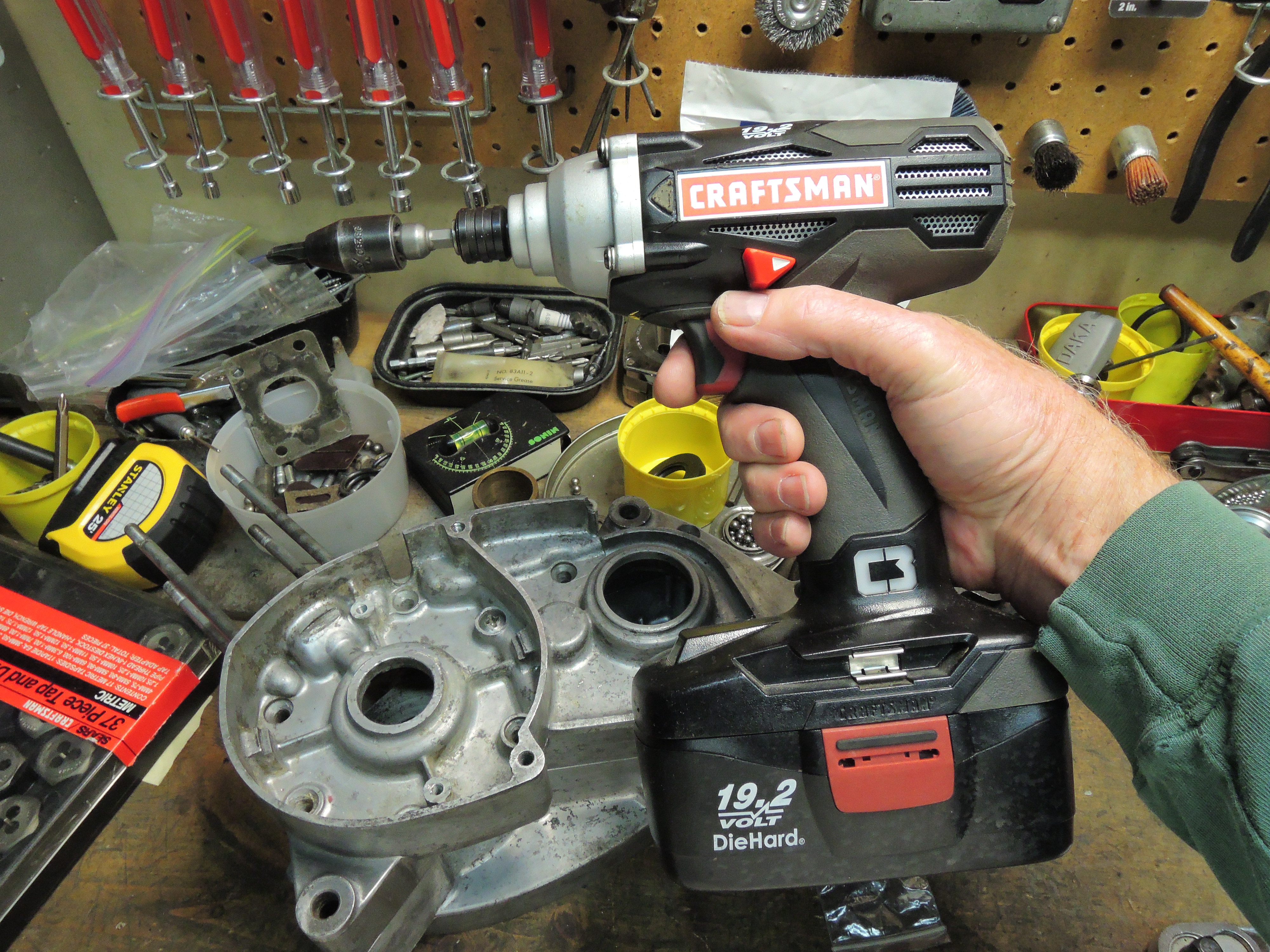

And hey, I forgot to mention that after using a hammer-driver for years, this little rechargeable impact driver is really slick for removing case and side case screws. (But not tightening them). It's also cool for for removing things like clutch nuts without having to use a holding tool.
