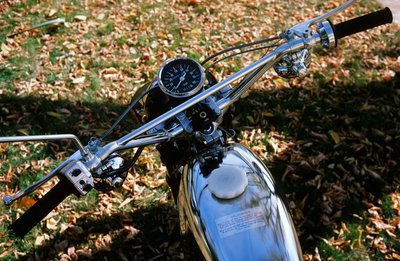

Rustiest and shiniest part of the bike. I'll have to do some research, but I'm guessing the signals go under the bars?

Welcome and congratulations on a nice find.
Regarding the turn signals; I think that they were intended to be mounted above the bars for visibility, but are almost always mounted below because they are just ugly otherwise… Be careful to mount them far enough out on the bars to clear the fuel tank at the steering stops on both sides.

Again regarding the signal lights...I have a 1976 Wombat (model 03) with similar signal lights. When you mount them under the bars it exposes the inlet wire hole to rain, so I just inserted some black wire coating around the wire to seal it. May look better with a clear silicone or anything to keep water from going all the way inside the light housing. I just think they look better that way and they are not so susceptible to getting broken if you ride it on the trail or in woods.

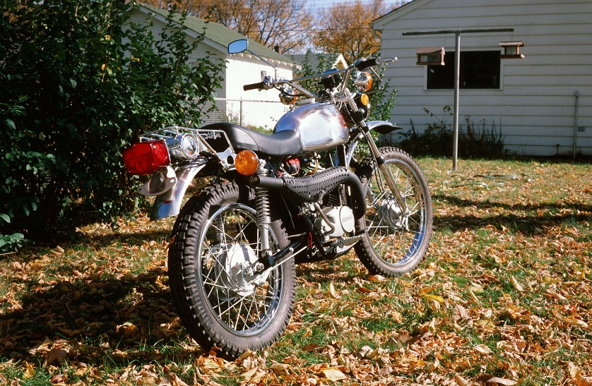

But here's a couple of pictures of my Wombat 94A just after I rode it home from the dealer in the mid-'70s. Only 12 miles on the clock. The front turn signals were mounted below the bars.
So - take your pick and mount them however looks best to you.

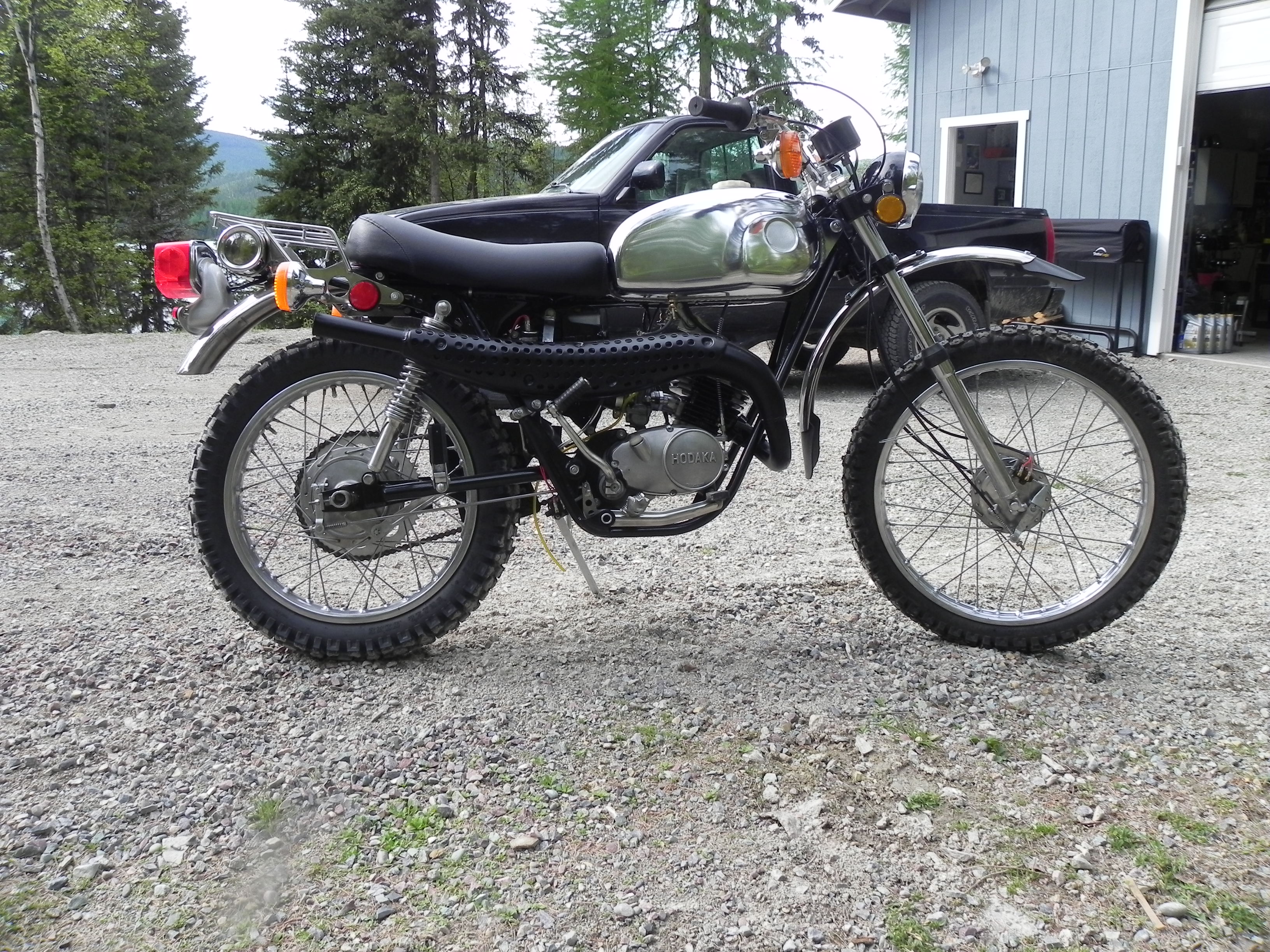

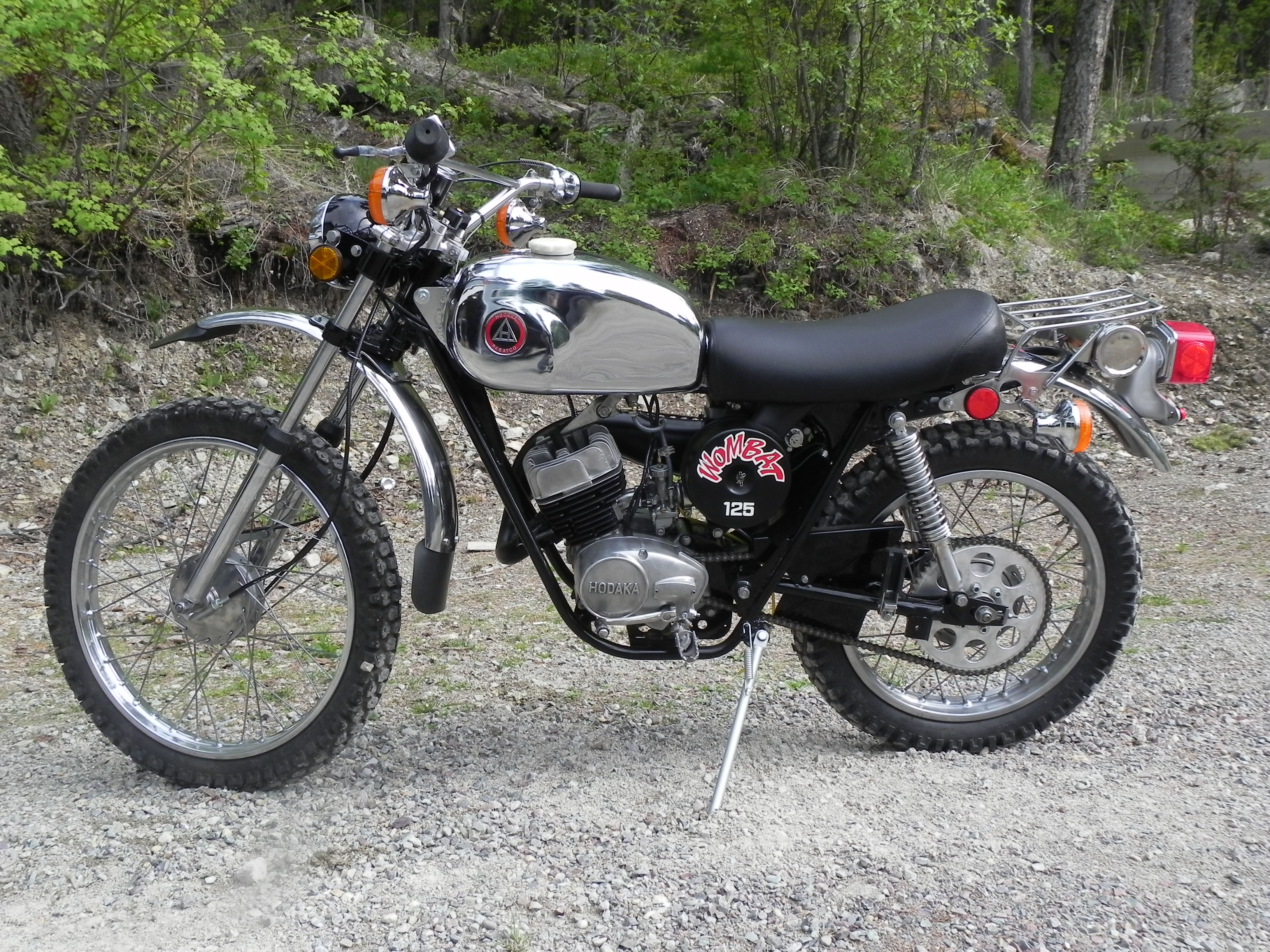

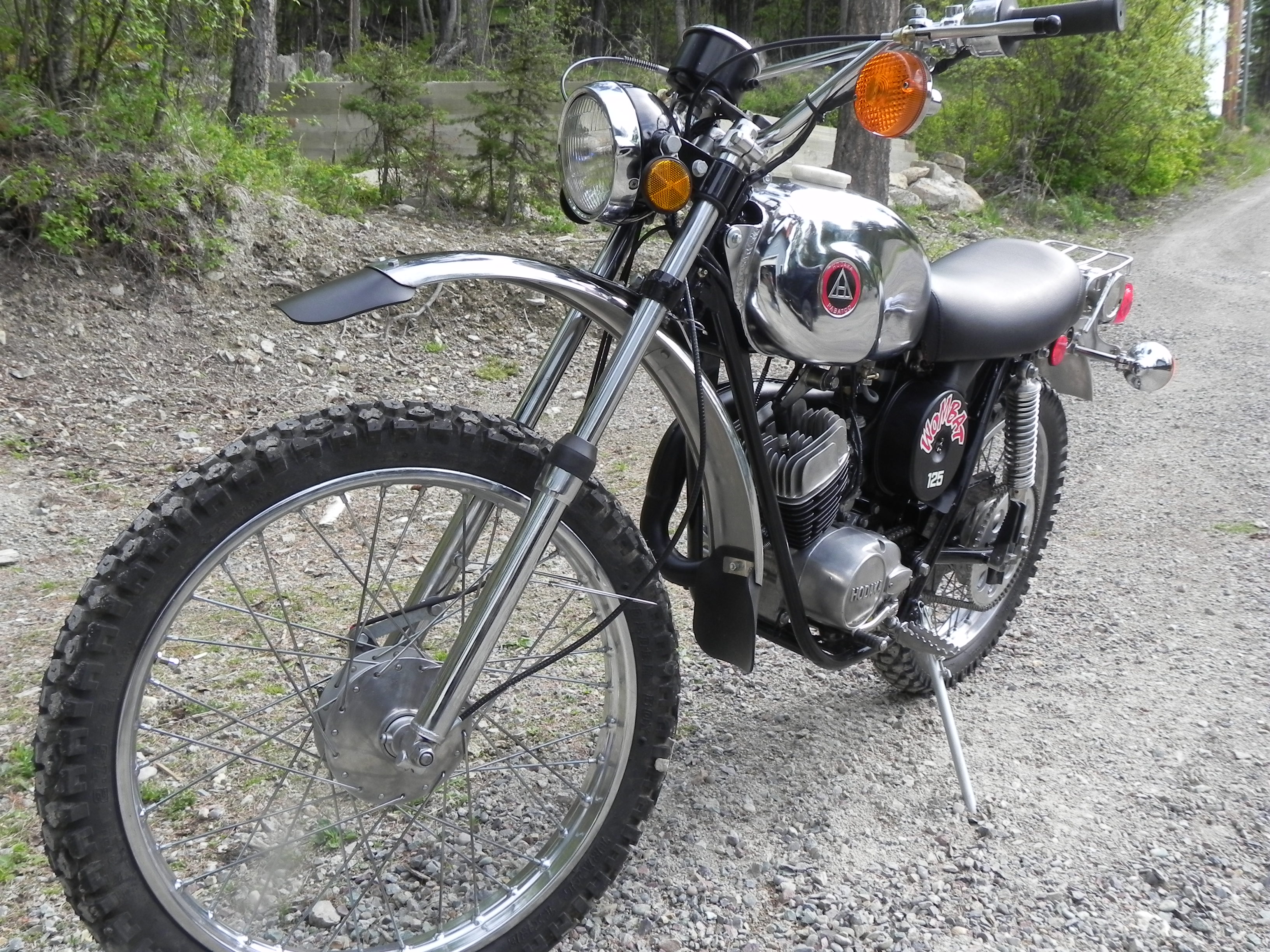

This is my 125 1973 94A Wombat I restored. Took two years (took my time) Everything is original, All parts were buffed and polished plus parts from Paul and Bill. Your bike looks great not alot of work just some minor polishing and and a few parts. Turn signals are down looks better and better protection.

Yes the badge is now on the tank

Thx MTRob - put the signals down and will fill the holes with clear sealer once I check all the wiring. Great looking restoration and taking your time is what makes that work relaxing. The more I wander thru life, I find relaxing time important.

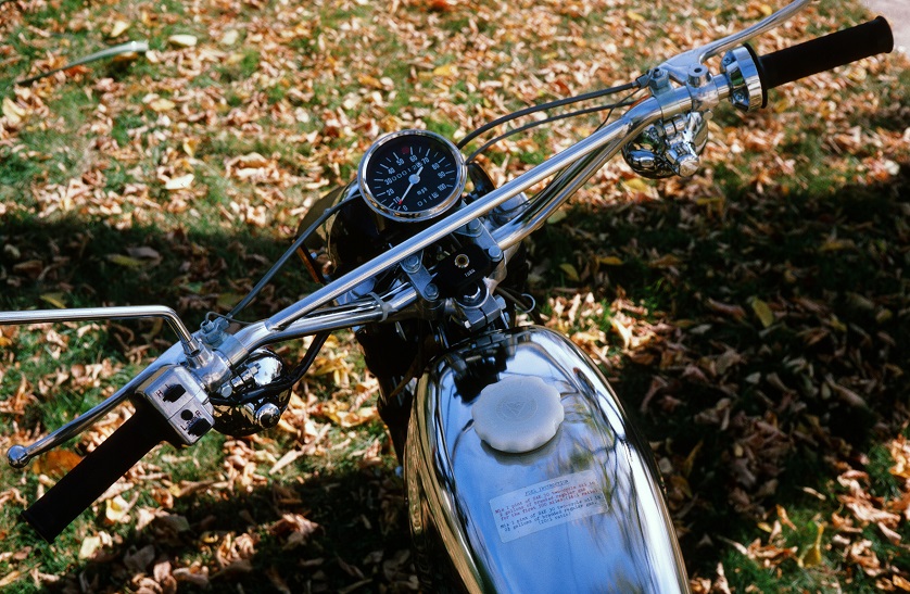

Just an update. I treated the remaining rust on the signal indicator with Extend and painted it black. I'm not looking for a showroom resto, just functional and stopping the deterioration. I also wanted to save the "TURN" sticker in it's stock form.
Some glare showed on this pic but the item is all black.
