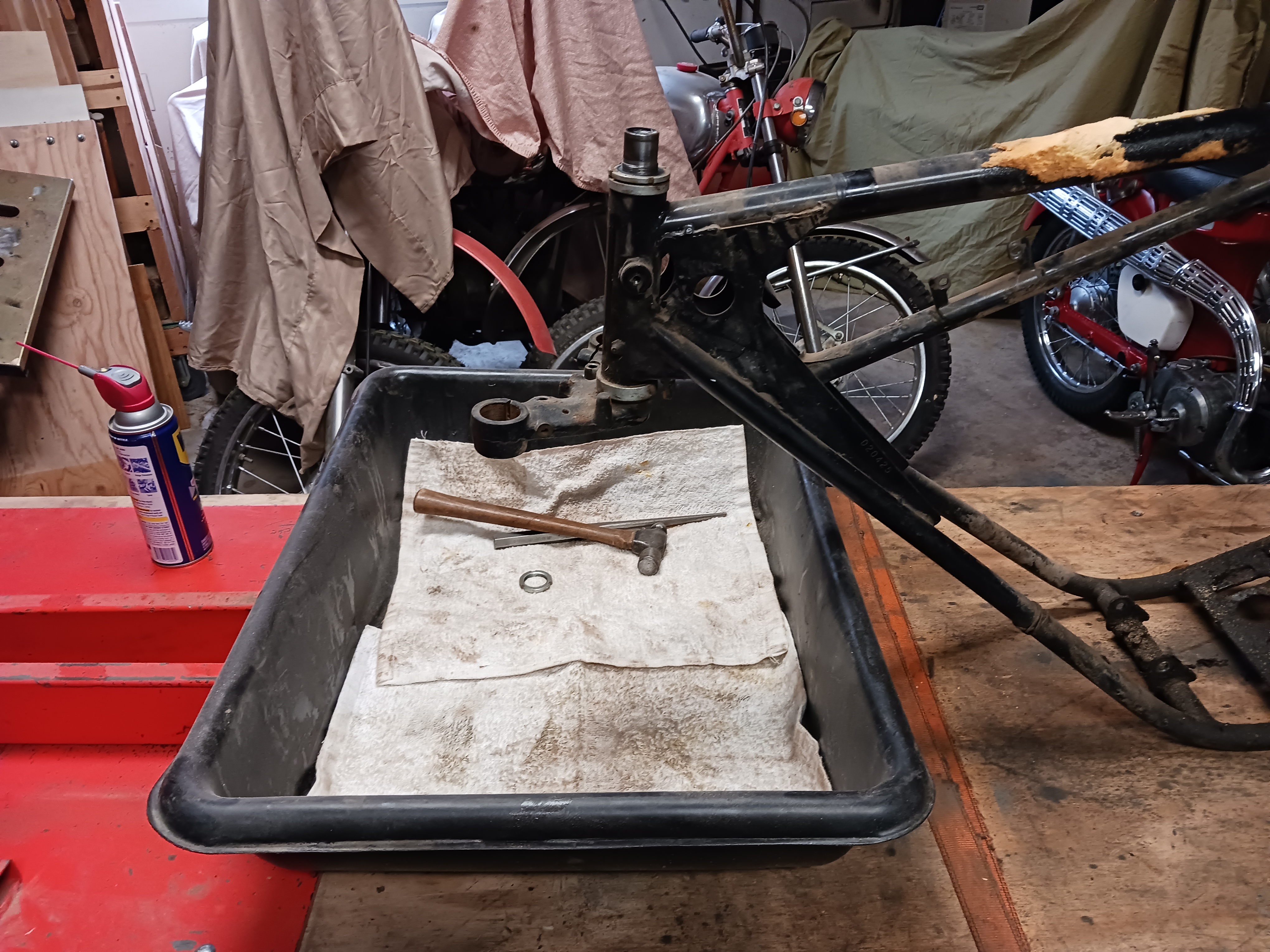

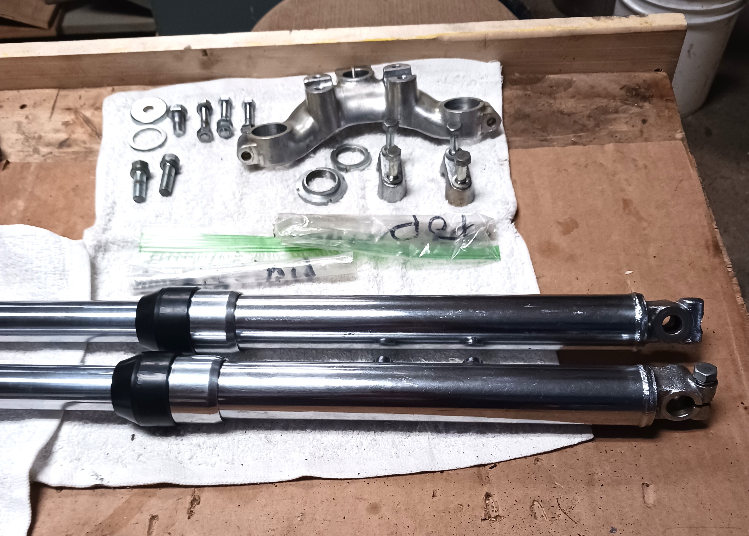

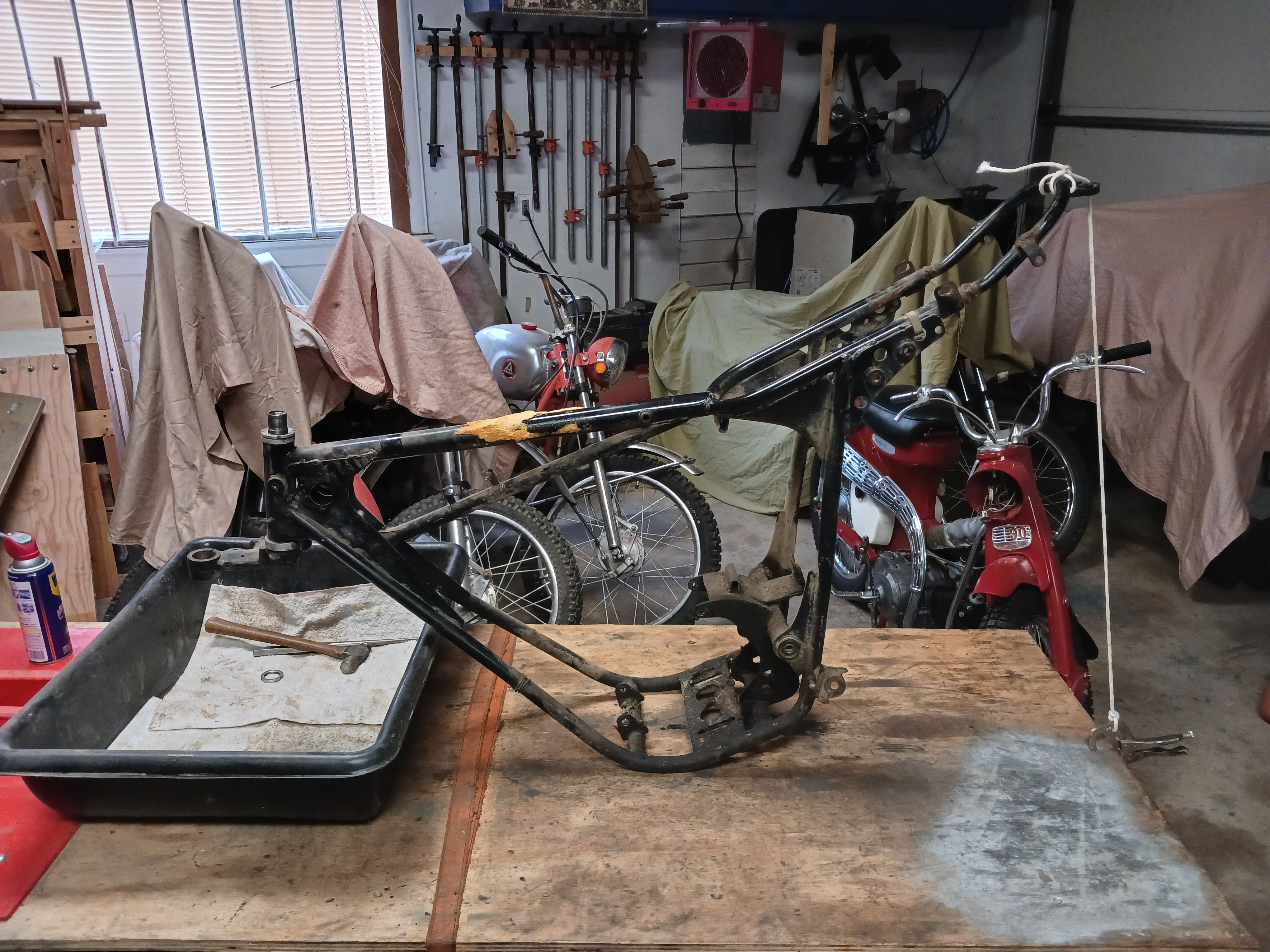

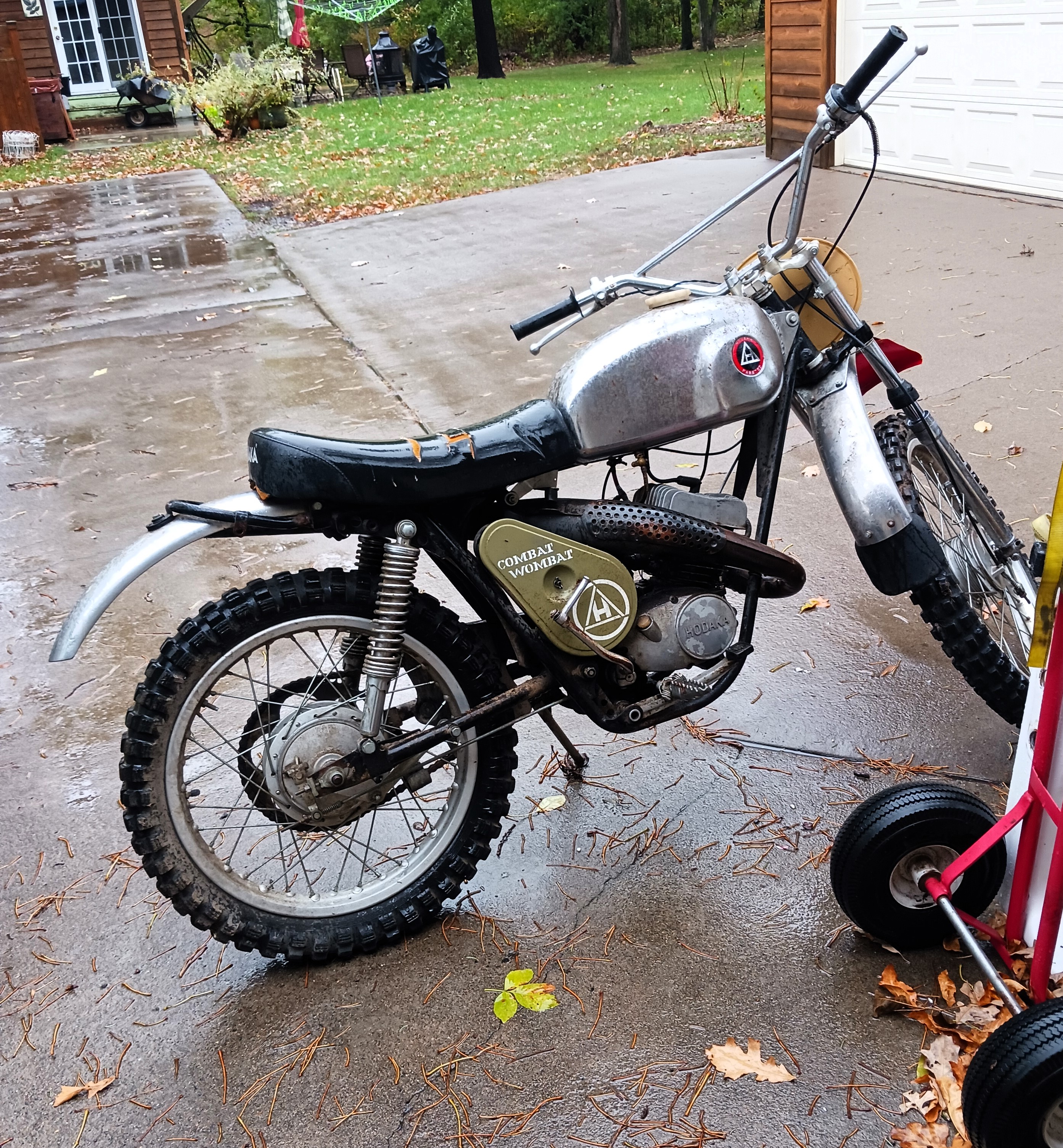

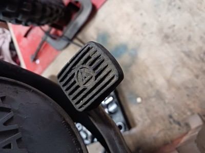

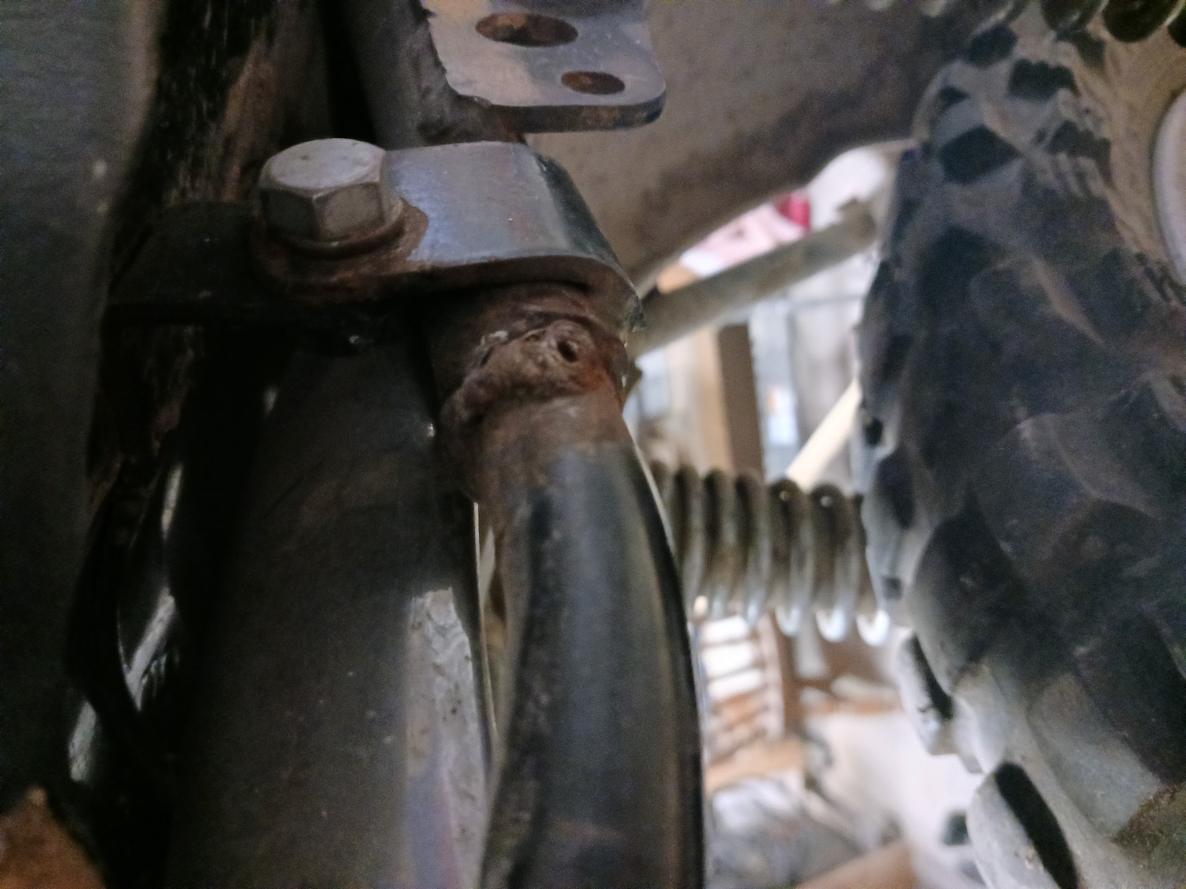

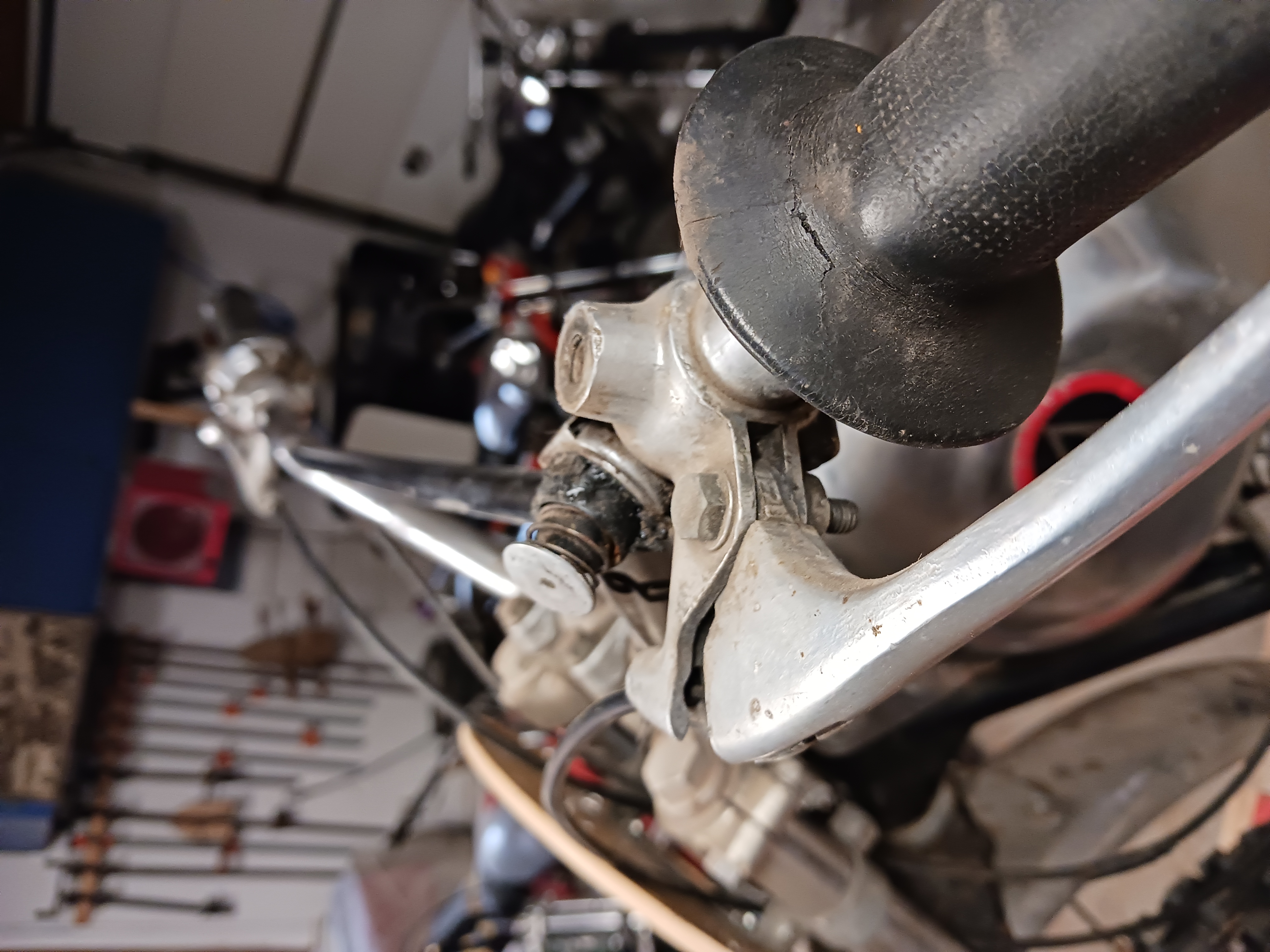

so finely got caught up enough to start getting into this project . some thing to look at , the fork boots are tore up so rebuild the forks , the air cleaner joint will need replacing , the clutch cable treaded part broke at where it screws into the case by the clutch lever , maybe that's why it got parked don't know , some one rewelded the frame on the rear part that holds the rear fender, and wire instead of springs on the exhaust springs , the rubber on the rear brake pedal looks pretty good , the kill switch needs the rubber covering , and the wiring harness has been cut up and soldered back together not to good either , so still need to take off the front forks and steering head yet . the swing arm may have a slight bit of rust , will clean the frame and swing arm and repaint , clean and rebuild kit for engine and carb . needs a seat cover and some other i call maintenance items. all in all the lack of rust makes this one the best HODAKAS i I've worked on out of the 7 I have , more to come ....albert

we cant be to careful when it comes to taking apart the steering head . don't want all those ball bearings flying around the garage floor

Albert I think springs on the exhaust should be pulling it forward not to the side. I would like to donate a ring, base gasket or head gasket to the cause. hope you don't need any of that. Looks really good! ------ Clarence

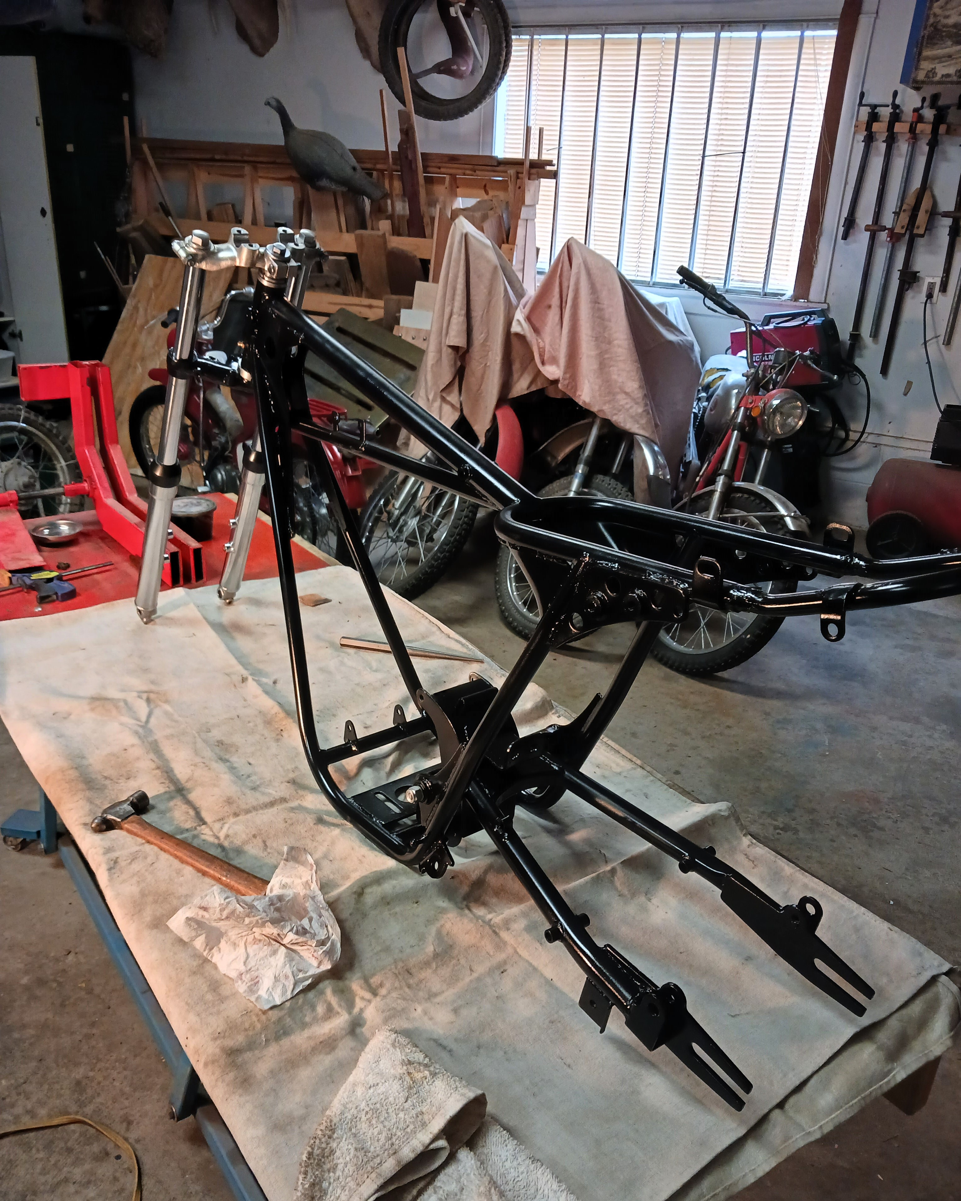

clarence., thanks for the offer i plan on getting a rebuild package from HODAKA PARTS that should take care of things and the exhaust springs are missing, what you see in the picture is baling wire that someone tied on to hold the pipe on . victor this bike has all the parts , except the springs , for the exhaust including the rear bracket , good idea thought . today in central Minnesota it was 54 degrees with no snow on the ground . i found time to sand blast the frame and swing arm a little more clean up and ready to paint......albert
Re: combat wombat barn find
Good deal! You need a total of 5 exhaust springs. 2 for the front, one for the middle under the tank and 2 for the rear mount. The shorter springs work better, front & rear, but a longer one works best for under the tank. :ugeek: Victor

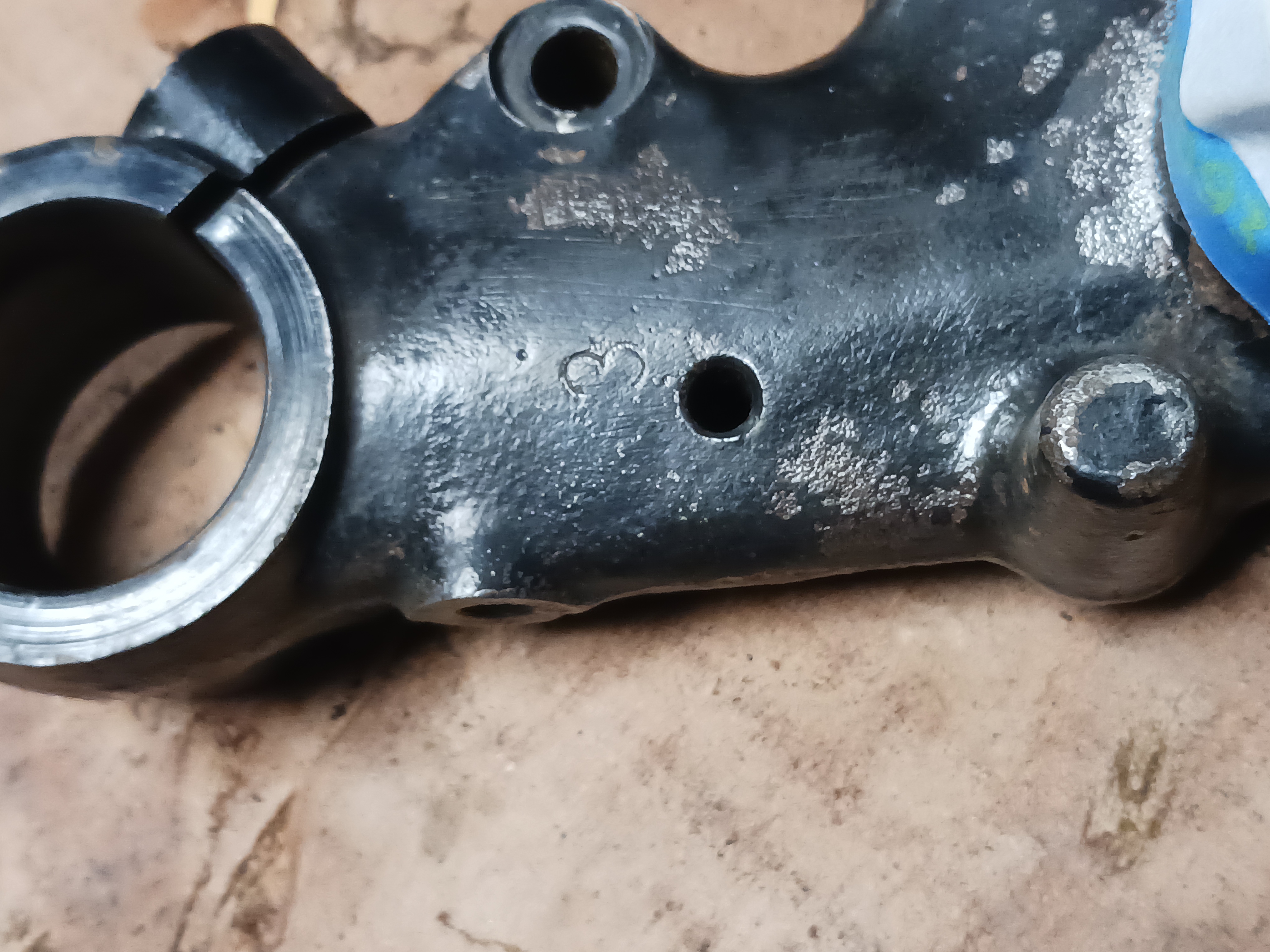

progress made , but whats up with the 3 stamped in the Steering fork bracket , just another number that the guy would pick from the factory
I've never noticed any numbers stamped on mine, but then I never really looked. I have to give all of mine a look to see if any are stamped.

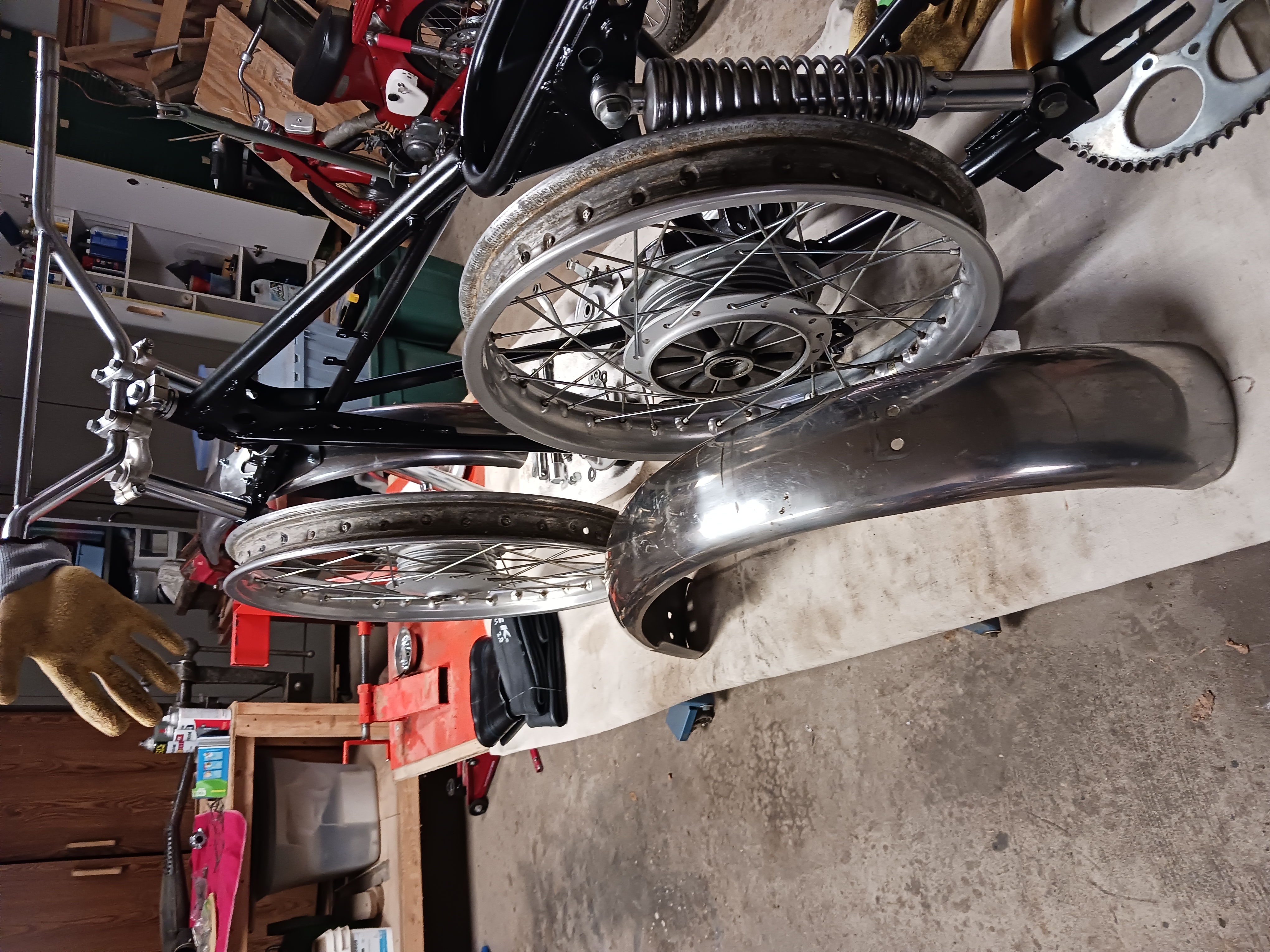

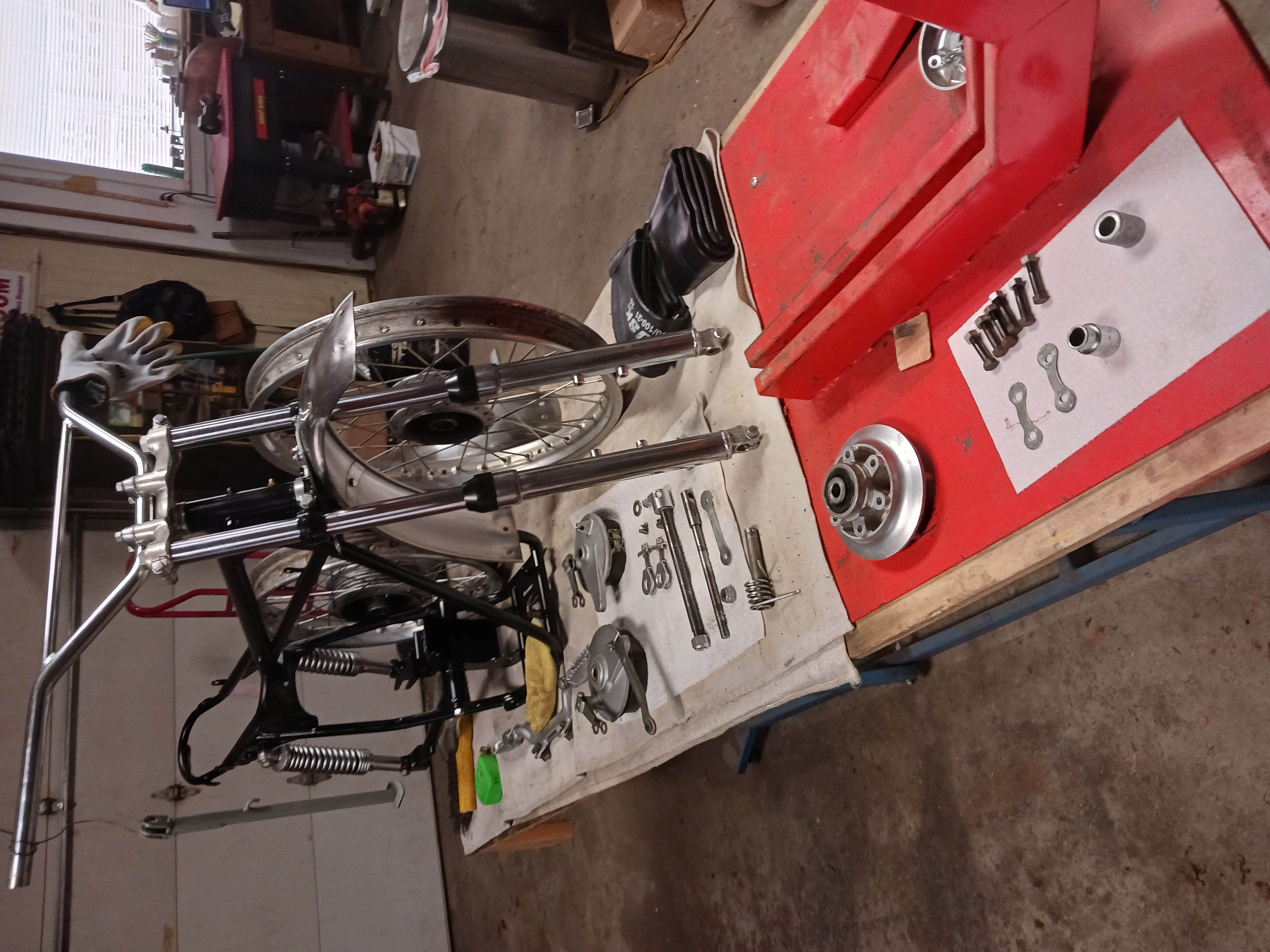

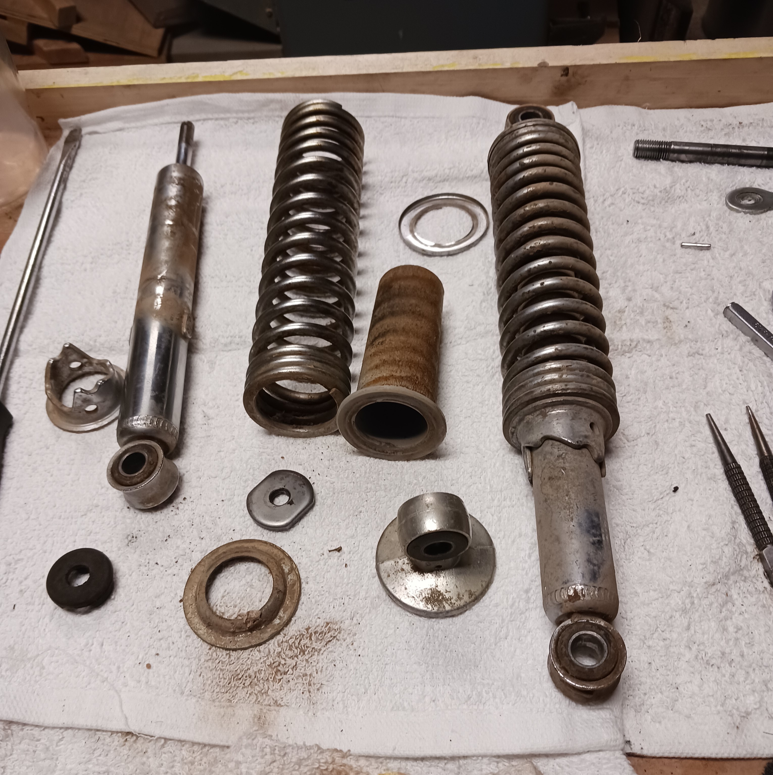

good start so far . swing arm and front forks on , rear shocks coming apart , thanks again Kelly for the video helps immensely. they should clean up very nicely. plan is rear shocks then front tire assembly . back to real life this week might slow down progress ....albert

Albert! You’ll find that after clean up of the top plastic sleeve, gray primer is a good paint for matching the original color! :ugeek:Victor
good tip . but this bike is cleaning up real good the plastic sleeves are a little dis colored but not to bad , i,m choosing to put them back on with out any paint . im washing parts in the parts washer then rubbing down with WD-40 and steel wool and there coming out pretty darn good . there is not a rust issue , just a good cleaning ....albert

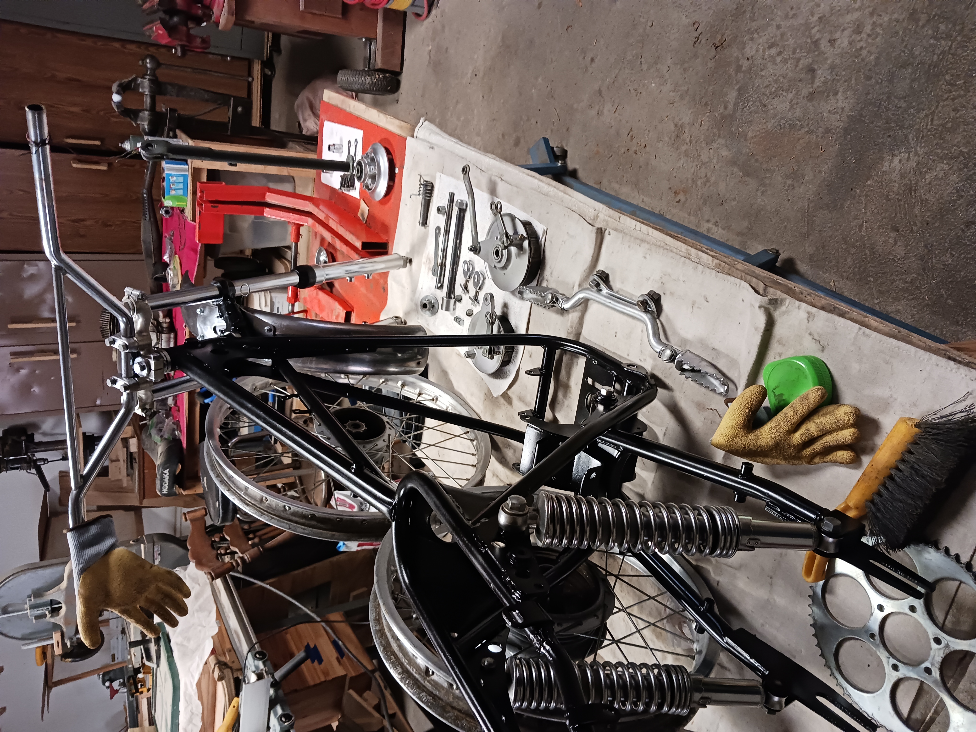

have the fenders cleaned up and the front installed , handle bars cleaned up and put on , front wheel assembly cleaned regreased . any recommends for tires , 21 front 18 rear , would be appreciated ....albert

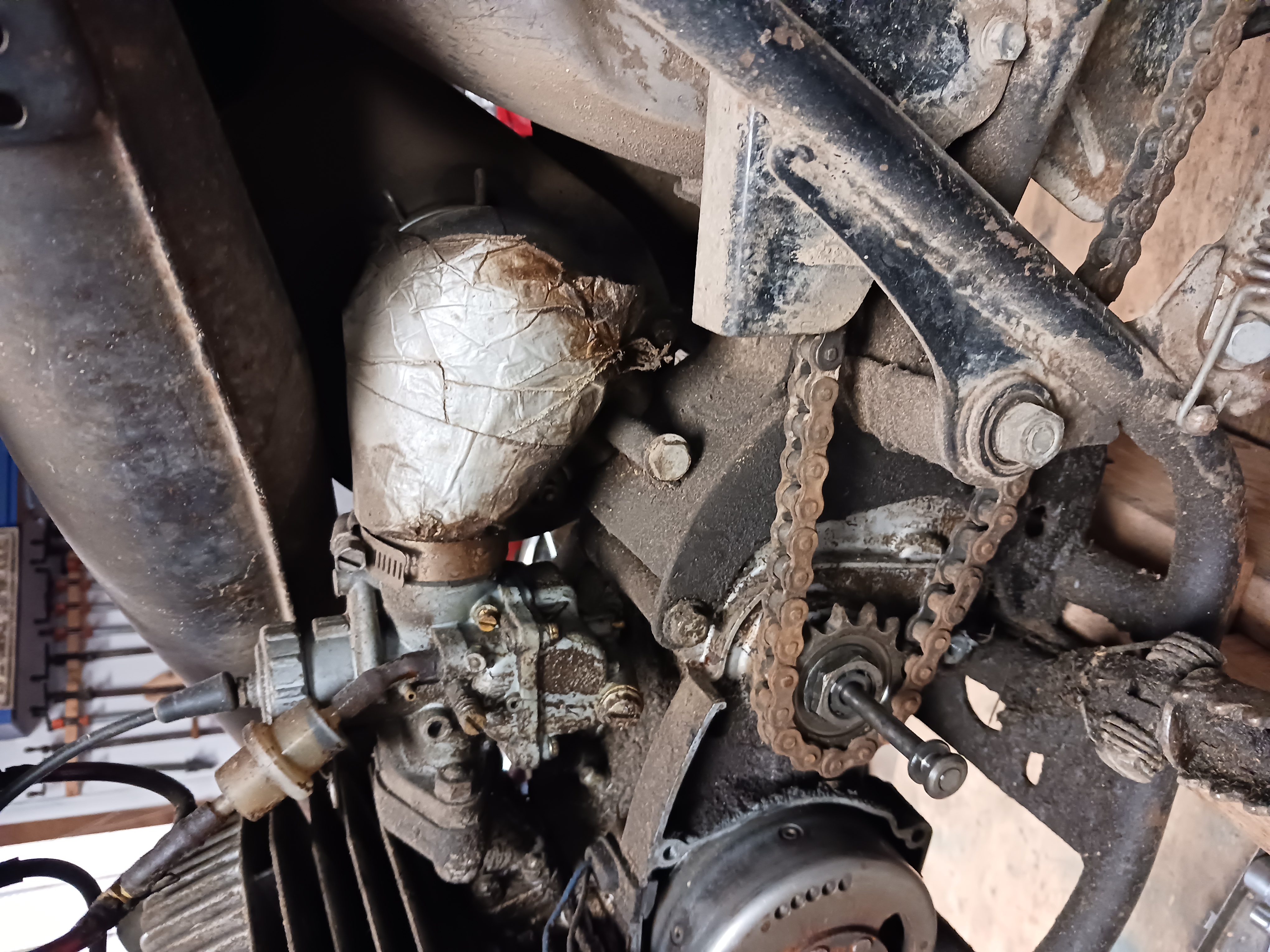

been cleaning parts and waiting for tires to show up . both wheel assembly's are cleaned ,grease repacked , throttle cleaned up , foot rests good to go . tubes are waiting ... ordered parts , new cables , air filter , rubber flaps for front fender ,air boot , will wait till tires are on and parts that can be installed are on before i dig into the carb and engine don't want to get to far ahead of my self..... albert
