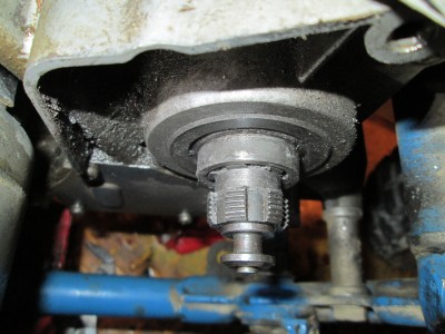

Dirty_rat might be on to something. It's hard to tell from the pictures for sure, but it seems to show that the diameter of the sheared portion might be slightly larger than the minimum diameter of the depth of the splines on the shaft, potentially indicating that the inner diameter of the splines on the sprocket may be larger than the inner diameter of the splines on the shaft. This would leave the threaded portion of the shaft carrying the bulk of the load. He may have nailed it, I hope.

Alright, I think I'm ready to talk about this now -- and apologies for the bad language in the subject line.
Here's an incident record of my 250SL counter shaft history:
1. At 6244 miles the STOCK and ORIGINAL counter shaft sheared. I sourced a NOS counter shaft and put the engine back together with the original 14T sprocket.
2. At 6800 miles I decided to move up to a 15T sprocket to make the 250 a bit more highway capable. Never could find the 15T Hodaka sprocket, although they seem to have been available one time. Hodaka-Parts has a listing but no inventory. But back in 1981 Cycle World had a Hodaka parts interchange that mentioned, in part, that the Honda XL250 CS sprocket is compatible. When Mike Perret was prepping his 250SL to ride across the country from Pennsylvania to Hodaka Days in 2017 he installed an XL250 sprocket.
3. Further along and rolling up to 9100 miles the NOS countershaft sheared. To replace this one I chose a counter shaft that had done 6600 miles before its bike became an eBay donor, speculating that an "experienced" part might prove more reliable in case the first run of shafts were not properly tempered (my bike is number 180 off the production line).
4. Now, at 10,000 miles this one sheared again... And to note: both sprockets have no discernable or measurable wear or damage.
Now I've acted upon Ed's and Dirty Rat's aforementioned speculations about the sprocket dimensions and have brought out the calipers to measure the I.D.s of the stock and original CS sprocket and the schematic sheet for the 15T I switched to:
Stock CS sprocket:
Distance between the valleys = 25mm
Distance between the peaks = 21mm
Brand X 15T:
Distance between the peaks = 22mm
The width of the valleys on both sprockets is = 6 mm
So, the smoking gun is identified by the distance of an extra 1mm between the peaks?
To the eye when physically matching the sprockets the mm is barely discernible.
But when I split the cases to replace the counter shaft and go back to a Hodaka sprocket I still won't be resting easy because of the circumstances (stock and original parts) of the first.
Anyway/ennyway it's good to get this matter off of my chest. In the near future I'll have something to say about the stupid breaker points issues (2X so far) with my 94 Wombat, it's another one-off, never-before issue again I'm sure.
Darrell
Over here in Nanaimo BC
