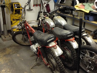

Thanks for all the info Bruce and Bob! I went out to the shop last night to pull frame numbers and get a picture. Both of the 100 Dirt Squirts are 92C or 96 models and the 125 Combat Wombat is a 95 model. Once I confirm the engine numbers I'll order service manuals. Here they are (tanks, air filter housing, etc are with the bikes, just not on them right now):

Nice bikes to restore !! Two of my absolute favorite models..

I'm starting with the 96 Squirts, I've ordered a manual and started breaking them down. I've already run into some excitement with the "red" one. Lookes like someone added a different carb based on the "custom" holes drilled in the intake manifold and by the way they chopped up and RTV'd the intake boot to make it fit over the larger diameter carb.
I can doctor the intake manifold, but what do yall think of the intake boot? I'm thinking of just adding a UNI foam pod filter if I can get over the fact that it wont be historically correct.

Re: Restoring Memories
I would recommend NOT switching to the pod type filter. A new air boot (or the one you have) can probably be made to work. I have a Wombat/Dirt Squirt type air cleaner connected up to a 28mm carb . . . so I think you can make it all work. (Not to mention that I think the stock system will clean the air better and probably breathe easier than the typical pod element.)
PS: Those look like pretty nifty starting points for getting things working. Lot's of folks have started out with "rust buckets" . . . and you sure don't have that problem!
