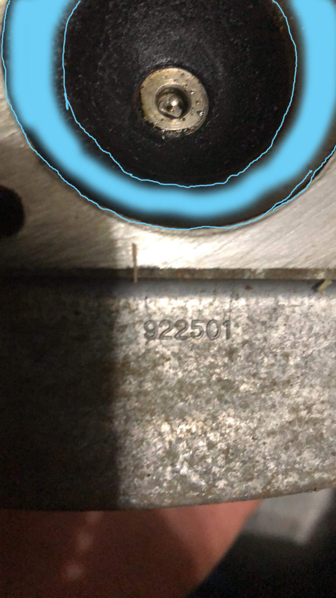

I was shown a pic of the bottom of the head to confirm the part number was a 922501 head & not a 932601 Super Rat head. Is it just me or does it look like the head has file marks on it? Here’s the pic.
It appears that it is not only an all stock configuration, it also has a std bore, 2 ring Ace piston and a 922501 Ace cylinder head with a 2 bolt Ace intake on the cylinder. Stock head gasket as well.
So my guess is someone milled the head down, possibly with a mill bastard file, based on the scratch lines in the photo? What do you think?
Or does it appear that there’s a significant enough carbon build up in the head to reduce the size of the squish area enough to cause the increase in compression? :ugeek: Victor

Well, that certainly isn't the factory finish on the cylinder head sealing face, but it could have been lapped for flatness - and that might not be the issue.
NOTE: The "squish" area is the thin "doughnut ring" of air/fuel volume surrounding the main part of the combustion chamber. Normally, there is a "step" at the outer edge of the "squish band" - commonly .010" or .020" or more. That "thickness" combined with the thickness of the head gasket provides for a ring of compressed fuel/air which is in close proximity to metal (piston on one side and head on the other) which allows for relatively easy escape of compression heat into the metal . . . which helps keep the compressed gases away from detonation temperatures and pressures. If the squish band "thickness" in the head has gone to zero thru head mods - - - that may be a hint compression has been significantly changed by some long lost previous owner.
NOTE: I don't have a loose "92" head to check for squish band at the edge. Sorry.

The "squish" area is in blue. There should be a "step" at the OD of the squish area from the sloping squish band to the sealing surface of the head.
Re: Dirt Squirt Compression Test
And that’s missing! So I’ve advised him 200 psi is too high a compression & to get a stock head. Thanks folks! :ugeek: Victor
