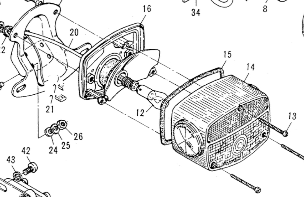

If you have been following the market for Hodakas they aint getting cheaper. Probably the original frame as the battery cover side plate would have nowhere to be mounted on an SR/SC frame. Looks like oil injection bypassed, wrong tail light, chrome rack, ignition switch and dash missing as are the very hard to replace blinkers. Pistons and rings can be sourced. How strong are those original features in your plans? 1500 would be max value to me. Most likely cost you approx 300 for top end rebuild. Puts it at 1800 as a runner. Fun play bikes for sure.

Because of the year, 1976 it 1977, it will require a full set of turn signals. Find out if he has them and is the wiring harness & Switch in place, because it looks like they are missing. Also has the incorrect, earlier Ace/Womvat tail light. The correct one is the rectangular one found on the Toads & 03 Wombats! :ugeek: Victor

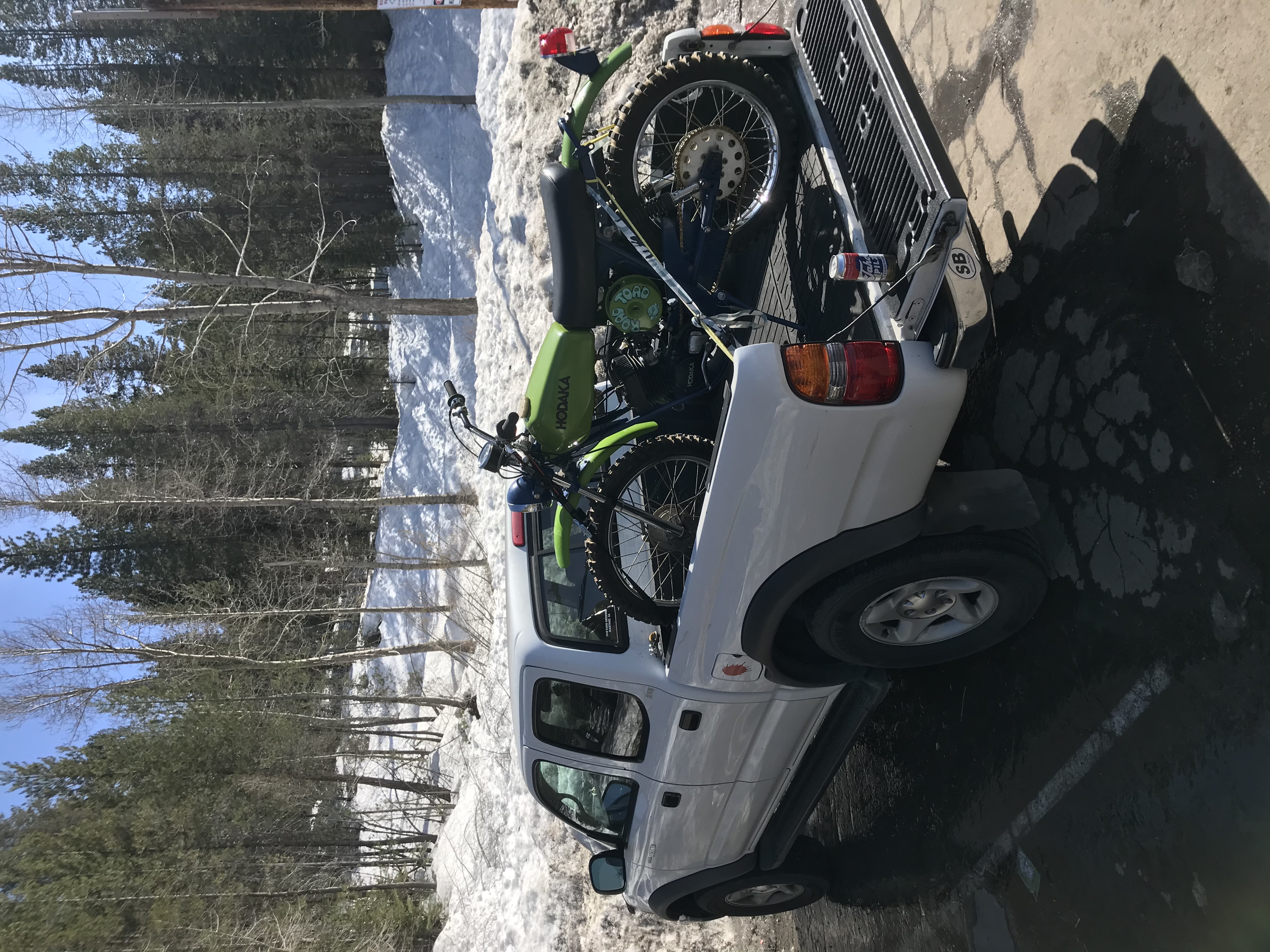

Yes I bought it!
I am the 4th owner, but the second that is serious about riding it.
I don’t know much of the provenance other than the original owner passed away, and used it primarily as an enduro race bike, so he shed as much weight as he could, unfortunately the blinkers, rack, and turn signals basically all the stuff that’s hard to find. The second owner was the original owners brother who knew nothing about bikes and stored it until 3rd owner bought it, rode it 2-3 times and then stored it for 8+ years in a climate controlled garage. I do have a title registered as an off highway not street legal bike. It’s missing an ignition switch, the hose between the air filter and the engine, blinkers, signals, rack, toolkit, mirrors, and probably other things I have yet to even know about.
I bought an illustrated parts manual on eBay and am excited to delve into this restoration. At least to make a runner out of it. I am on a budget and OEM parts are a luxury I can’t afford at the moment unless they are actually affordable so I am very open to any tips or suggestions. Thanks all for responding to me and helping me make this dream a reality. My neighbor is convinced all the bike needs is a carb clean to make it a runner but I want to do this the right way and not damage other components rushing the job.

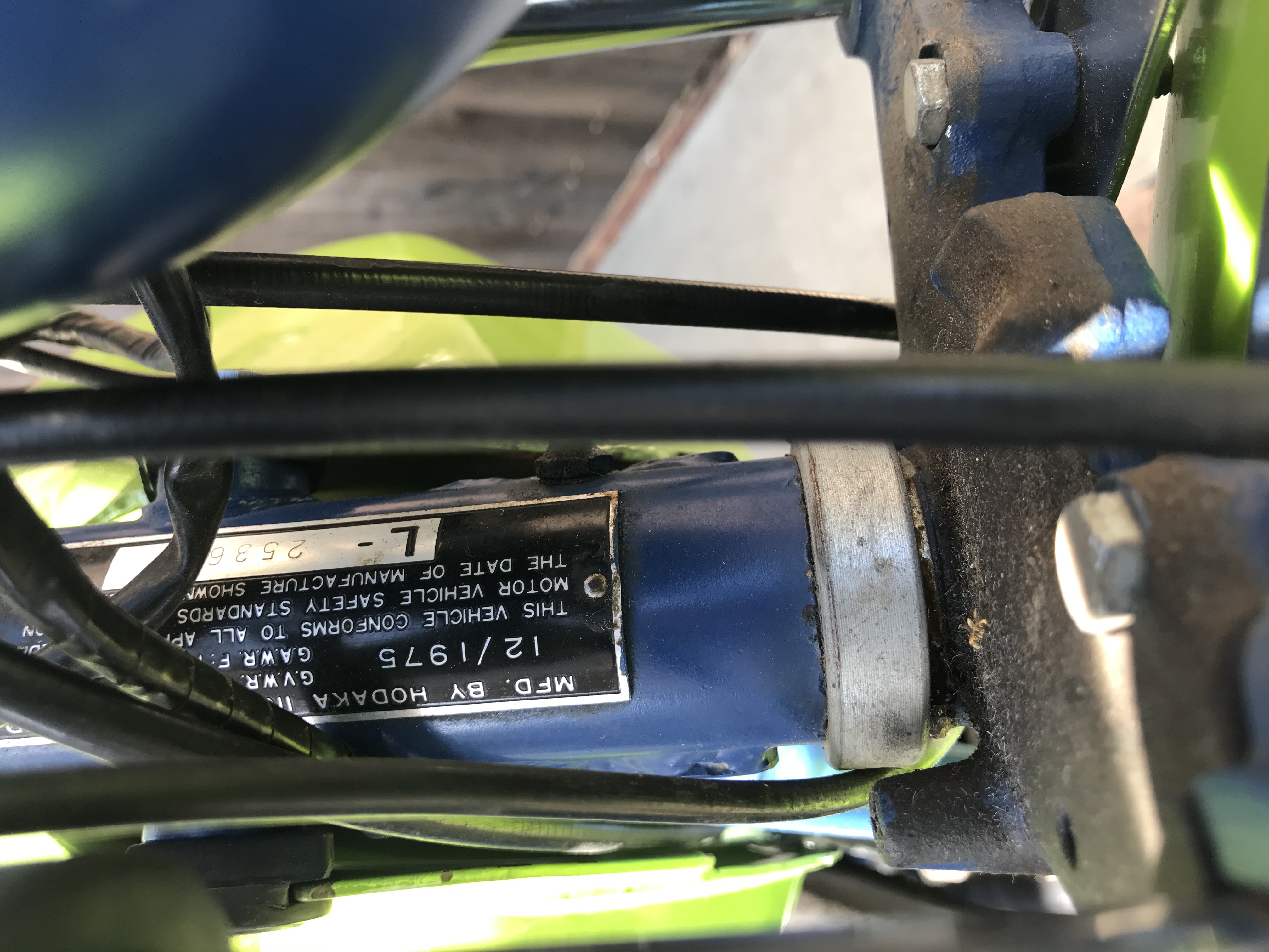

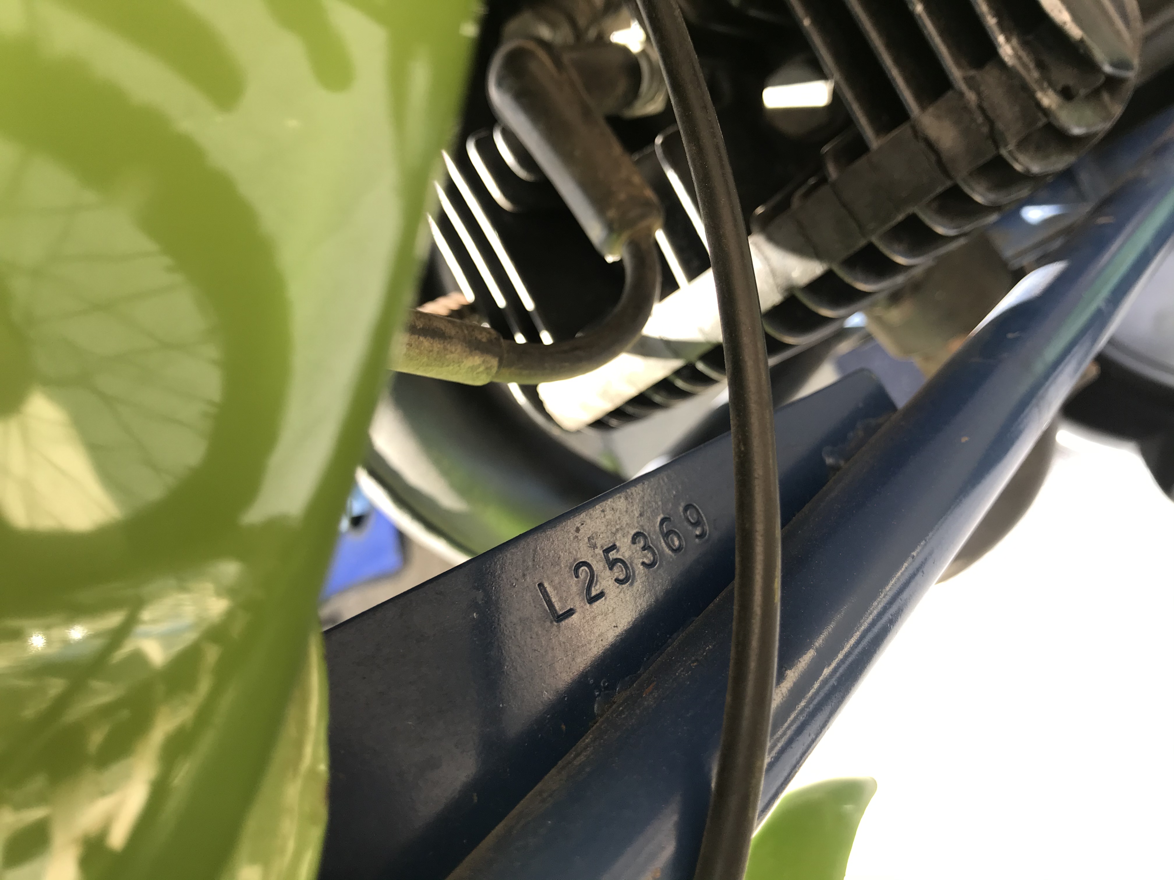

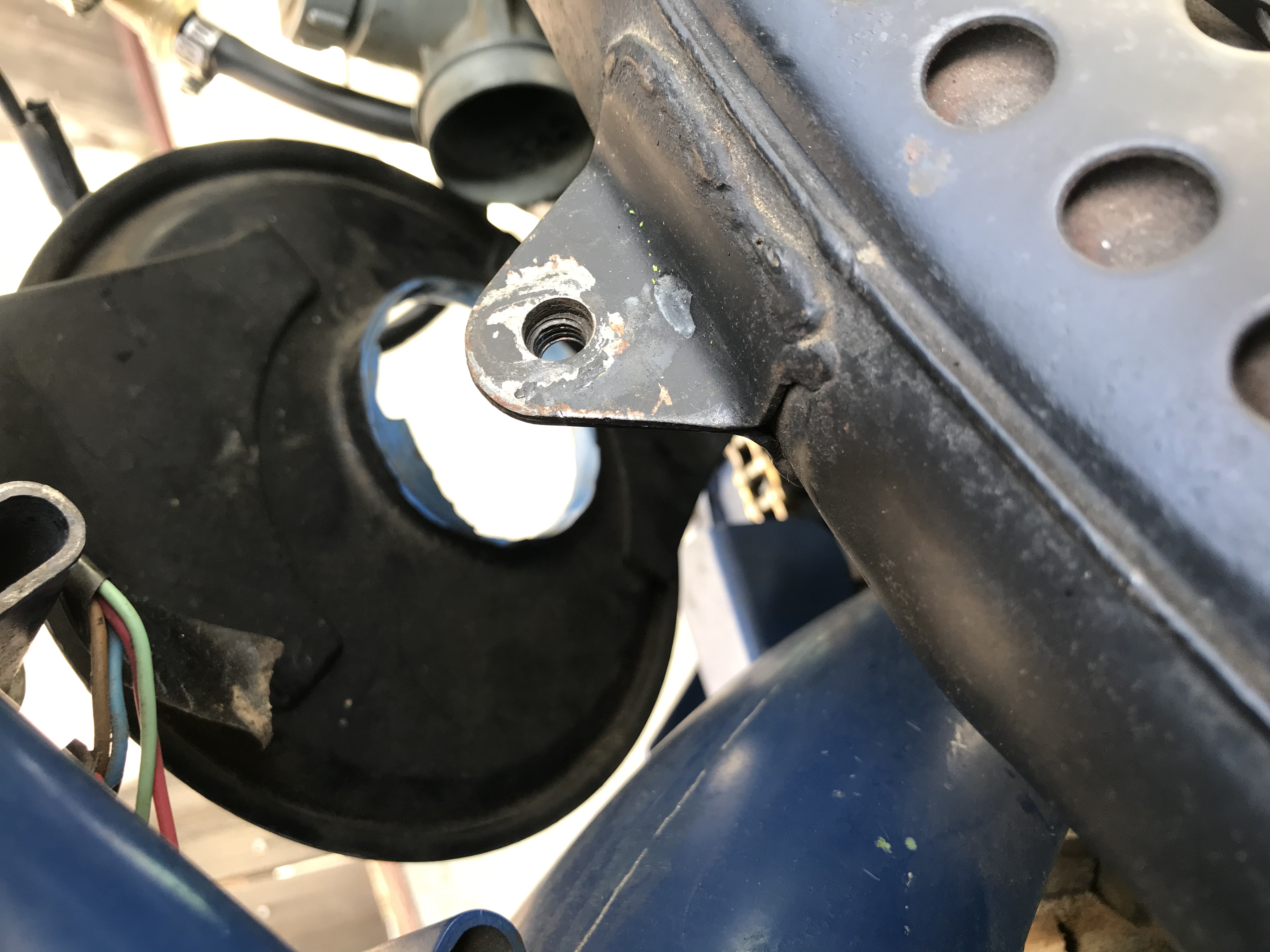

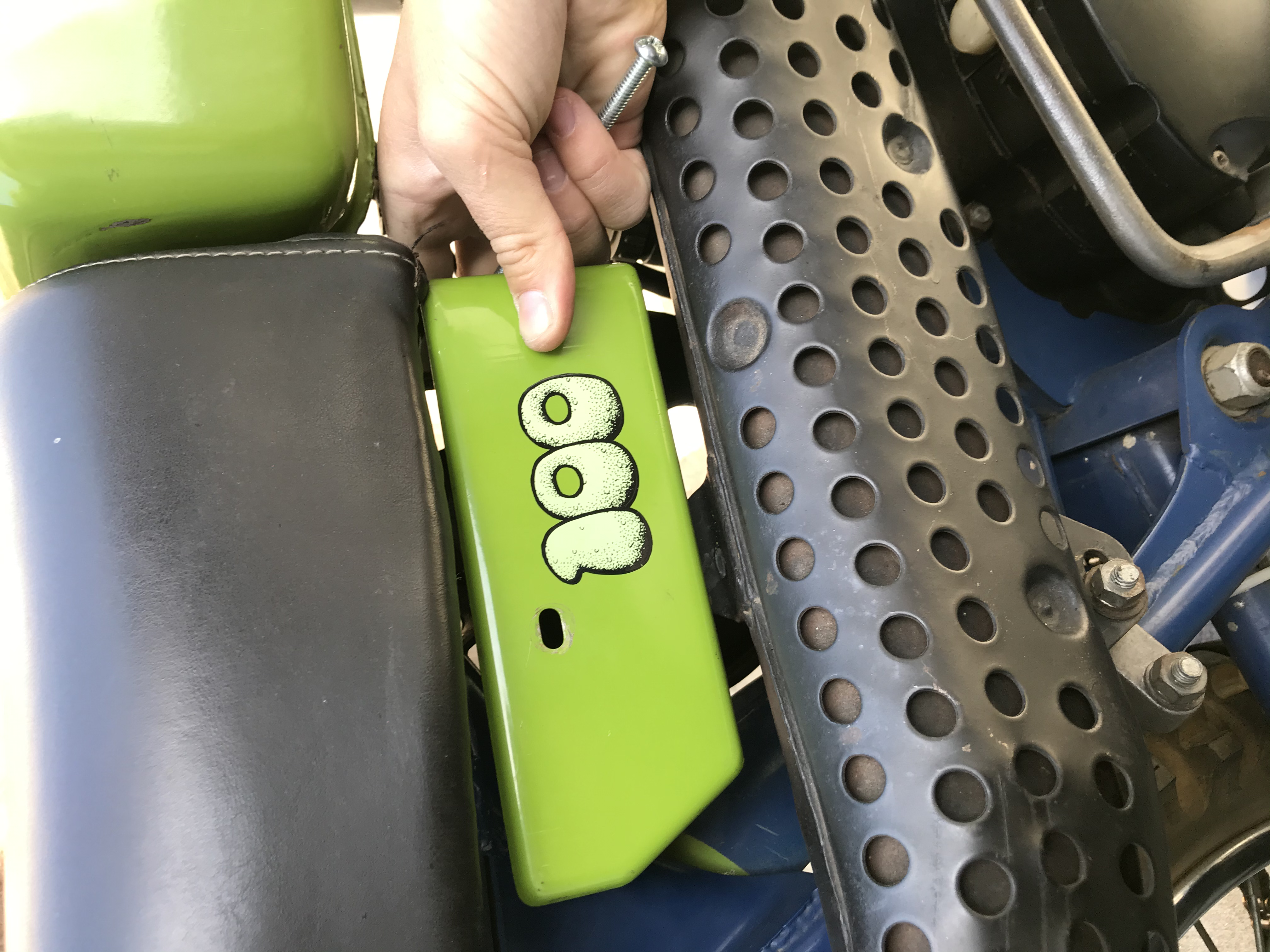

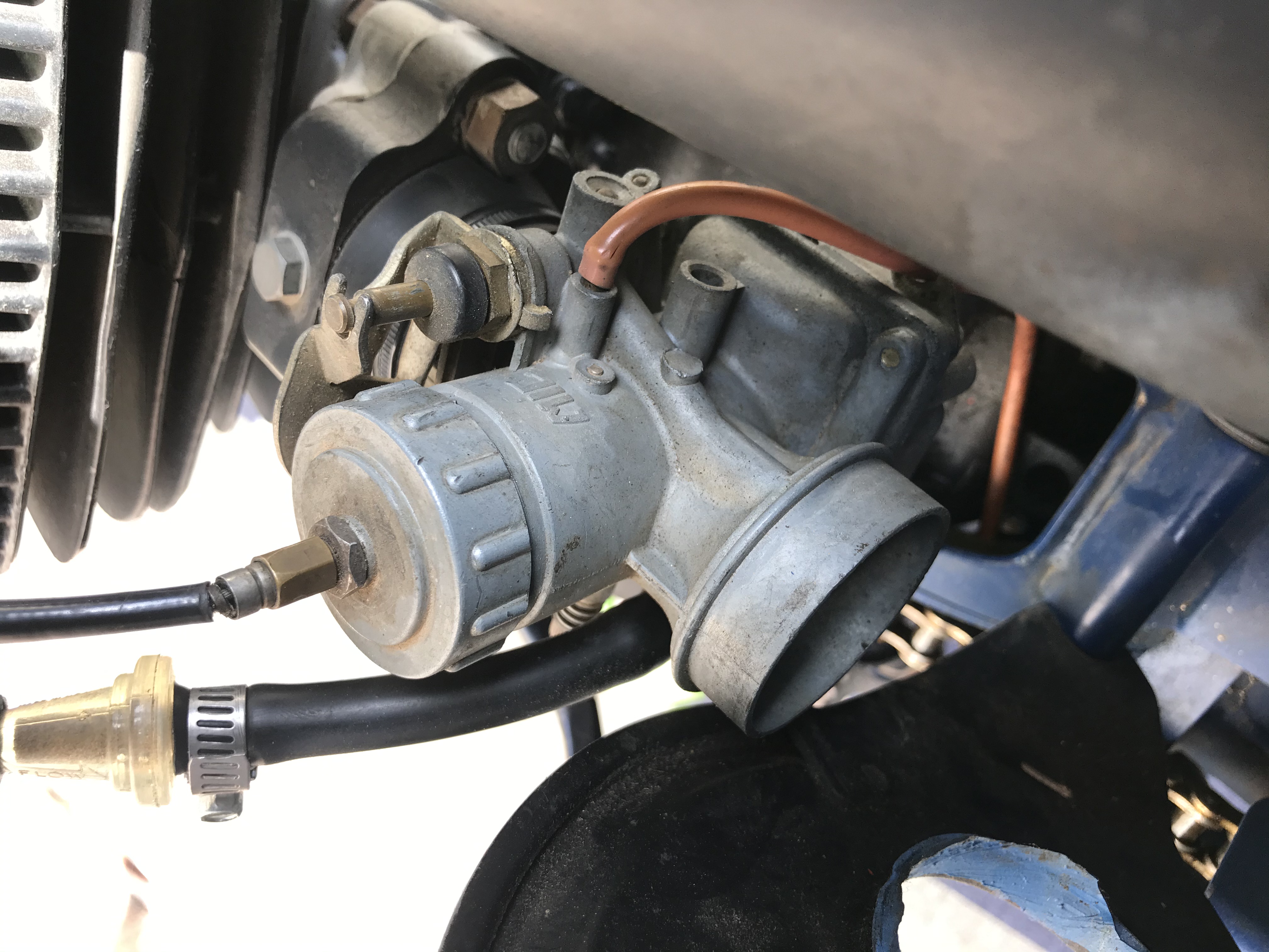

Hi all, I started some tinkering. I figured I would start by cleaning the carb. Here is some more things I discovered about the bike. The badge and some of the markings on the frame. I also noticed the battery cover? The green L shaped bracket with the 100 decal seemed to have just been held on with one long bolt to the frame just sort of floating there. Note the missing elbow from the air cleaner to the carb. Also the exhaust pipe is missing it’s too bolt and doesn’t appear to have anything to bold to. Am I missing a battery entirely? There is nothing behind that L shaped bracket. Is this a confirmed 02 Toad frame? Someone mentioned if it wasn’t a toad frame that battery cover would have nothing to bolt to. Is the fact that it’s kinda jerry rigged and just floating mean the frame may not be a toad? Thanks all

Diagram Q on the HPI website parts list show you the parts of the battery box and how that ties things together. That green cover is the battery cover. Its loose because the battery box is gone. The pipe can be mounted solidly without the battery box if you find all the parts. Since so many parts have been removed, some creativity may be involved. You indeed have an model 02 RT.

Thank you, the battery controls the headlight, taillight and blinkers I take it?
