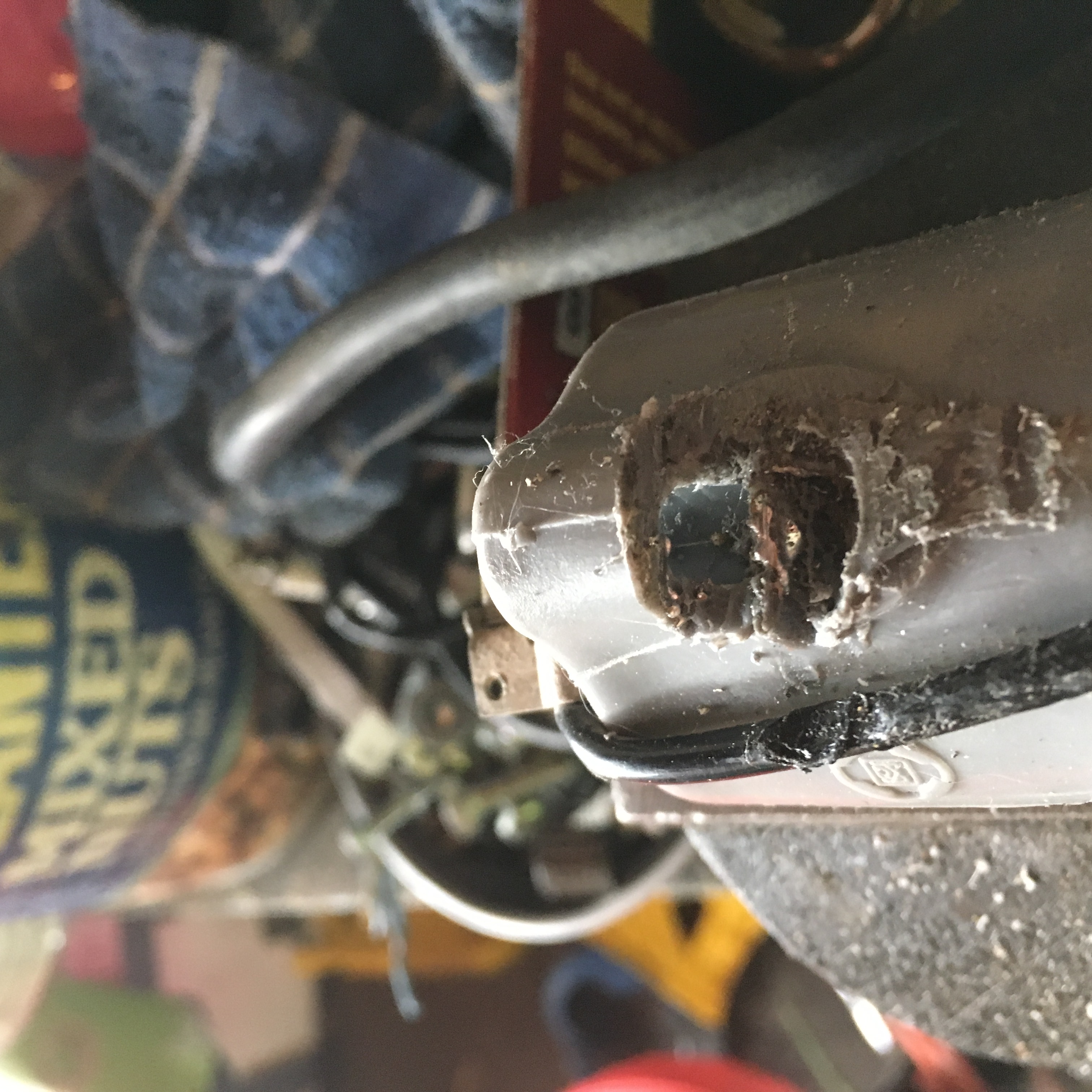

The coil on Albert's "burned up basket case " thread looks like the same coil. Maybe he can tell us about it.
Larry S
Re: The coil on my 98 Rat is dead
all i know at this time is i had to do a little fabricating very easy and i solderer new connections on the wires coming from the magneto and condenser and got a new spark plug cap at the local auto parts store when all was hooked up got a healthy spark out of it, till i get the bike started thats all i can tell you ....albert
