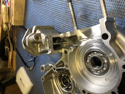

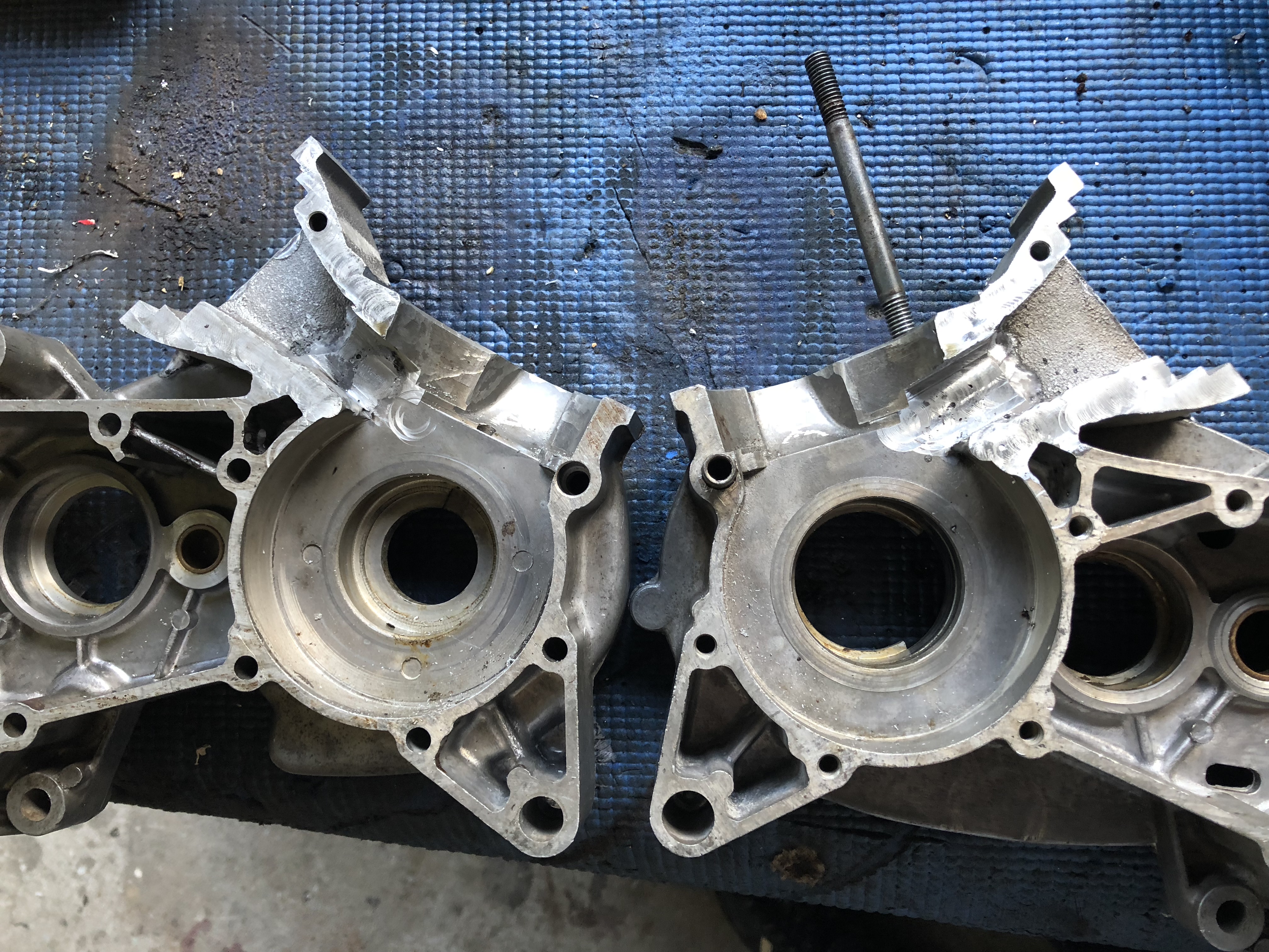

The cases. The first set of cases had the reed block bolted on and during the cleaning up of the cases I lost some too much material so I had to run a center gasket. These new cases have sealed up and passed a leak check with out needing a gasket also having the block welded also reduces leak points and allows the return of a screw location that is lost in the machining process of the inlet passage.

The first design

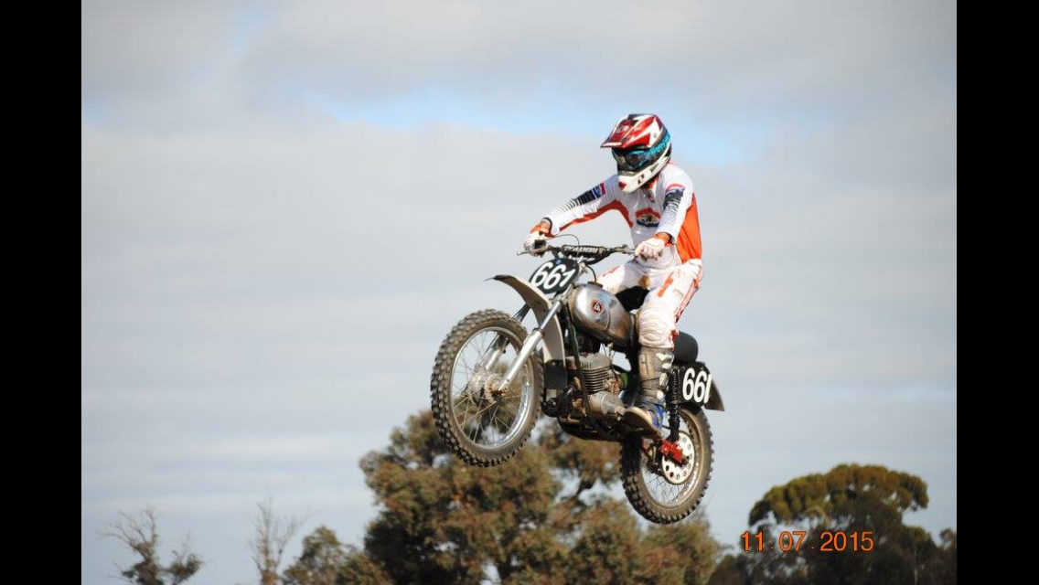

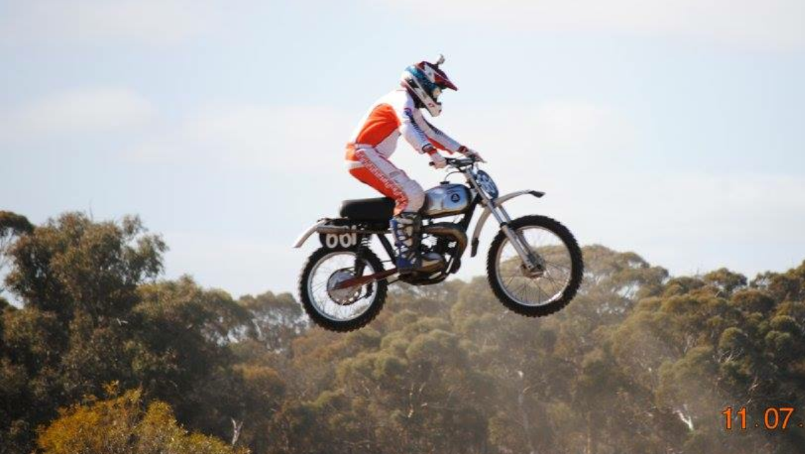

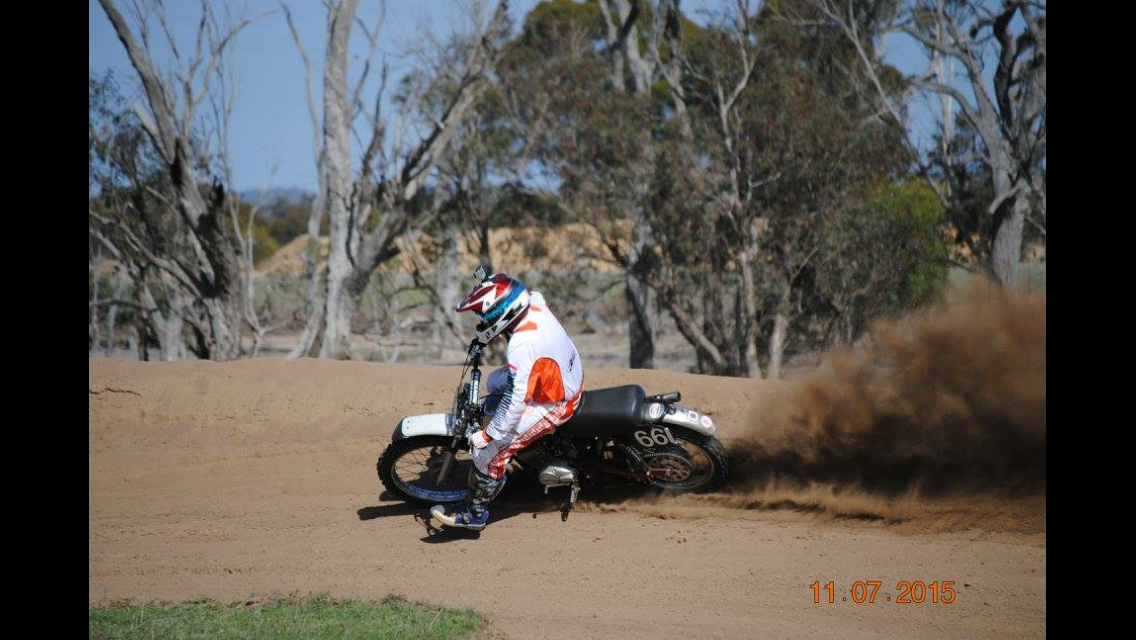

A few pictures from that test day.

This is really great work you're doing. Thanks for sharing. I will be interested to hear how durable the 4-plate clutch pack is with the cushioned hub. Thanks for the tip on the Honda front end. I have an XL-175 front end that I will take a look at. How much did you lengthen the stock 94 swing arm? Did you add any additional gussets or other buttressing to any of the frame components. What spring rate on the shocks? Sorry about all the silly questions. I have a pumped up M94 that I have recently decided to finish off as an open class MX bike. Unfortunately the vast majority of tracks in my district are SX. Tight turn, jump, jump, jump, tight turn, jump, jump. tight turn, rhythm, etc. etc. Less real estate and sells tickets, but would murder a stock 94 frame. Thank you!

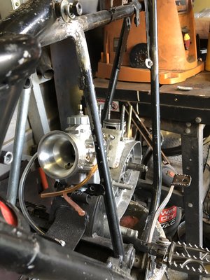

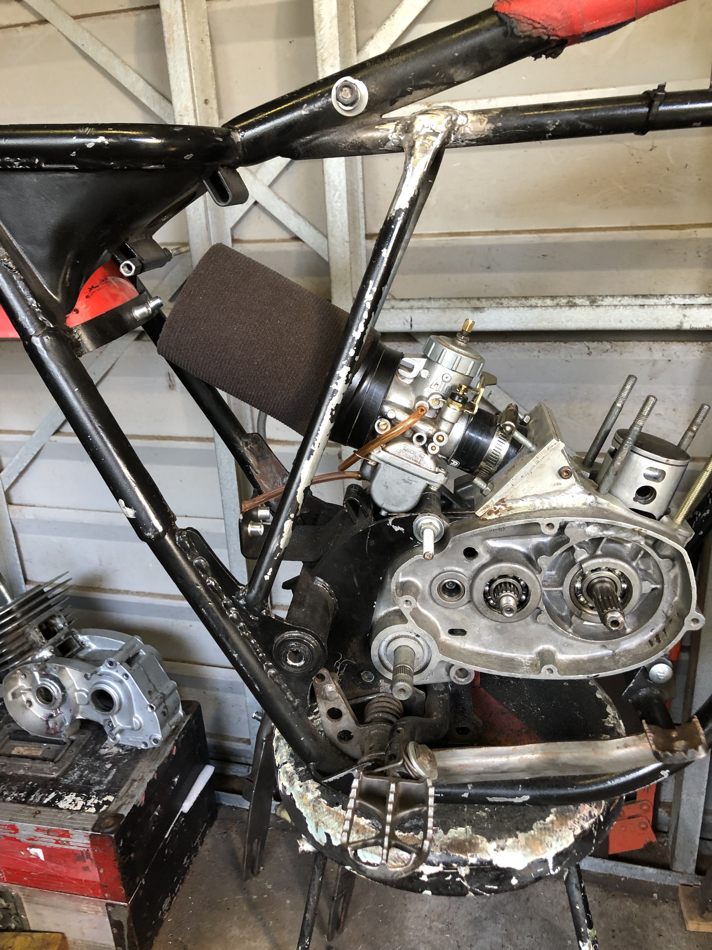

Trial fitting an air filter over a velocity stack. I thought I would create an airbox with a normal filter but I have this pod already. I might put this in a pod and work out how to support the rear of the filter.

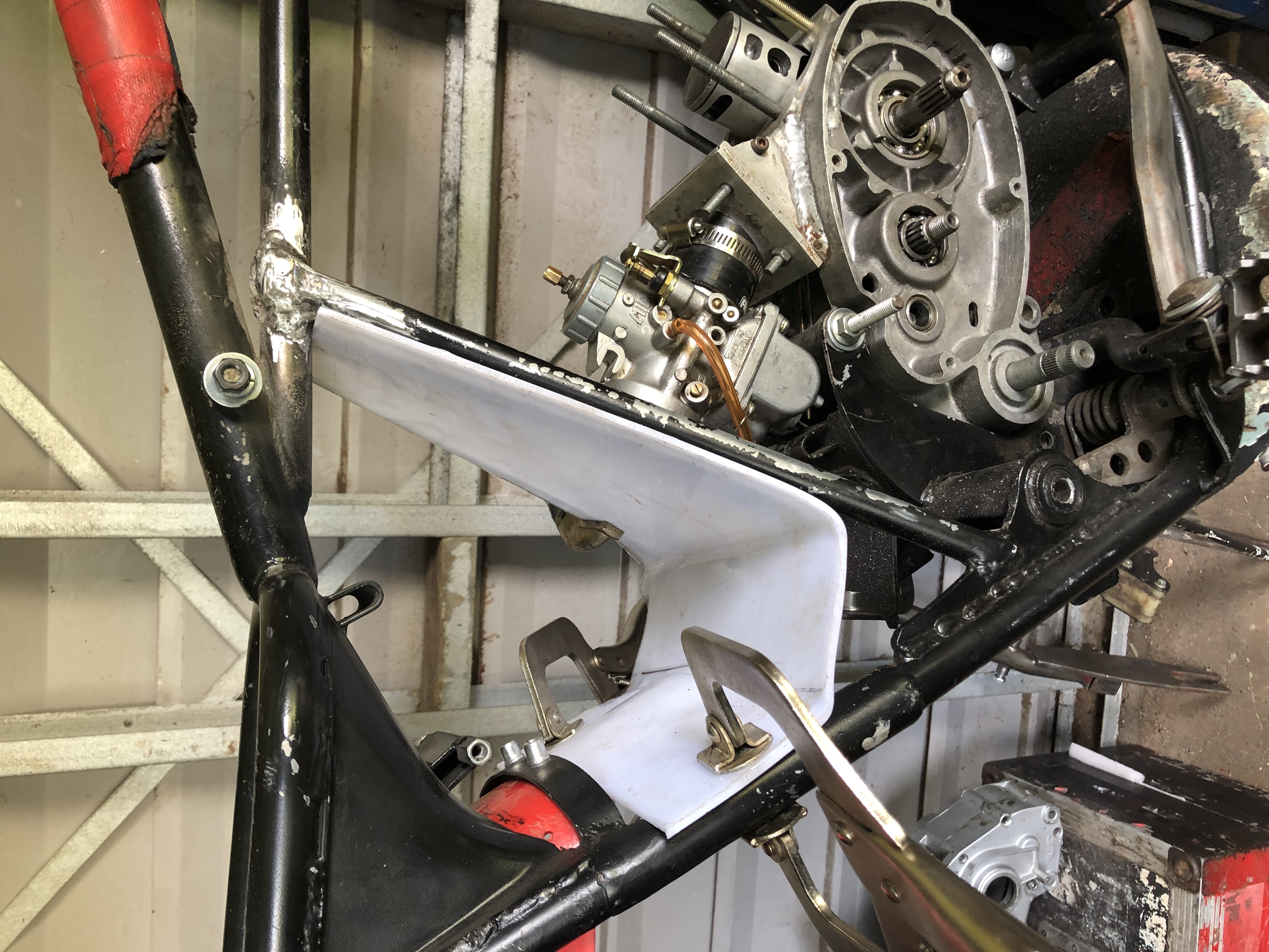

Airbox coming along using plastic sheet and a heat gun.
Re: Case Reed 125 Hodaka Project
Velocity stack!?!!! I love it. I diddled around with one for awhile, but all it had was a little mesh screen for filter which did essentially nothing. Do you think the foam will impede the air acceleration required to achieve laminar flow along the walls of the horn? Then again, who cares - it looks AWESOME. Hopefully you'll get some bonus screamin' reamin' air intake noise. You sir are certainly soldiering on in the highest tradition of Hodaka modifiers. I love it!!!
- Posts: 275
- Location: Australia

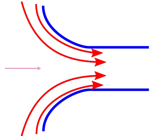

I just think it looks cool. But here is the rub ! I was tempted to buy a longer stack but I read that the shorter length is better for top end. I read that the stacks adjust the resonance of the inlet track but being a reed valve I don’t think that matters because when the reeds shut it stops the resonance through the carby, who knows ? Nobody will know it’s there except me and that will give make me grin a bit on the start line. Actually the Honda CR 250 Elsinore carb to air filter rubber boot is a valocity stack in design but that’s piston port.
- Posts: 2799
It is interesting to think about, "What are differences in air flow dynamics when the air-flow is reciprocating (mostly forward with small steps backward) versus intermittent (forward for a while, then full stop for a while)?"
While I have NO direct experience comparing the performance of a "pod" type filter configuration against a larger "ring" like filter (like the stock Wombat or Super Combat) . . . but I did stay in a Holiday Inn once . . . and I have been coached by tuners I trust that pods are simply more restrictive than larger diameter "rings". The air flow "wants" to come in from the sides . . . and the pod limits that because of its small diameter and the extended length simply doesn't contribute flow - cuz that flow from the outer end would be traveling where the small pink arrow is in the diagram. (Let the debates begin . . .
