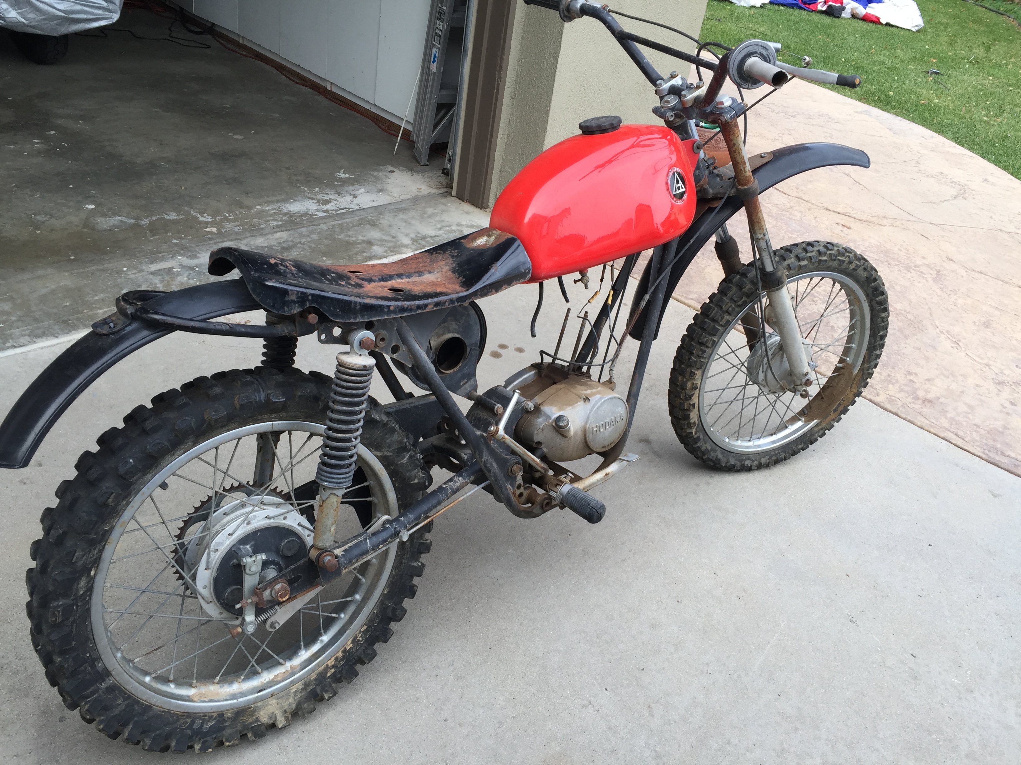

Hello all,
I recently scored my first Hodaka! I have been able to learn so much looking at the forum and using the Strickly Hodaka website. I just wanted to post what I have and get some opinions. Looking at the frame number, I believe it is a 1973 Combat Wombat. I bought the bike with a motor in it, and a motor that is more complete. The motor in the bike is not the correct engine to my knowledge, and the other motor I have I believe is a Wombat engine. I do have a few questions about the bike. I don’t think I have the correct tank, I believe the Wombat and Combat Wombat has a chrome gastank. Also, the Wombat engine has black covers on the side of the engine and I have not seen a Wombat engine with these color covers. Lastly, there is a broken piece on the bottom of the cylinder and I am wondering if this can be repaired? I would appreciate any feedback and advice. Thank you for your time!

Re: New Member Wombat Project
Welcome to the Hodaka community! Your bike looks like a model 94 125 Wombat. What is the frame number? The Combat Wombat will start with a D. Judging by the stator and longish cylinder studs I would say the engine in the frame is a cast iron cylinder 100, either Ace or Dirt Squirt.

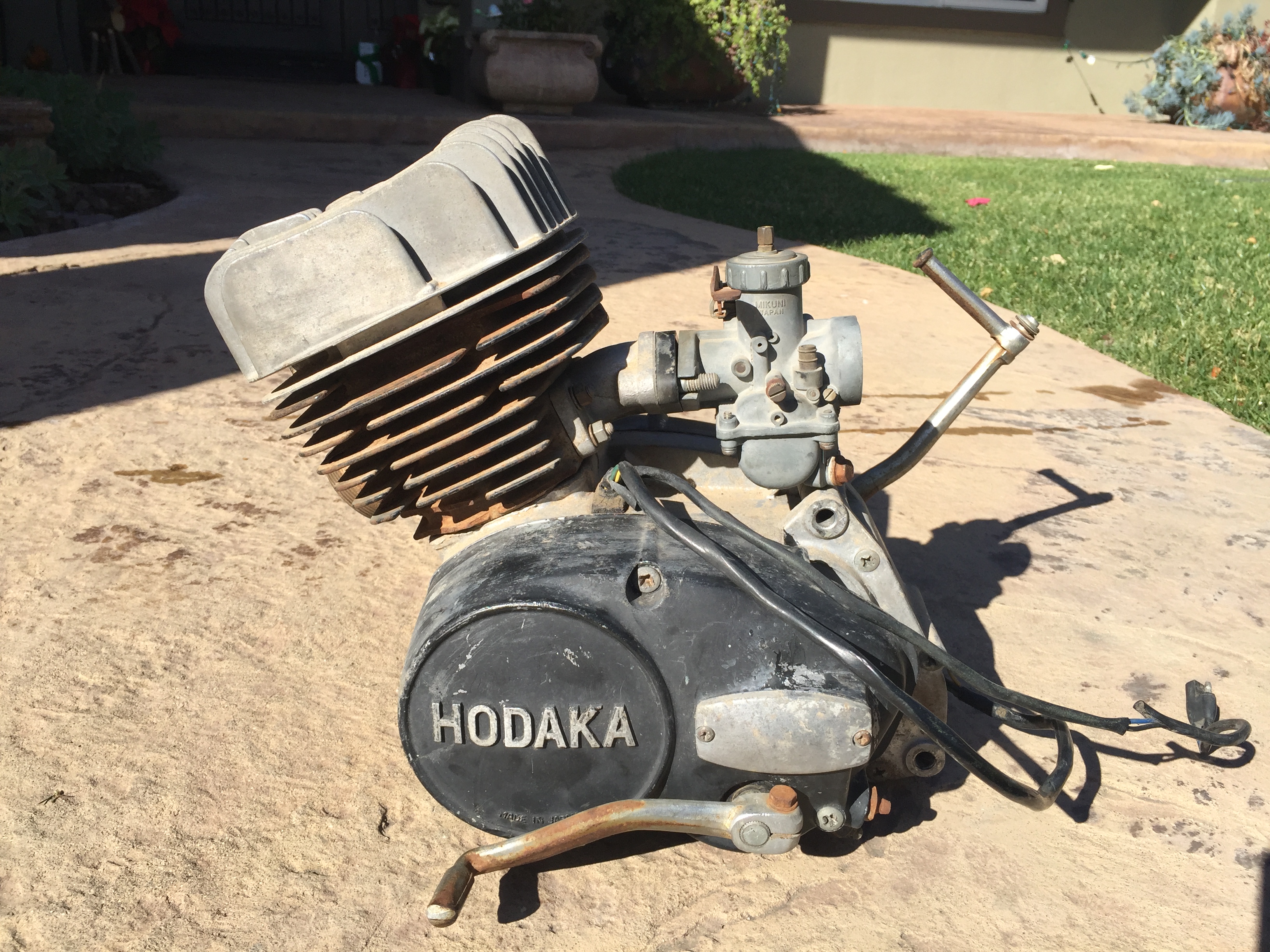

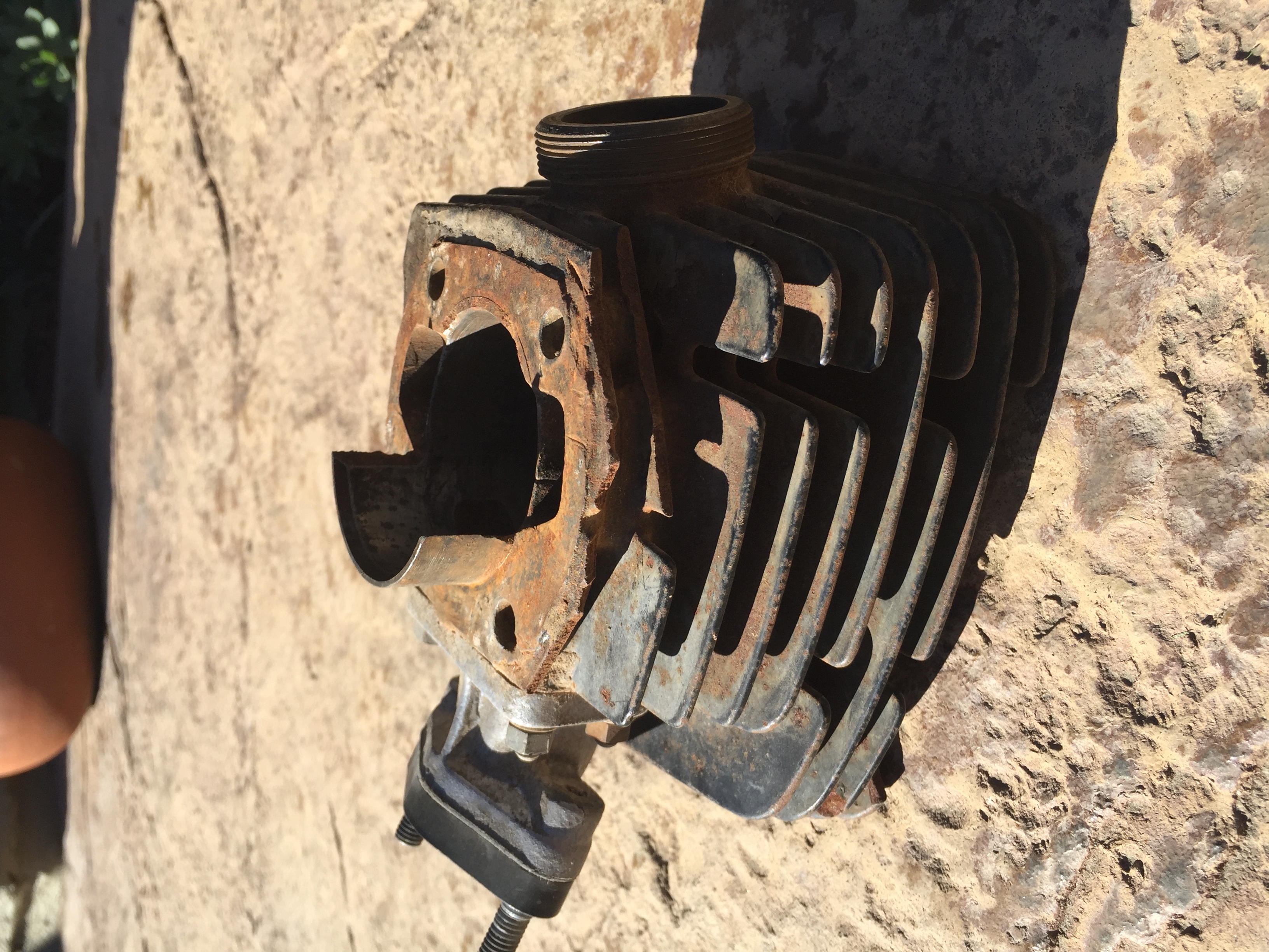

The spare engines you have are a model 96 Dirt Squirt and a model 94 Wombat. The broken cylinder could possibly be repaired, but in my opinion you are far better off looking for a good used one.

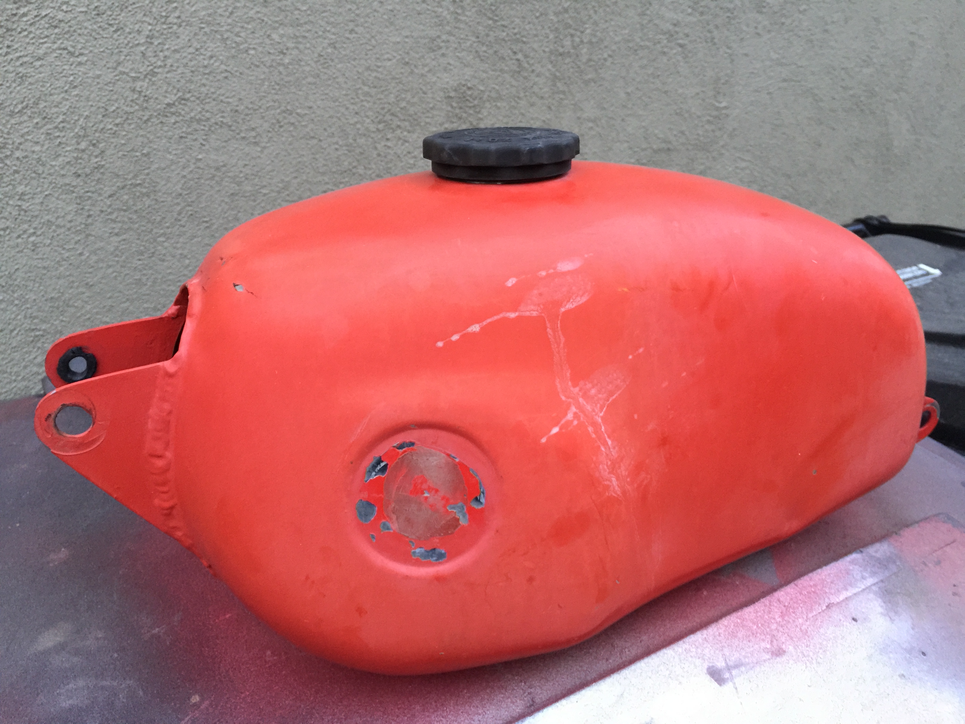

As you suspect. the black engine is not stock. Someone has been painted them at some point. The same goes with the gas tank. You should find chrome under the paint.
Welcome aboard!! You have a cool project ahead. You have a tangible example of one of the cool and unique features of the Hodaka concept - parts interchangeability. The P motor originated on one of the Ace series bikes including the chrome tank Dirt Squirts. The H motor came off a M94 or 94a Wombat. The damage extending onto the gasket sealing area is concerning for salvageability of your 123cc cylinder but there are some true wizards that have a steady presence on this site that can just about fix anything who may have another opinion. The tank looks to be from a late model Dirt Squirt and looks to be in excellent condition. It may be a M95 chrome tank that has been painted. The engine cases were probably just painted black. You didn't cite the frame number but I suspect it to be a M94/94a Wombat seeing as how you have a Wombat air box and motor. You can tell right now by looking at the steering head plate. It it says its street legal, it is a Wombat. If it says off road competition only, it is a Combat Wombat frame. There is a frame and engine identifying index on the Strictly Hodaka website for sure and maybe on the sites of HPI and Hodaka Parts as well. Depending on what the base gasket area of your Wombat motor look like, it may be fine for a rebuild. Your best move at this time is to undertake a complete disassembly of the bike down to the nut and bold level followed by a thorough cleaning, inventorying, identifying and frame inspection. Take careful notes, preferably with accompanying photos to assist with the rebuild. Get yourself an official Hodaka Wombat Workshop manual - its an absolute necessity. You'll have superb support every step of the way with the folks who contribute to this forum - I sure have! Also, there is an excellent network of parts houses that support our efforts to keep these insanely cool bikes alive. Try finding all that support for your Jawa, CZ, Monark, Rokon, etc. etc. etc. Most importantly, HAVE FUN!. Remember, its a "BOOGIE MACHINE"!
A couple more observations:
The front forks are non-stock and they don't appear to be late model Hodaka forks either. It would be interesting to know what they are from and what size the tubes are.
The rubber foot pegs are non-stock and are from an Ace or Super Rat. You Wombat should have steel cleated pegs.
The rear brake backing plate is off a later Hodaka, possibly a Road Toad. It has the nice feature of inspection plugs that allow you to check the brake linings.

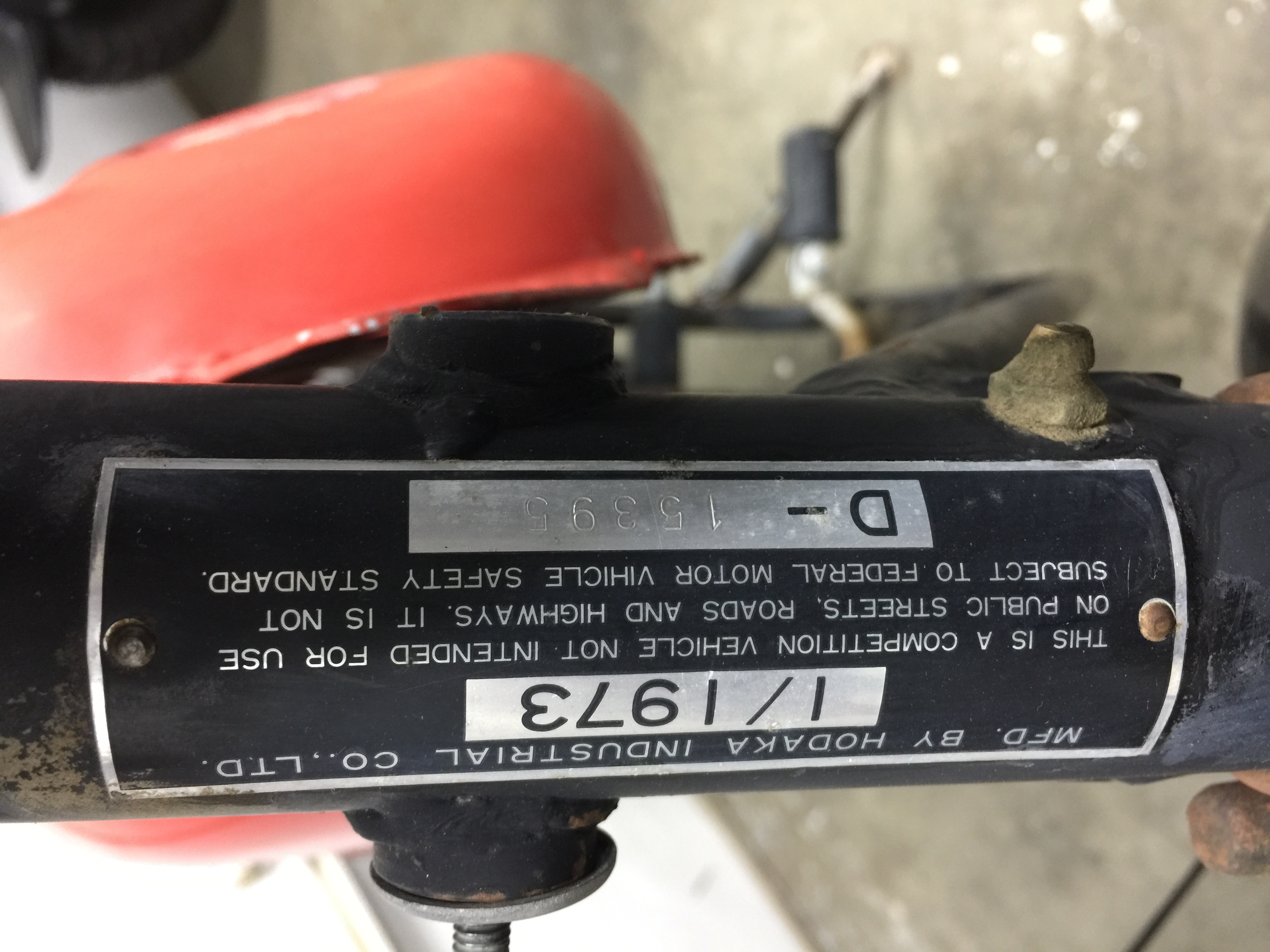

Looks like the frame is a 1973 Combat Wombat! It’s a D15XXX frame number! I could see the frame number in the VIN tag from the picture showing the left side of the bike! Congrats on the find!!!
Check your motors for a case serial number starting with a “J.” That would be the correct motor for it.

I don't believe your cylinder is repairable. The broken off part is called the "spigot". It serves double duty. It "centers" the cylinder on the cases AND the skirt of the piston travels all the way down to a point even with the bottom of the spigot so it is an important part of the cylinder wall. I don't believe there is any reasonable way to weld a replacement piece of matching cast iron in place to return the cylinder to service. In addition, it looks like there is a crack in the cylinder wall at the base of the transfer passage. So, I'd have to say you have an interesting paper weight. The photo also shows where to look to find cylinder displacement information on Hodaka cylinders. It seems pretty sure you will find a designation of 98cc on this cylinder.

Good eye Victor, that does look like a "D" in the frame number. It doesn't look like there is too much of the Combat Wombat left though. The rims look like chrome plated Wombat items and the front brake backing plate has holes for the brake light switch.

Ed. If you check the other photo of the broken spigot, you’ll see the cylinder is marked 123cc. Too bad too!!! Victor

So here is some information which may cheer you up. The Combat Wombat frame is EXACTLY the same as the Model 94 Wombat frame AND the Model 96 Dirt Squirt frame (except for some misc. bracketry). The model 96 100cc Dirt Squirt (like the one in my garage) may well be the funnest fun bike I own! Note that lots of guys started out with factory stock Hodies and ended up with machines like yours with bits and pieces from several other Hodie models.
On looking at the photos more closely, the biggest problem I see is the forks. I'm not sure the two legs are the same. The leg I can see has an alloy slider . . . but isn't from a Hodie. The other slider doesn't appear to match . . . so I'm not sure what you have there.
You'll need to do some thinkin' to decide whether you want to re-build one of the engine "cores" you have (100cc iron cylinder) - or start searching for a Wombat/Combat Wombat "core" to re-build and install.

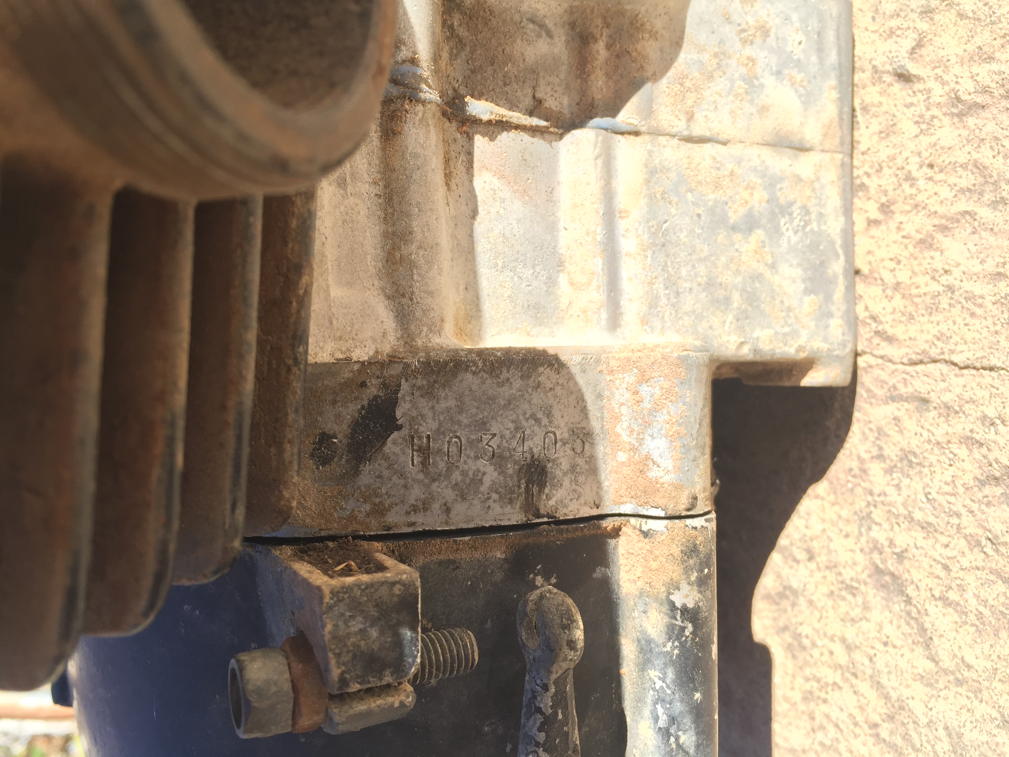

So Mitchell, the engine "bottom end" with the 6mm dia. cylinder studs (I think) appears to be a 100cc "core". If the studs are 6mm, then the engine is 100cc and can be re-built with a 100cc iron cylinder. If the complete engine with the black clutch cover is a 125cc engine . . . then you are well started with either engine size!
- Posts: 2784
DOH! . . . and the "H" on the engine serial number makes it a 125.

Thank you so much everyone for the valuable information!! I have attached a picture of the frame number and I do believe it is a Combat Wombat Frame. I would like to build the 125cc motor, although I think it would be best to get a new cylinder. I will have to take a closer look at the forks later. I could even post a few more pictures of them. If anyone is selling a 125cc cylinder let me know! Thanks again everyone!

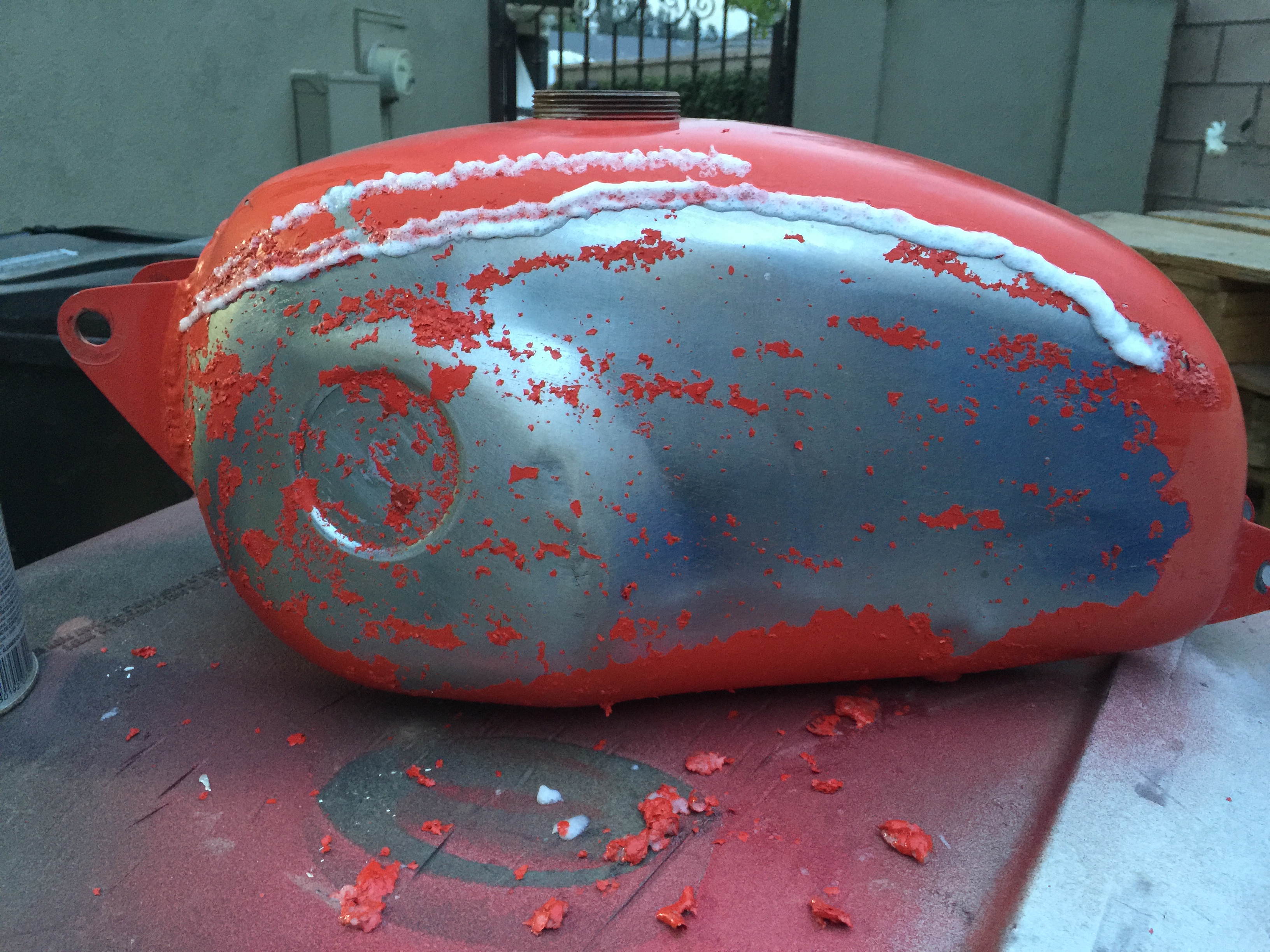

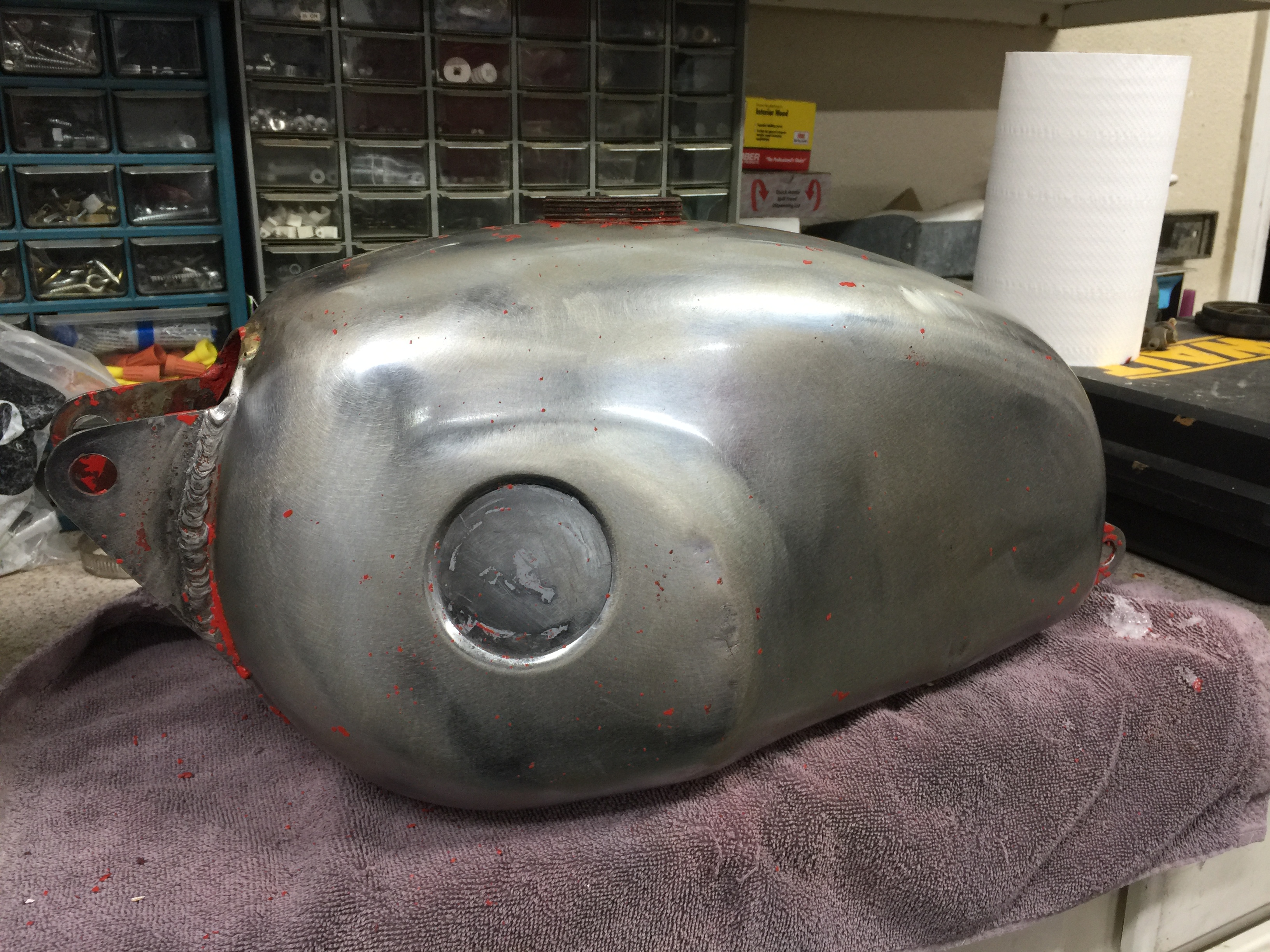

Tonight I started to work on the gas tank. I used some paint stripper and it worked quite well! I was glad to see the chrome underneath the red paint! The tank was scuffed up a little in order for the red paint to stick to it, so I may try to polish it or get it chromed again. I know there is still some paint left on the tank, I ran out of paint thinner

Mitchell, there's some sage advice from some really great guys. Regarding your tank, two things. First, how cool the tank was preserved by leaving it full of fuel. That will all clean out leaving you a pristine tank. Secondly, from what I can see, that tank should polish out beautifully. A decent drill mounted buffing wheel and polishing compound set will run you about $20 at Harbor Freight and I'd bet that with a little time and elbow grease, you could get mighty close to a show chrome finish on that baby.
