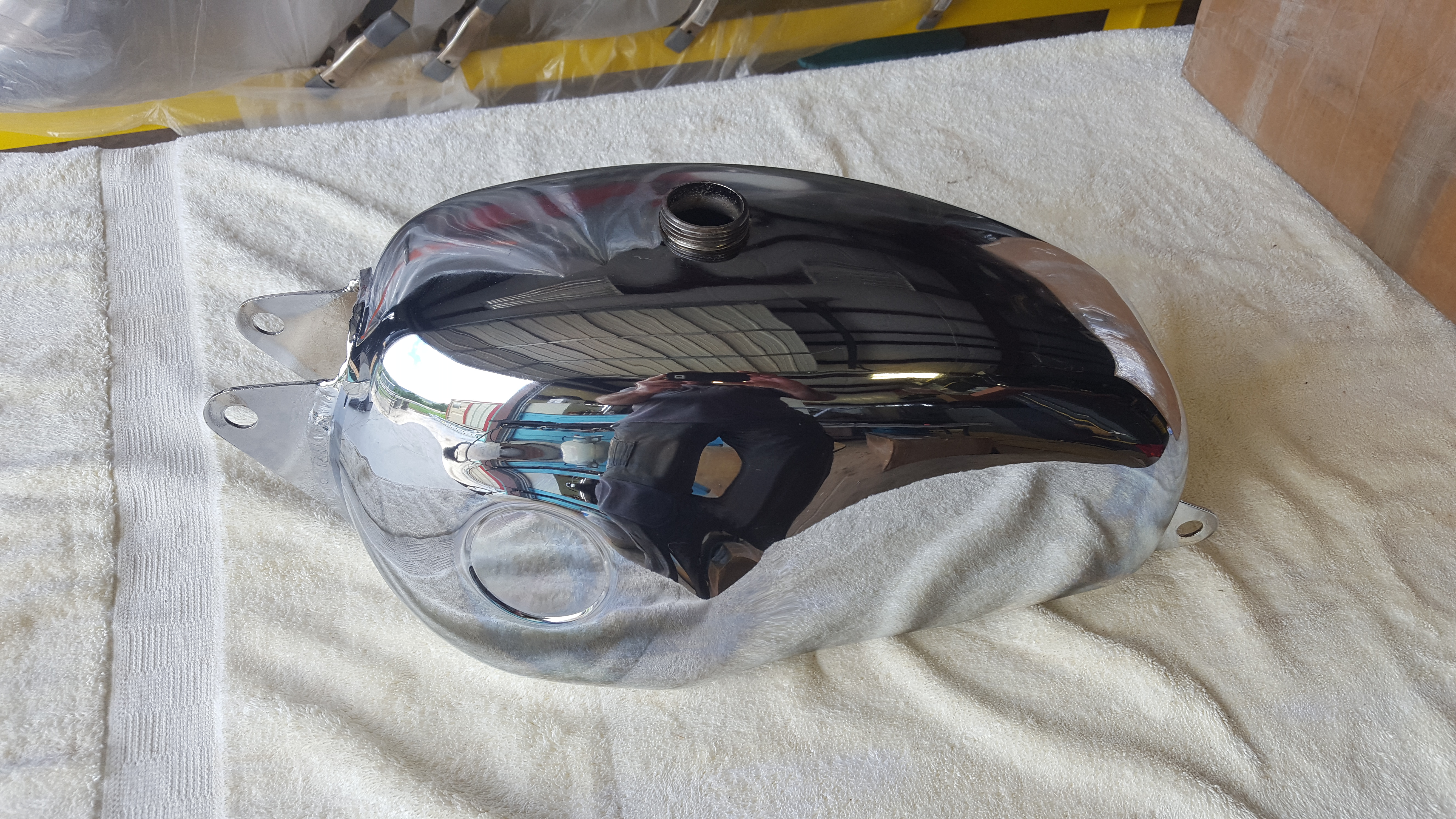

Here is the second tank that Daniel Gromm at dent dynamics repaired for me and then Salt Lake chrome rechromed for me. Another beauty!. I think I will coat it inside with Caswell gas tank epoxy. I have used that stuff several times now and it has worked very well for me.

No signs of any dents, Gromm is a master craftsman, he must have the patience of Jobe. Kevin Williams at Salt Lake chrome is a master plater also. Cost me $200.00 for the rechroming. That's a steal compared to what I was paying in Houston, Texas before I found out about Salt Lake chrome. KC Titze from Eugene, Oregon recommended Salt Lake Chrome to me.

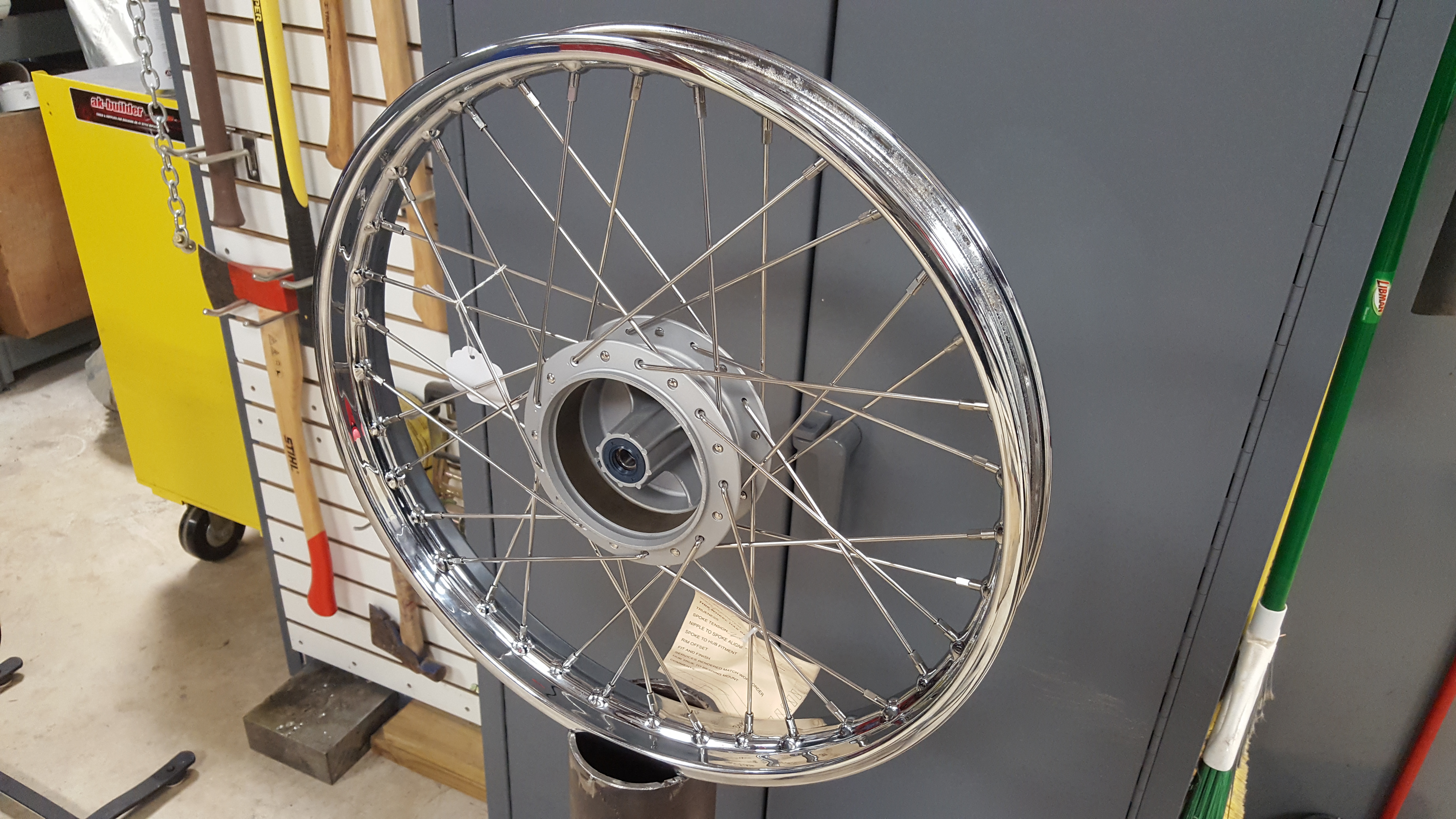

I just got in a set of wheels from Buchanans spoke and rim in Azusa, California. They installed polished stainless spokes and laced it all up. The rims Salt Lake Chrome in Salt Lake City had done previously. That's a little bit more shine than when they came from the factory but what the heck. They are just lovely. Zoom up

Here are some wheels that just came in from Buchanans Spoke and Rim in Azusa, CA. They are for number two. They have polished stainless spokes, and nipples rather than zinc plated. If they ever need repolishing, its easy to do. Never will rust either. The hubs are painted with Mr. Pauls Hodaka grey that he sells. The rims were rechromed by Salt Lake Chrome. Everything has come out very nicely with these. I have a nitto NOS knobby tire for the front and an NOS 3.25 x 18 Barum for the rear. There are two pics for each wheel. Zoom the pics to see them better. Thanks Gentlemen
