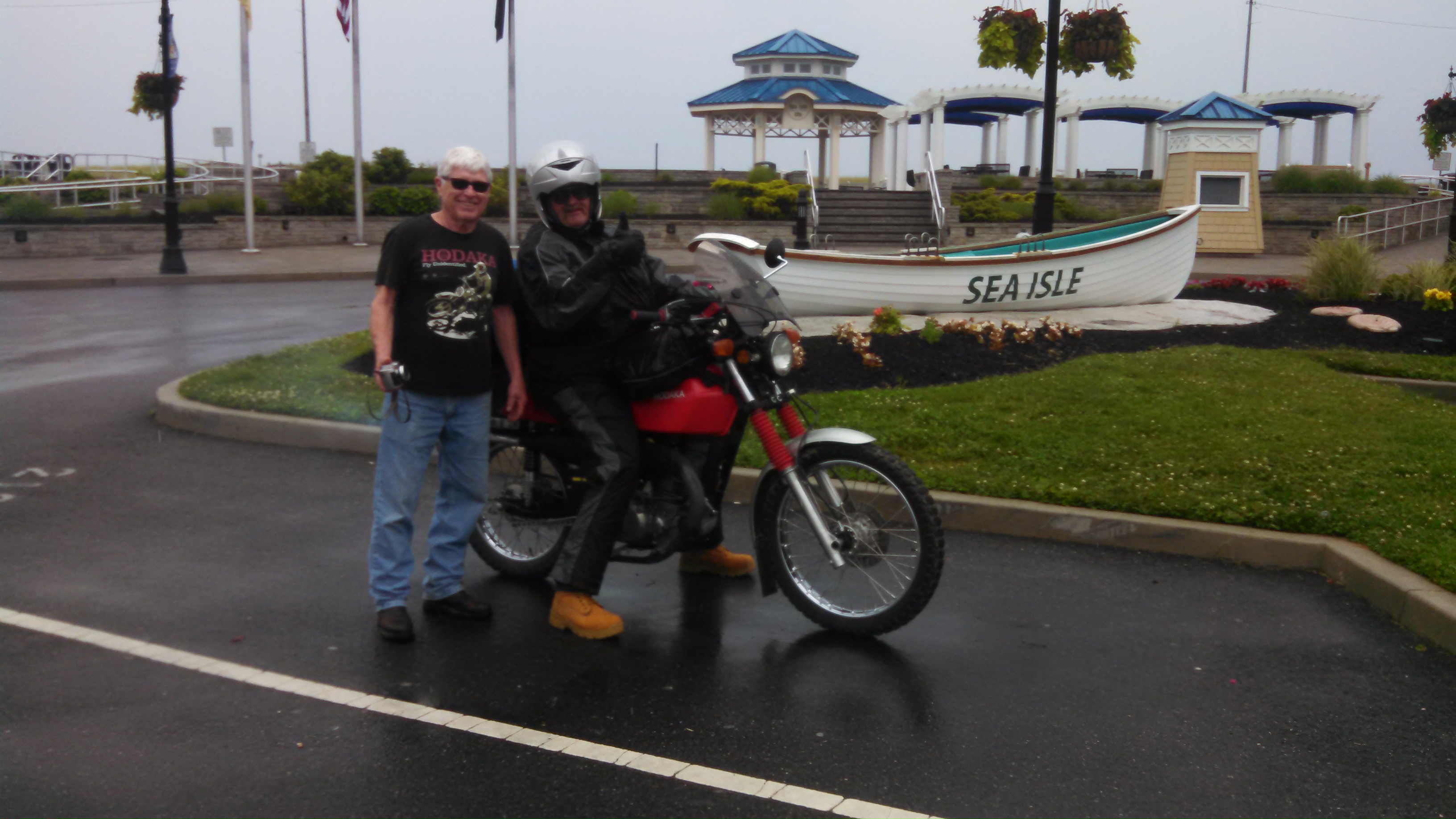

He will leave Ocean View (Sea Isle City) New Jersey, Tuesday morning June 6th (D-Day). He plans to cover about 300 miles per day staying on “The Lincoln Highway” as much as possible.

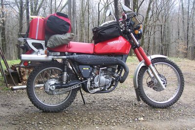

Photos of Mike’s Hodaka will be posted. It is a very nice upgrade.
Mike Perrett “Lincoln Highway” 250 SL modifications.
Honda XL 15 tooth counter shaft sprocket. Yamaha YZ 125 40 tooth rear sprocket
Honda 250SX tool box. Baldwin air filter element
Many steel parts replace with aluminum,
Strictly Hodaka improved kick starter shaft
250 ED swing arm
ED shocks with aluminum preload spacers. ED "yellow" 150 lb. springs
KTM silencer/spark arrestor
Preston Petty rear fender and taillight
BMW aftermarket rear luggage rack
1972 Suzuki TM 250 cylinder head
Suzuki TS 250 mag coils
Cobra windshield
Yamaha rear view mirror
Yamaha XT turn signals. Yamaha XT instruments. Yamaha XT headlight
Automotive H5006 sealed beam. 6 volt to 12 volt conversion. Kawasaki headlight switch
Bronze swing arm bushings with stainless steel 20 mm pin
Jake brake
Yamaha YZ chain guide
Honda CR 125 shift lever
Transfer ports raised 2 mm
Piston intake skirt shortened 2mm
Timing set at 24 degrees BTDC
Yamaha petcock with reserve
Moose 12 volt voltage regulator
Motobat 12 volt battery
2008 Kawasaki KLR front end with disc brake
Bridgestone Trail Wing tires
Honda CBX front fender

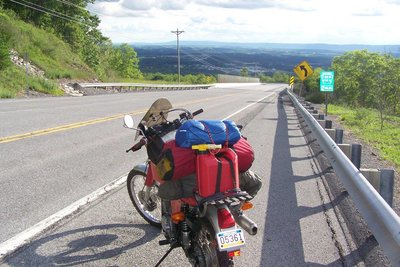

Mike called last night. He was in Bedford PA. He will spend the night in Shawnee State Park. He had a bit of a concern when he was unable to get into 5th gear. Turns out one of his plastic bags got pulled into his chain and clogged his shifter mechanism. Here is where he is as of 6 PM last night.
https://www.google.com/.../data=!4m5!3m4...
Mike will be following the old Lincoln Highway which in most cases is US route 30.

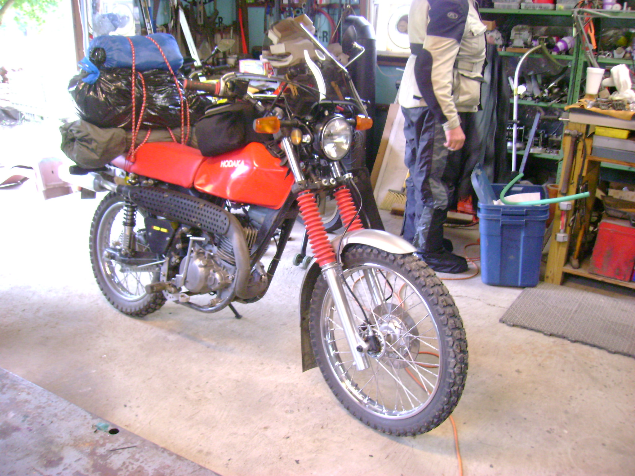

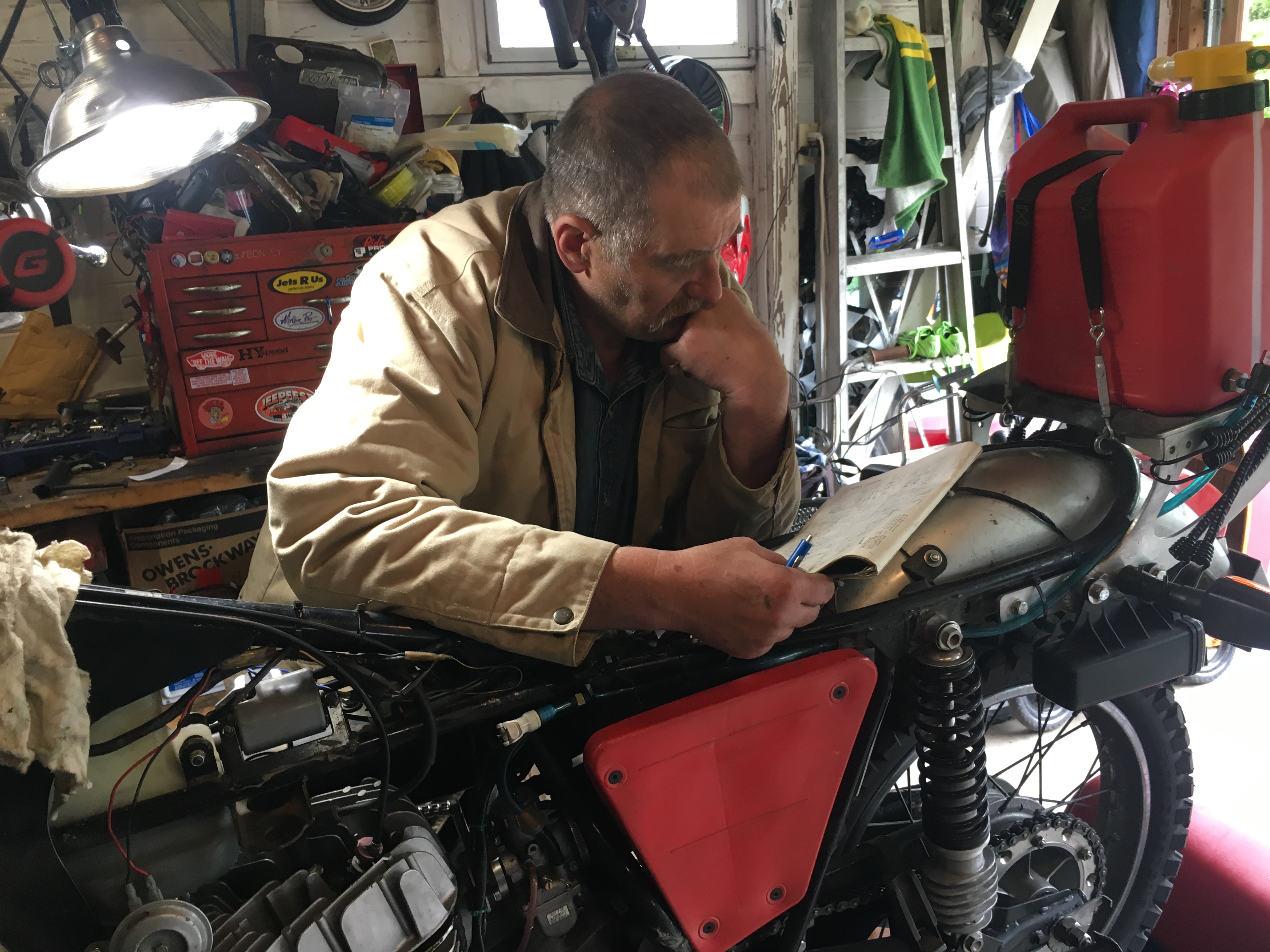

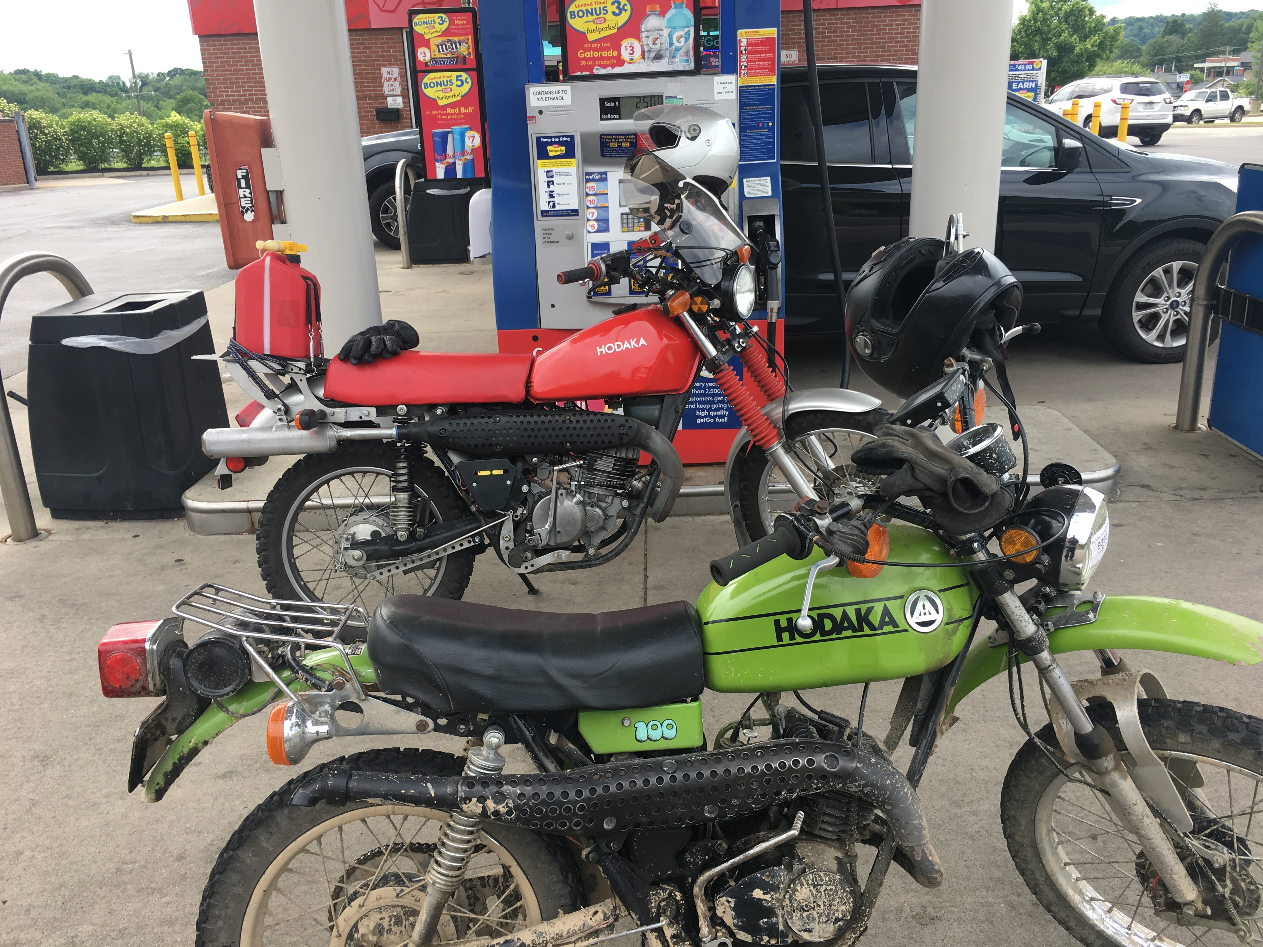

Jake sent in some photos from Mike's camera on his way to Finleyville and Jake's garage (I think). Also his campsite In Shawnee State Park

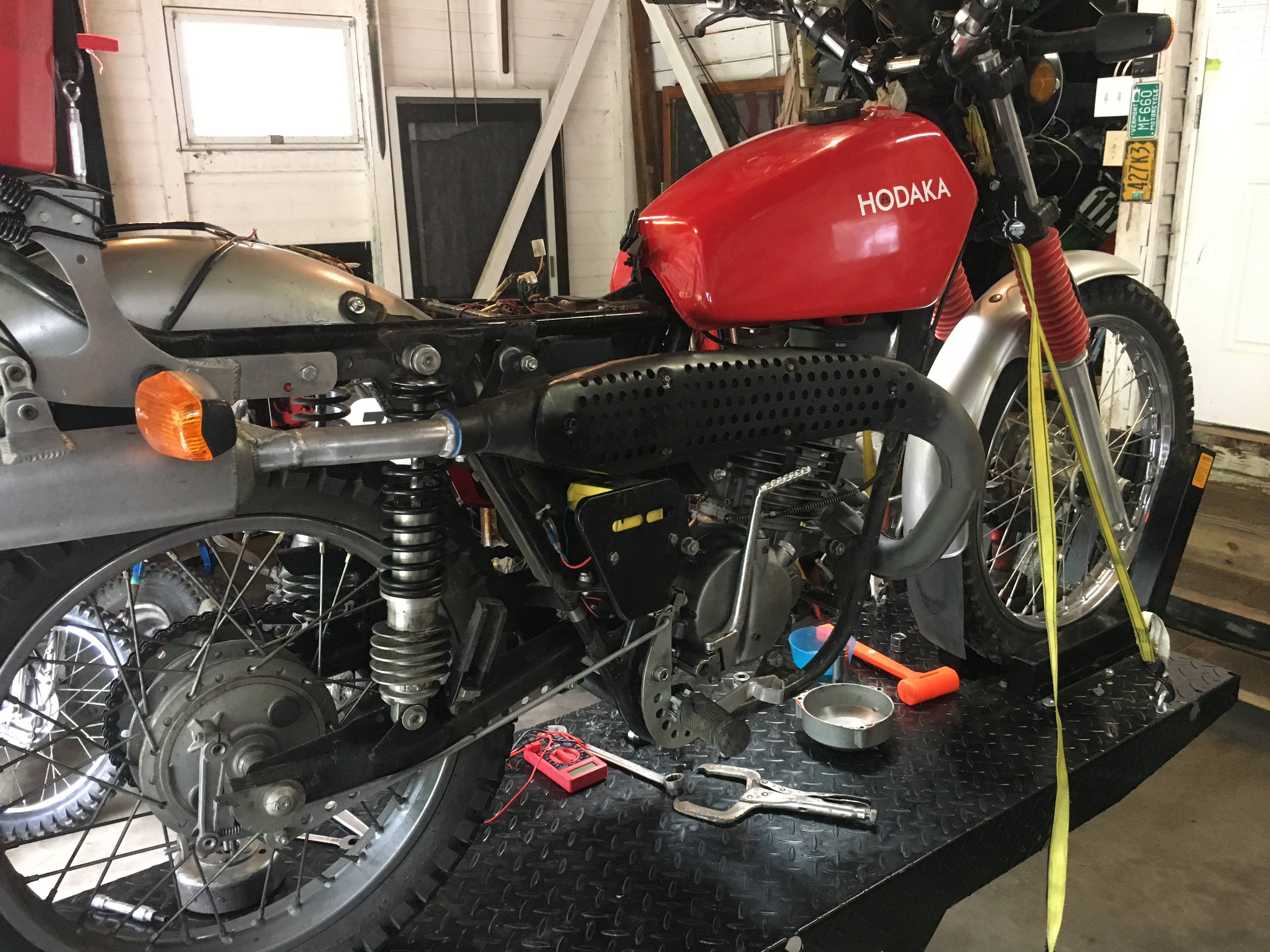

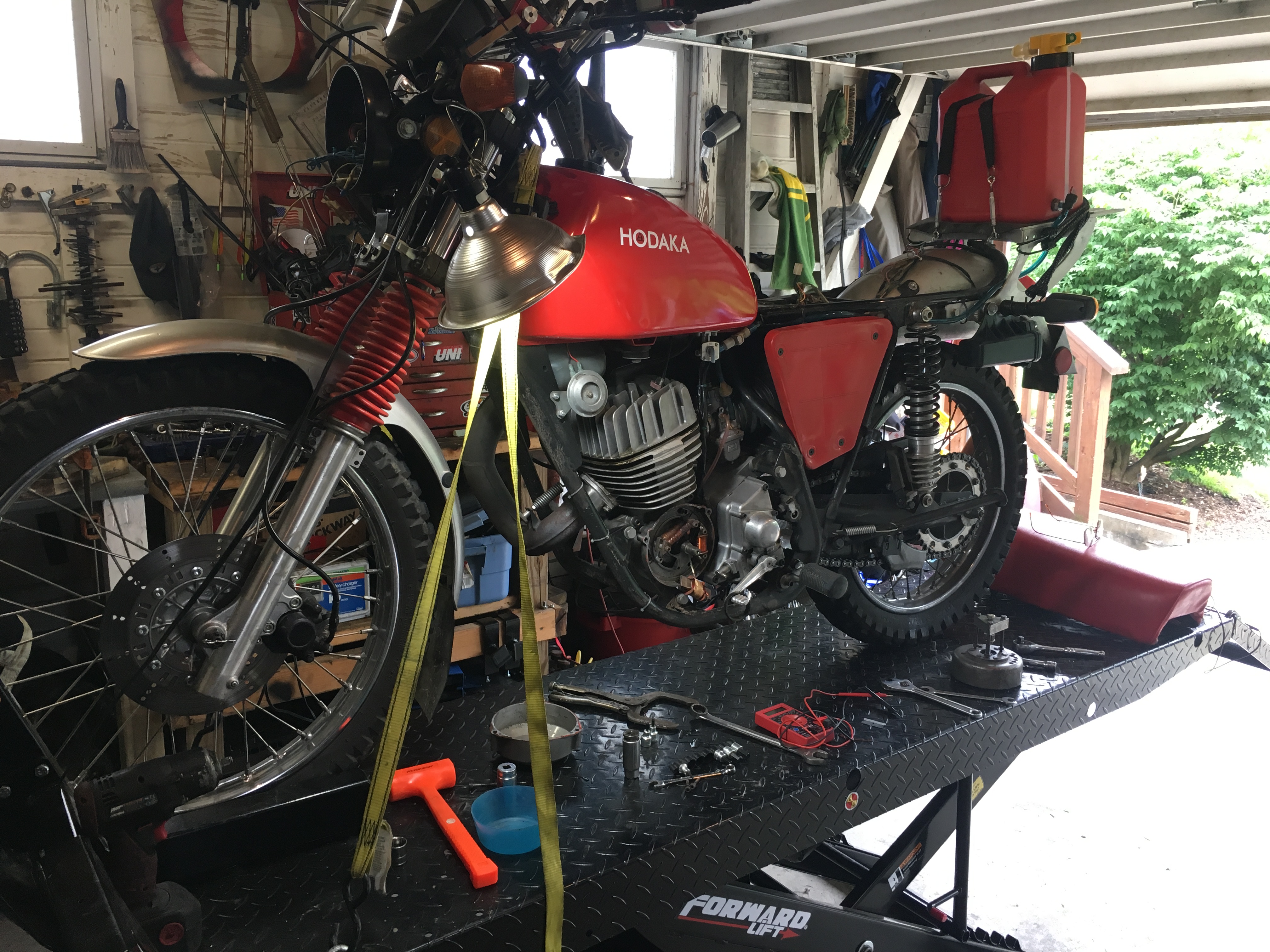

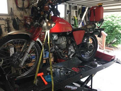

Hey Rick, I'm not sure where that pic is from. I am gonna post a couple pics from my phone that I took today. The first pic is from the test ride, and the others are from my garage at my house.
We swapped out his stator with mine, cleaned a bunch of connections, and checked a bunch of wires. It was a good time. Mike sure is diligent when it comes to electrical diagnosing. I learned a lot. We went for a test ride and Mike filled up his fuel tanks, his headlight worked flawlessly.

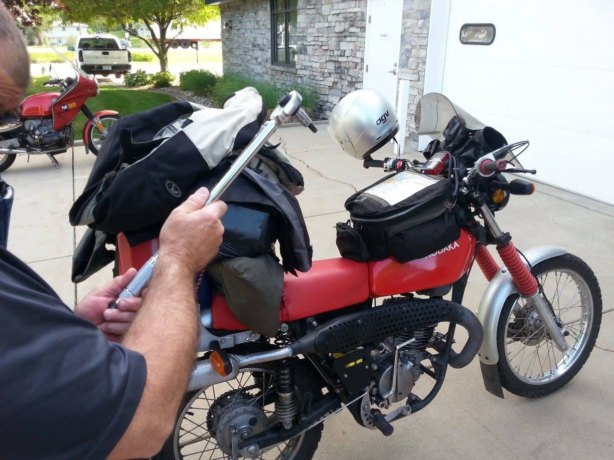

From Mark Eichhorn:
Met up with Mike in Valparaiso IN at fellow Hodakaholic Steve's shop. Went for breakfast, then did some maintenance on the 250. Battery testing was giving mixed results so Mike decided to try a new battery. He also found a bad connection to the rectifier, so we're hoping those two issues will cure the problem. Mike retorqued the head bolts on the custom cylinder head, and headed down IN 2 towards Illinois. Looking good Mike!
