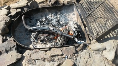

I am planning to cook an 01 Dirt Squirt pipe in the next few days. I will post some pictures. It is just as Roger explained, but the pictures are always a little funny to see.

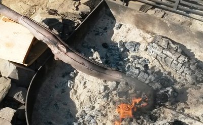

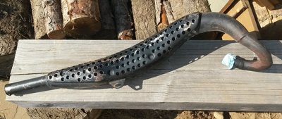

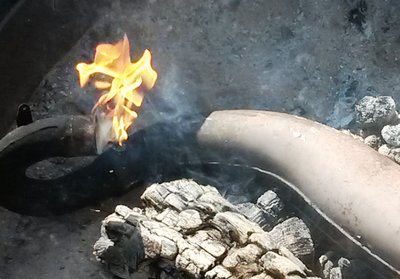

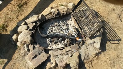

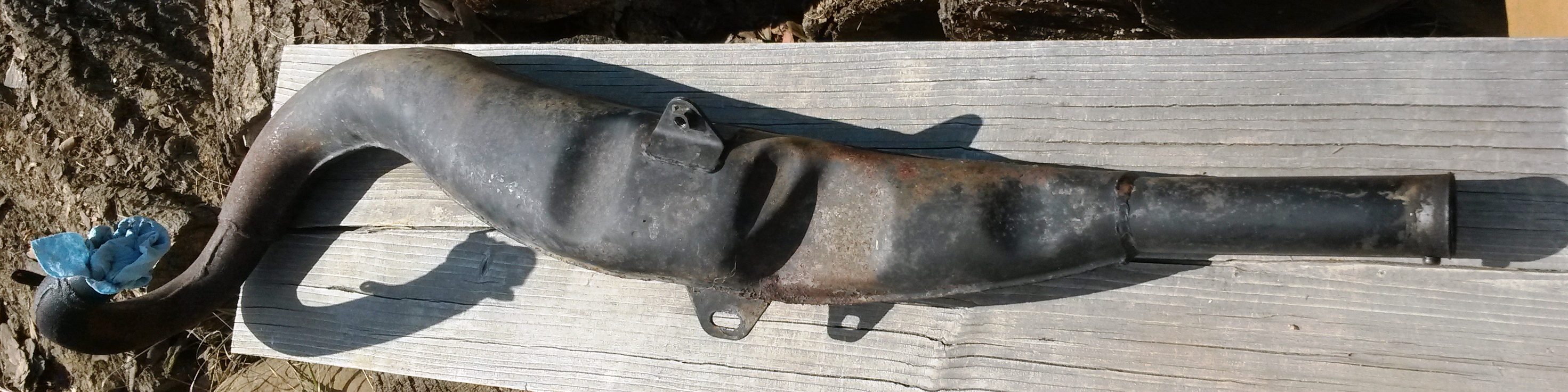

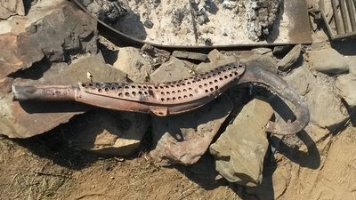

Had a little time today to burn out a Dirt Squirt pipe. I spent about 1 hour start to finish. I will now clean it, do a little sanding and it will be ready for some paint.
Before
Before
Into the fire pit with a bed of hot coals
Flames soon appear at one end
then flames at both ends
Flames burn out but it continues to spew smoke for 5-10 minutes
Still an occasional burst of flames
Rotated the pipe to make sure that all surfaces are burned clean
After all flames and smoking are finished, pipe is set out to cool off
Re: Mdl 94 Wombat Rebuild
Ah, thanks Dale, it looks to be pretty straightforward. I'm gathering sticks for the procedure now that you have bolstered my confidence! ;)
