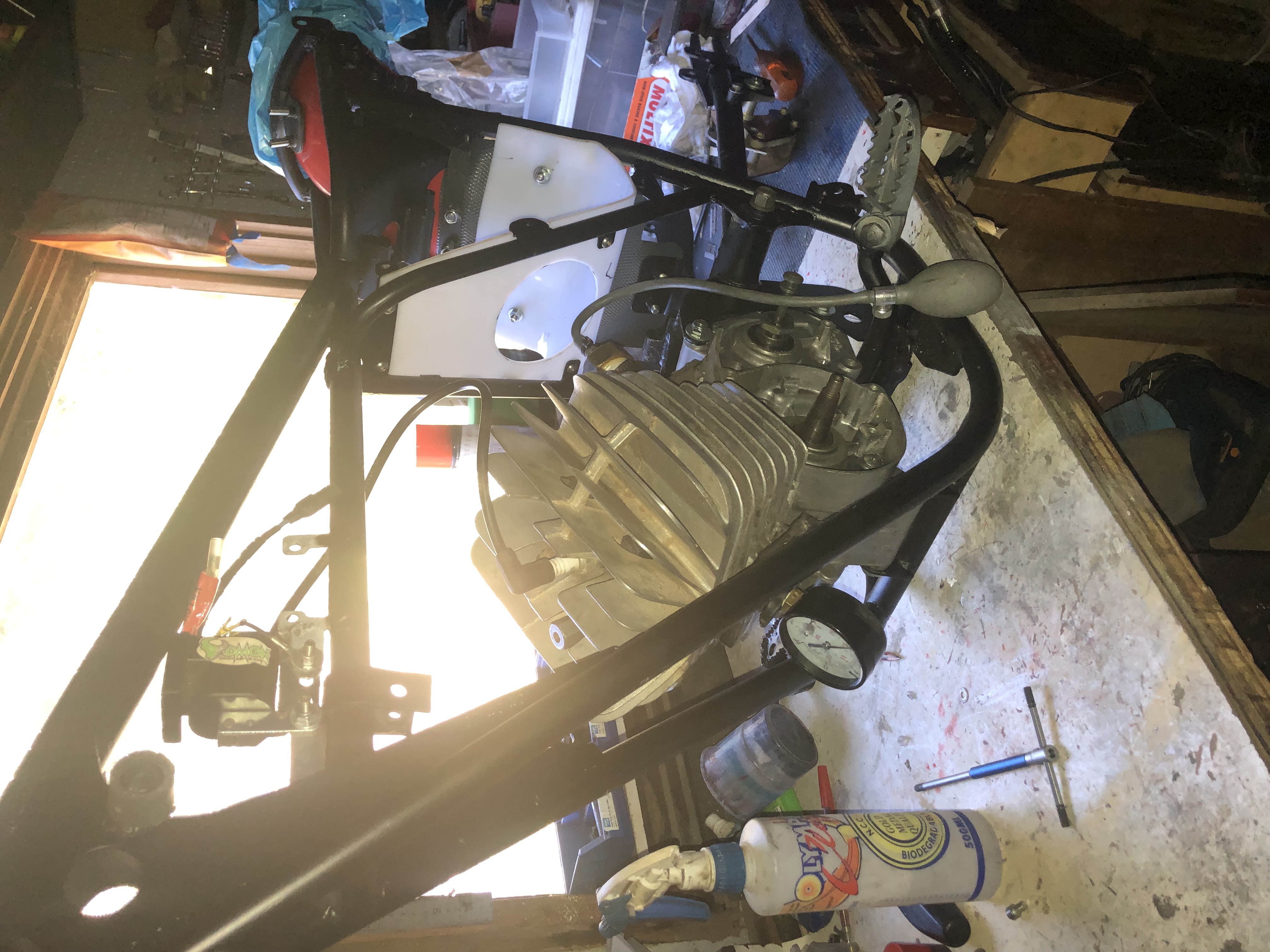

Another mile stone
Air leak test passed.

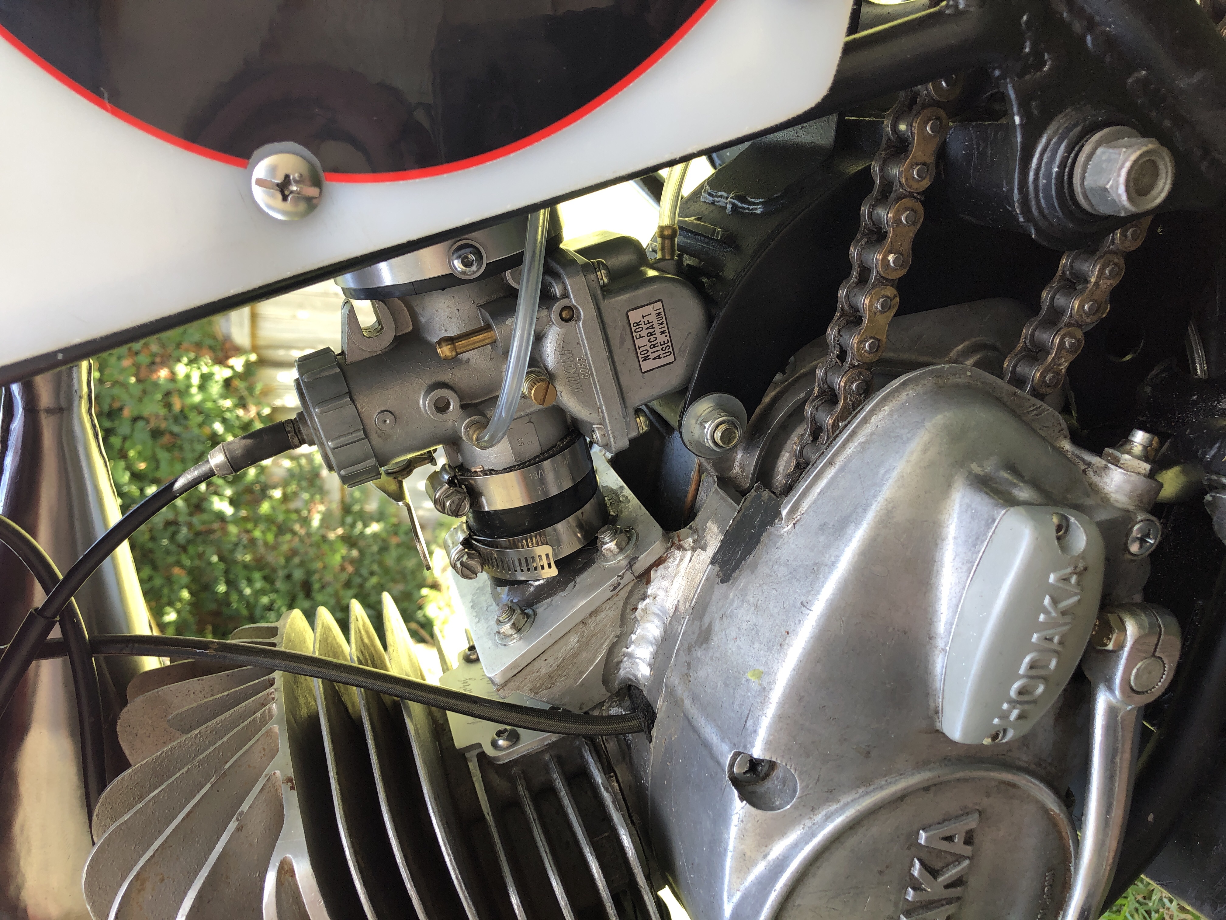

Ooh- I'm loving the progress, Third. I have a quick question. From what I recall, the maximum allowable fore/aft inclination for the Mik is 20 degrees before you start to impede maintenance of proper fuel level in the float bowl. My spectacularly inaccurate eyeball compass puts yours at 30ish. Here's what I know. Your bike is going to drink like a fish. Now the question - are you concerned about maintaining proper fuel height in the float bowl at that angle to feed the motor? I know there is the possibility of tweeking the float tab to allow maintaining a more appropriate fuel availability, but that sounds a bit fiddly to me. I would question whether an angled shim used to trim out some of the carby angulation might interfere with the flow dynamics of the intake track on a motor that is really going to gulp. I'd be really interested in hearing your thoughts on this matter when you get minute. Great work!!!
Posts: 2799
Re: Case Reed 125 Hodaka Project
;) A mixed "serious and semi-serious" set of comments follows . . .
1. I've seen some equally steep (by visual guesstimation) carb installations which seemed to work out fine, so testing as is would seem appropriate.
2. This machine is going to spend a large amount of its time on the track waving the front wheel in the air (which reduces the "steepness" of the carb angle) . . . :o
. . . waiting to hear how it goes.
thirdstone
Posts: 275
Joined: Thu Nov 07, 2013 9:28 pm
Location: Australia
Post by thirdstone »
Haha you are both right. Matt , correct 20 deg is what Mikuni say is the max angle, this is right on it. I ran another case reed engine at this angle and it wasnt a problem . When an MX bike is mobile it’s rearly upright anyway. I have done some mods in the carb to help though. The main jet drinks from the bowl nut. There is a disc thing that the main jet sits in ,this is a baffle. it’s job is to ensure that the main jet didn’t get uncovered.fuel gets into the nut from around it( it’s not a seal ) and through two tiny holes in the disc. I drilled couple of more holes in it to make sure the nut gets filled quicker, I didn’t know what affect the extreme angle would make on the nuts supply. You can buy deep nuts as well and I looked at that but they wouldn’t fit with the clearance I have. I have toyed with the idea of a pumper carby, I even bought one . I couldn’t work out how it worked and as the Mikuni was working I didn’t pursue it any further.

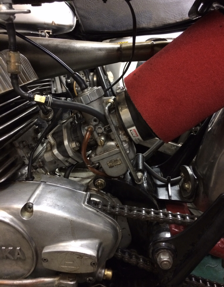

A close up , pre airbox .
Thanks Third. I was wondering if the angle of the bike in the photo enhanced the appearance of the angle. As The Captain suggested, one of my riding buddies races show machines and on his main sled, he runs Mikunis set in at just under 30 degrees to horizontal without issue. The thought is that the agitation and terrain variation keeps bowl level adequate. I'm really digging this build. Thanks again for sharing it with us!

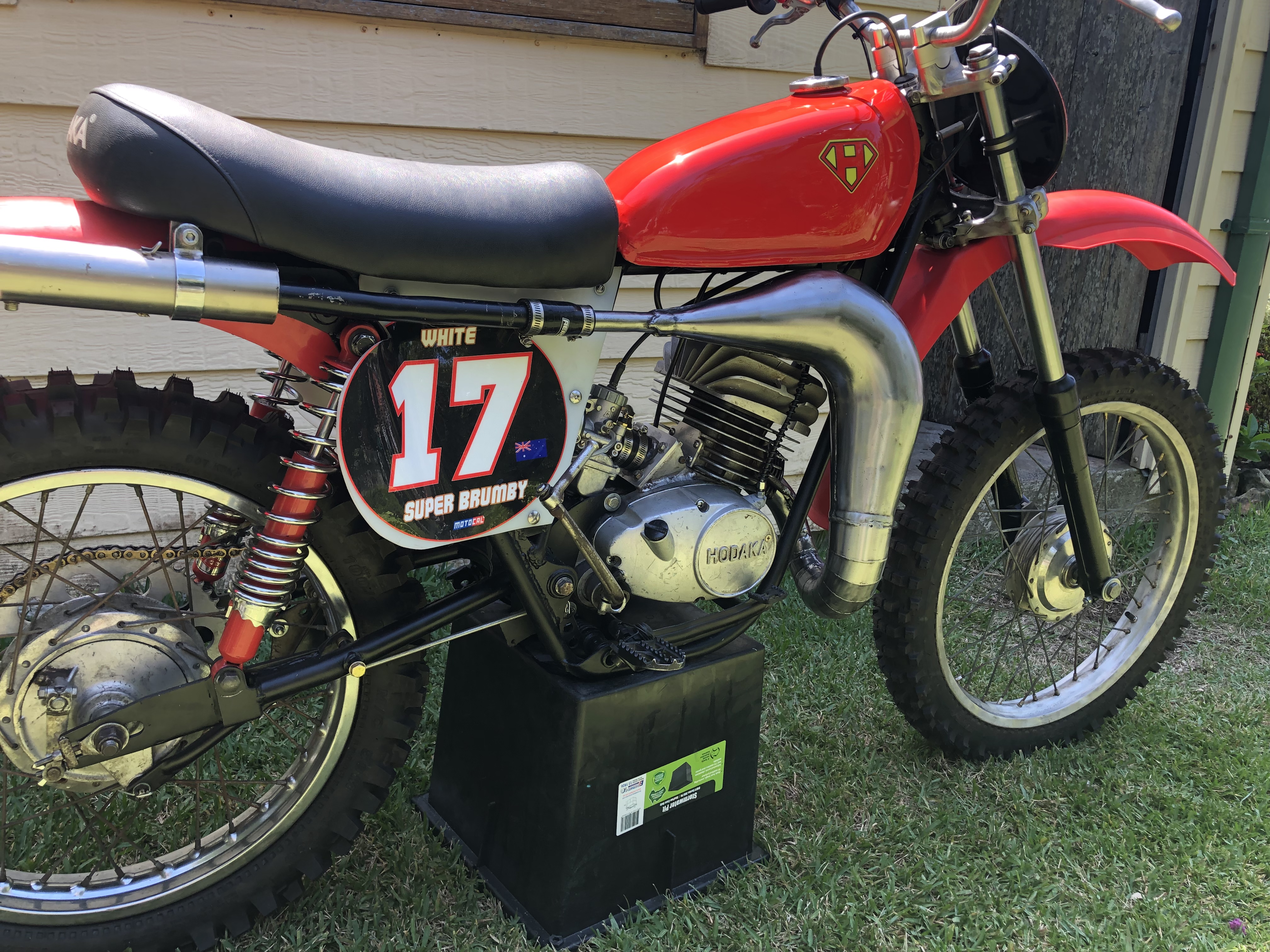

Good news for me , I’m done with the assembly. I just have some little bit to do on the tanks and make sure the clutch is adjusted.
Not bad for a bike made from spare parts .
