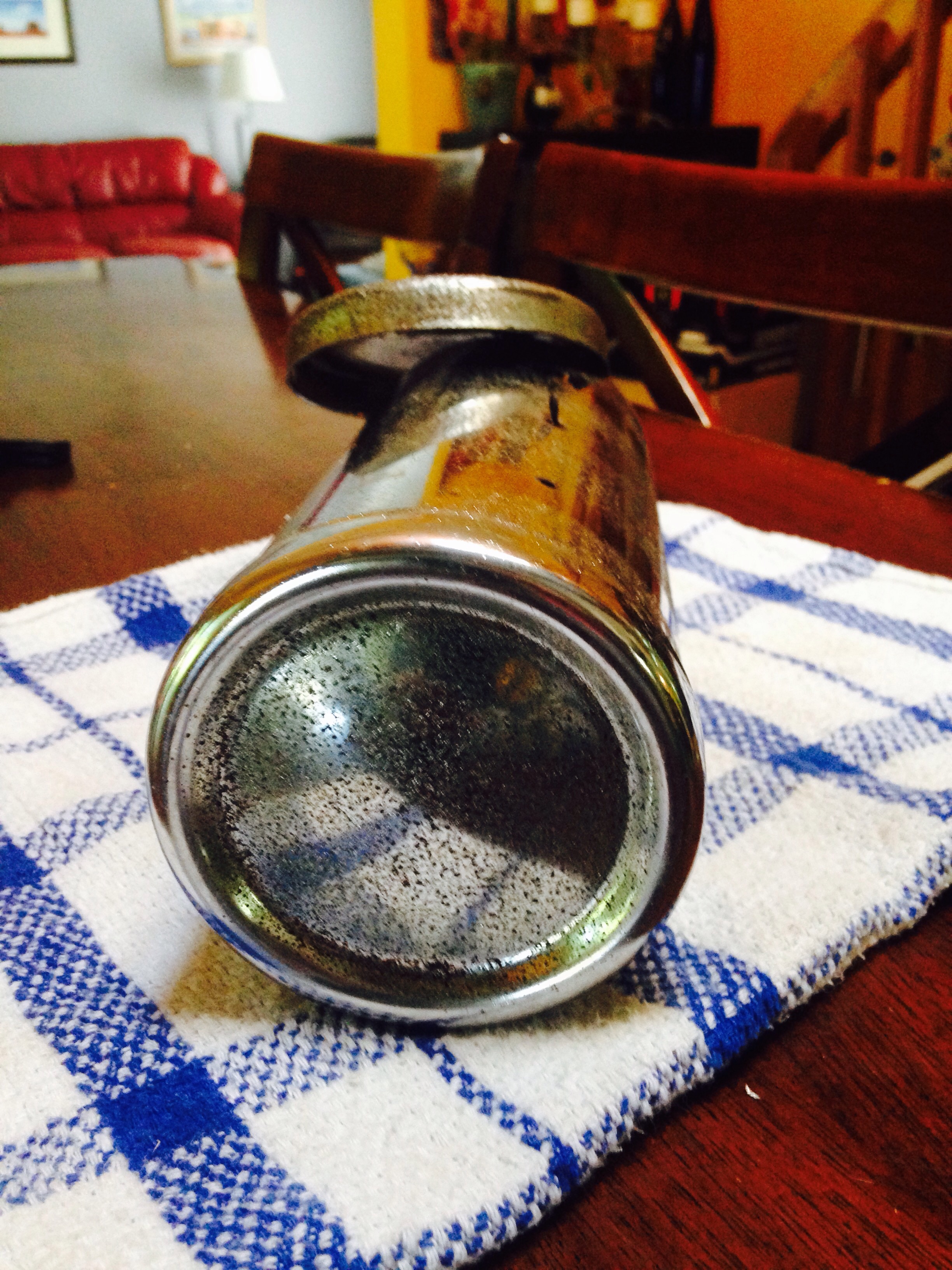

Posts: 4868
Re: NEW
Greg. I had read about this a long time ago but never tried it till recently. I got a rear rack & tool box from Danny and gave it a whirl. I was amazed at how well it worked!
Here's an after photo of the tool box. It was so rusted it didn't look like chrome any longer. Of course, now you can see where the chrome completely pitted through, but I'm getting it rechromed for $45.00. ; D Victor
bchappy
Posts: 448
Location: Monument, CO
Re: NEW
Post by bchappy »
Would be nice to see a picture of it after it is re-chromed. I just wonder what they do with the pitting.
dcooke007
Posts: 479
Re: NEW
Post by dcooke007 »
Hey Bill,
A top quality chrome shops eliminate the pitting by plating with soft copper and polishing. The process is repeated until the pitting is filled. This is a link to Advanced Plating explaining the process. They do great work...show quality stuff and expensive. http://www.advancedplating.com/site/restoration/
Danny
