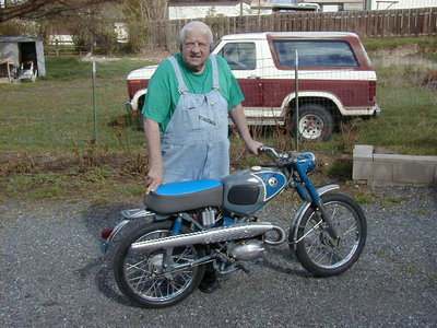

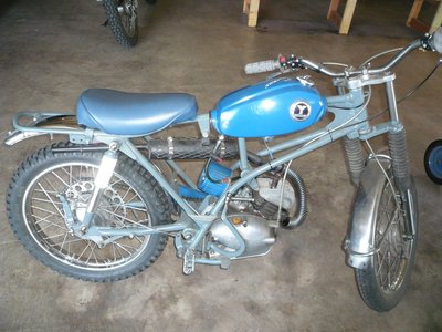

Clarence: This is it. Whitey Hartman's "Lil' Ballerina" Yamaguchi trials special. He has passed it down to Heidi and me. He is still kicking btw, and planning on his 85th birthday this January 10th.
The lil' ballerina
The lil' ballerina

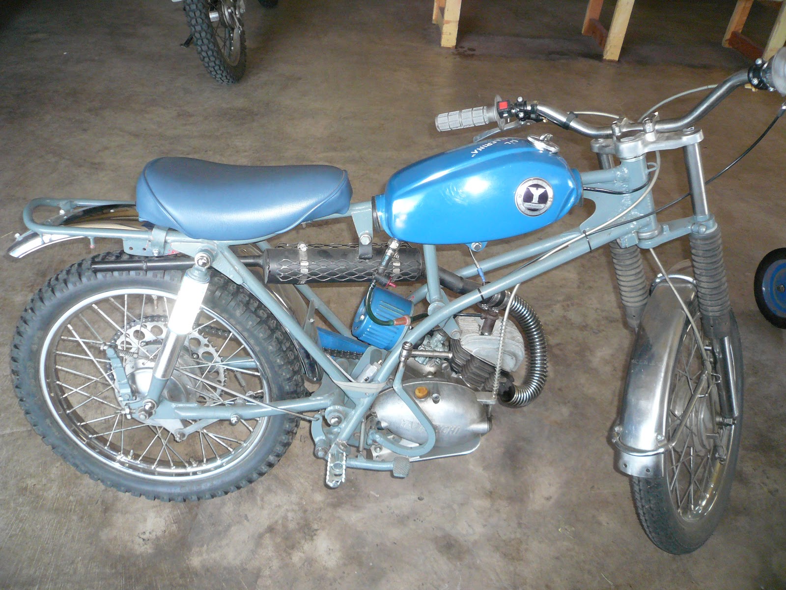

Here it is before it got the trials treatment.
Whitey Hartman and his Yamaguchi 55cc motorcycle

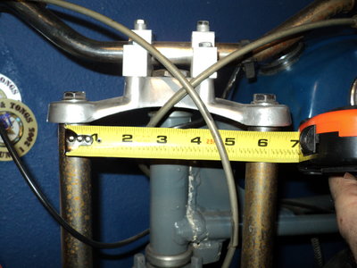

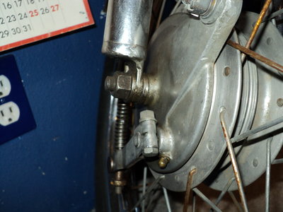

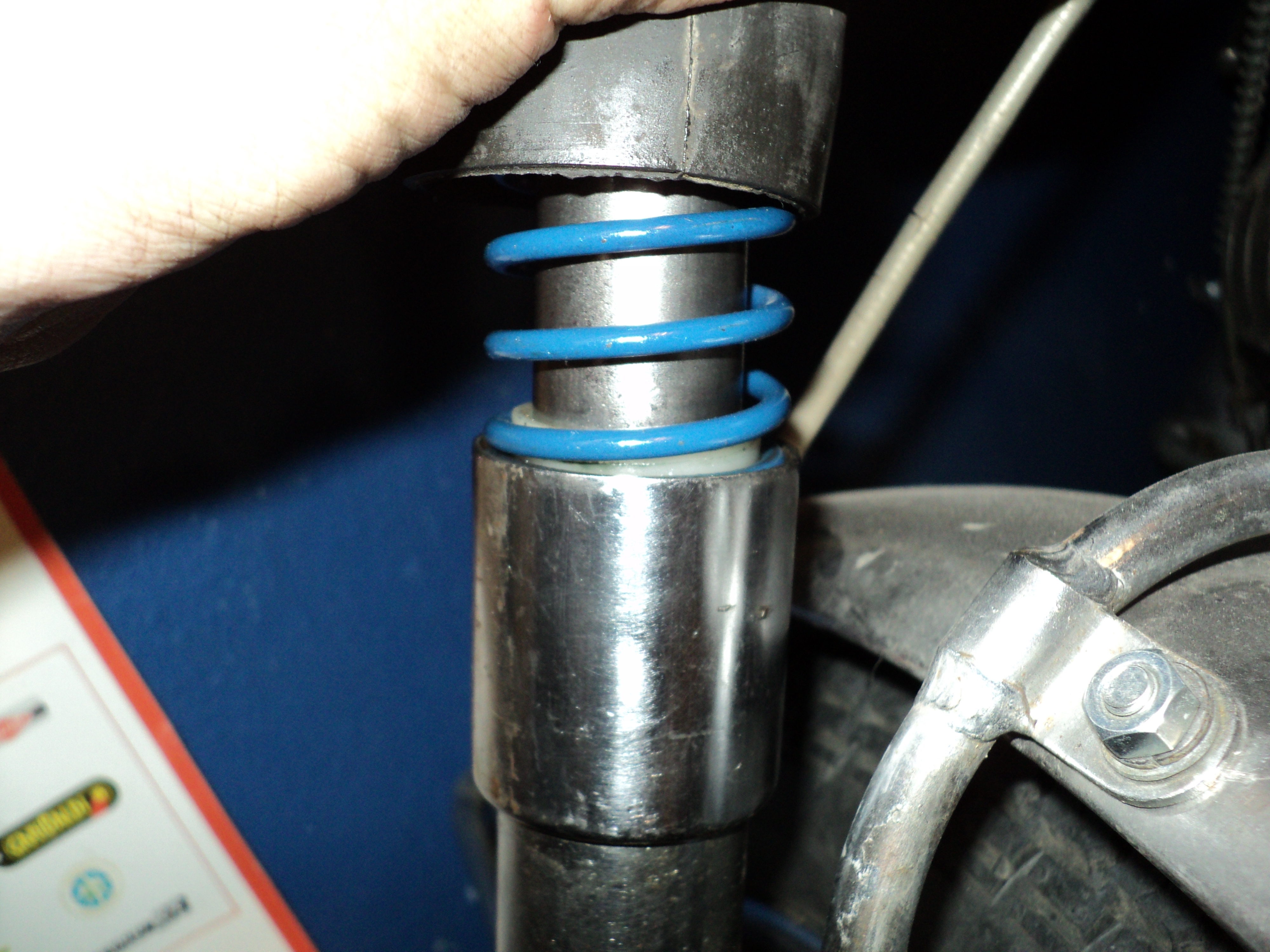

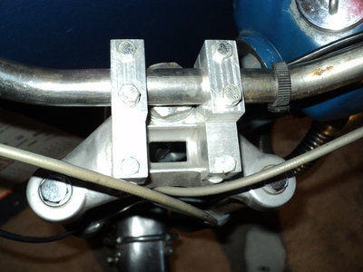

So here goes with the photos. Good luck Jack.
cool square hole
cool square hole
Flat axle brackets on both sides
fork spring and seal retainer
Six inches center to center.
Jack.Broomall
Posts: 29
Joined: Sat Oct 26, 2013 8:43 am
Re: Hodaka History Mystery. The Harry Taylor Road Racer
Post by Jack.Broomall »
Jay,
Thanks so much. This helps a great deal. It does, however raise a couple of additional questions. The Hodaka Ace (both 90 and 100 as best as I can tell) had the forks on about a 148 mm spacing center to center- 5.82 inches and that's just a bit shorter than what you measured for the Yamaguchi. Makes me wonder if the "Harry" bike had an entire Yamaguchi triple tree (upper & lower both). Also, one last question Jay. What is the fork tube diameter on your bike. 27 mm like every early Hodaka? Or something smaller like 24? From your pics it is clear that the fork tube lowers on your bike are something different from the Hodaka parts but the seal holders look like what I see on Harry's bike. Maybe that stuff was interchangeable which is one reason why I as about the fork tube dia. Anyway this all helps flesh out the story and I.m grateful. Now to try and find the Yamaguchi part. Anyone got any leads on that sort of stuff???? Yamaguchi fans weigh in here!!!!

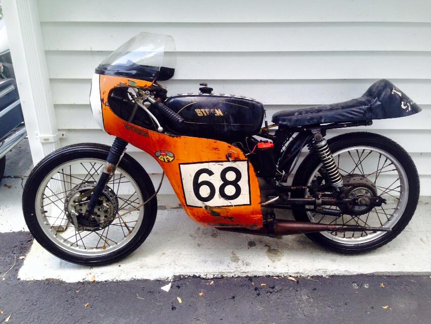

Jack K

Does anyone on the forum know who bought the Number 68 John Steen Road Racer from the Mecham Auction in Las Vegas? I believe we have a rolling frame that was built out of the same shop.

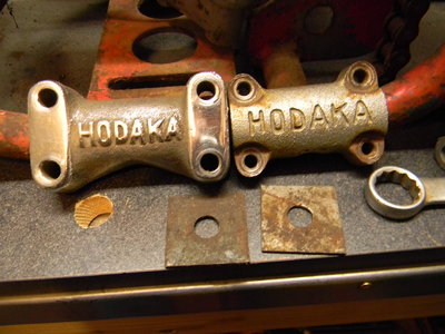

The upper plate with the square hole is off a ace 90 prototype. I call it the ace 90 prototype because many of the parts did not fit the production Mark 11 hodaka nor were they ever listed in any parts or shop model the frame and many things were different. Looking at my early ace 90 frame 87 about I have the same parts you are showing with the square hole. I am not sure when the change was made I think about number 233. I will try and post a picture later as I must find it. The clamp that held the handlebars on hodaka was engraved in rather than raised.

It did work . Also the frame had a loop welded on the front of the frame for a wire loom. Clarence

we have the number 68 bike here in our museum...if anyone has more info on it please let me know.Trying to find any backstory on this bike.. It's a Aermacchi chassis with a Ace 100 motor.

2Brothersvmxracing
Posts: 23
Joined: Fri Jul 19, 2013 3:43 pm
Post by 2Brothersvmxracing »
Hi scooterbobby,
