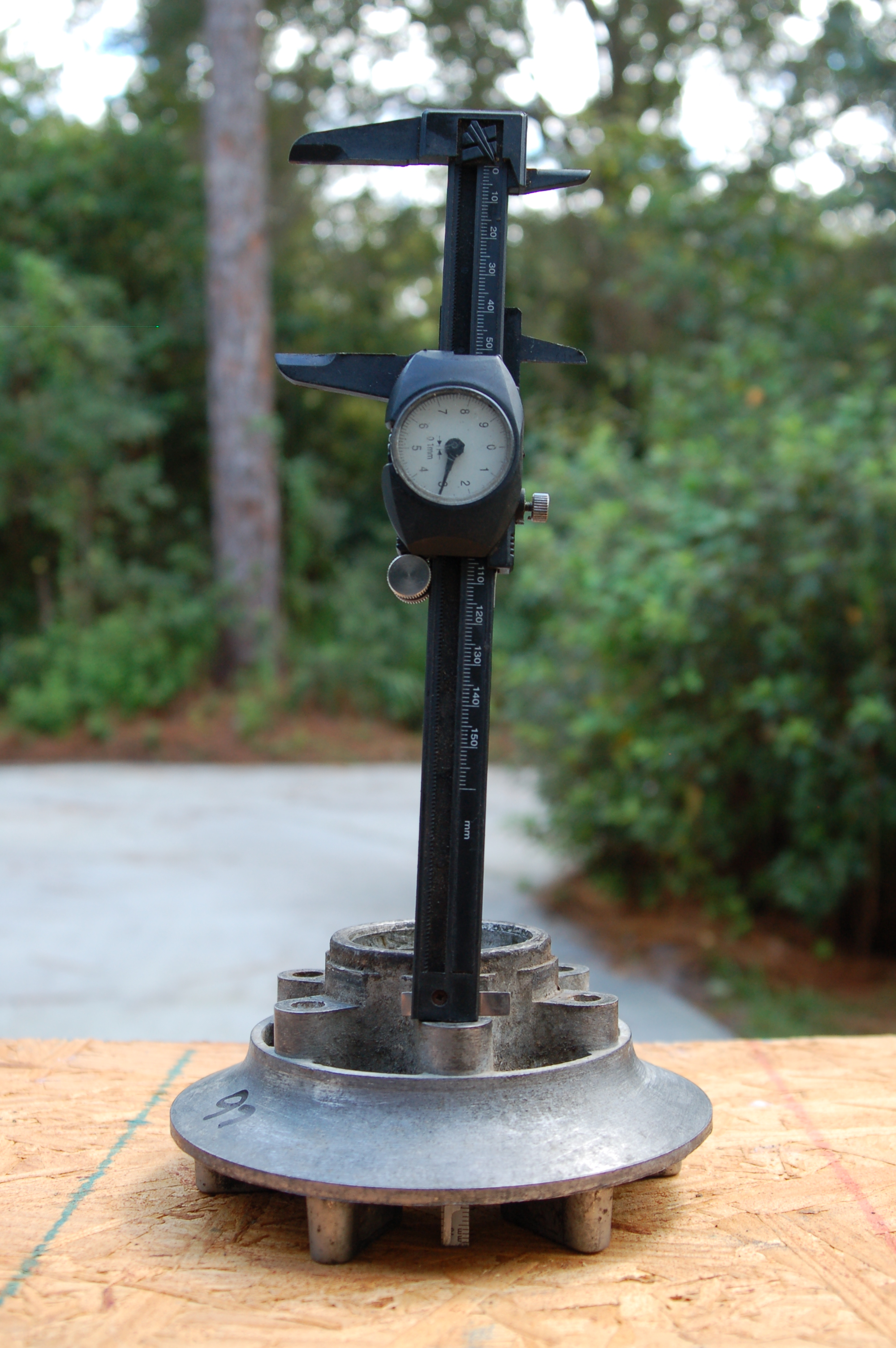

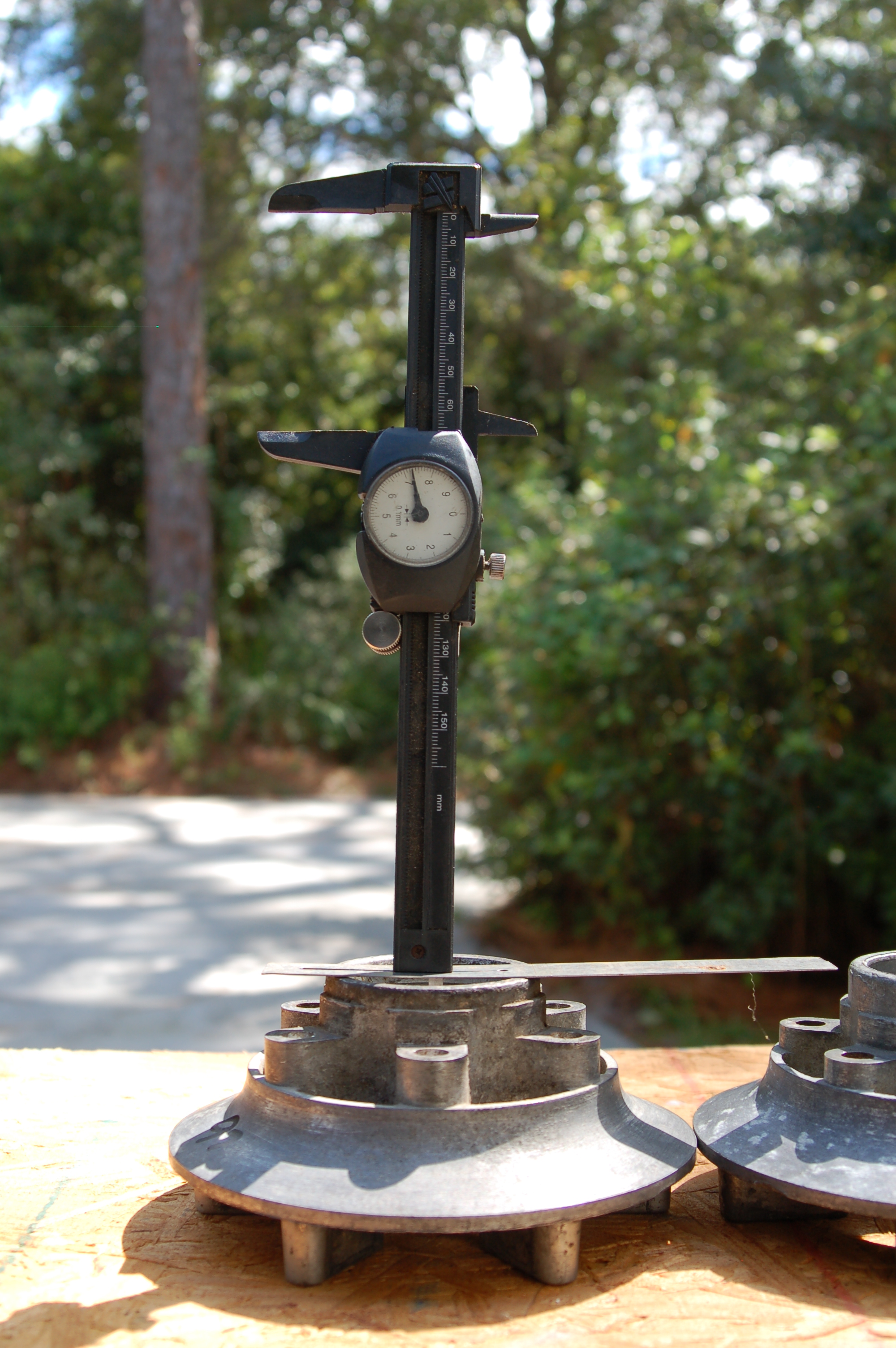

Anyways, to assist me, if you have one of these drive flanges handy, could you snap a photo and take two measurements for me. The measurements I need are:
1 - overall height on flange. (place on flat surface and measure in mm's height. One in photo measures 67mm)
2 - Height of sprocket mounting surface from base. (One in photo measures 53mm)
See attached photos of what I am looking for. Also advise if it is a single bearing flange or two bearing flange.

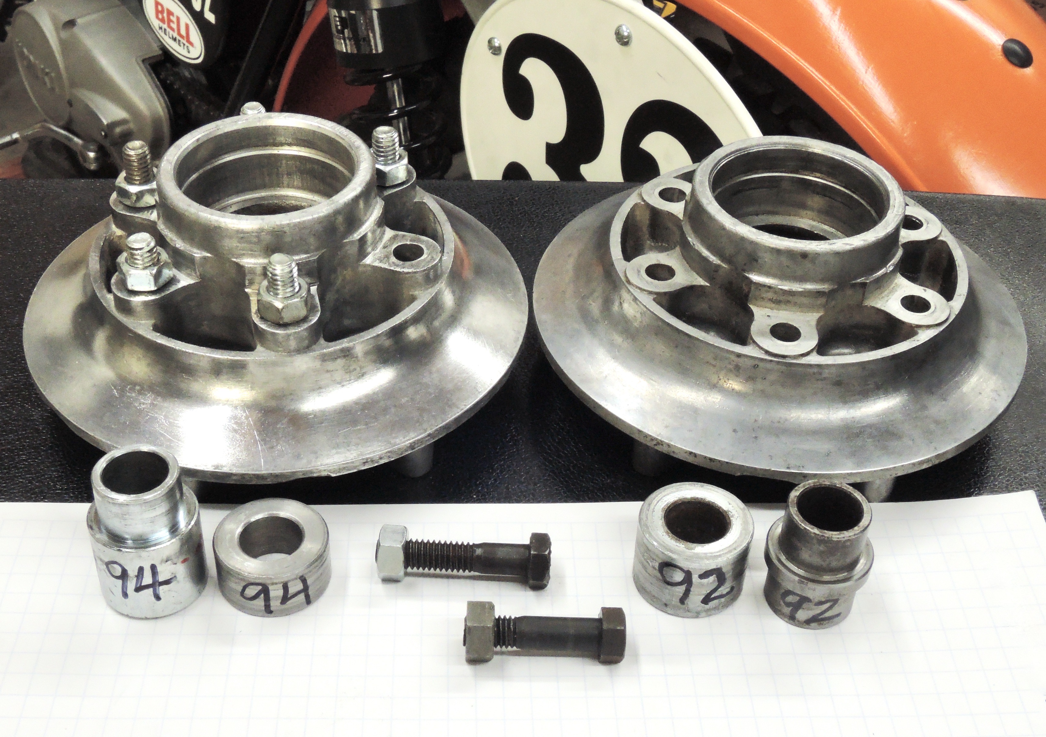

Been through this one after tearing down two Ace 100B+ and three 94 Wombats and throwing all parts in the parts washer. Sheesh, about never figured this out! This picture might help. Maxie
Re: Drive flange differences
Thanks Max. The 92 flange looks a little different than the flanges I have. Specifically, the sprocket mounting area is almost even with the main flange body, where the 94 flange the sprocket area is raised a few mm's higher. That would also account for the different lengths of mounting bolts.

Getting educated with my newest project using a 94 frame and 92 engine from spare parts of both. Down to a 92B+ hub and using this 3mm spacer from a 93B, a cush hub Super Rat plus offset front sprocket to move the chain out from the tire a bit. 94s had bigger chain which needed sprocket moved out a little more. Complicated and I'll still have to see if this all lines up. I'll try to keep you posted!

Looks like they have the same drive flange but only the 93 has the spacer. Both use 420 chain, 93 has offset front sprocket, 92B+ a flat countershaft sprocket. Clarence! What's happening up North? Maxietaber hodaka wrote: ↑Thu Sep 22, 2022 5:15 pm Max isn't the 92B+ and the 93B the same spacer / and cush hub and chain?? Clarence
