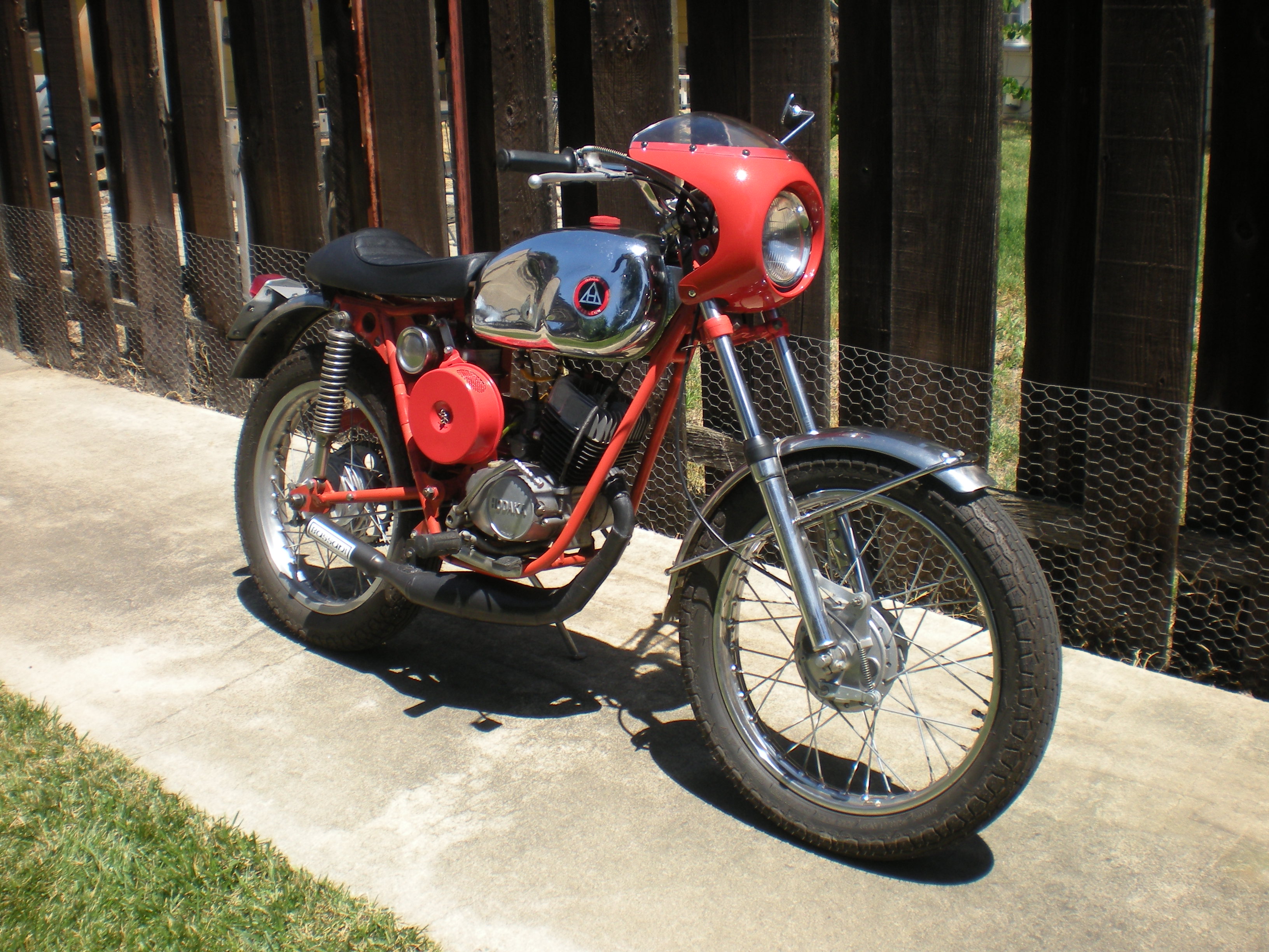

I have four Hodakas. Three are serious dirt bikes. I wanted a serious road bike. My road bike started life as a 1970 ACE 100 B. The engine, wheels and air cleaner are '94 Wombats. The seat and fairing are generic cafe racer. I'm not finished. It is still evolving.

Lower the front end and score some clip-ons and you're there. Nice ride!

It always amazes me how a little fairing the size of a large cooking pot can make a bike look so much more streamlined . . . and faaaaasssst looking!

Please tell us about the pipe.

The pipe originally was a Bassani high pipe. I wanted a low pipe for my project so I cut it up and remade it as a low pipe. The first three inches are the original Wombat pipe. The next three inches are exhaust tubing. The rest is the Bassani pipe I cut into wedges and re-welded to get the shape I wanted. A lot of measuring, cursing and duct tape were involved. The hardest part was re-welding. Oil impregnated steel is not easy to weld.

Hi Matt -
I'm not interested in clip-ons as I want to maintain a comfortable riding position, but I did lower the front one inch. It is still a bit high. To get it looking good, I need to lower it one more inch - but now, things start to get complicated. I have a handle bar-fork tube clearance problem and I'm changing the geometry of the front end. I can fix the clearance problem, but I don't know about the geometry problem.

Yes, for the cafe full monte overkill, you'd have to chop the frame and reset the rake then the bike would become something else. My comment was tongue-in-cheek.
I had a bud with an RD cafe'd out with clip-ons and the whole schmeer. Hated them.
