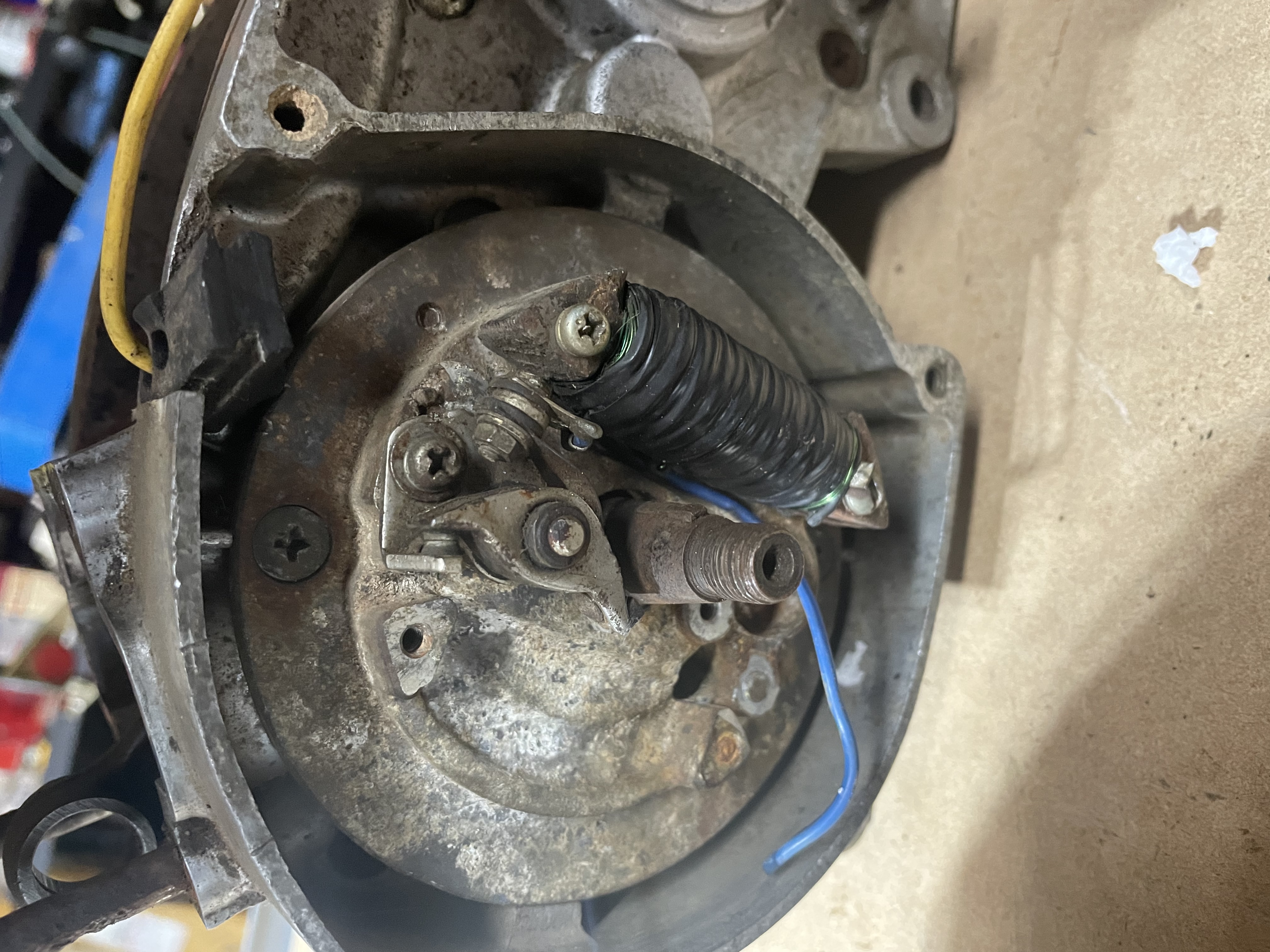

Attaching some pictures for more review
Any input on the pictures is appreciated as well
There is a blue and yellow wire on the stator
The shaft is helicoil is that a good thing ?
Re: Ace 100
Regarding the color of the stator wires, there is a blue wire shown, which connects your points to your missing condenser. There should also be a blue wire which terminates at your ignition coil, along with a black wire.
There should be black & blue wires which connect at the back of the stator and run up to the ignition coil. It appears the ignition primary (exciter) coil has been removed. Also, it appears only the lighting coil remains and the 4 wire plug to the ignition switch has been removed. But, I would guess the DPO tried to use the lighting coil as the exciter coil, which would possibly explain the yellow wire.
It also has a broken exciter coil screw in the mount hole, as well as a broken screw in the condenser mount hole. And it looks like your bottom stator screw is missing. You may need to drill it out and retap the threads in order to mount both the exciter coil and a condenser.
I would find a different stator which is complete. Your flywheel will be better balanced having both coils in place, even if you remove or don’t have the ignition switch, if it’s decided you don’t need it. But you will need it if you decide to add lights and/or an ignition switch.

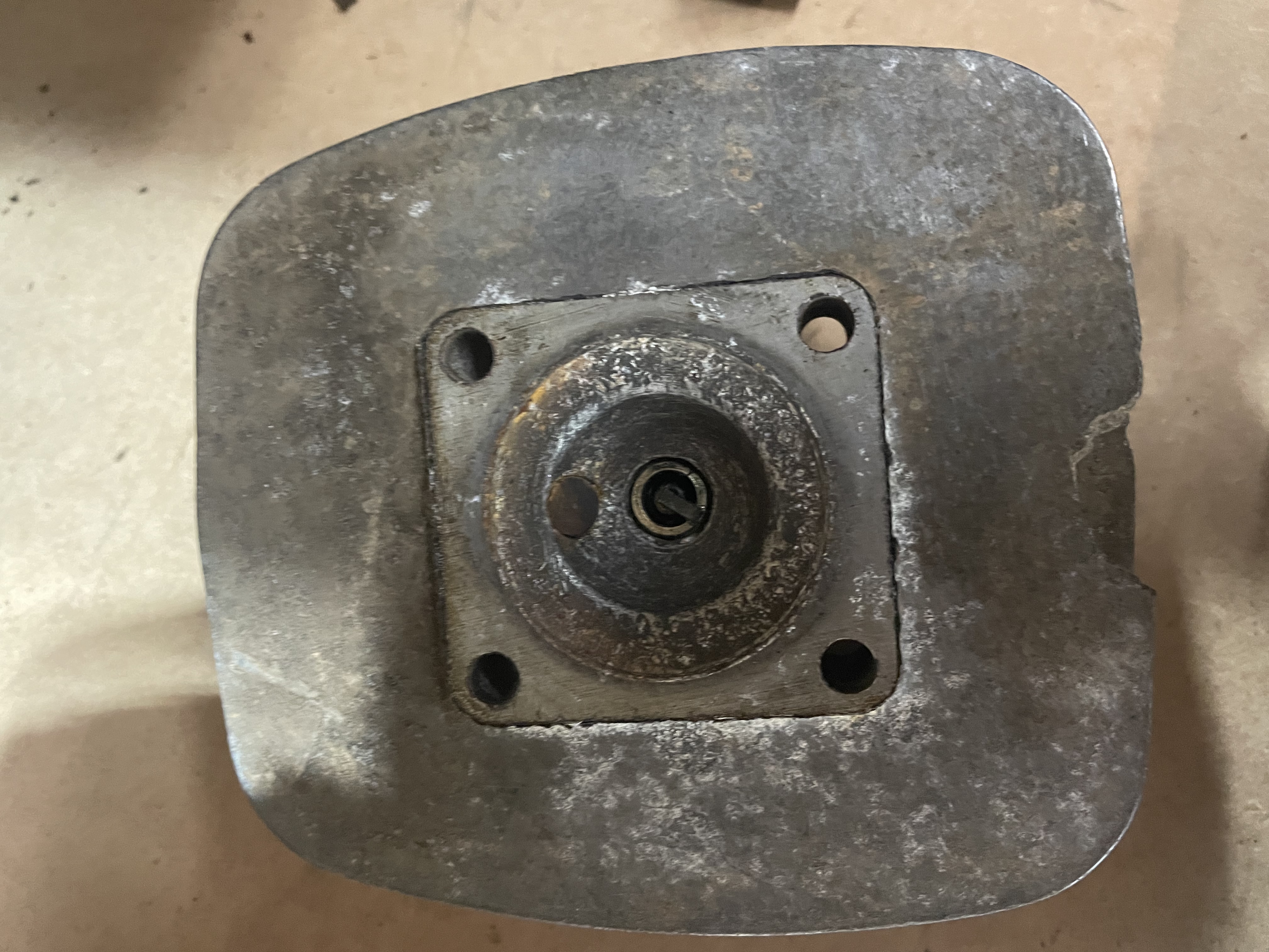

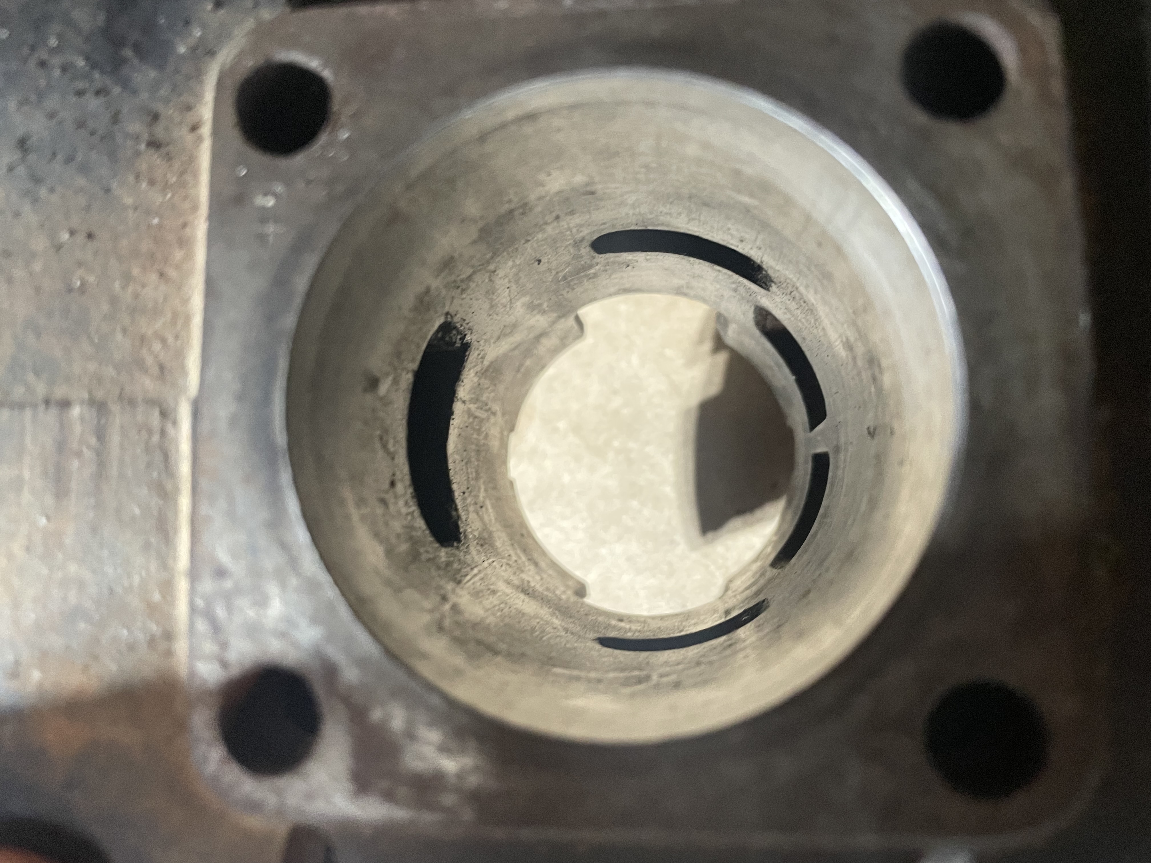

It’ll need to be bored. Better stator assembly would be good, check all screw holes and repair as necessary.

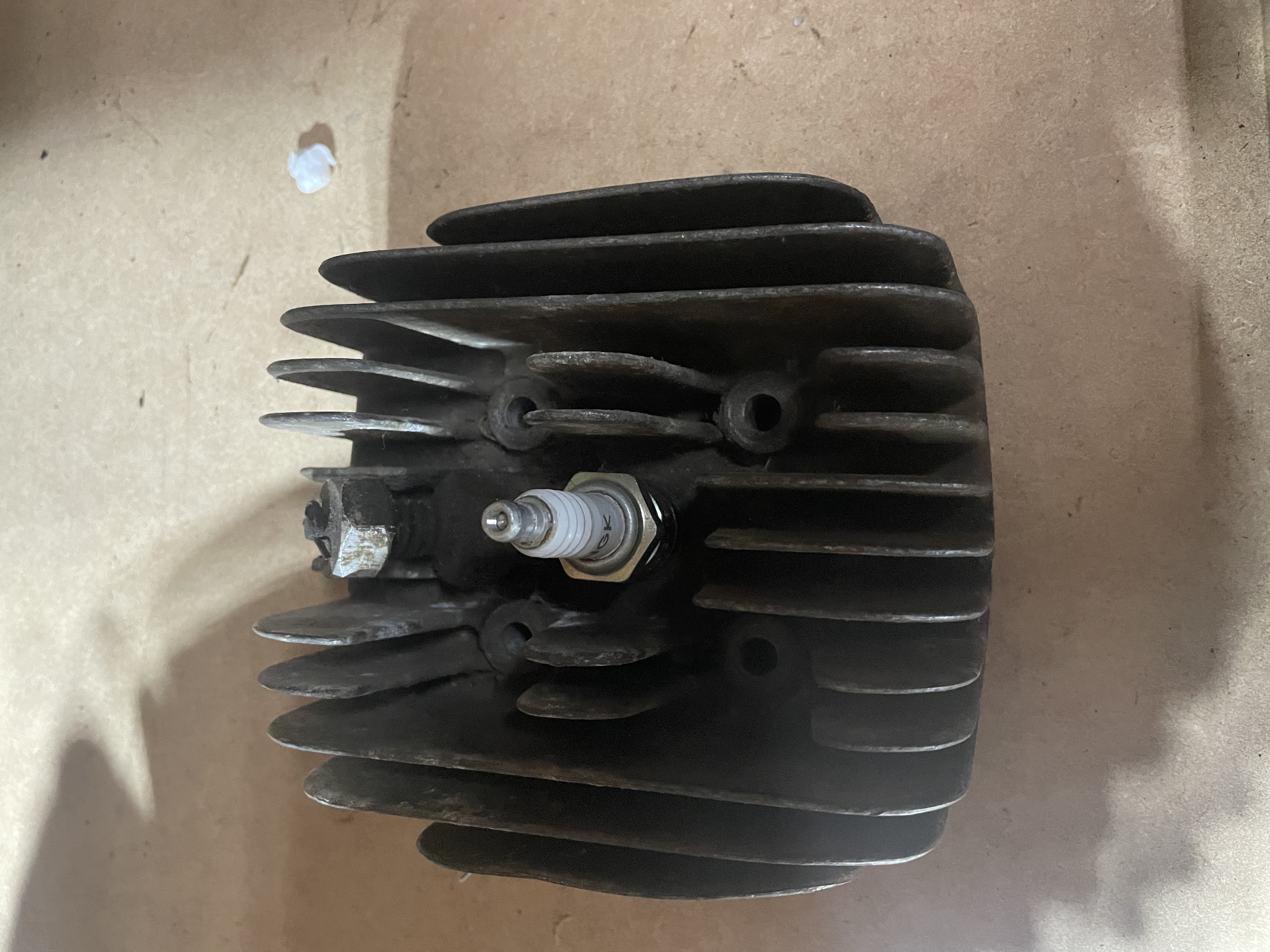

The head looks questionable as well. You can buy a hood used head from Terry Larson at www.Hodaka-Parts.com. He tells me he has plenty of heads for $25 each!
That one looks like they drilled it for a second spark plug or a compression release and put some kind of plug in it. I’d replace it.
Bictor
