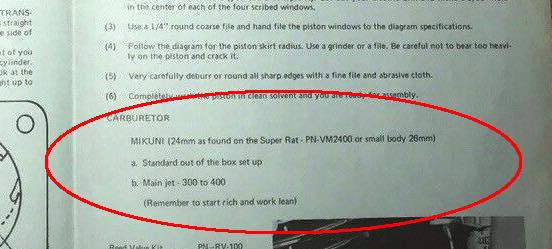

Re: Back to reed valve jetting on a Super Rat
Pabatco published a beautiful service bulletin for installing a reed, with exact details for porting the cylinder and placing holes in the piston skirt. My local dealer gave me a copy, and I followed it to the letter. But, I don't recall if it included jetting recommendations. Anyway, back then it was very common, almost to the point of being of standard operating procedure, to bolt on a bigger carb. One of the Pabatco bulletins I had, but I don't recall on which subject, even had instructions for using an Amal monobloc carb.
For all of the aggravation and idiot mistakes I made, I would not change how it was back then, I learned so much, though often painfully. I'm even glad there was no internet in the 1970s. I feel that it can become kind of a fine line between trying to help and sounding preachy, so sorry for that. I know everyone here is trying to help each other.
-Stever
I reeded & ported numerous 93 SRs following the REED CAREFULLY pamphlet from PABATCO and never found it necessary to change the pilot jet of the stock carb, only the main jet.
OK my friend, maybe I have found what you are looking for. Bear in mind that I posted earlier, regarding the Pabatco reed installation instructions, "I don't recall if it included jetting recommendations". I kind of figured it did, but my copy was long gone years ago. I looked a bit online and found that someone just sold a copy on ebay. I lifted one of the photos, and it does indeed have starting point jetting recommendation for the stock 24mm carb. If the attachment worked, see photo, carb ref circled in red. Only the main jet is changed, all else is standard.
Bottom line, the bike should crank with standard jetting. Forgive me if I offend, but since it doesn't, and given the recent work in the ignition, if it were me and my bike I would double check that the timing is still correct. Good luck.
-Stever
-Stever

Standard jetting otherwise, Victor. The only exception is occasionally raising the needle one notch. This is race bike tuning for high revs all the time. It would be totally wrong for light trailing.
