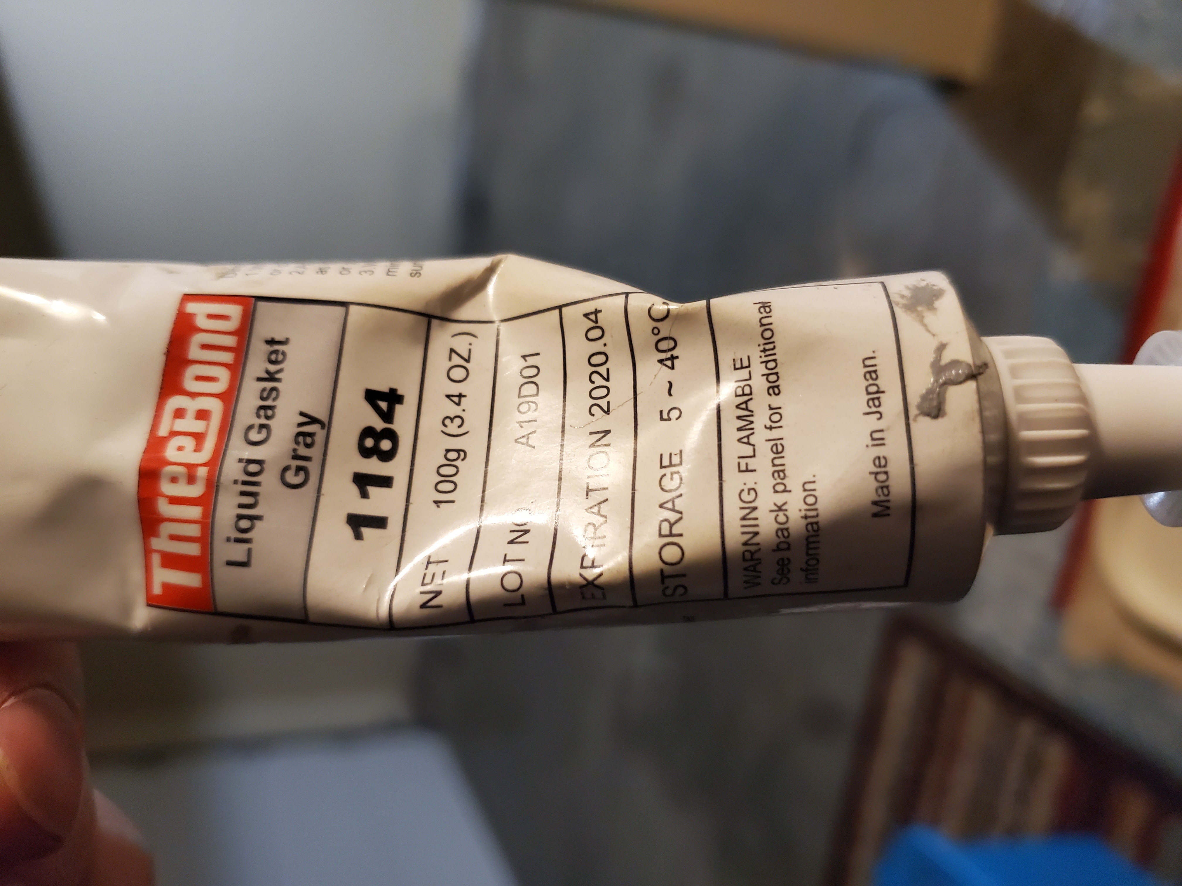

If you do decide to use something i'd use Three bond 1184. Read up on it. Ive used it before with no issues.
Ive been where your at before. Do i use gasket goop or not? If you dont use it and it seeps oil thats gonna suck. I would use it. Its not going to hurt you either way. Its time consuming and messy but if you get the Three bond you can cut the cap really small and spread it like your icing a cake.

I went with what I know works and what was first suggested --> Three Bond 1184
Had it in the toolbox - used it on all of the other Hodaka Cases I have done (which most did not have gasket, just bonded).
