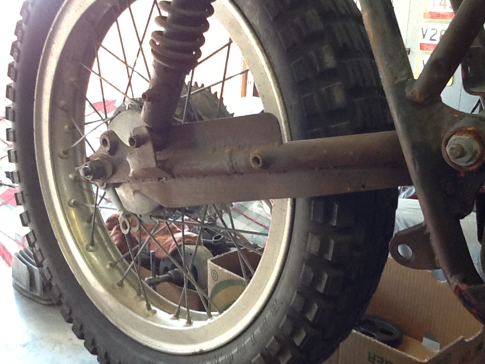

Re: Swinging arm thread.
I have and use the extended swing arm on my old ace 90 it has 3 axle positions I can use. Quick change, quick align, and quick tension. ----------------- Clarence
Cool Clarence. It would be really groovie if you could post a picture of that swing arm. Sounds snazzy.
Here is a pic of a nicely modified Ace 100 swing arm. Works well.
Excellent Dal. We're starting to get a decent collection. I just unearthed a blue swing arm which I hope came off a Super Combat or painted tank Rat. I don't think it is off an SL250. Now we need a craftsman-level welder and some input from a pro regarding the best length to add.

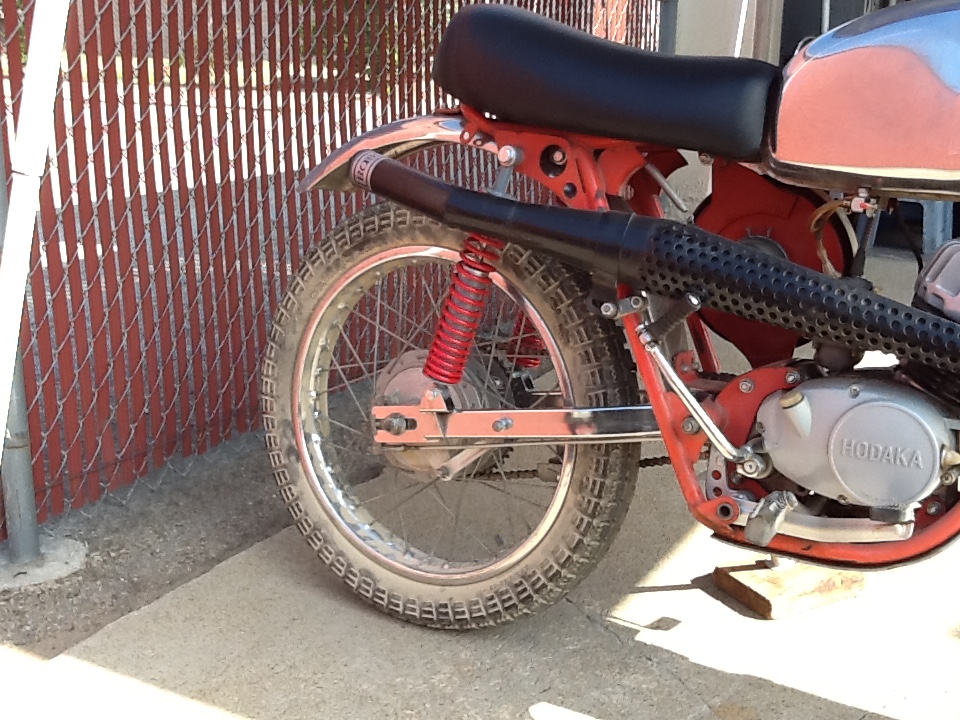

I have a Swenco swingarm on my Super Rat. I will measure the length and post. I believe it is 1 inch longer.
Sweet bike. I have one of those Bassani pipes that will need a header mod. How do you like it on a 100cc motor? Mine was off a 250, but it is the same as what I can see in your picture. Cool bike, by the way.
Tha Swenco swingarm is 1 1/2 inches longer.
