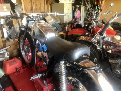

Remember when I did this? Well I mounted it! :ugeek: Victor

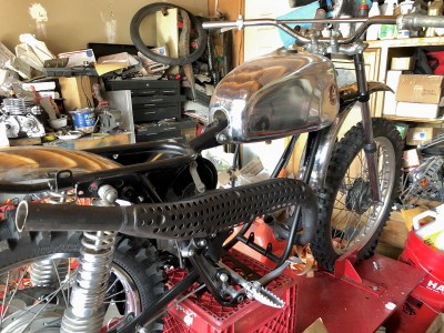

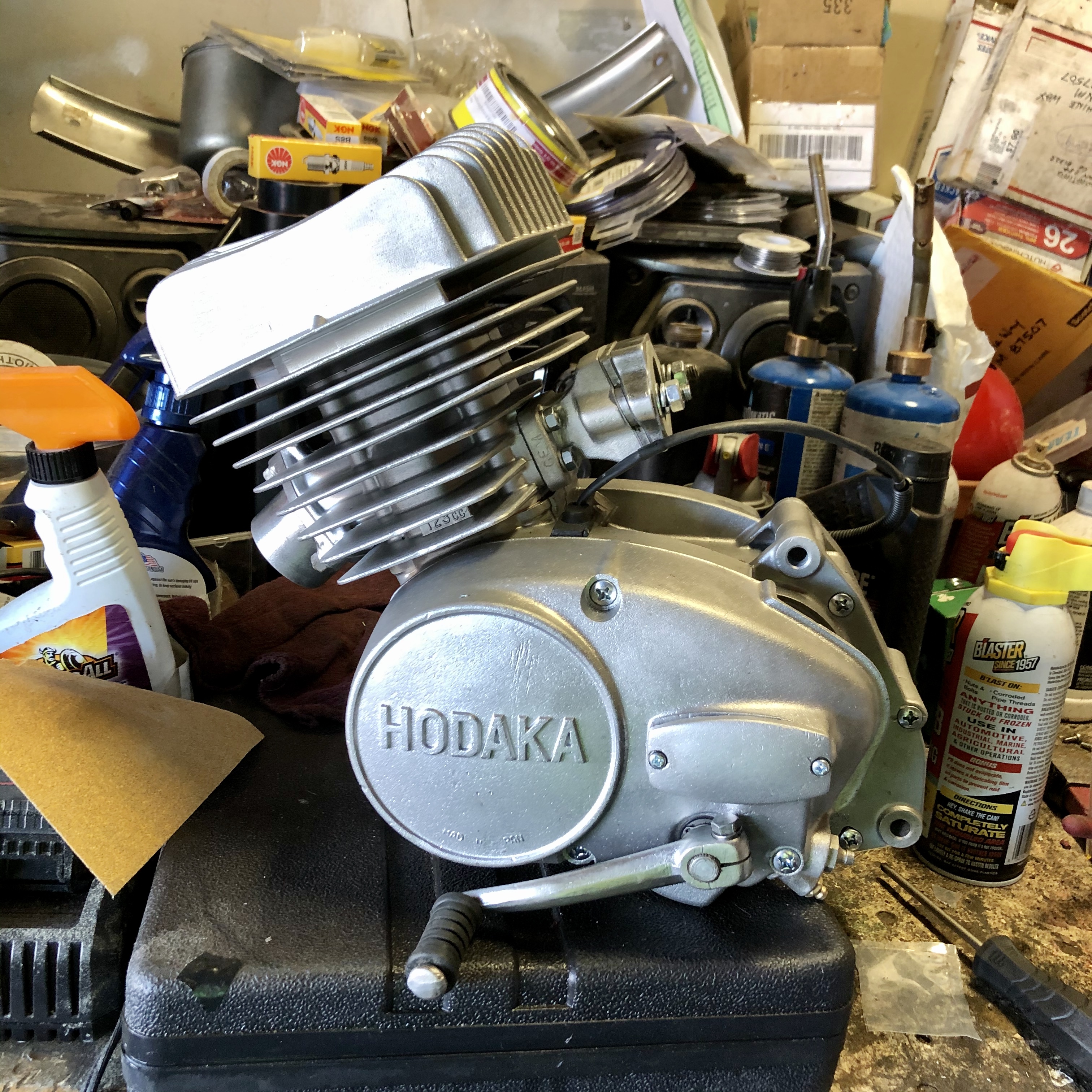

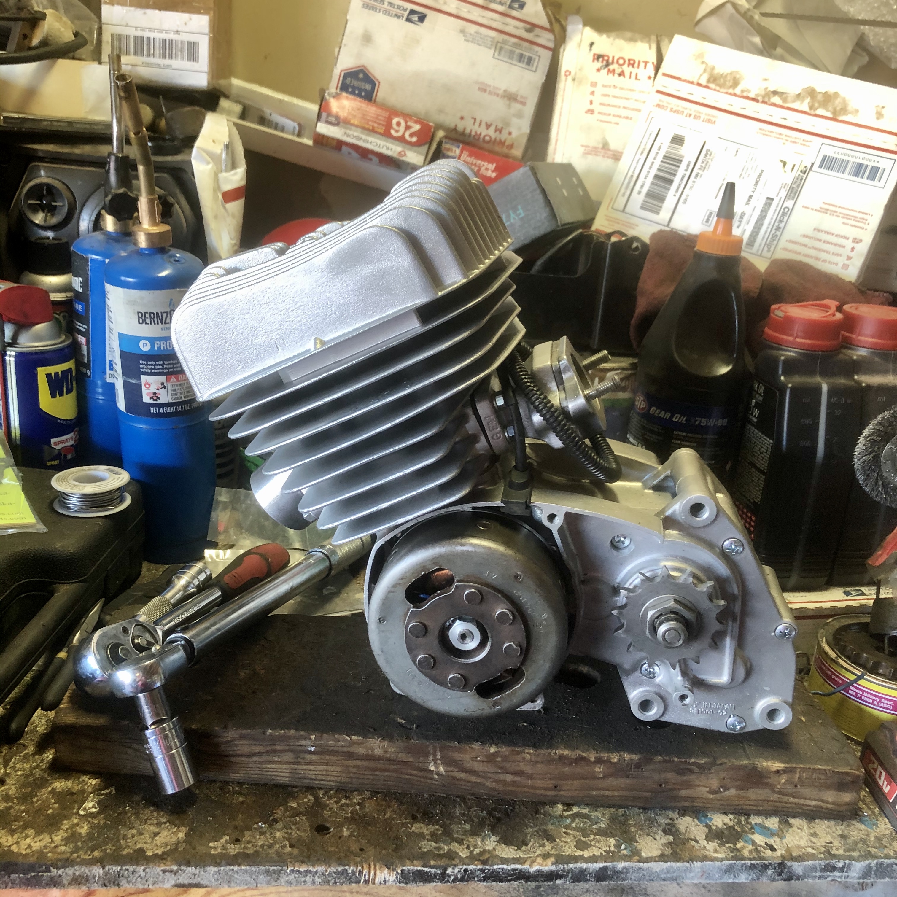

Been working on & off on this project, as my back will allow. Thanks to Tim Ryan for the CW stator, and, thanks to Alan Donovan for the clutch rebuild kit!
I have talked with Terry about fitting a carb on this bike. It has a GEM reed valve manifold designed for a flange mount carb. Terry has the rubber fitting I need to attach a round intake carb on it. I think I will go with a 28mm carb & start the jetting at something similar to the jetting for a Super Combat. I just need to confirm what nozzle is in this carb so I can see if I have a good needle to match to it, or, if I need a different needle.
Any suggestions about which needle jet & jet needle to use for a 28mm carb in a reed valve configuration? I’m going to use a Model 03 exhaust also. I need to pull the bottom of the carb and see if I can get the needle valve out and confirm the size.
As a refresher, this is a Model 95 motor ported for reed valve and a Model 97 piston. GEM reed intake. Looks like I’ll have to cut my own gaskets.... :ugeek: Victor

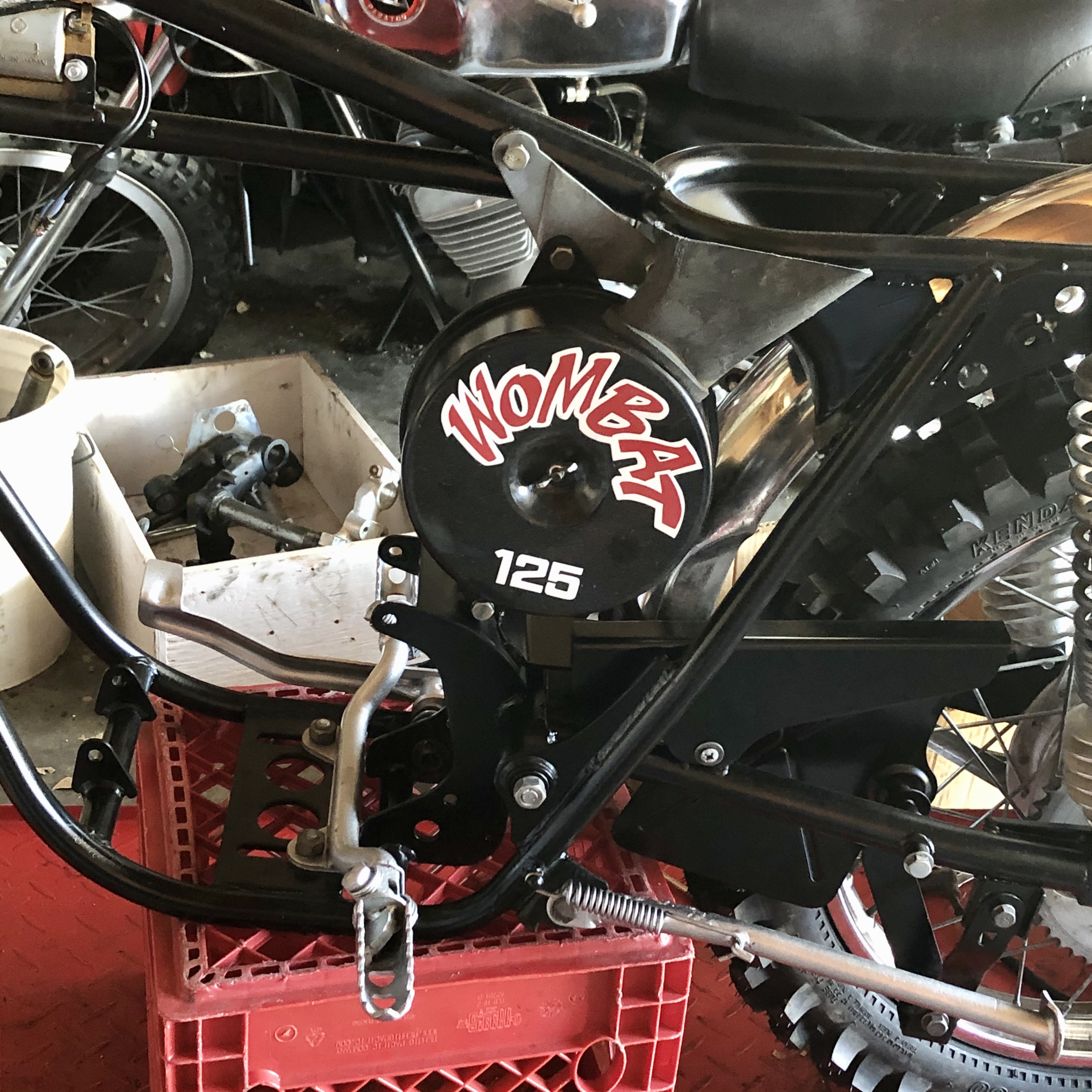

Your choice of an 03 exhaust will most likely see your jetting end up somewhere nearer the stock 03 jetting versus the 95/97, Starting with the correct needle jet and needle are critical. A lot of guys try tuning with the main and pilot only because it easier. The needle jet and needle really run the show and must be right before you fine tune with mains and pilot choices.
olddogs
Posts: 410
Re: Starting the Wombat Combat!
Post by olddogs »
After viewing your pictures, which everyone loves seeing, I see you are also using a stock Wombat air box and snorkel. Great for that classic look, but a bigger carb also pulls bigger air, Trying to tune an engine that is straining for air is difficult. I would suggest some 1 inch holes in the outer ring of the cover. If you put 3 or 4 along the backside near the ignition switch and use rubber ring grommets they are almost invisible to the eye. An 03 inner cover with holes and a full foam style element is an option that also adds breathing, but the snorkels base area is way too small to free flow air.

OK! Thanks for the advise on air flow. I’ll give a good look at the 03 jetting and see where I can go from there! :ugeek: Victor

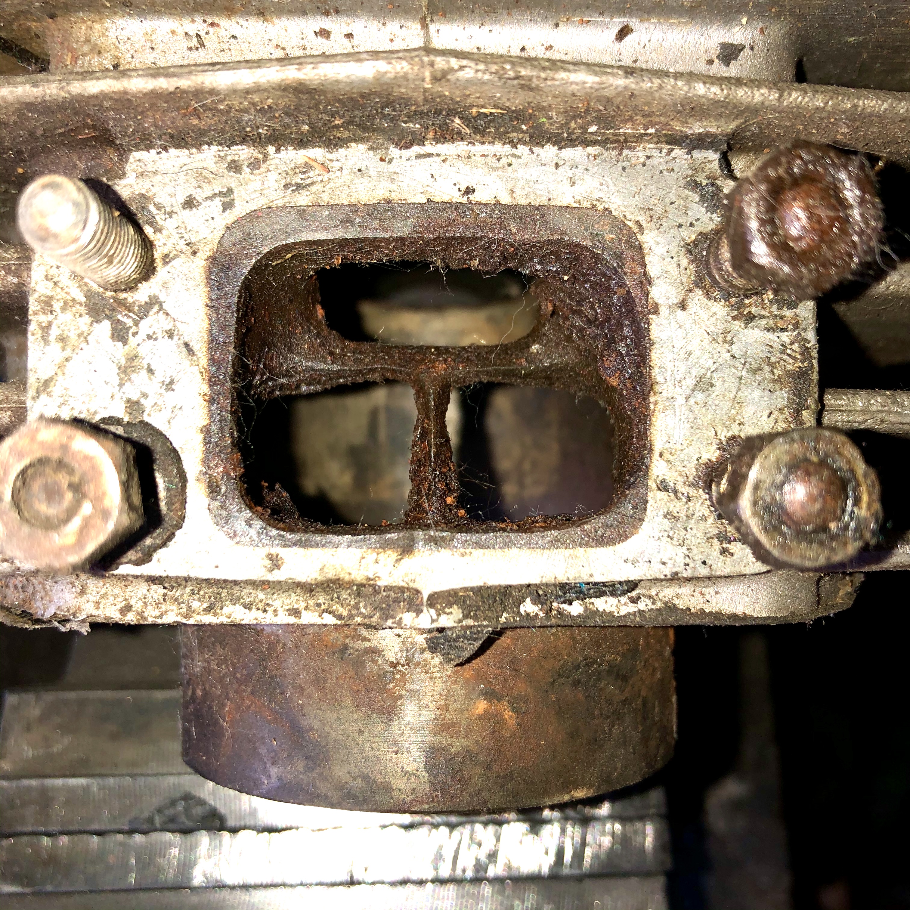

Well Matt. I was planning on starting with a slightly rich version of the Model 03 jetting & go from there. I didn’t do the porting work on this bike so I don’t know to what level tge ports were worked. They were really gunned up with fuel & oil before I had it vapor blasted, but they are clean now and very closely match the ports on the Super Combat piston. With the 28mm carb, I’m hoping there won’t be a tragedy of errors trying to tune it in. :ugeek: Victor
Before Vapor Blast

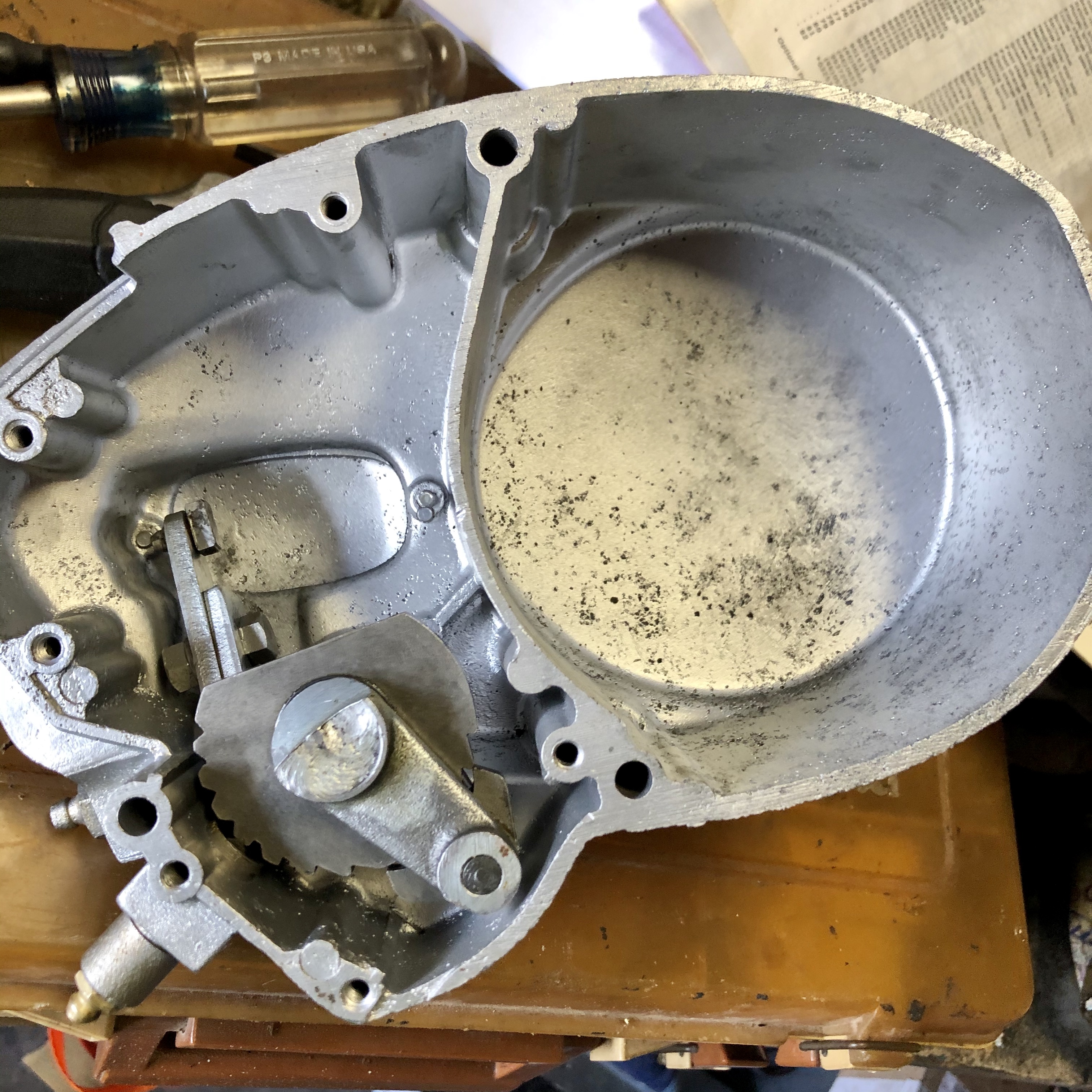

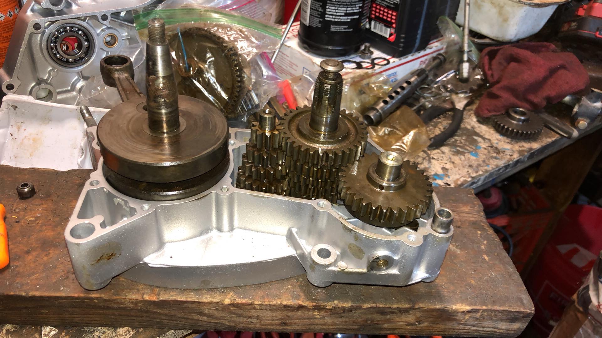

The motor was making a noise as the crank turned. Turned out it was an excess of Yamabond causing the crank to scrape. Split motor apart and cleaned off the offending bond, tested crank rotation and reassembled.
Found my 125 clutch which had fallen off the top of the work bench to the bottom shelf behind a plastic milk crate. Pulled old clutch apart, salvaging the clutch hub & springs! But, the clutch hub wouldn’t fit onto the 125 crank shaft.
All I can guess is someone swapped the clutch hub for an Ace crank instead of leaving it as a 125 clutch. More to come.... :ugeek: Victor

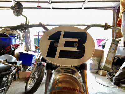

My numbers were in the mailbox! I decided, when I ordered the numbers, I would make a positive out of a negative. The negative being the bad luck issues I’ve had to deal with on this build. Decided to number it “13” and I laugh when I look at the number plate! Also, my Son In Law’s Birthday is November 13! :ugeek: Victor
