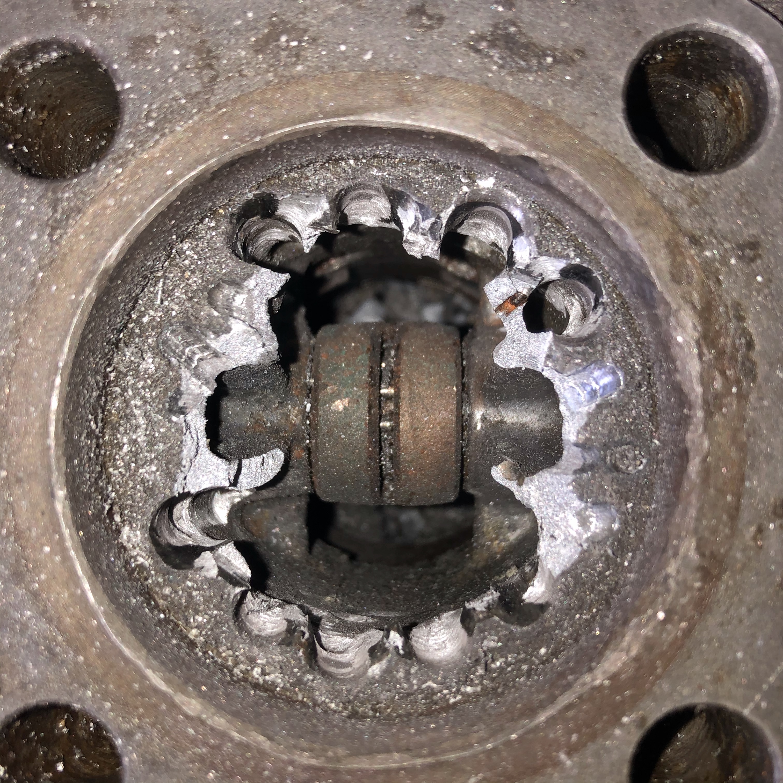

Nothing was penetrating the rings free. So I drilled holes in the top of the piston. 4 front, 4 rear. Tried to loosen with my punch in the holes. No movement. Then I put the punch in the center. Top of piston started breaking away. Now it looks like this & the damn thing still won’t move! Is there a way to break through the top of the rod? Or should I just cut it from below and be done with it???
Re: Frozen Motor
There is a better way. After all the chemicals and tapping, plus the cylinder heating then dry ice on the piston, you can try this. Block the engine under the front mount (a hardwood block works well) so that the exposed piston top is horizontal. Use a steel shaft about 1.5" to 1.75" diameter and 3-4 feet long. Stand it vertically on the piston top. Use a steel fence post driver (typically 15#) to drive the shaft down on the piston. The directed inertia will normally move the piston and frozen cranks. Of course this won't work at TDC or BDC

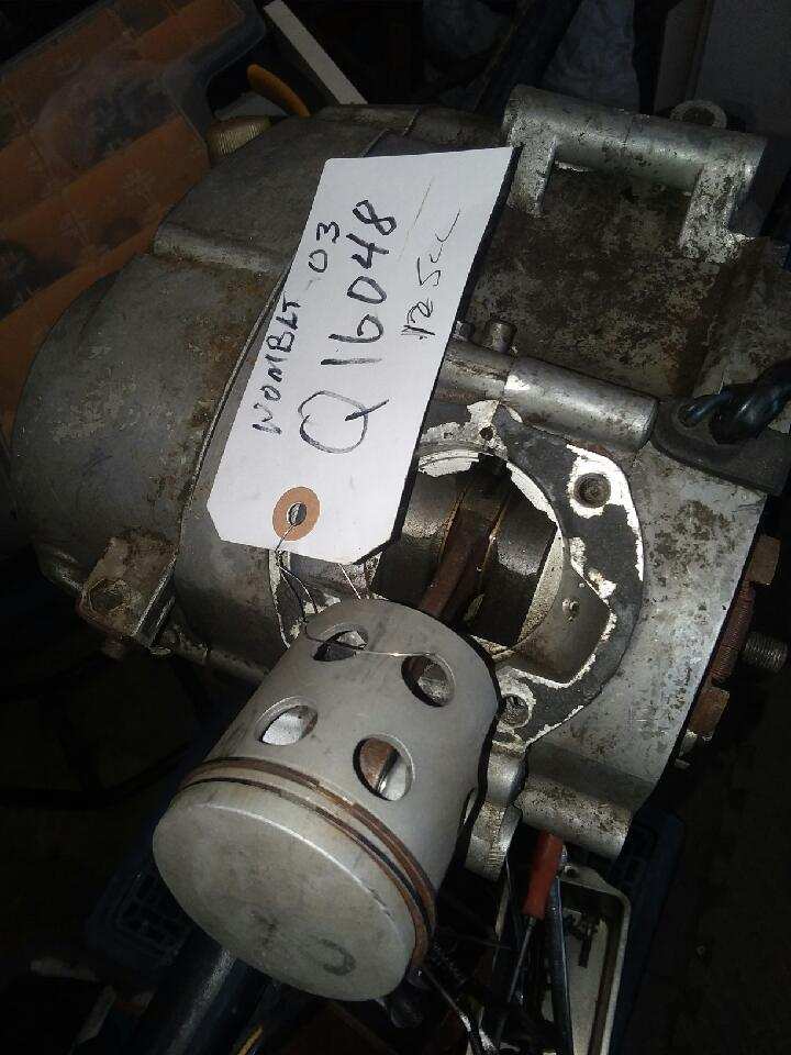

I found a better way! Bought this from Bruce today! I’ll just remove the piston & get a std cylinder & piston kit from Terry Larson!!!
