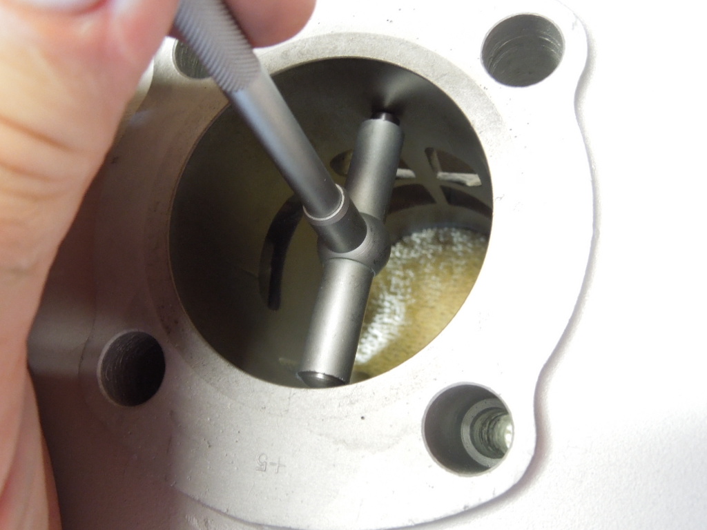

Measuring an 03 Wombat cylinder and took some pictures to demonstrate process and tools used. More sophisticated tools are available but basic quality micrometer and telescoping bore gages can get the job done.

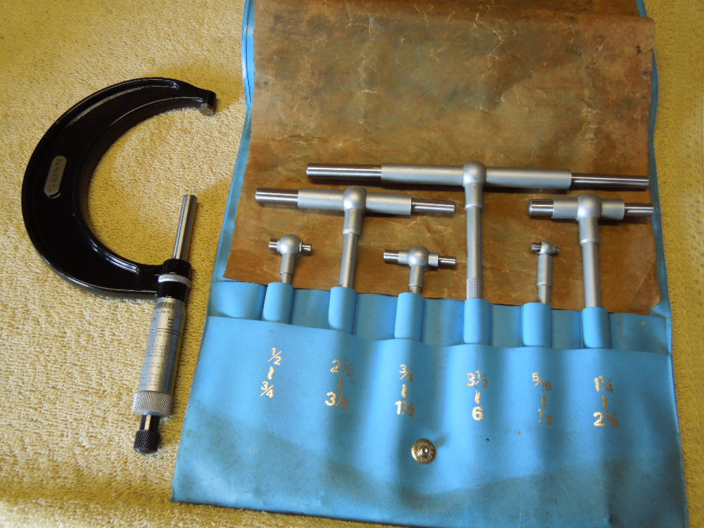

This is the kind of job that you need three hands. Micrometer holders / stands are available but in this case vise and padded jaws. Still looking for a good deal on a micrometer holder.
Note radius on ends of telescoping gage.
Most people think the proper way to use a telescoping gage is to attempt to center, square up the gage and then tighten the locking nut. There is better way. Place the gage in the bore at an angle and tighten the locking not firmly. Pivot one end of the gage up while maintaining the opposite end in the same location. The gage will telescope in, center in the bore and give an accurate reading. Practice and proper technique is required. When done properly repeatable measurements will be the results.

). Up near the top I think it would better to say "snug up" the tightening knob on the bore gauge. ( Rather than "tighten the locking nut".) The bore gage has to be snugged up enough that it won't spring "out" on its own when removed from the bore, but not so tight that it requires excessive force to move it thru the arc which self-centers on the exact bore diameter. Precision measurements require a bit of "touch" or "feel" - and a bit of practice. Since I don't do precision measuring every day or even every month these days, I like to take a specific measurement multiple times and throw out the extremes to zero in on the most accurate dimension.

I like the basic 436 Starrett version micrometer with carbide faces and 10th scale. Micrometers measure in 1 inch lengths and the one used for the 125 bore is a 2 to 3 inch. I think you would need a 1 to 2 inch version for the 100 bore. I bought all my micrometers on ebay. Micrometers are either heavily used or used very little. I look for mics that have seen very little use and pay no more than 2/3rds the retail price....sometimes much less. Some very good deals can be found. I also have standards for all my mic's to verify they are adjusted properly and standards can be used to practice your measuring technique. Quality varies and some very cheaply made micrometers are out there and should be avoided.
The telescoping gages I purchased many years ago from Snap-on. They do not make their own and I think they are General brand and not very expensive on ebay new.
Danny
