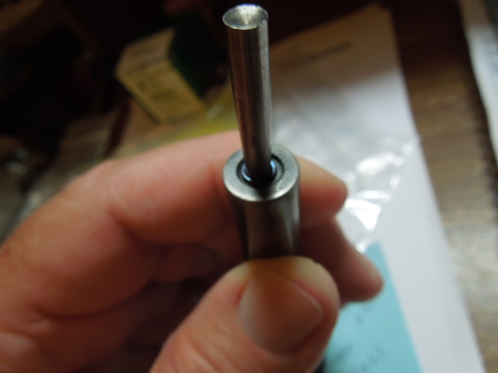

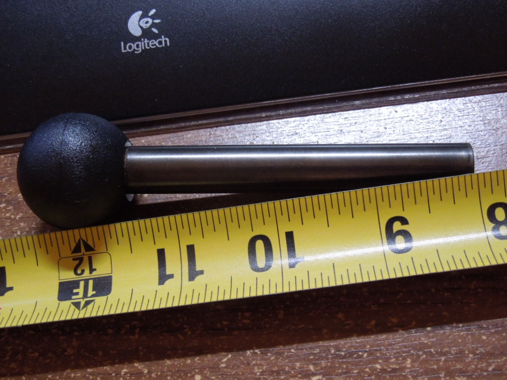

Would a kindly chat group member post some close up photos of the "pin" and the "business end" of that black ball handled device?
I'm gonna need to do some of these little C shaped clips.
I've got a mini lathe and some stock. I can cobble one together.
Dimensions of the "pin", inches or metric, would be super if available.
Some idea of the business end of the Outside Tube dimensions would be a great help.

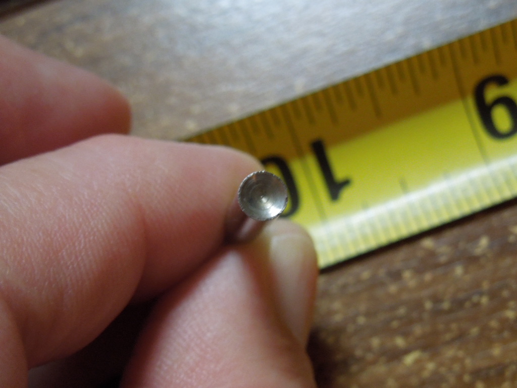

The handle part is a piece of cake, it's the tapered pin that's the tricky part.
Re: Hodaka snap ring tool
The working end of the pin is 5mm the same as the end of the control shaft. The over all length of my tool is 1/2 inch shorter than the original tool. Preference on my part. This is one of the original batch of tools I made for Strictly Hodaka. No extra ones available at this time.
Thanks Dan.
Could you provide approximate diameter and depth of the "counter bore' in the end of the Tube part?
I'm gonna assume the recess in the end of the pin is something like 90 degrees included.
And just one more thing...... Approximate diameter of the starting taper.
Your post is a big help.
Thank you.
Thank you.
Al,
1. The counter bore depth is slightly greater than the thickness of the retaining clip. You want the tube end of the tool pushing against the clip retainer.
2. The counter bore diameter is slightly larger than the clip when it is at maximum expansion on the pin part of the tool.
3. The recess in the pin is to allow the pin to mate up with the control shaft with out any gap the clip could get caught in. 60 or 90 degree should work. I have hand ground them in with a small round stone and dremel tool. Experiment a bit. Knowing the object of what you are trying to accomplish is important in determining what works with the equipment you have.
4. Small diameter of pin is 3mm.
Danny
