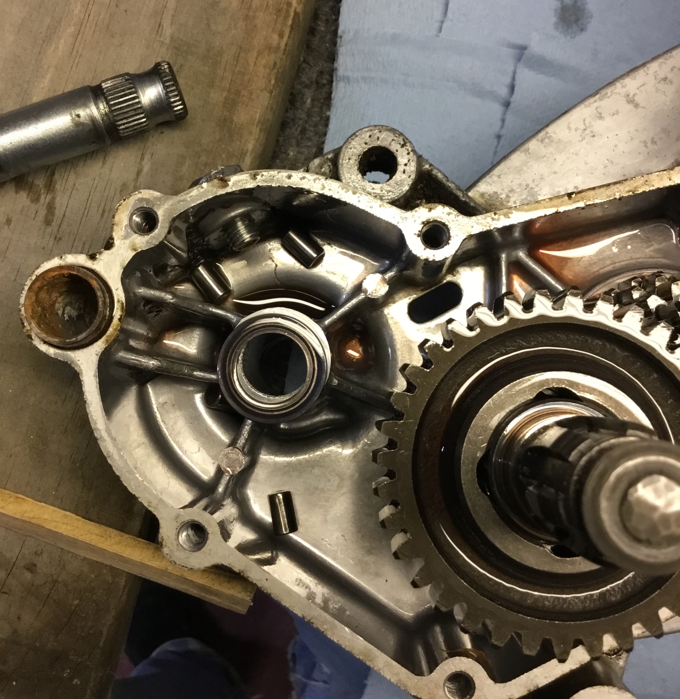

Well,as Matt stated,it can be pretty risky to start an engine of unknown history. I would say that I got real lucky not to have done more damage.

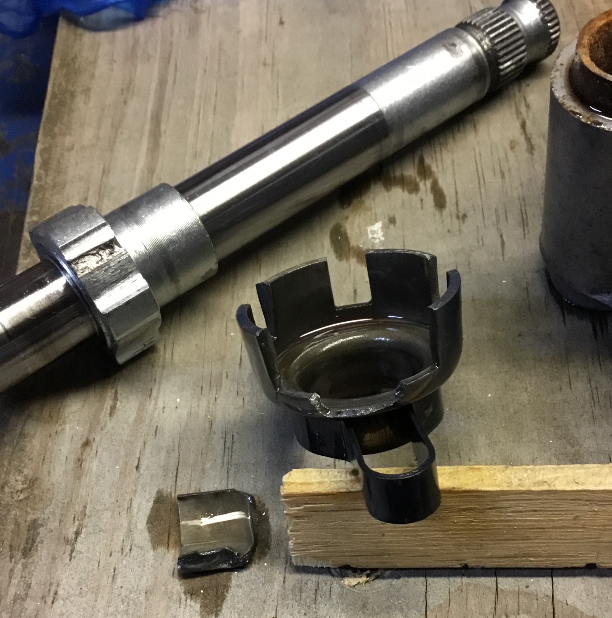

I see that your kick shaft bearing retainer broke! I’m guessing it was an OEM retainer & not the later, heavy duty one? It doesn’t look as thick as the HD. Victor

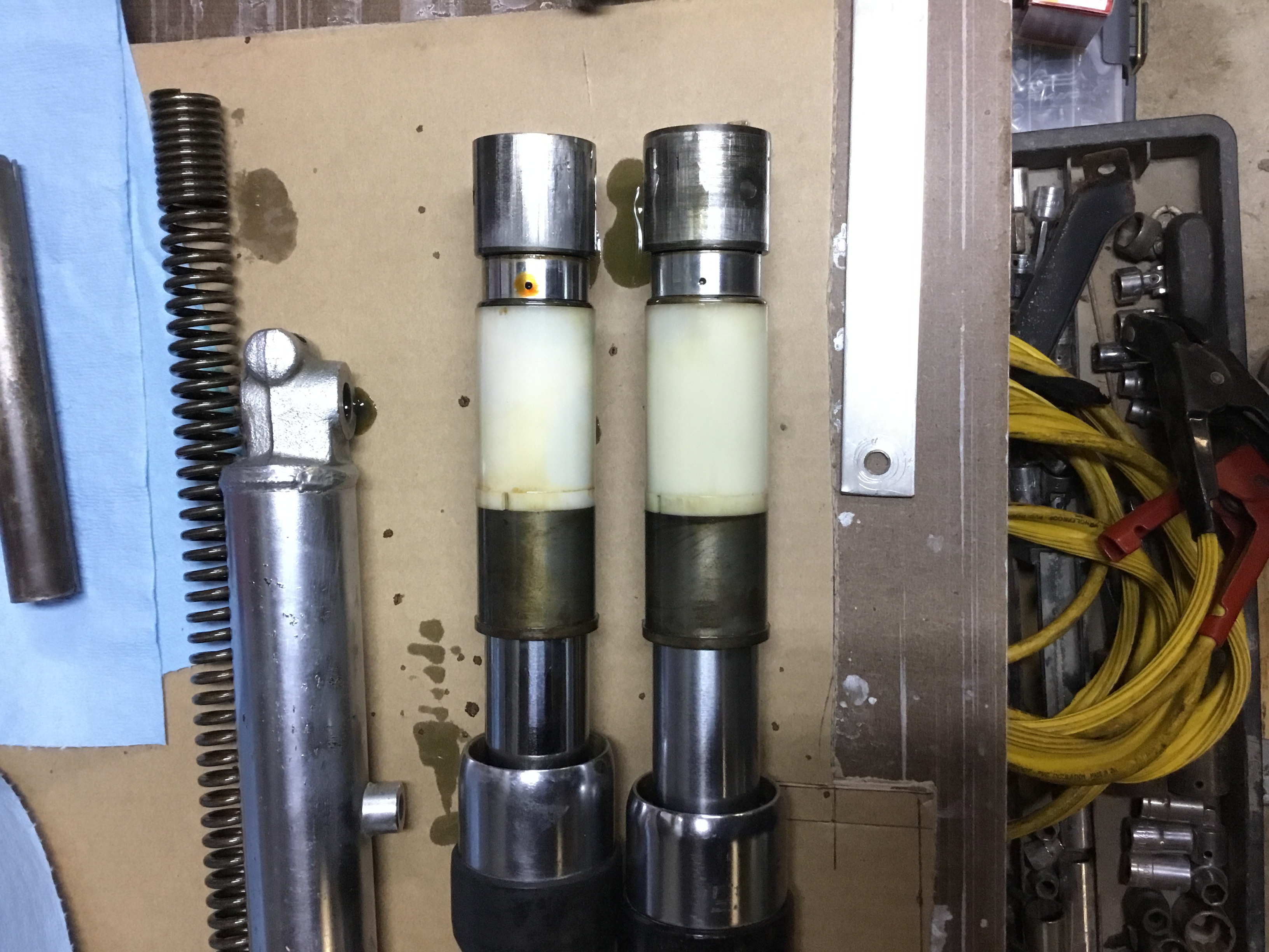

Just though this might be of interest. Took apart the forks that came on my wombat that are different lengths just too see what the heck is going on.
I was hoping that the longer one had been modded as dirty-rat had suggested,but this is not the case. Everything internally is the same as far as I can tell,but one inner fork tube is longer by an inch. Any ideas what model would have a longer tube ? Also,do these look like the correct springs ?
Re: Never ending Ace trials project
The one inch longer tubes are model 97 and 98. You have two different model fork tubes.

Okay,still trying to figure out the fork differences. Hodaka parts list new tubes that will work from the 92B+ 93,94,95 etc. all the way to the super combat. So they must be the same length as my longer one,but it says in order to use them with the 92B+,94,95 the lower white plastic spacer must be removed.
In the parts schematics it shows the spacer on all of them,but the super has a different part number for the lower fork legs. I,m guessing that is the difference that is the reason the lower spacer must be removed when using the longer tube in the older legs ? Is there a way to tell a super combat lower fork leg from a 94 or 92B+ leg. Just trying to figure this all out and see how much of a mix match of parts I have.

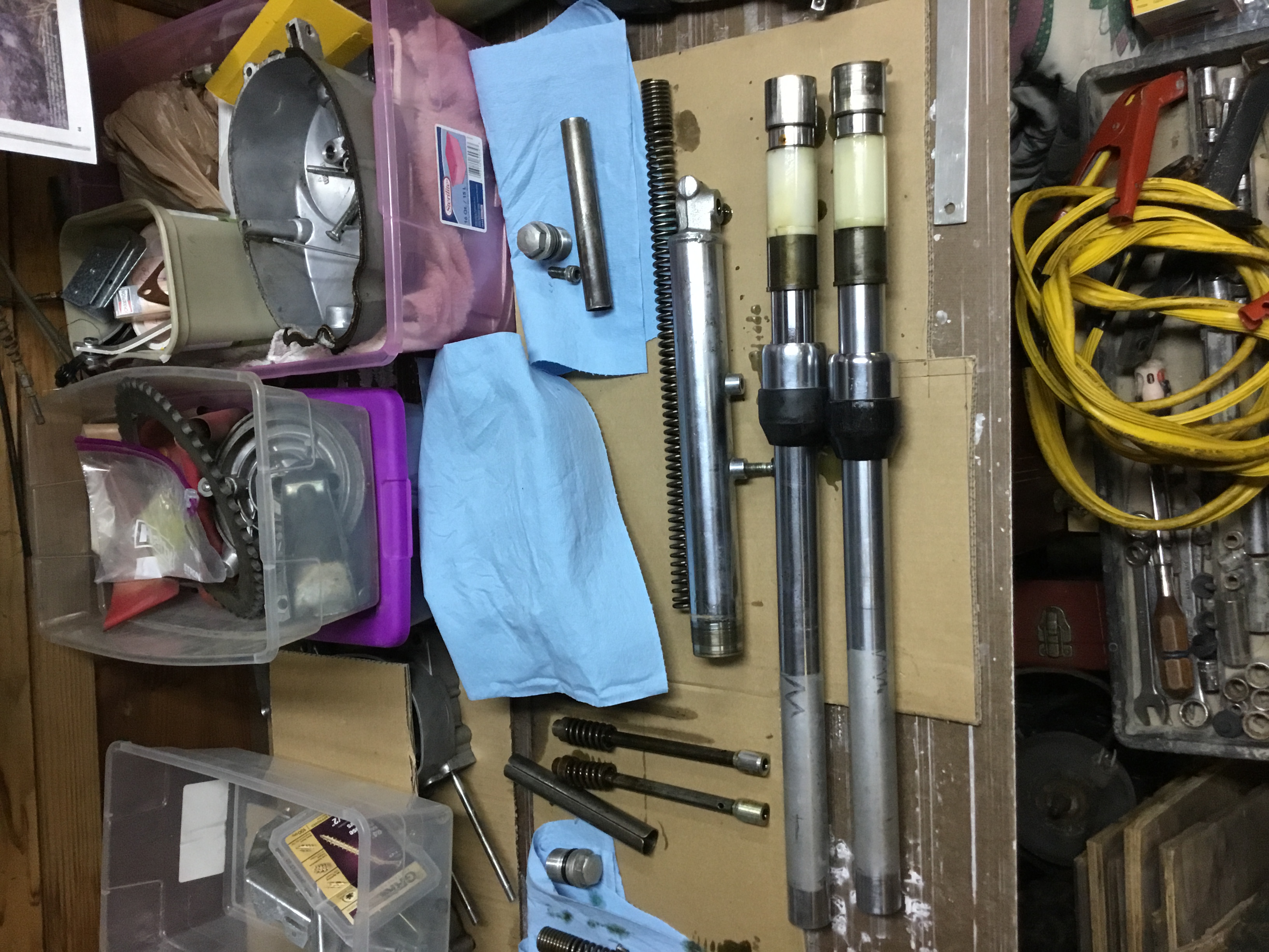

Went back out to take apart what I think are,maybe,92B forks and this is what I found. Three different lengths and one without the lower spacer. The two with the spacers were the ones on the wombat.
Okay, I maybe need to do more investigative figuring before I post stuff. From what I can tell the tube on the right with no white spacer is from a first year 93,which would probably explain why it,s bent.
