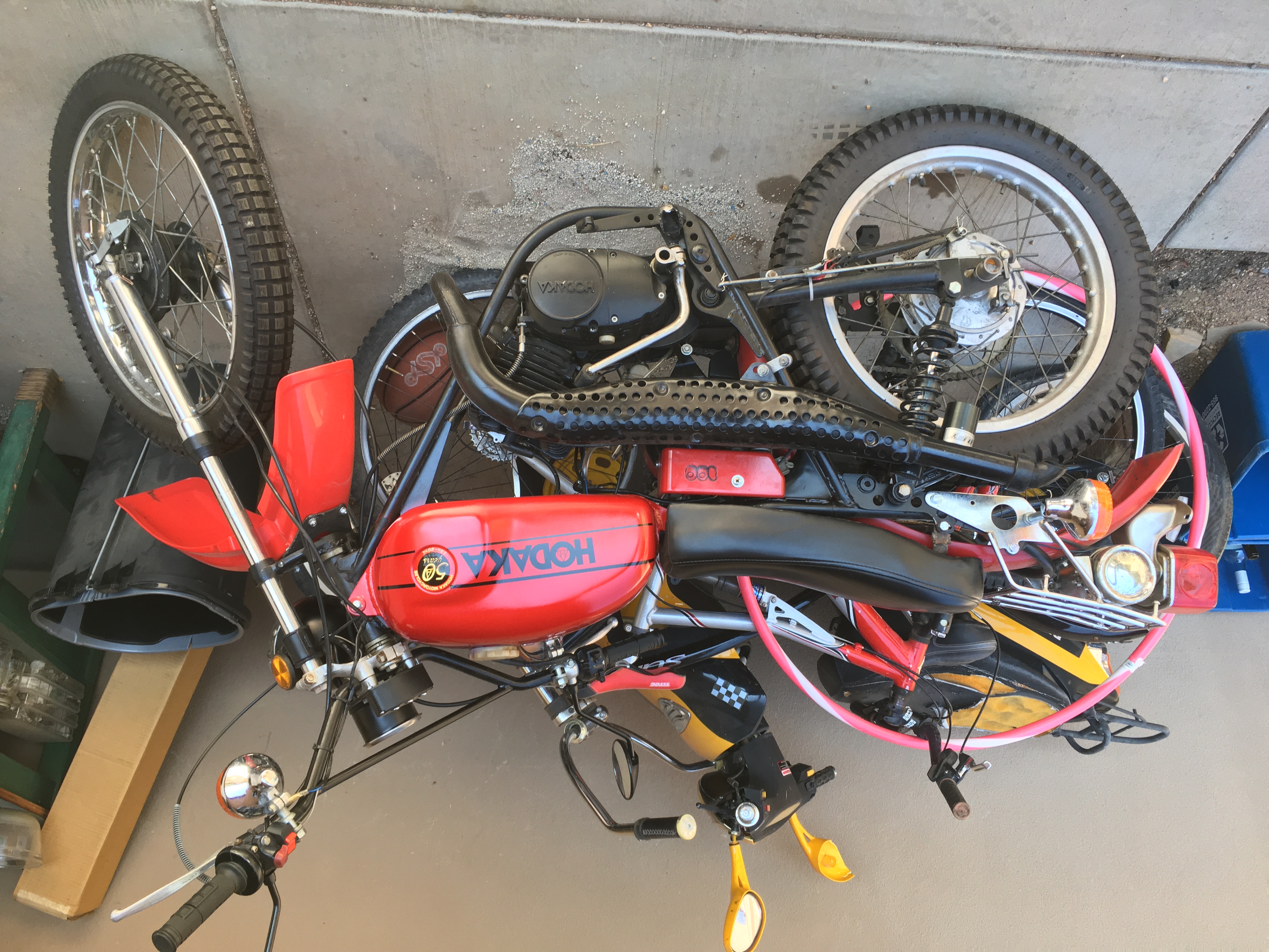

Well... I got the new tank painted and ordered another set of tank decals on Thursday.
Today, I went to remove the 50th badges which I bought from the club last year. I mounted them with a little bit of silicone cement last year.
I heated them up and couldn’t get the fishing line to not break. So I used a very small screw driver to pry them loose while hot. The black background came off the badges & took a lot of the gold on the numbers/letters with it!
I’m disappointed but I bought another set tonight. :ugeek: Victor

Well, I wanted this tank to look perfect, so I bought new 50th badges from the Club. Worth every penny and helps the club too! :ugeek: Victor
New tank, new paint, new badges, new decals!

Got the new tank on today, finally! She’s back together & ready to roll! :ugeek: Victor
