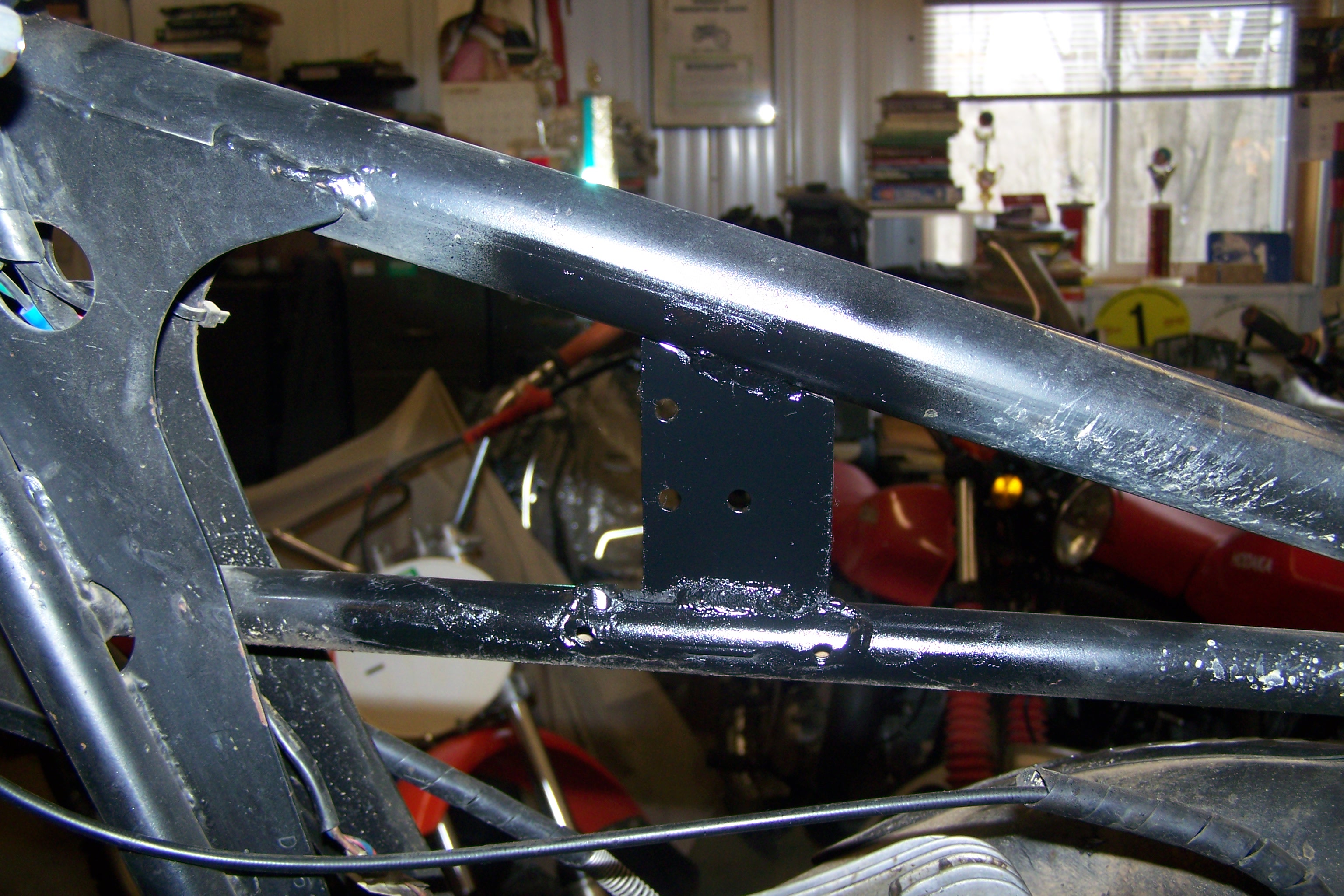

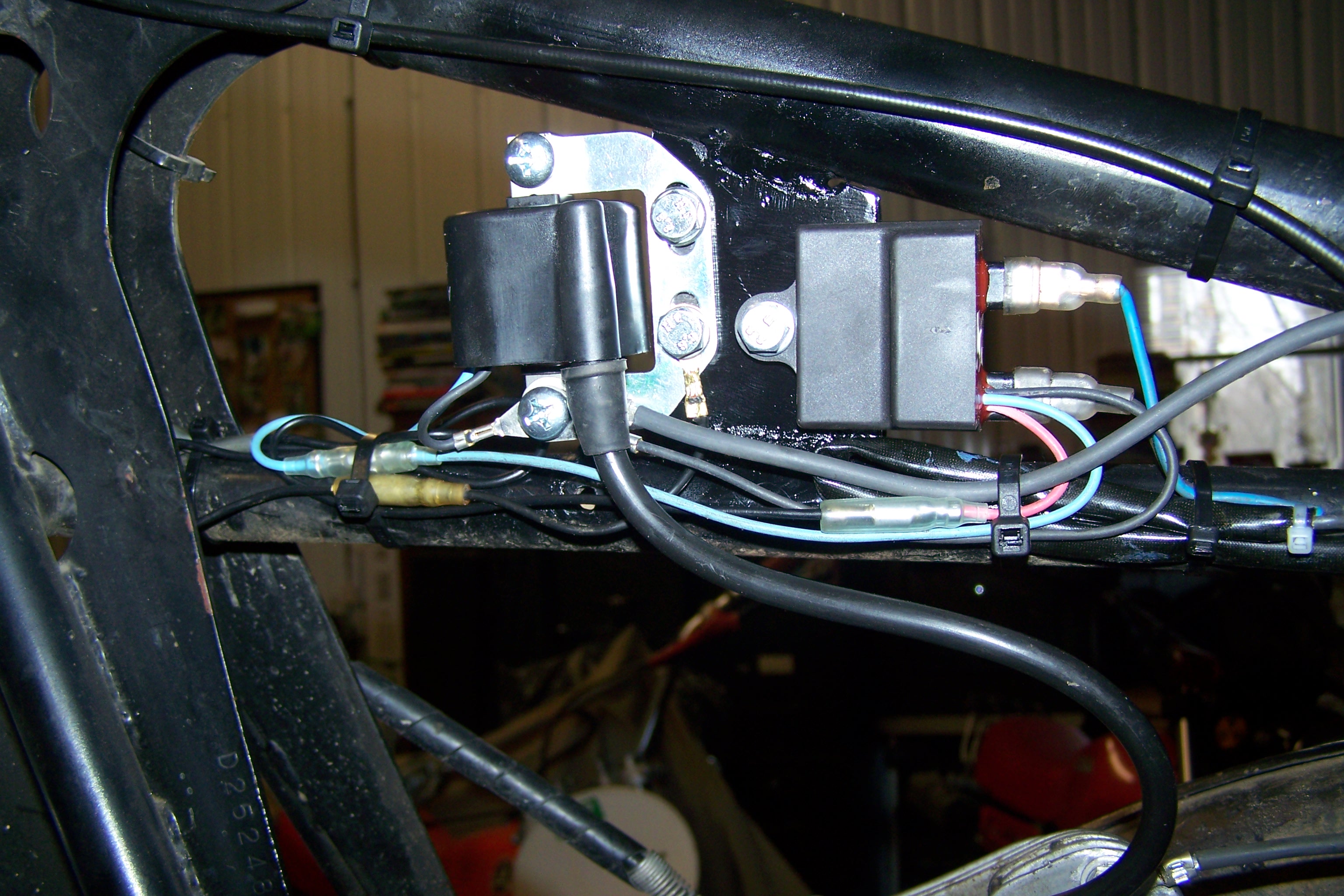

Looks like my CW will be much more reliable now that a PVL has been installed on it while at its winter home at the Super Secret Hodaka Research and Meditation Center in Western PA.
Had an incident last June when I broke down 9 miles into a 100 mile Reliability Run in Ohio.

You'll love it. I have them on all my dedicated race bikes including the CW and I've had zero problems ever!!

Hey Rich, The PVL is a really neat ignition system. Make sure you have a separate ground wire going from the frame to the coil. I have also seen others install a ground wire from the cylinder inlet stud to the frame under the tank. Good insurance.
