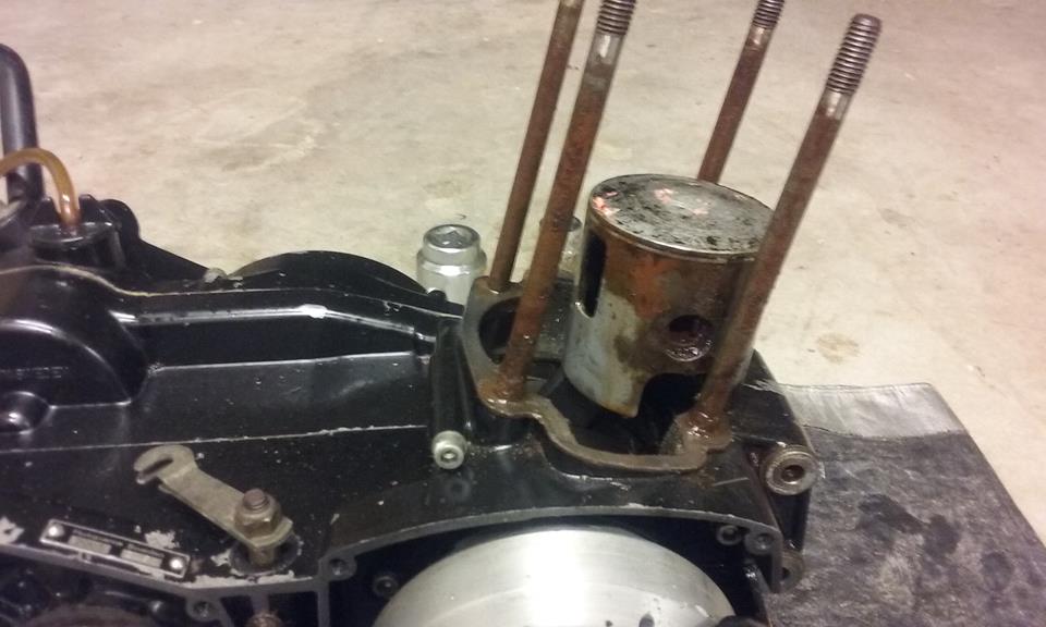

that may not work if the transfer ports or the exhaust ports are not covered...I had to do this a few months ago on a Husky motor that was stuck...soak the top and bottom of the piston for a few days in PB blaster. Lift the cylinder off the case to spray the bottom of the piston. Take a piece of a flat metal bar and drill 2 holes in it to fit the studs. Place an appropriate sized socket between the piston and the metal bar and start tightening. If it doesn't brake loose keep the pressure on and whack the metal bar with a hammer a few times...

Post by cuzncletus »
