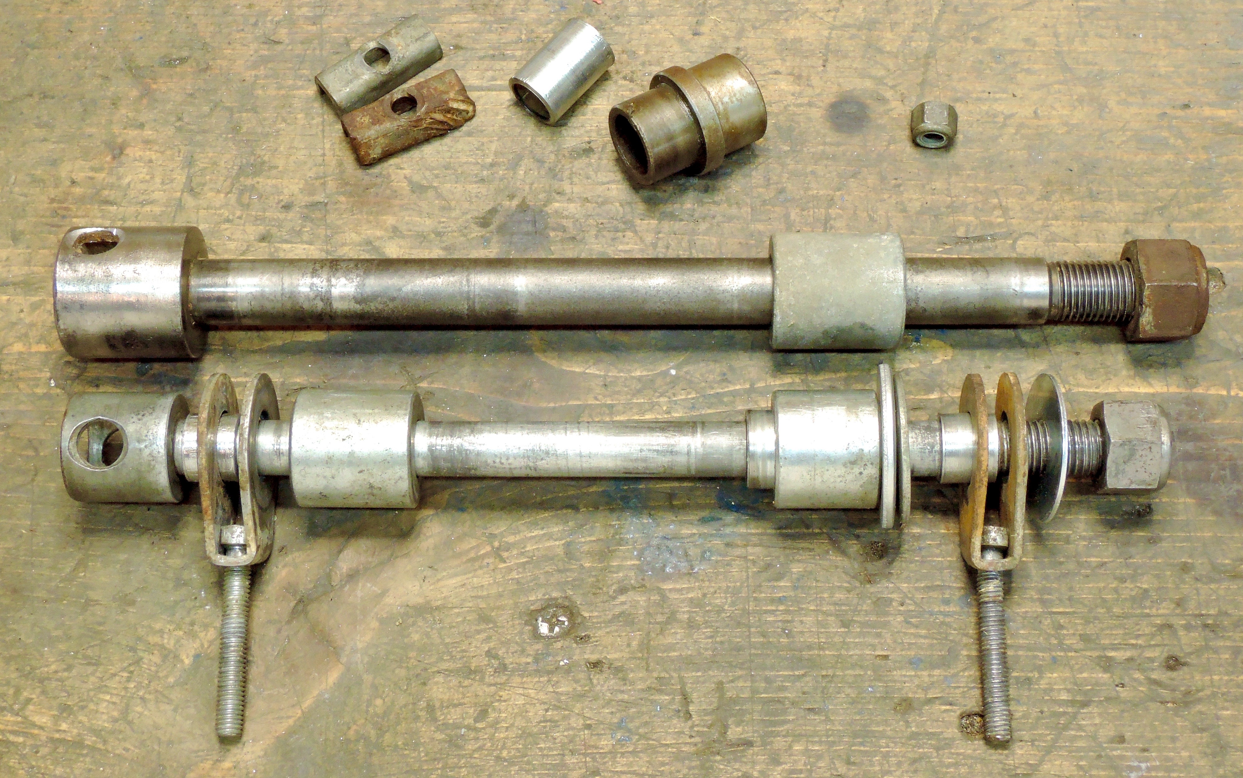

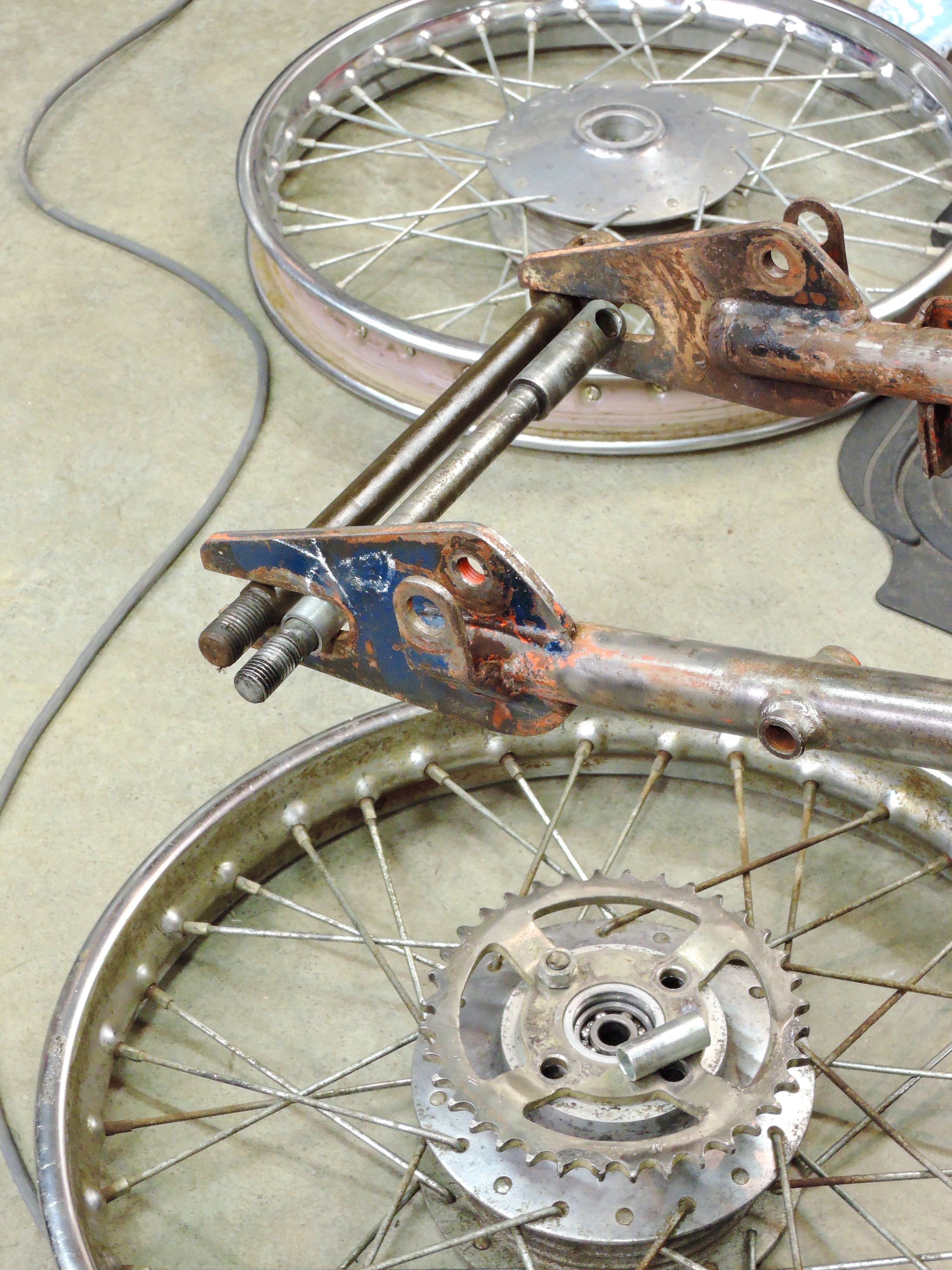

A quick update: Some major rummaging in the Hodaka shed turned up a barely long enough 12mm rear axle that looks like it will work. Some spacing and cutting two 15mm to 12mm axle collars to length for each end of the axle and I'll be in business. Whew! It might be a bit tricky putting this all together. We'll see. :?
Re: The 2 the Max Project

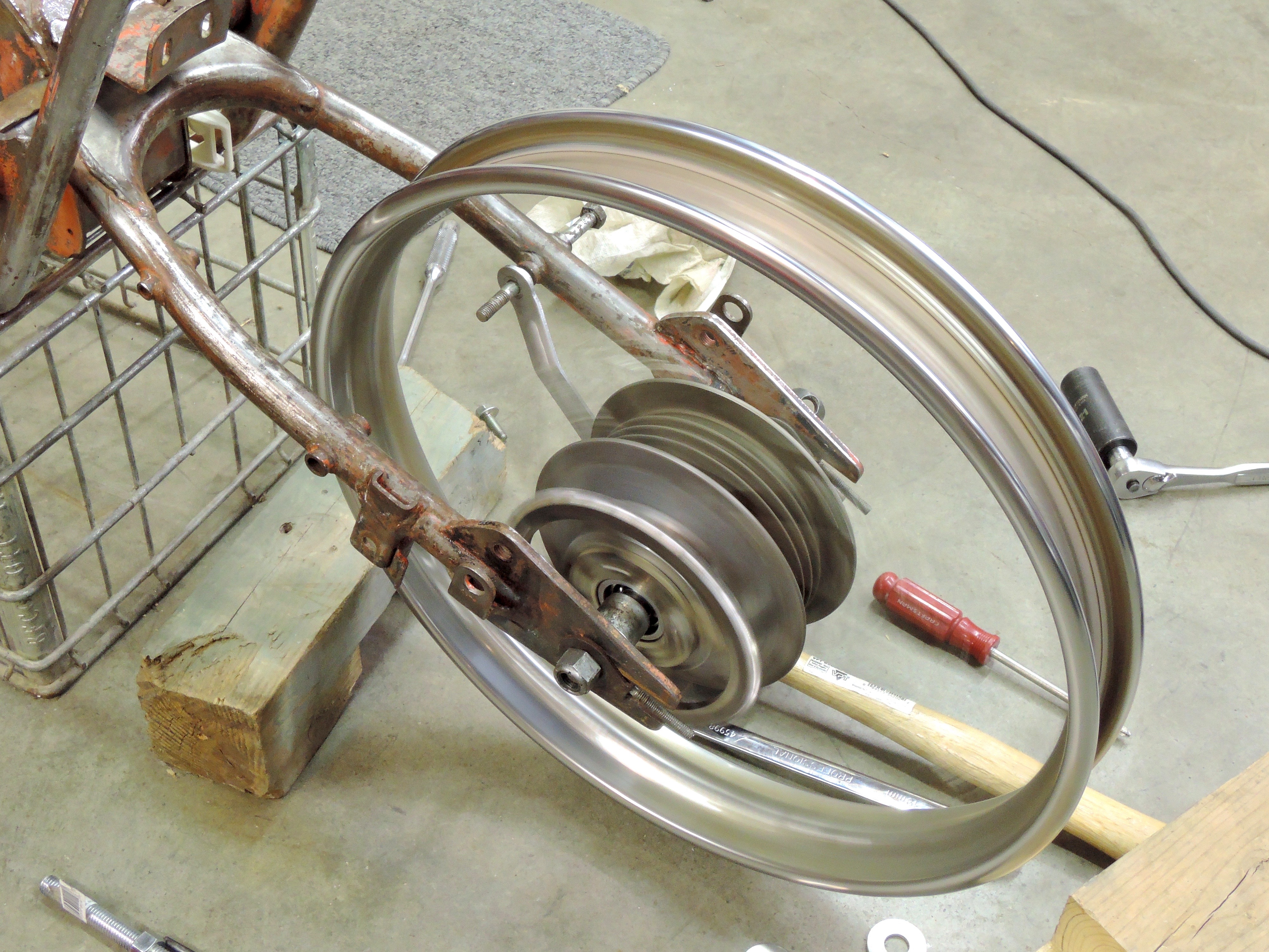

Cheez, what a bunch of fiddling to get the smaller axle to work so I can run the light 4-bolt hub. The advantage is now I can quickly change wheel and axle sizes quickly. All good for a multi-purpose racer of sorts. At least I can easily try different wheel combos while I'm in limbo. This thing could go several different paths yet. I may have located a twin cam brake 18'' wheel and hub for the front. If this comes to be I'll probably put something like the cush hub 18" Rat wheel on for a back and have 18s all around. If not I'm still set up for a pair of 17s. This is all fun trying to figure out what this thing should be. I know, not too exciting a report, but it does keep me thinking and plotting.
Spacers and such for two different axle sizes
Tested to 160 MPH. Not really, just kidding.

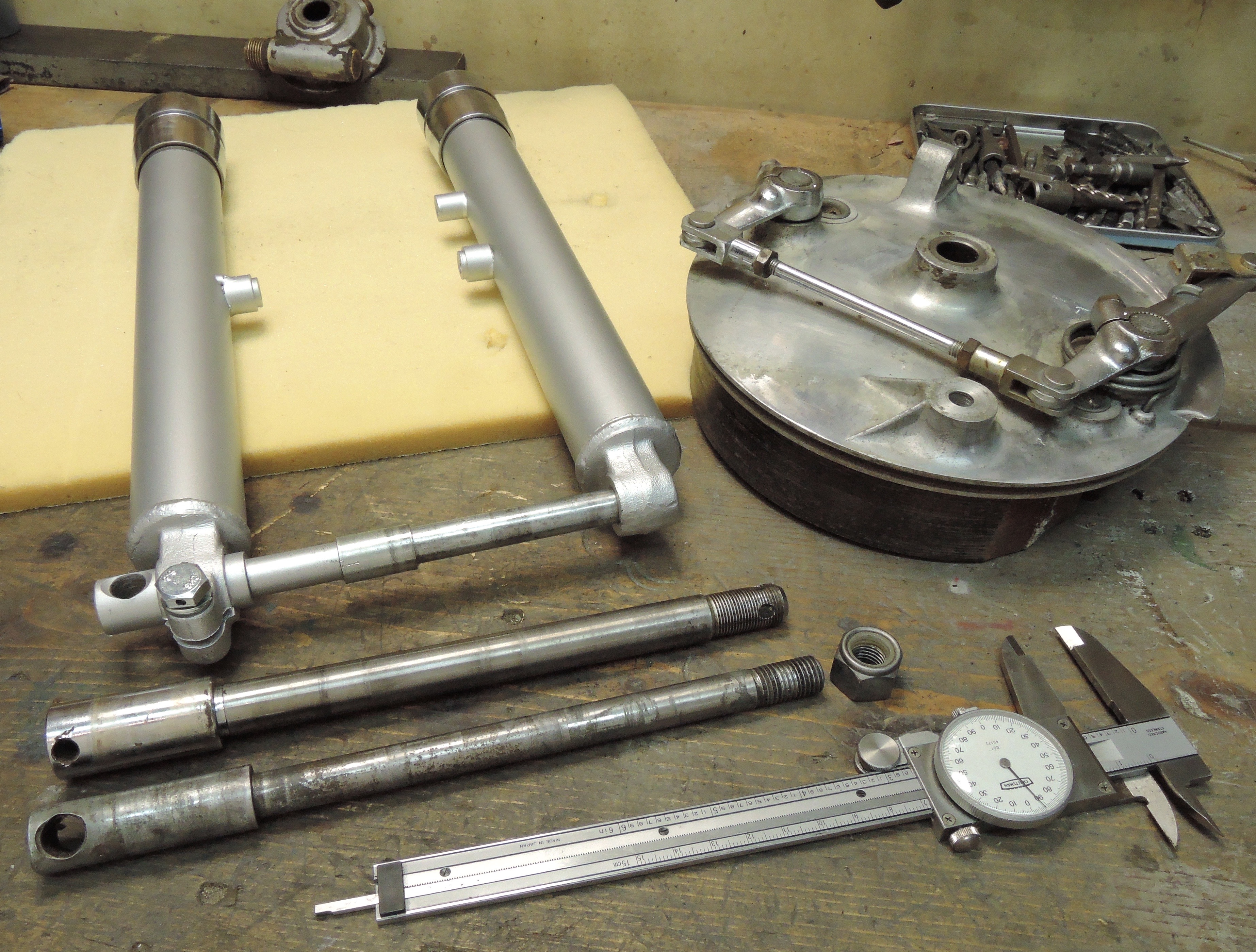

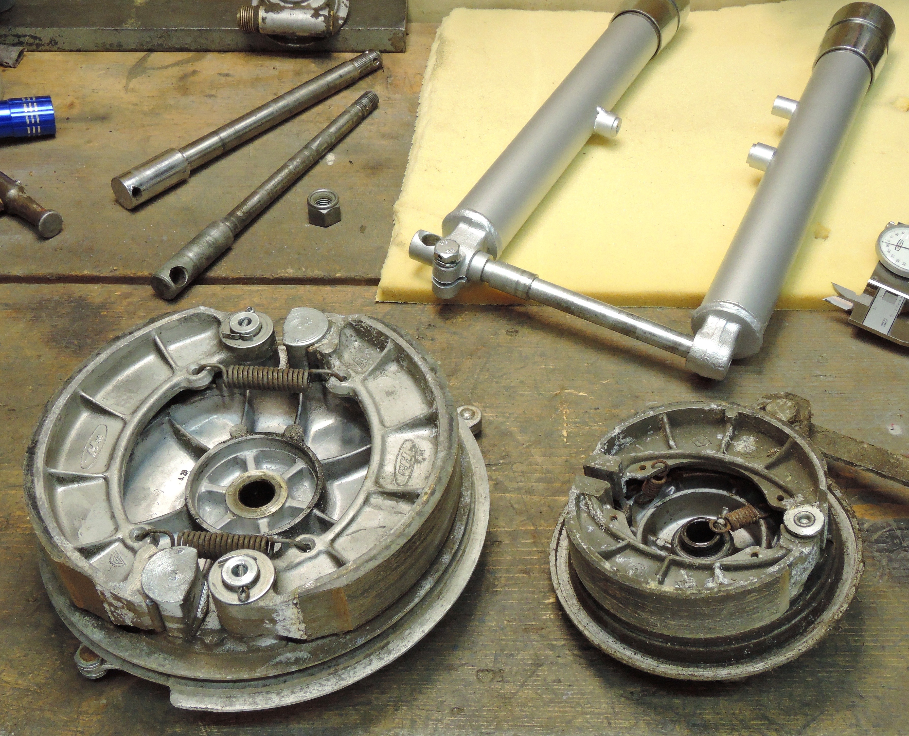

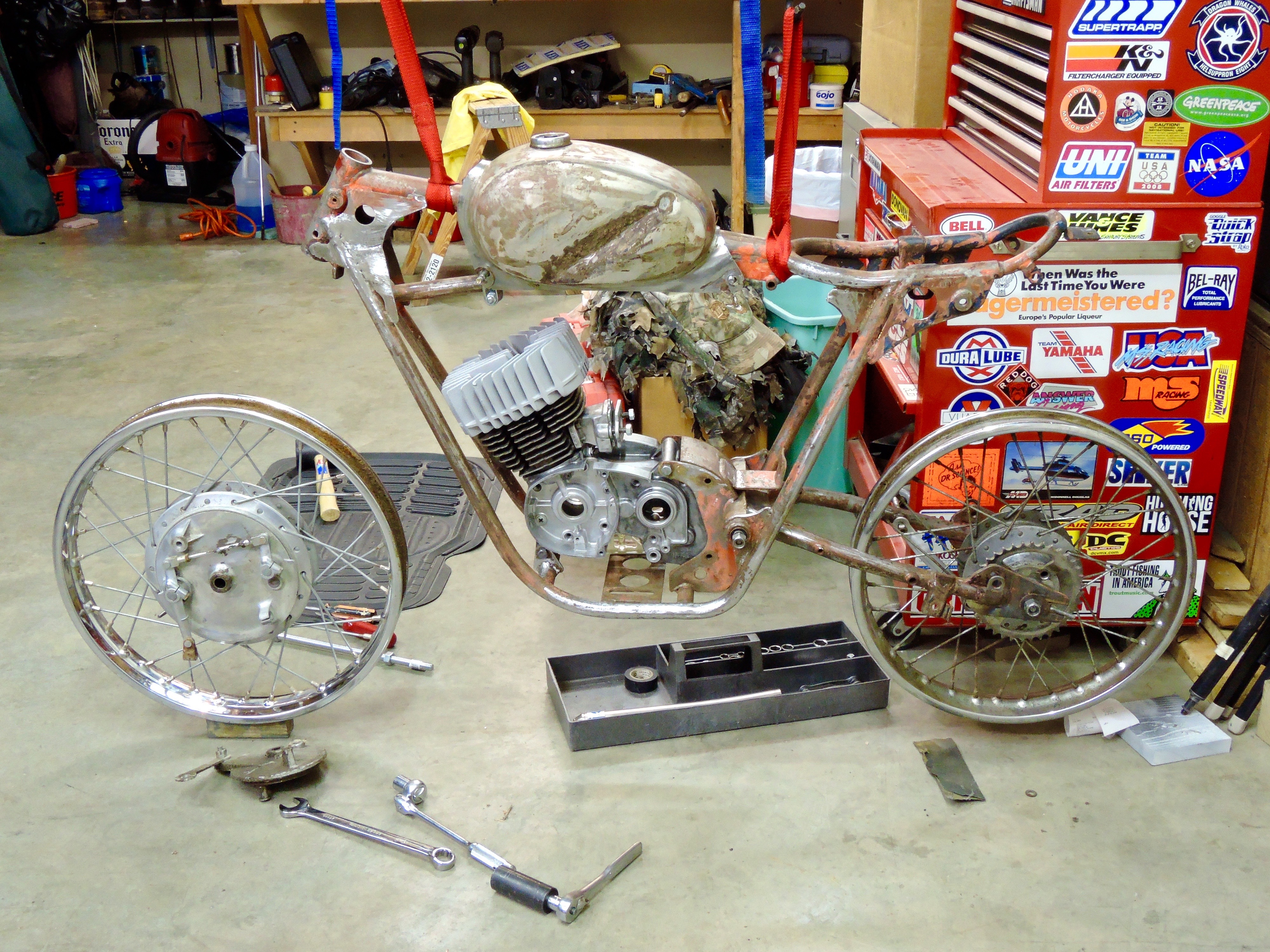

The twin cam brake 18'' wheel just arrived. It will not work with the Ace 100 forks as the axle is too big but it should work on some baby Cerianis that I can borrow off of the Day One Project which are cooler anyway. The wheel for the back can be a 4-bolt 18'' is the plan. Just a quick report as I haven't even measured anything yet.
Bigger brakes!
Bigger brakes!

I wuz a little stumped by all the references to 5mm and 6mm axles . . . um, still am. But on to another topic - the dual leading shoe front hub is pretty nifty to let go of just because it uses a larger axle. Have you considered a hollow axle (sleeve) trimmed to hub width plus a few thousandths, which will snugly accept the Hodaka axle to handle the fork to fork span? (will likely have to have some custom spacers on the axle to center the hub and allow for "clamping" to the "nut side" of the axle/fork assembly.)
Doing my best to keep things complicated, thereby violating the rule of, "Simplicate and add lightness."
Hey Ed, Yes, I may be able to sleeve the smaller axle to fit. I just took the thing out of the shipping box and took a picture of it. All I noticed was it had a larger axle. I'll look at it a little closer soon and see what all the possibilities are. I don't visualize very well and have to do hands on things with all the pieces. :shock: Another puzzle to test me. 8-) As for the axles on the rear wheels, the model 92 uses a 12mm rear axle while the 93 uses a 15mm rear.

Oops, My Chinese measuring device Is the culprit, at least who I'm blaming. I stand corrected, the cush hub 93 rear axle is 15mm and the 92 is 12mm. Does that sound better? Thanks for pointing that out Ed. The Honda axle is also 15mm, something will work. I read it wrong, Dumb. I was reading the wrong scale. Duh.
Cheez, I had to go back and change all the wrong posts. I think I've got it right now--Maybe. :?

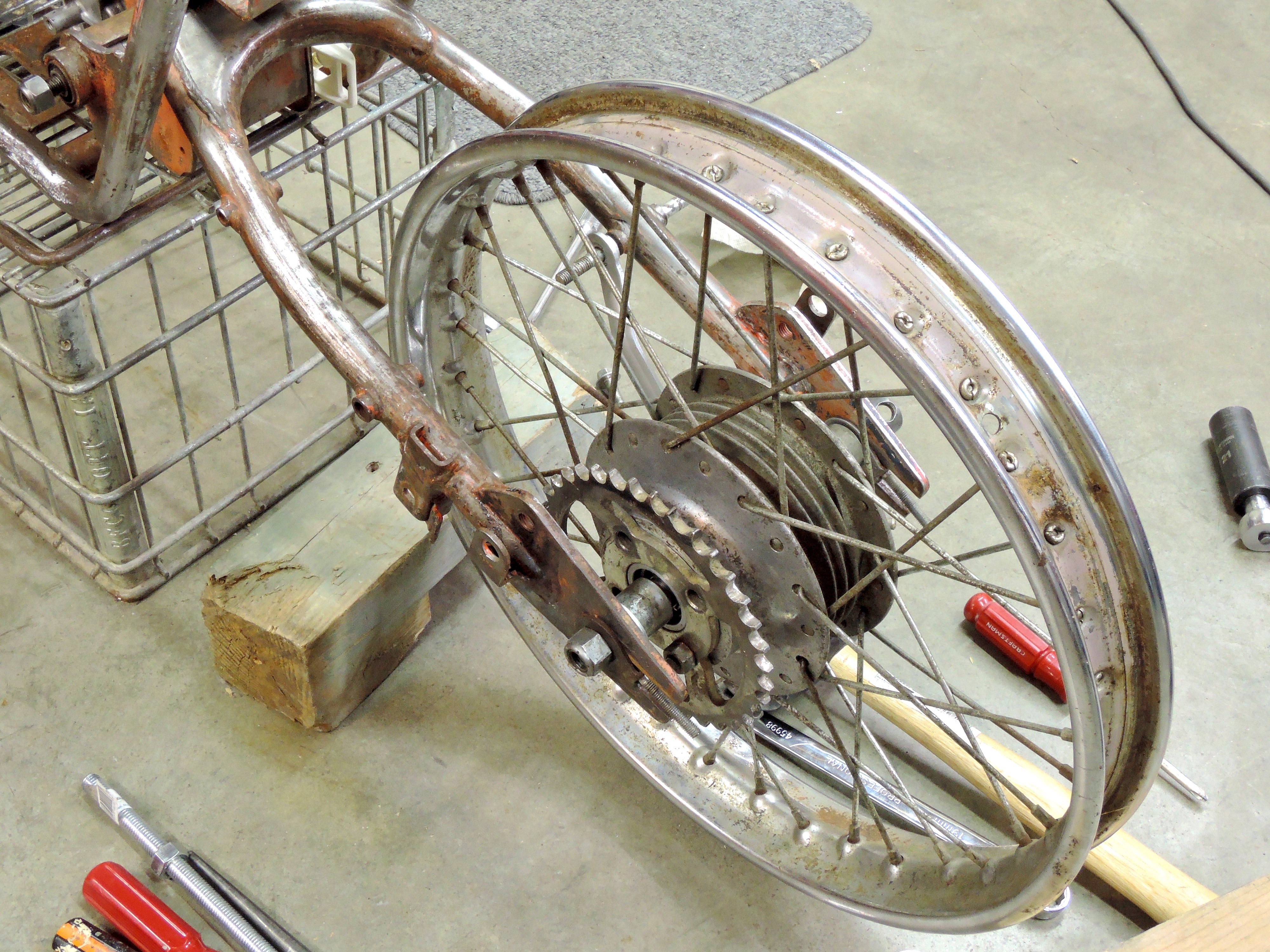

Some quick measurements this morning and this looks to be a relatively simple bolt on with a 12-15mm sleeve that I just ordered on E-bay. It should fit both the Ace 100 forks, Super Rat 93 and Cerianis. The bearings are sealed and smooth and I'll go with them. It does look like I'm going to to have to remove the speedo drive notched collar that is stuck in the wheel and/or cut it off. Minor stuff.
12-15mm collar on the way.

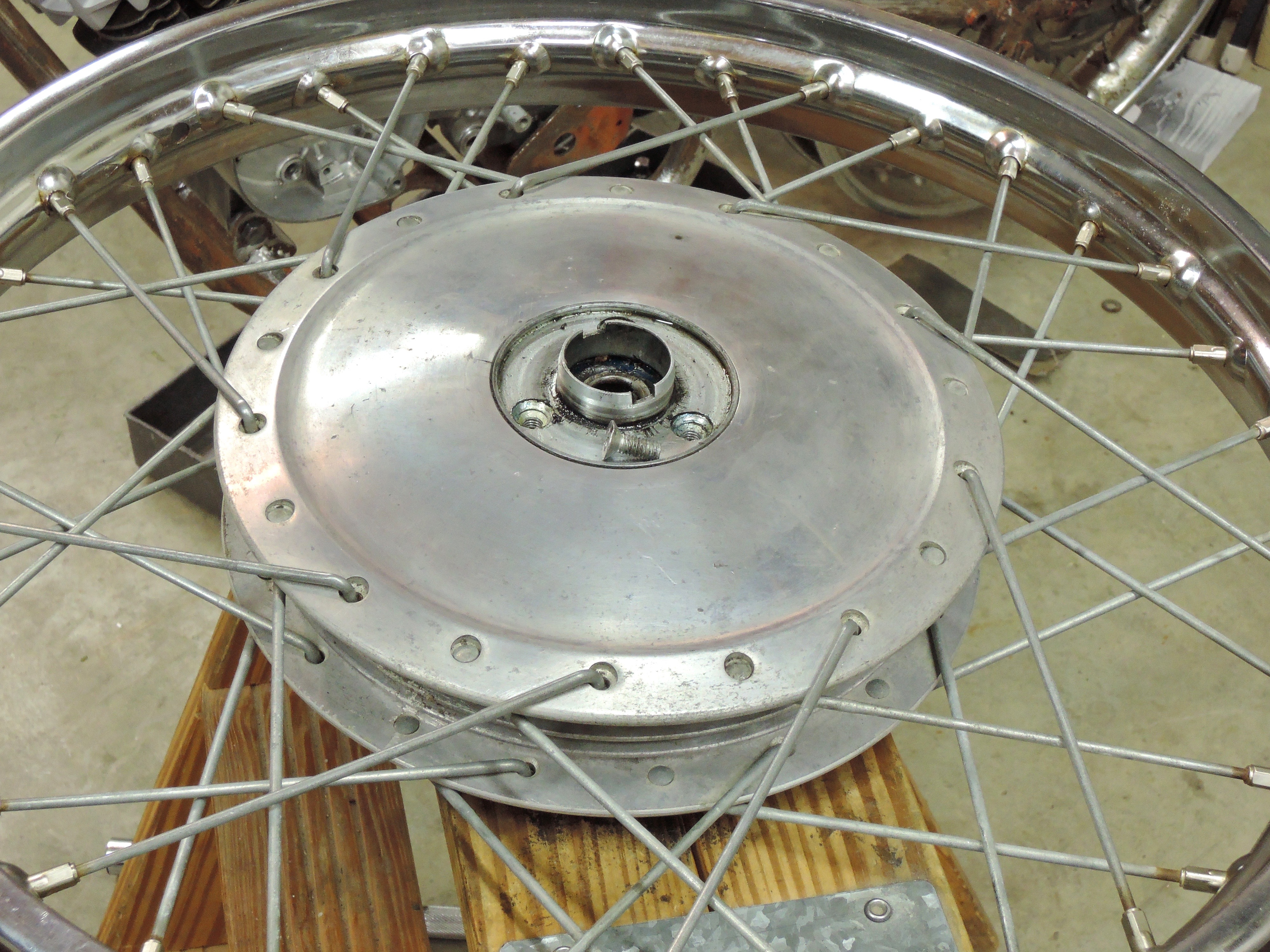

Like I said, adjustment of double leading shoe brakes can be fiddly. One shoe has contact the drum first and the other at a particular moment. If the other shoe contacts too soon, the brake can be grabby. If too late, the brakes won't self-energize enough. The cable adjuster and connector rod arrangement should be fairly intuitive on the adjustment. But see if you can get the factory adjustmnt procedure just in case there are tricks.
Those binders are going to look great, too.

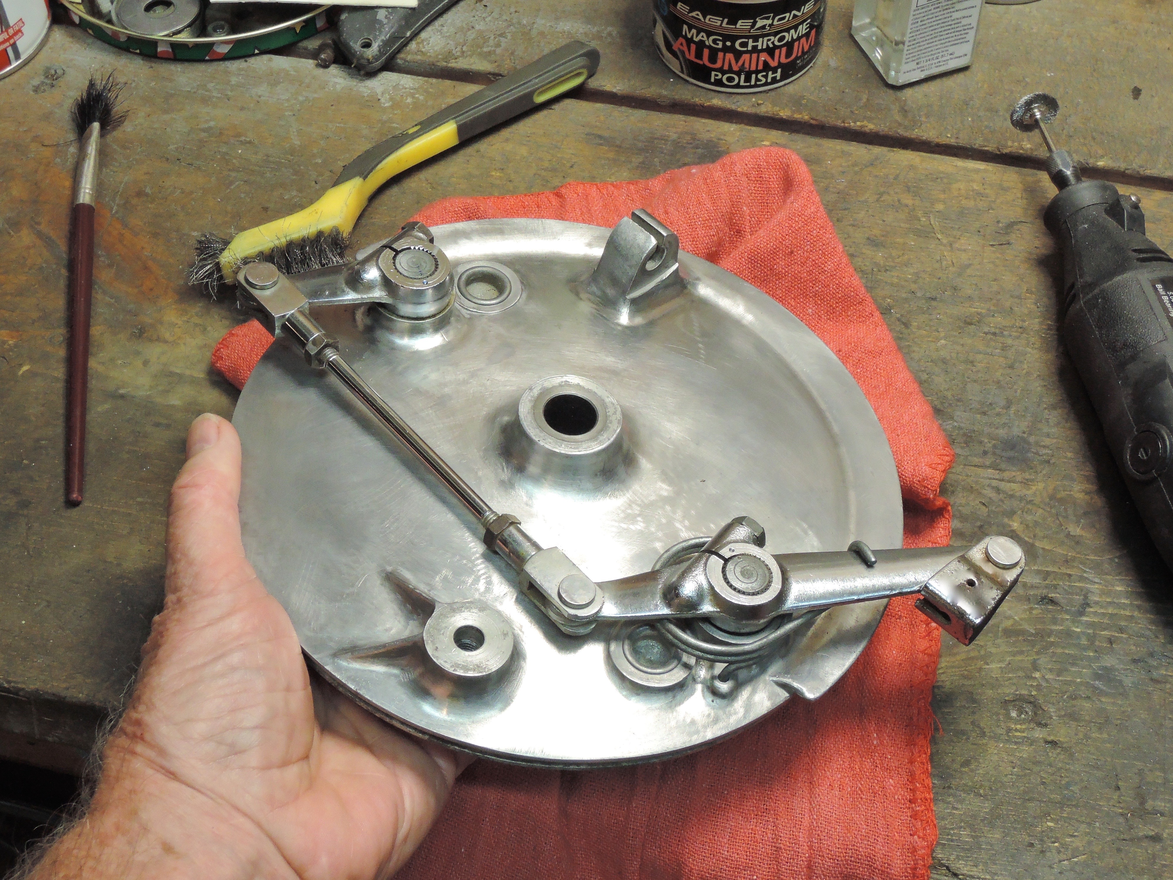

Yes, one of the rewards of motorcycle restoration. A fifty year old brake plate has been reborn. Time and elements had taken their toll. Seized shafts and sections covered with the stuff that is a mix of lubricants and earth that takes decades to fully set into one of the strongest materials known to man. It can hold it's own against wire brushes, solvents, degreasers, acids and miracle cleaners. Ah, but include time and manpower (me), it finally yields to removal revealing the clear (now yellow) plastic like clear coat of the day. It's never all there, some has worn through leaving shiny vs dull yellow.
Hey, I got the grunge off, now I can attack the used-to-be "clear coat". Let's try. I'll test an area where the coating has worn down in various thickness to bare metal. Carb cleaner and brake cleaner remove paint but no effect whatever here. Phosphoric acid aluminum cleaner, scary but totally ineffective. Brass and stainless steel brushes bounce over it putting new meaning to protective coating. I've saved the paint stripper to last. Not a curl even on the thin edges leading to bare metal.
Well, I knew all of this from removing said stuff from my XS-650 Yamaha cases a few years back. Disassembly and wet sanding is the only way. Places you miss show up when you wire brush as places that need more sanding.
OK, getting back to the point. There's nothing easy about restoration but nothing more satisfying than the final piece that you have worked hours on. Here it is, back to spec. Bare metal, shafts turning with the least of effort, a really satisfying mechanical sound as you work the linkage, ready for the project. Again.
Crazy huh?
Reborn
Reborn
