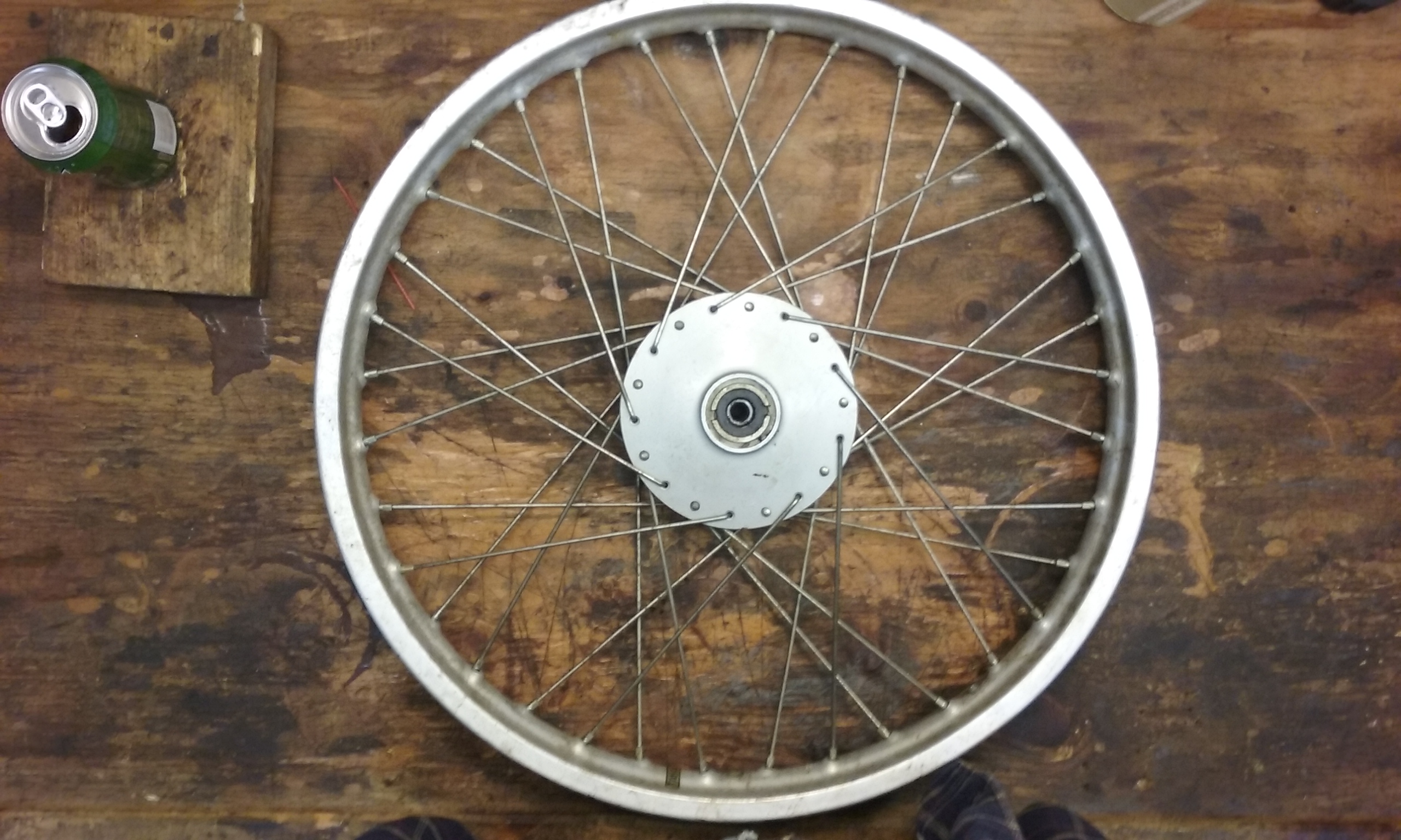

heads first on both sides (inners) ...ALL of them in the hub on both sides before you start setting them in the rim...then the tails (outers) one at a time on both sides...the outside spokes have about a 90 degree bend and in insides a little less...make sure you have them separated properly...here is a pic of the spoke pattern. the pattern skips 3 holes..make sure you start in an inside hole...skip 3 spoke the 4th...ship 3 spoke the 4th...let me know when your laced and ready to true... i have a pretty good method

Re: Respoking combat wombat wheel
Post by rough rider »
Thank you for the photo Squid and for your instructions. I have the rim now laced up but the outer spoke are over the flanges of the inner spokes on the hub....not right. I think the problem is following the instructions in the factory manual with a spoke overlap of three which these spokes are designed for an overlap of two spokes. We will find out. Thank you Dirty Rat, I will give call soon.
