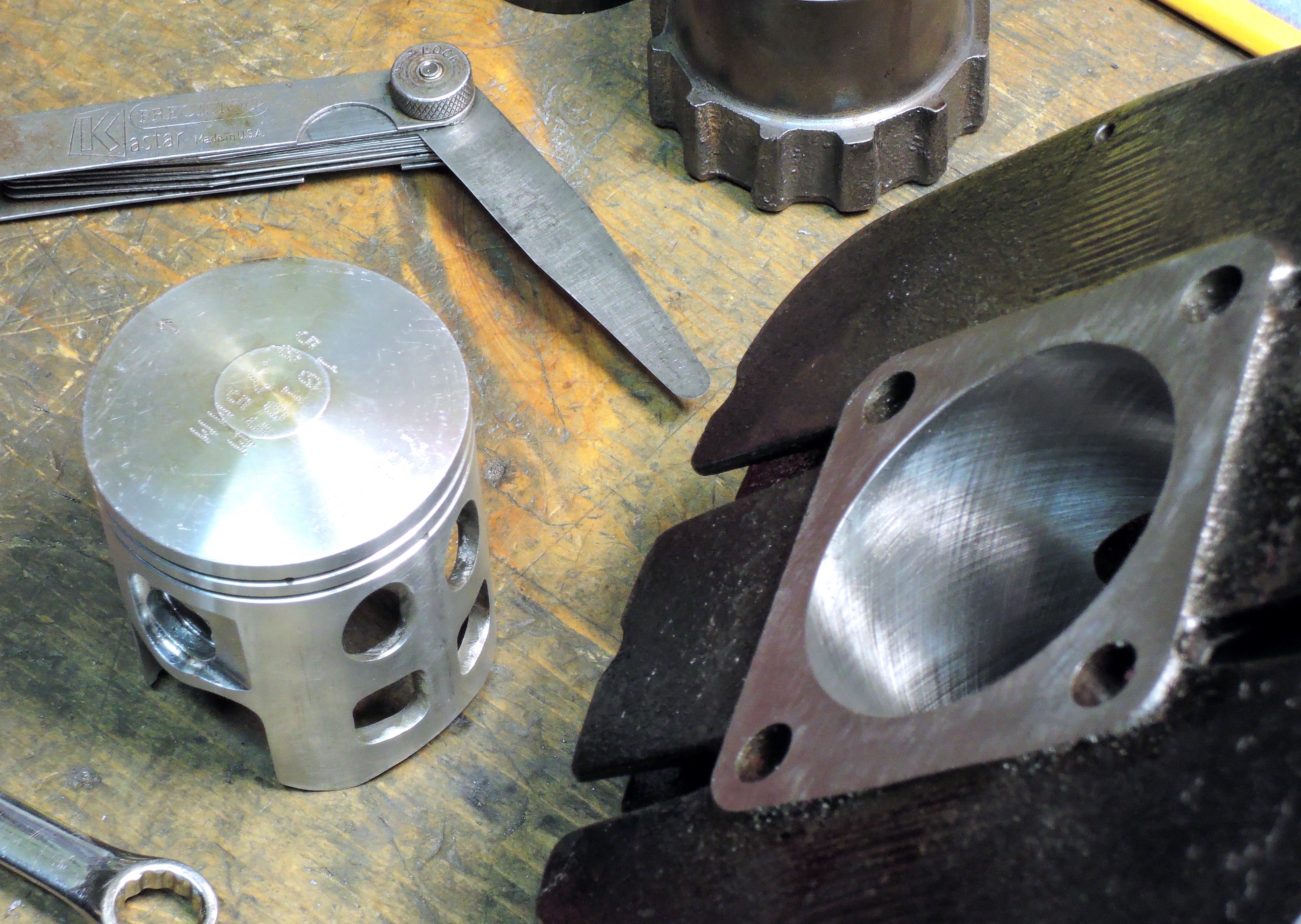

Harry said to use a pipe from a bultaco trial bike and it is a lot shorter overall, to the one you have. Could this be part of the problem with your jetting? Also looking at your piston it looks like the EX side has got hot...could this also be part of the pipe problem? If the pipe is not scavenging all that heat stays in the engine.
Re: Day One - New Project
Hey Doug and DR, thanks for the input. I think I'll know quite a bit more next week after a tear-down and inspection. The first thing will be checking for for damage and then shortening the pin and installing new proper clips. At least I can get rid of some variables. The exhaust is certainly experimental and can be evaluated then. I'll keep everyone posted. :)

Fresh bore/ more clearance.
