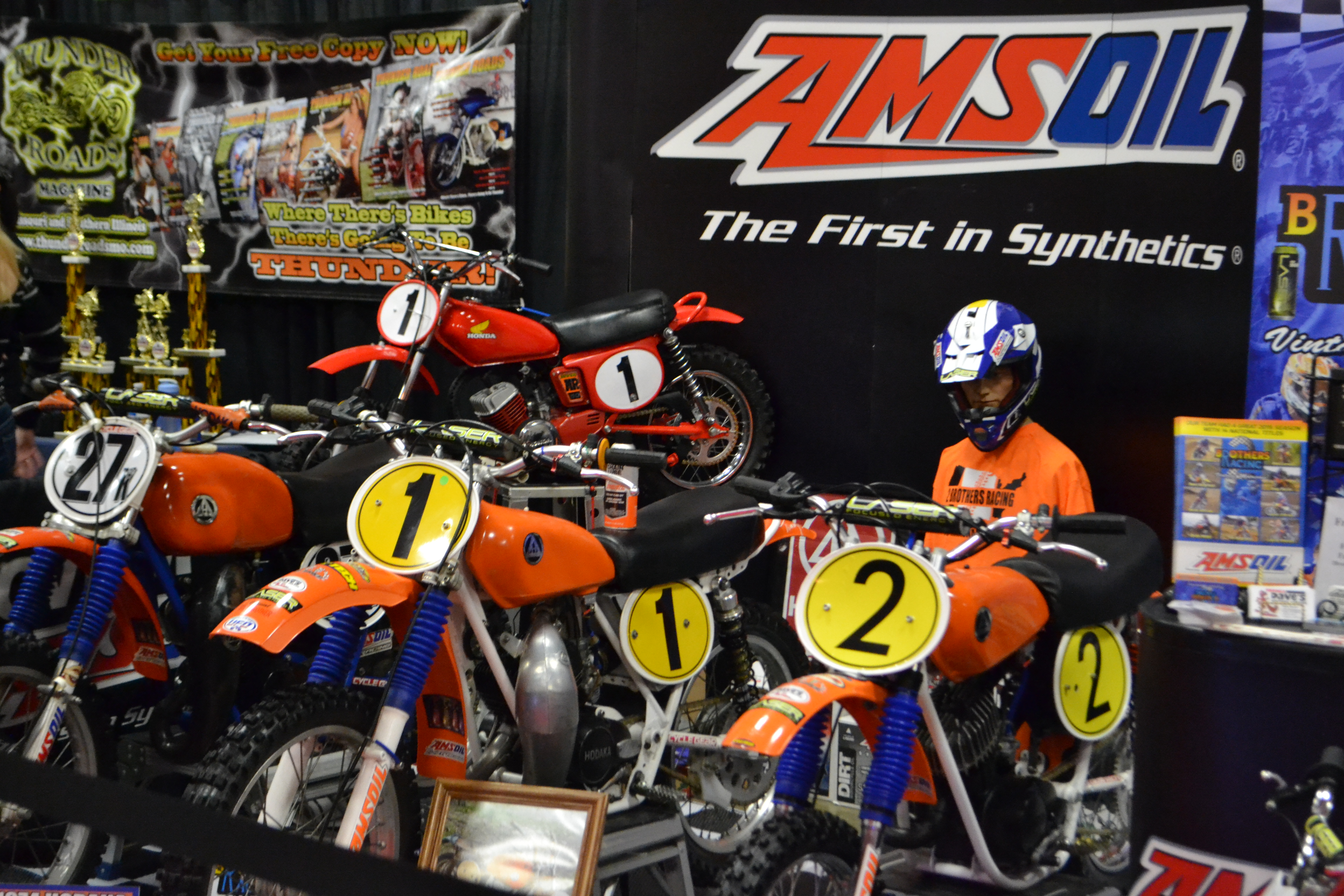

Here's a project we have been working on at the 2Brothers VMX Racing Team shop for the last few months. It was taken to Hodaka Dave's for final assembly using his expertise fabrication and knowledge. We built this as a 100cc Super Mini to compete in the Vintage Youth classes by my youth rider Reed Borgfield. It is built to the original AMA Minicyle Specs from the 1970's/80's when Jeff Ward came out with his famous Mini Elsinore. This has 16" rear and 17" front, 48" wheelbase and sits about the same size as the Hodaka powered Steens did that was so dominating in the original 100cc class. A Clarke Elsinore tank, New 40 year old Preston Petty fenders tops it off. A Hodaka Dave Rozier built Early Super Rat motor with a original Webco head off of one our race bikes from the 70's. We wanted to replicate this build to look like Reed's Dad's, AHRMA 100cc Expert Champion 1974 Super Rat. Follow us on our Facebook page as we get ready to fire this bike up.

Nice little bike that is , what forks did you use
racerclam
Posts: 588
Re: Hodaka "Super Mini" project done
Post by racerclam »
never mind I blew up the picture , looks like Hodaka forks
