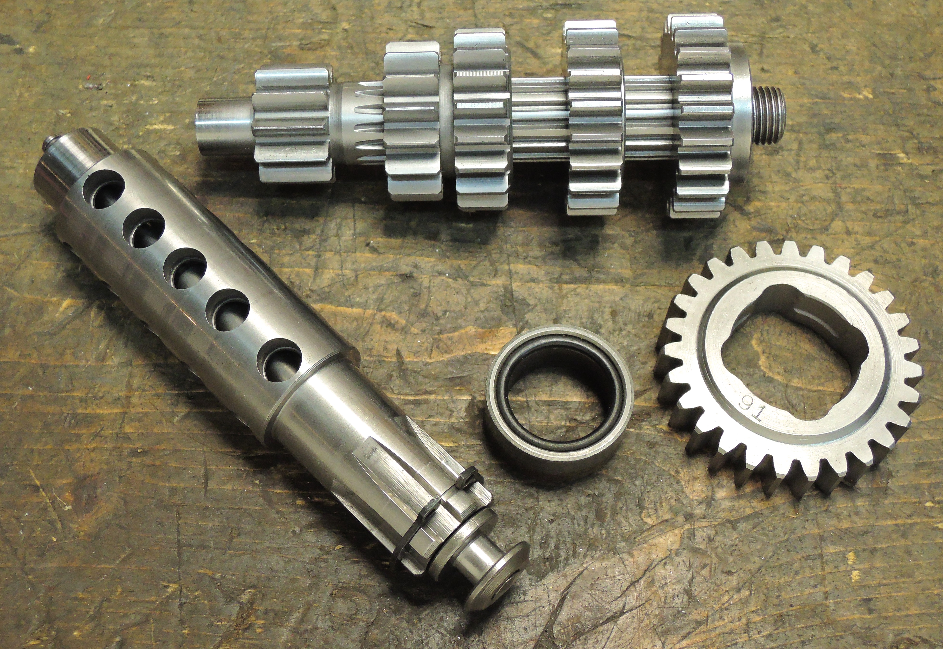

I bought this gear set in 2008 because I thought it was unusual and it was reasonably priced. It has the number 91 hand engraved on it. The description on the packing list says: "Close Ratio Gear Set for All Early Hodaka's from the Ace 90 to the 125"

The 91 gear set originally came out as a racing option for Ace 90s which were 4 speeds. They required some machining of the crankcases. I ordered the set for my 90 racer about 1966.(a close guess). There was a bulletin on it from that time and someone posted it on the Forum quite awhile back during a discussion of the close-ratio 5-speed.
The early ones for 90s came with a countershaft with a snap ring for the sprocket requiring a different sprocket collar with an o-ring to prevent oil leakage. I always thought that the splined main shaft was way cool.

Thanks for the picture and information. What you show is what I have.

I'm also somewhat curious how this will work out on the street. I have only driven the CR on tracks, keep us posted! AZ, I'll try to count them soon. (It is the Christmas season!) Maybe I can Just lay them out in a picture.
OK, while waiting for Santa I had a few moments to shoot one for you to analyze.

Are you sure your gears are close ratio? The tooth count as shown on the counter shaft is: 24/26/27/30/34. Seems like a wide ratio spread. The main shaft gears I am not sure. Are the stickies the tooth count for the three gears starting with the machined spur?
If so I get 21/20/18/15/11 as the associated counts. Trans ratios would be: 3.09:1, 2.0:1, 1.5:1, 1.3:1, 1.14:1. Maybe close and wide are relative terms. These also sound really tall. Is this a dirt track gear set? Or road race?

AZ, I only raced these short track. Harry Taylor recommended them for road racing also. This is not the set that I raced but they are marked 91. In road racing 4 and 5 need to be really close because you are geared so tall. As I remember low is taller in the CR than the WR. I bought this set last year to replace the set in my short tracker that disappeared between the time I sold it and found it decades later. I really hadn't looked at these until I shot the picture. We'll figure it out, I'm off to Christmas dinner!

Az, your count on the teeth are correct and it is the close ratio transmission. Most of the parts were 91xxxxR except the control shaft parts. -------Clarence
