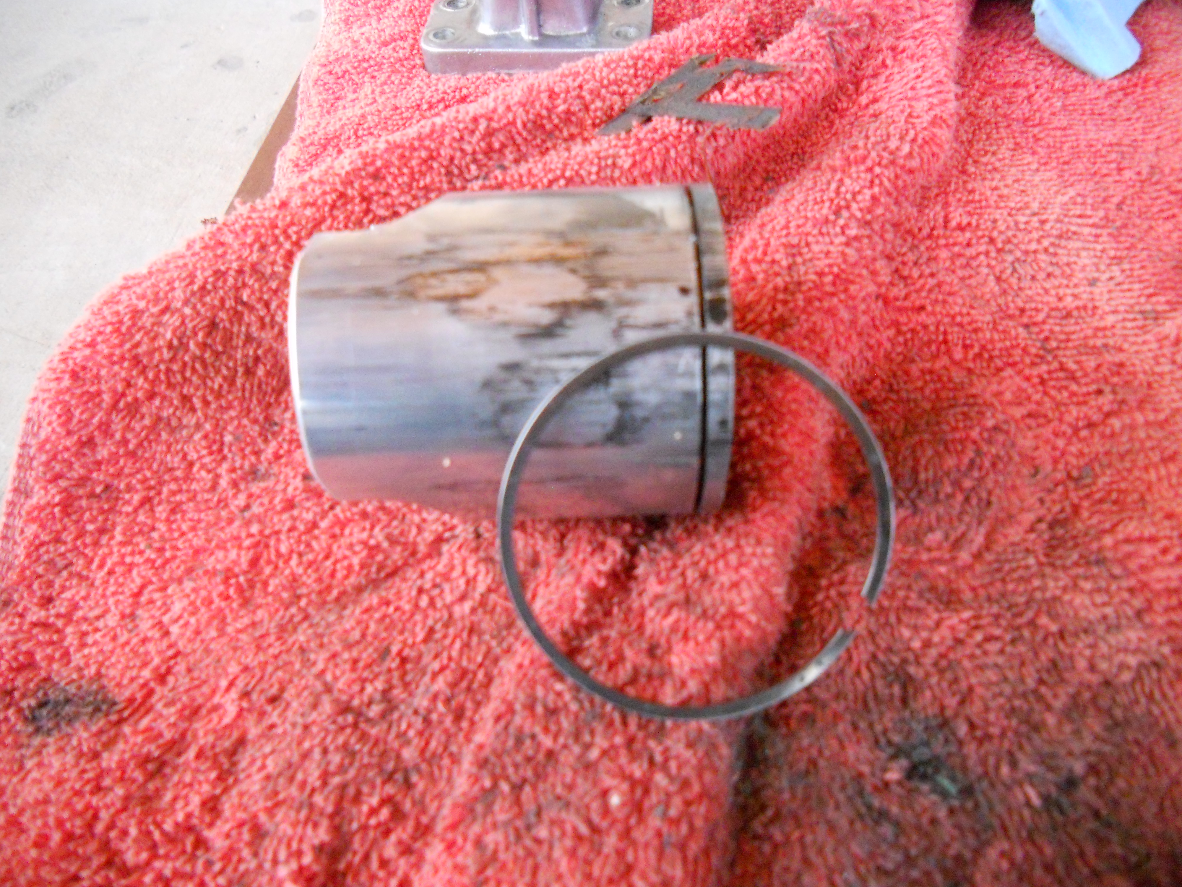

Got the old ring out of the piston , nope note broke !

Just for grins, slip the ring into the top of the bore, square it up with the crown of a piston, and measure the gap with a feeler. Just curious to know what it was or what it would be now. If 0.009" which I believe you said it was set to, it shouldn't have jammed. Still curious to know if the port was chamfered. Something caused lubrication to fail in that area of the exhaust port. Also, after you removed the damaged piston, where on the cylinder was the bulk of the damage, above or below the port. Or both. Just trying to get a sense of what happened so as to avoid a repeat.

Another question: are we looking at the exhaust side of the piston here? It looks like the ring locating pin is just to the left side of the piston which would put the ring gap just to the right of the exhaust port. I would think that was a crazy place to put a ring locator pin. Not familiar with Wiseco pistons so just asking. Does anyone know for certain where the locator pin should be (if that's what is showing in the photo)? Is it possible the piston was put in backwards???

Arizona Shorty wrote:Just for grins, slip the ring into the top of the bore, square it up with the crown of a piston, and measure the gap with a feeler. Just curious to know what it was or what it would be now. If 0.009" which I believe you said it was set to, it shouldn't have jammed. Still curious to know if the port was chamfered. Something caused lubrication to fail in that area of the exhaust port. Also, after you removed the damaged piston, where on the cylinder was the bulk of the damage, above or below the port. Or both. Just trying to get a sense of what happened so as to avoid a repeat.
Gap turns out to be .009 sloppy . The ports are chamfered . there was little marks above the exhaust port half way up , very minor , hone took them off with about 6 go through ! Lucky on that part !

Does the piston have a cast-in or stamped arrow on top? If so, it points to the exhaust side. Take a look. Verify the piston was installed with the arrow toward the exhaust. I guess I have just never seen a 2-stroke piston with the ring gap forward. Unless it is just the photo that makes it look that way.

Arizona Shorty wrote:Does the piston have a cast-in or stamped arrow on top? If so, it points to the exhaust side. Take a look. Verify the piston was installed with the arrow toward the exhaust. I guess I have just never seen a 2-stroke piston with the ring gap forward. Unless it is just the photo that makes it look that way.
LOLOL Shorty you see it wrong , ring gap was rear off side !! all good there .. LOL and yes I had it the right way ,...

Darned photos. When I enlarge the shots, they fuzz out, but good to know it was right side around. I hate auto focus devices.
