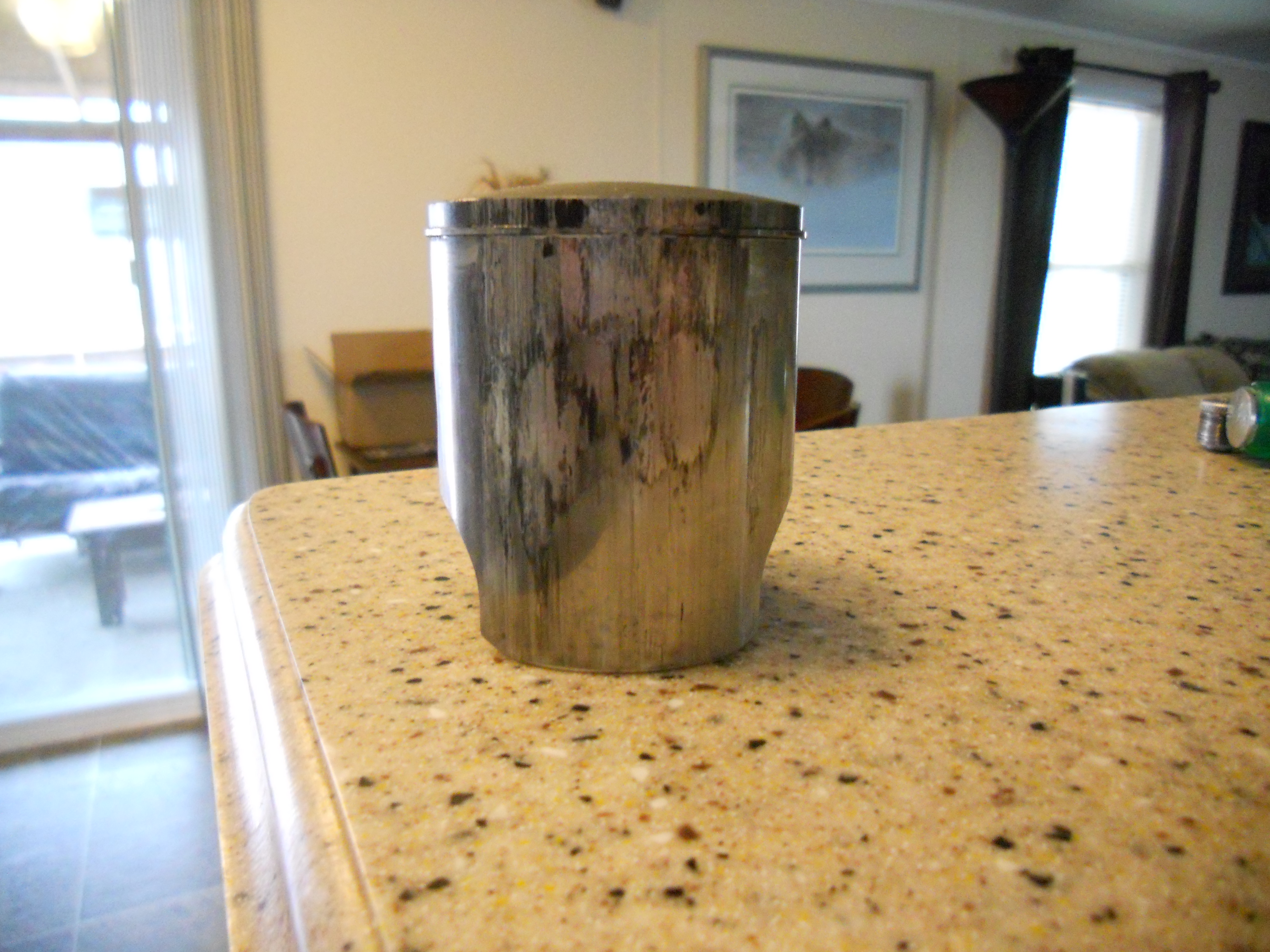

Ramble all you want it all makes sense ! Here is the piston , ran the hone about 4 to 6 times up and down and it cleaned right up ... Oh and its manly on the exhaust side ...
Taz

That was a pretty hard seizure. The picture gets a bit fuzzy when expanded but looks like some of the ring is missing in the area of metal transfer. Since this was a new piston and ring, I have to ask - who set up the ring clearance? Was it built by someone else for you, or did you install the piston and ring?
The reason I ask is this: new piston and ring are rarely if ever ready to install as they come out of the package. The ring is most always too long, intentionally. You have to set the ring end gap to suit the installation, which Wiseco can not control. Nor can any other manufacturer, which is why the ring is made a bit long. The end gap needs to be filed to spec to fit your cylinder.
The ring in your case appears to have jammed up tight end to end, and may have even forced some of the ring to expand into the exhaust port, either distorting the piston ring land or shearing off some of the ring. In either case, failure would be moments away.
Another often overlooked aspect of a new piston is the wrist pin. Rarely is the out of the box pin clearance correct for the wrist pin, and here I can only guess why. My guess is tolerance control. Pistons are made, in this case, by Wiseco, but the wrist pin is made by a different machine shop. Pins may be held to a stated tolerance, as would be the pin bore in the piston, but the combination of tolerance as between pin and bore can't be strictly controlled, so the bore is generally a bit small, and pin fit will be really tight. The pin bore needs to be lapped until it fits the pin with a push fit. It shouldn't fall through the hole, but it should not take tools to push the pin into place. Too tight a pin will grossly shorten piston and rod life, but would not cause the seizure you had. Only mentioning it because it is part of piston fitment.
Closely inspect the upper edge of the exhaust port and see if there is any collision marking there. If there are burrs, dress them out and be sure there is a bevel on the upper and lower edges of the exhaust port, as well as all the other ports.
If you didn't set up the ring on installation, ask the one who did what gap it was set to. If you did it, what gap did you use? You may want to open the gap to the high side of recommneded gap. Better to have a bit too much than not enough gap on the ring.
Practice varies between techs, but I don't rejet for breakin. I have been known to use a richer oil mix for the first tank, but only a little. Too much oil just makes it run hot, and overly rich engines can also run hot, so I don't rejet. Varying engine speeds are okay mostly because it is hard to run a bike without varying engine speed. Long sustained full throttle is of course not recommended for fresh engines. I would say just ride normally, but not for long periods. Get the engine fully warm by riding around running through the gears and not pushing hard, and then park it and let it cool fully. Repeat. Repeat again. Each time ride a bit farther between cycles but let it cool down between runs. After a half dozen runs or so, it is about as good as it is going to get. Unless you have a nitride bore, two strokes break in pretty fast. Just stay away from peak rpm pulls until it has some hours on the clock.

Bore had 3000 clearance and I set ring gap at .009 ports had no edges ... So far I have found in carb that the ring on the needle was one mark leaner than the middle and the main jet is a 150 , I'm still tearing into things ...

All good info from AZ on ring end gap and break-in. When R pistons for Ace 100s were $8.00 and $2.75 for a ring,(plus $8.00 for a rebore) break-in didn't seem as important as it is today with $150+ pistons, maybe that's why I'm overly cautious on my personal rich break-ins. :lol:
Of course a new piston/ring looks to be needed. I have salvaged a piston like that but it usually is not too successful. It's hard to get the ring out without breaking it. If you do succeed you can measure the end gap in the cylinder. Repairing damage to the ring groove is tough (but can be done with small files and such) to restore the clearance needed for the ring to move freely and perhaps worth a try, what have you got to lose? If all that works sand the high points off the piston and check clearances. Might work--maybe. :?

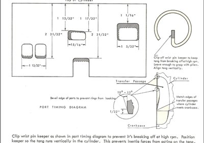

Cool Taz! We don't want you to sell out. Here's a diagram of the port chamfering that AZ was talking about from an old bulletin about flat track modifications. As AZ says, very important. Keep us posted on the project!
Port Chamfering-ONLY ON THE TOP AND BOTTOM!

hodakamax wrote:Cool Taz! We don't want you to sell out. Here's a diagram of the port chamfering that AZ was talking about from an old bulletin about flat track modifications. As AZ says, very important. Keep us posted on the project!
NICE !
