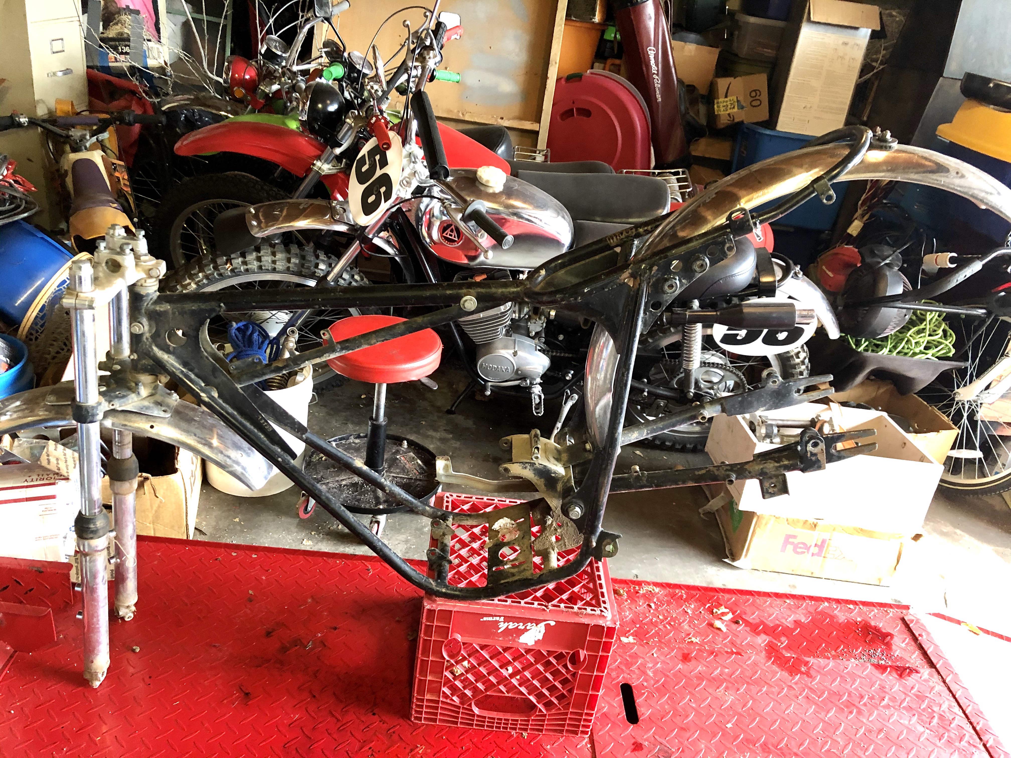

Here’s the frame for the reeded Combat Wombat motor! It’s a C frame, #13720. It is a Model 94 frame as the frame number is lower than 14,500.
First thing I’m going to do is clean, Polish & rebuild the front forks and clean and pack the steering head bearings.
Next after the fork rebuild and before fork re-assembly will be painting the frame.
I could use a better front fender. This one appears to have been drilled for an Ace B low fender mount. If someone has one they can trade, or sell, I’d be very interested. Here we go! Motor is estimated to arrive back from Canada next Monday. Victor

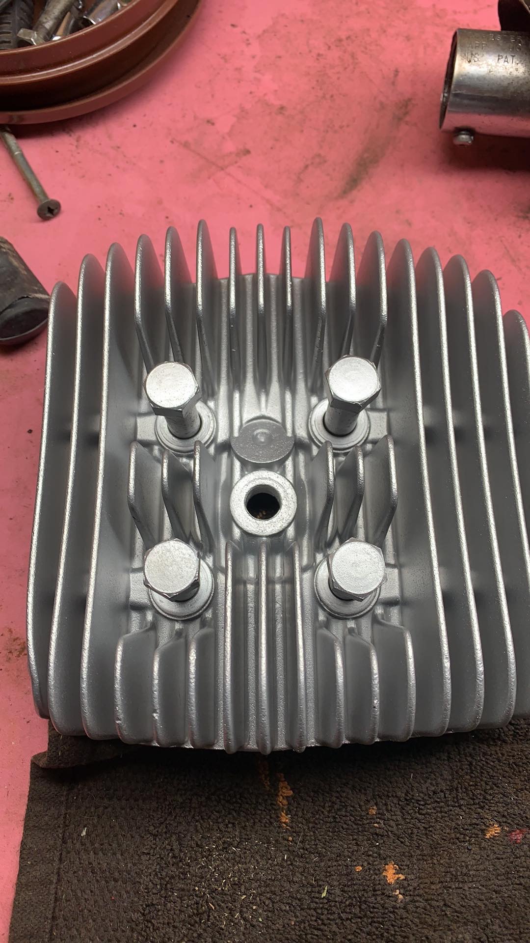

It went to Canada because the guy I asked to vapor blast it here F^<|<€|) it up. He soda blasted it and then did something else which made it look sand blasted.
Kevin, Alan’s guy who does Alan’s vapor blasting said he would fix it. I’ve seen Kevin’s work. And I trusted him. There wasn’t anyone else here in the entire state I could find to send it to.
He had to plastic ball blast it first to hammer the finish back down before vapor blasting it. It’s still not smooth but it’s a lot better. You have to zoom in on the pics to see how badly the first guy screwed it up. I am supposed to receive it Monday.
It’s not going to be the beautiful motor it could have been thanks to the first guy. I just wish he would have told me that he didn’t have a vapor blast machine to begin with, because that’s what I kept asking him for. It’s going to be a different finish for sure. Here’s a before & after. Victor

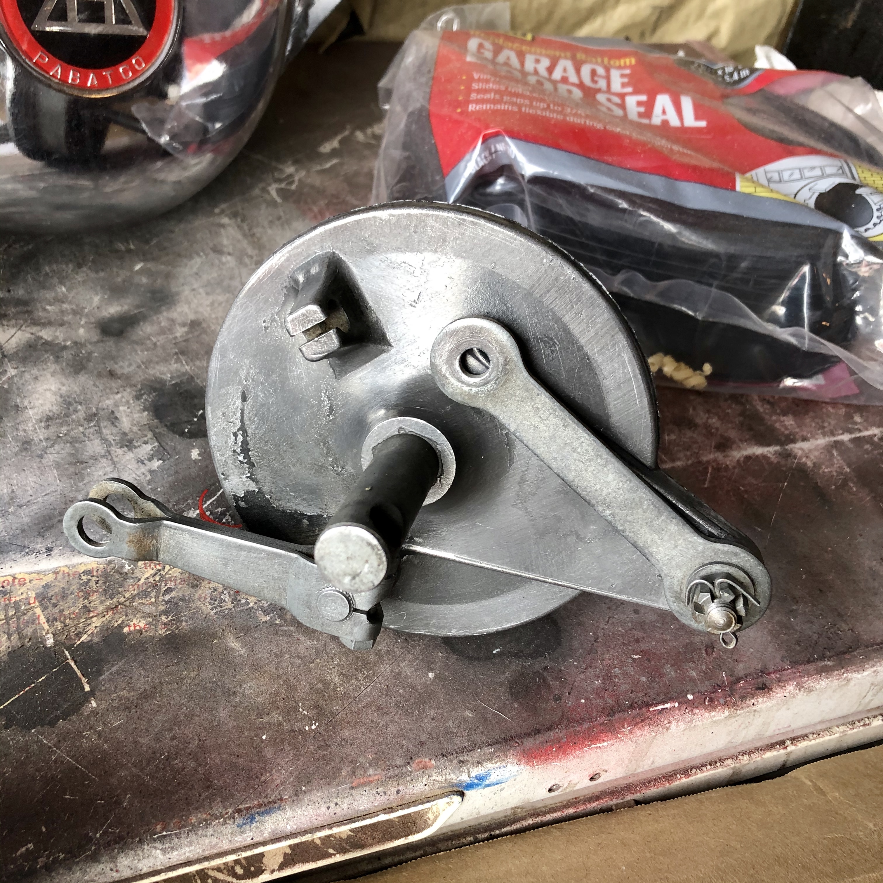

Got the frame completely dis-assembled, except the tree. Power wire brushed the brake pedal assembly & spring, and painted it silver this afternoon.

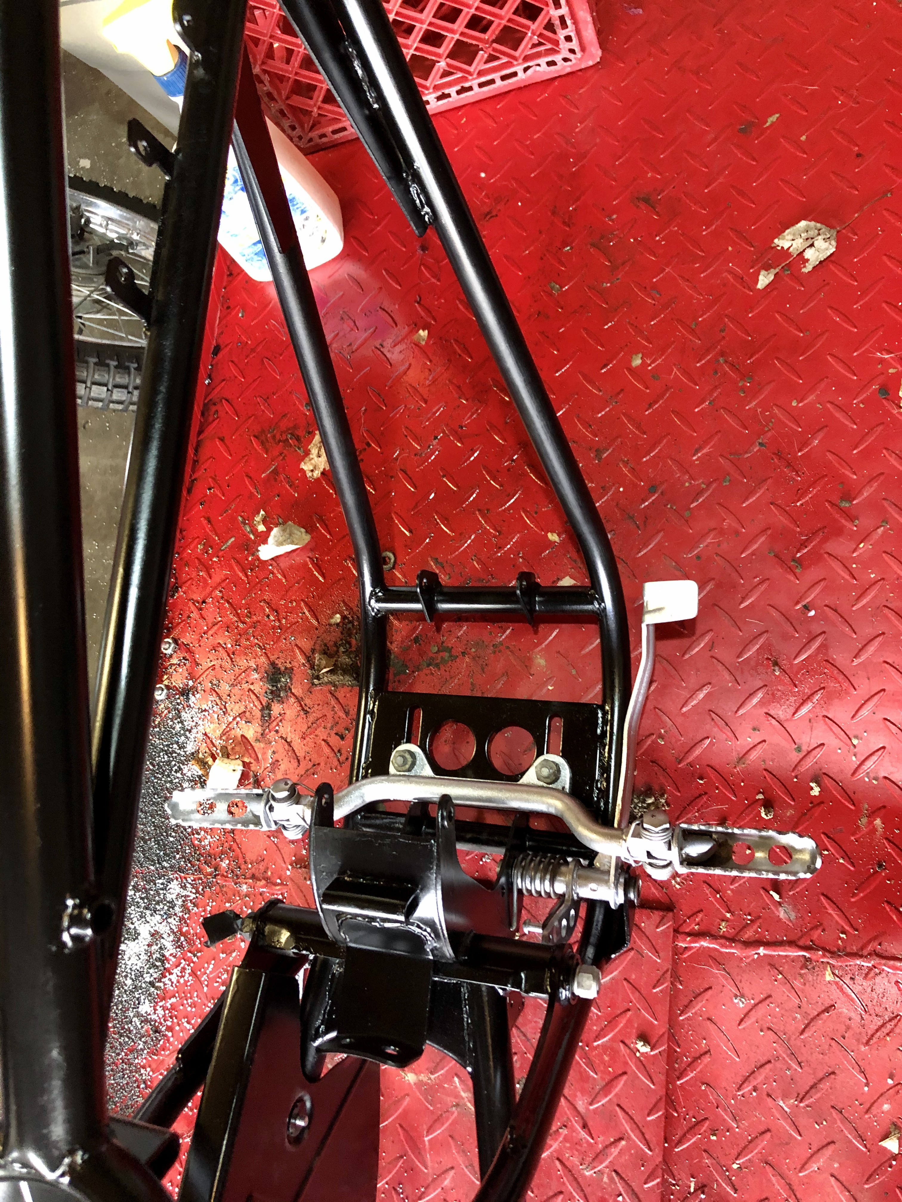

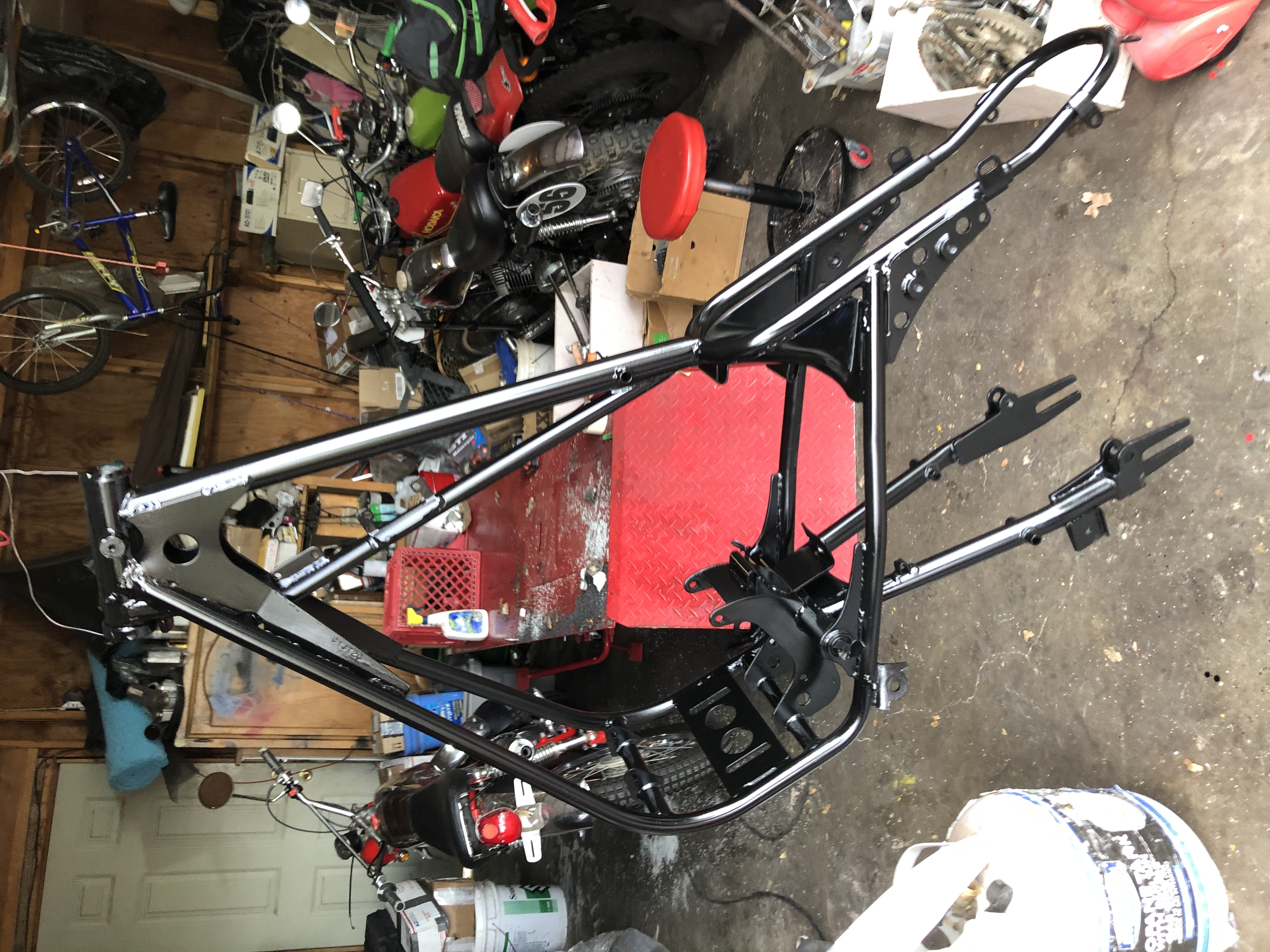

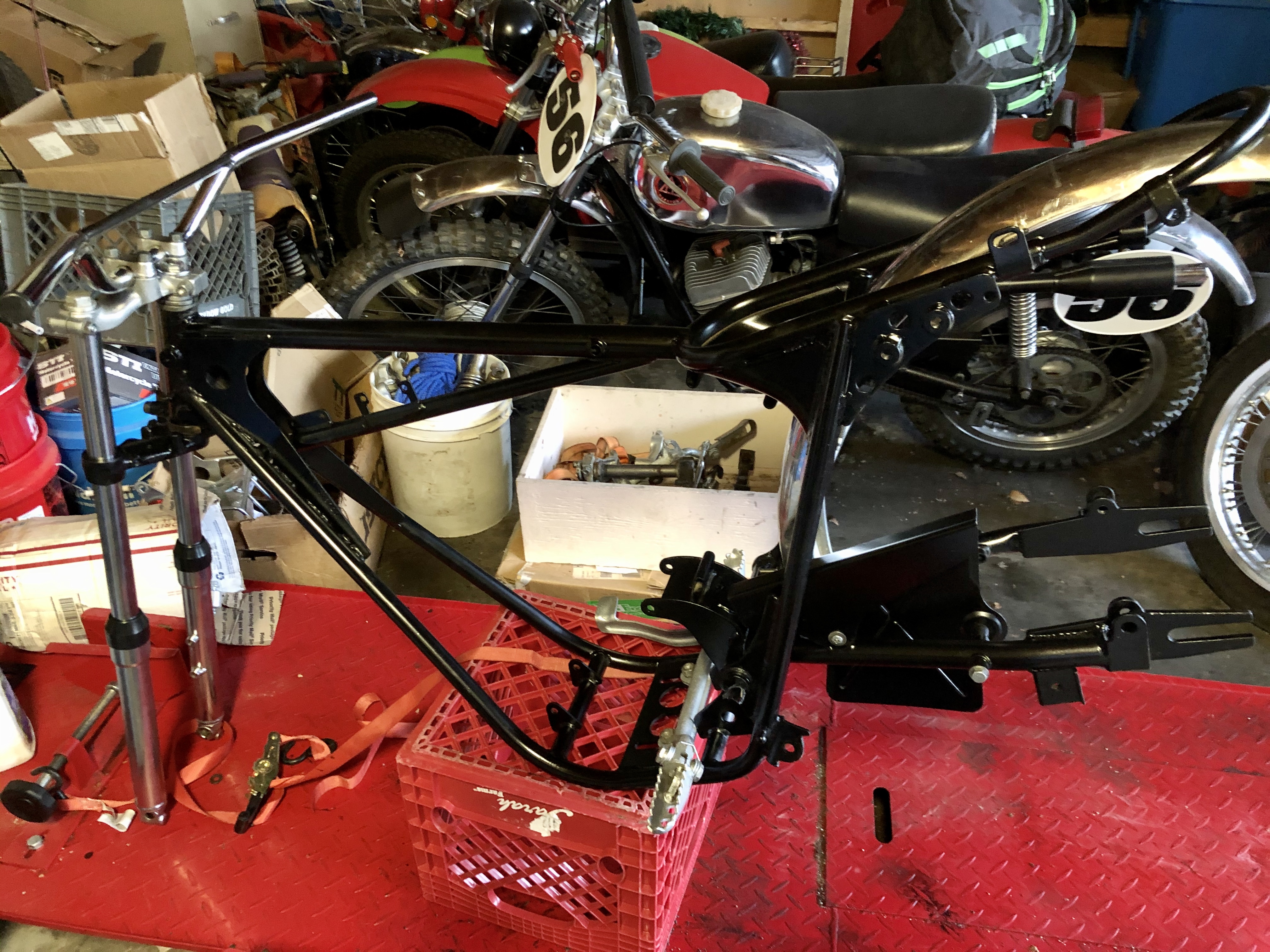

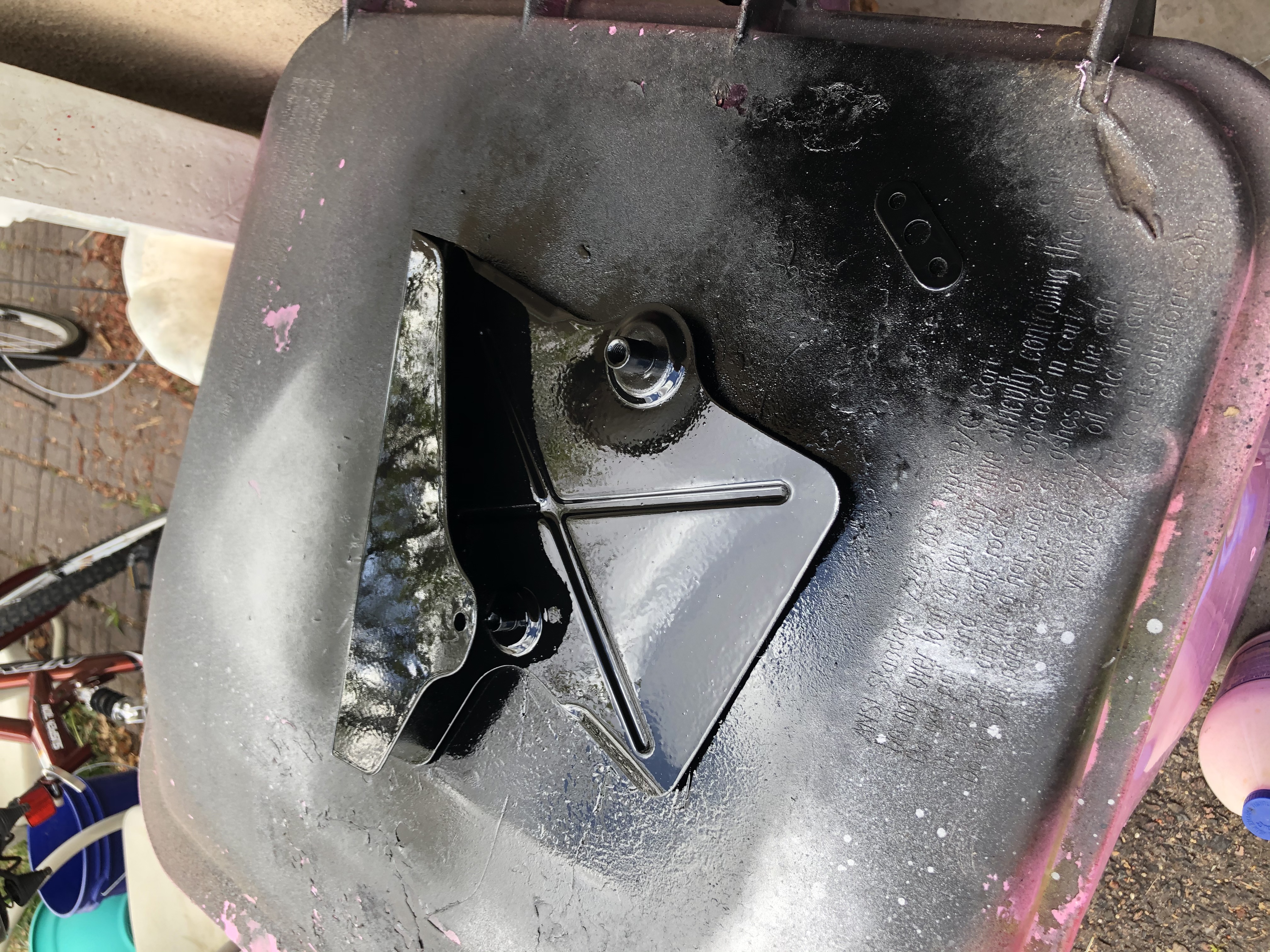

Frame got sanded & painted today! Also painted the brake pedal assembly and the foot peg assembly and mounted. Rear fender is on and so is the chain guard!
I got the steering head painted and the grease & lower bearings are on the tree. Ran out of daylight so I’ll mount the steering head tomorrow! Victor

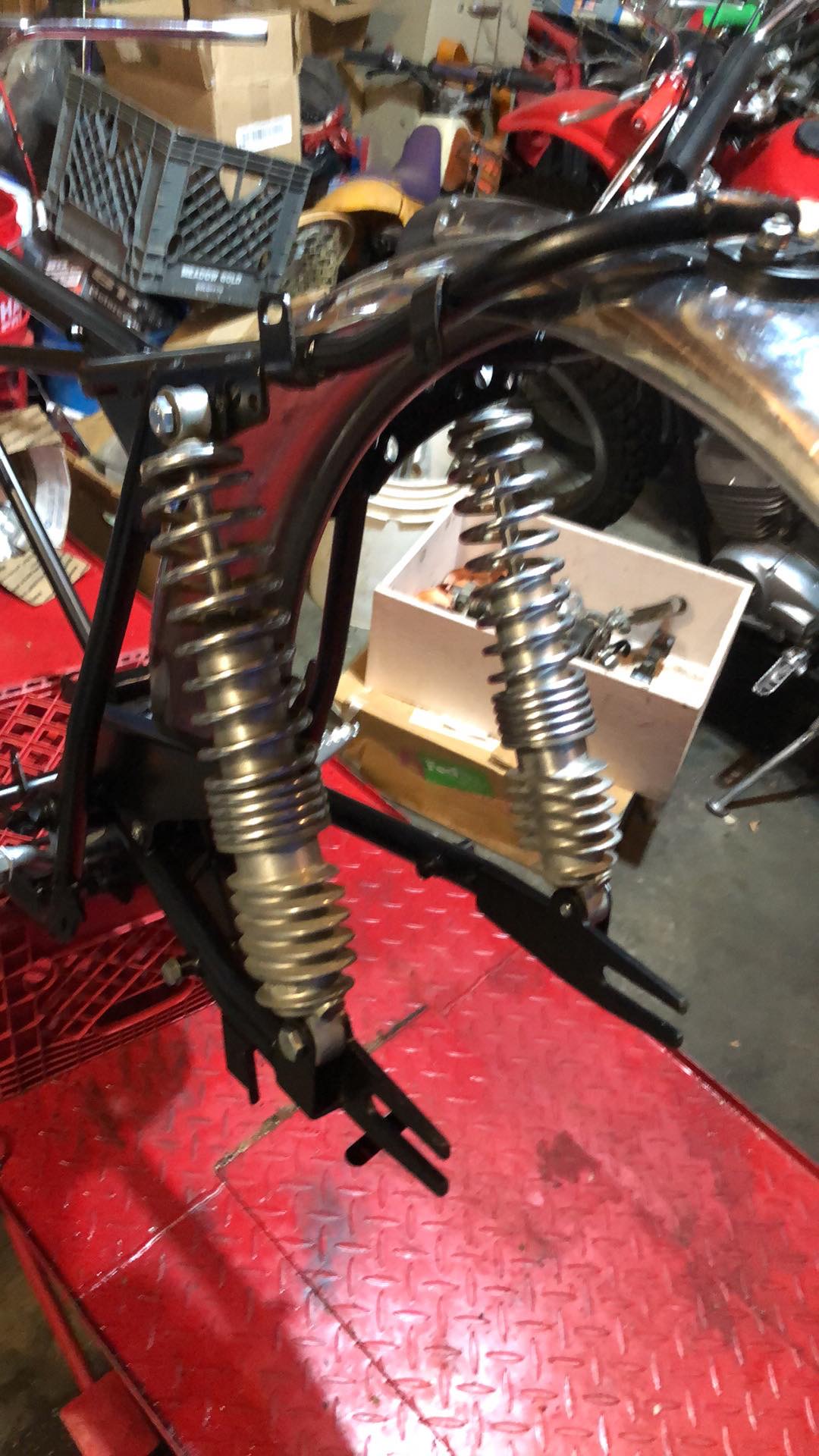

These are the Super Combat shocks I cleaned up for use on the Wombat Combat! I think they look great on this frame! Victor

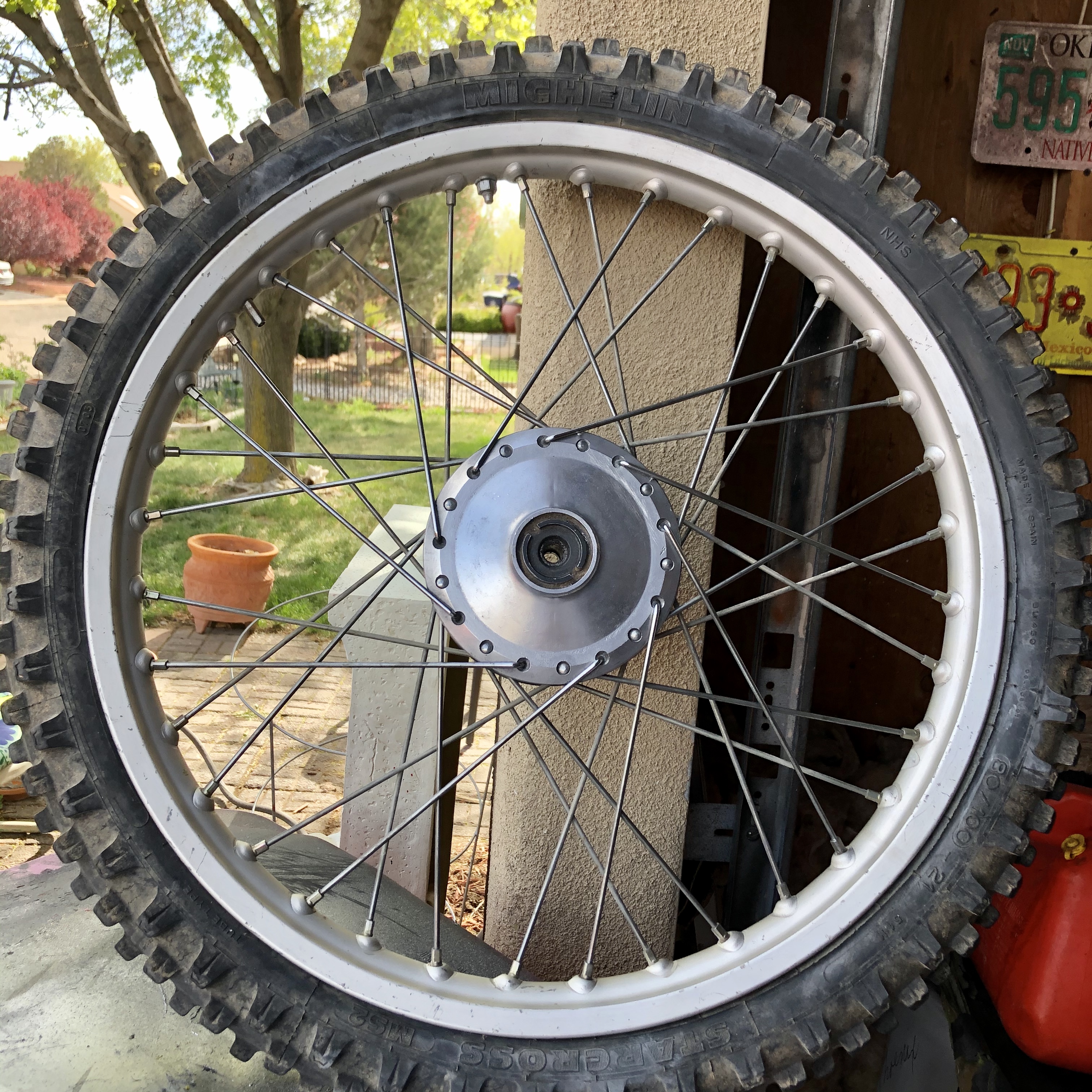

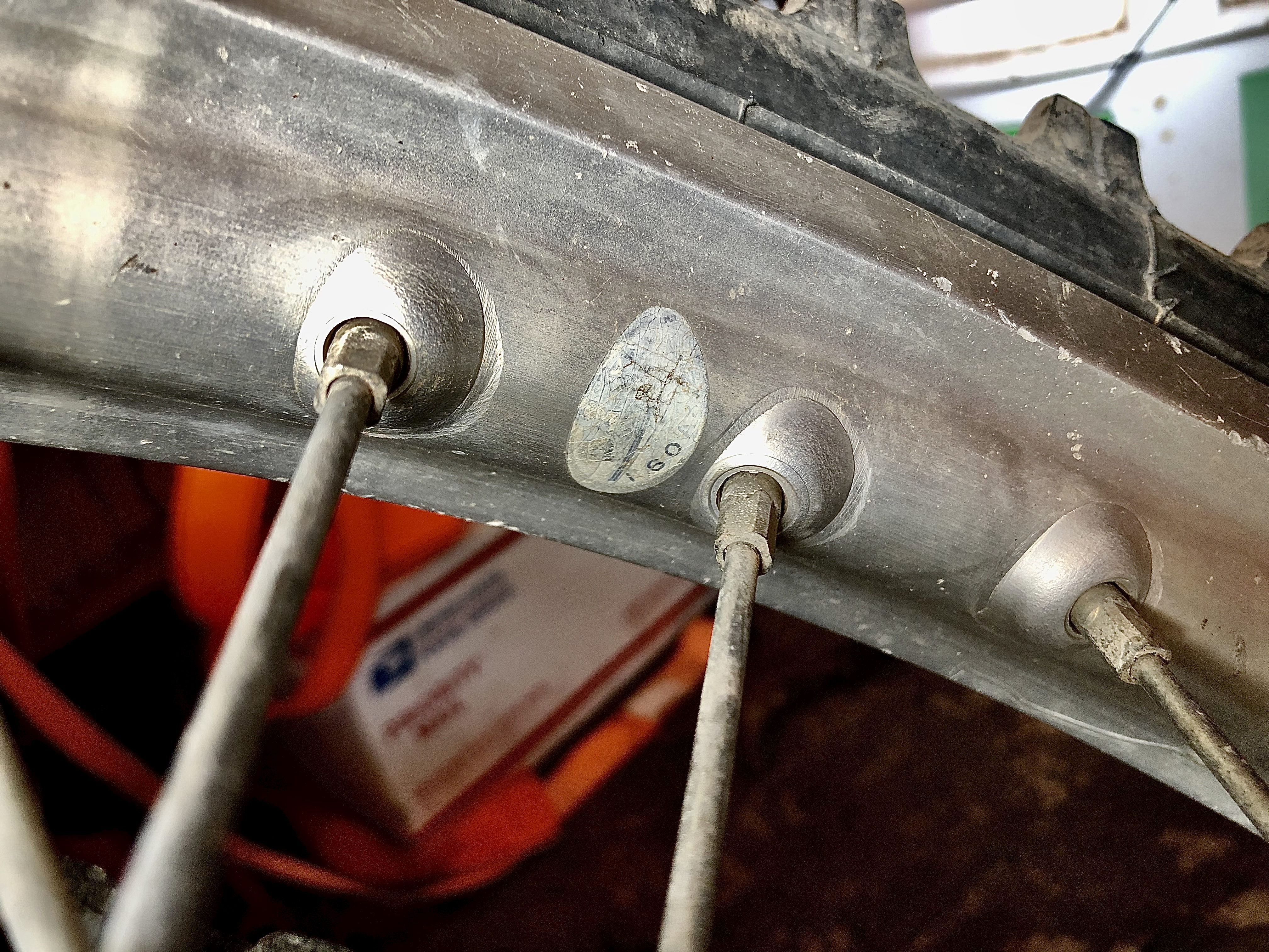

Does anyone recognize this sticker? I know it’s hard to read. It’s on a 21” front rim with a black painted hub. It appears to be a shoulderless alloy rim. Any info in it? Victor
Re: Starting the Wombat Combat!
Wow Victor, my eyes are playing tricks on me. That looks like a mud catcher off a CW.
No, Matt. It’s shoulderless! According to Dale it actually a Super Rat Front rim. 21” with a black hub. I’m just not sure what brand/make because I can’t read enough of the sticker. Too faded.
Cleaned it all up and removed the outer black paint with carb cleaner and a brass wire brush, started mounting the new tube & tire after these pics! Victor

You can see the entire rim in this pic. No shoulders. Not a CW rim!

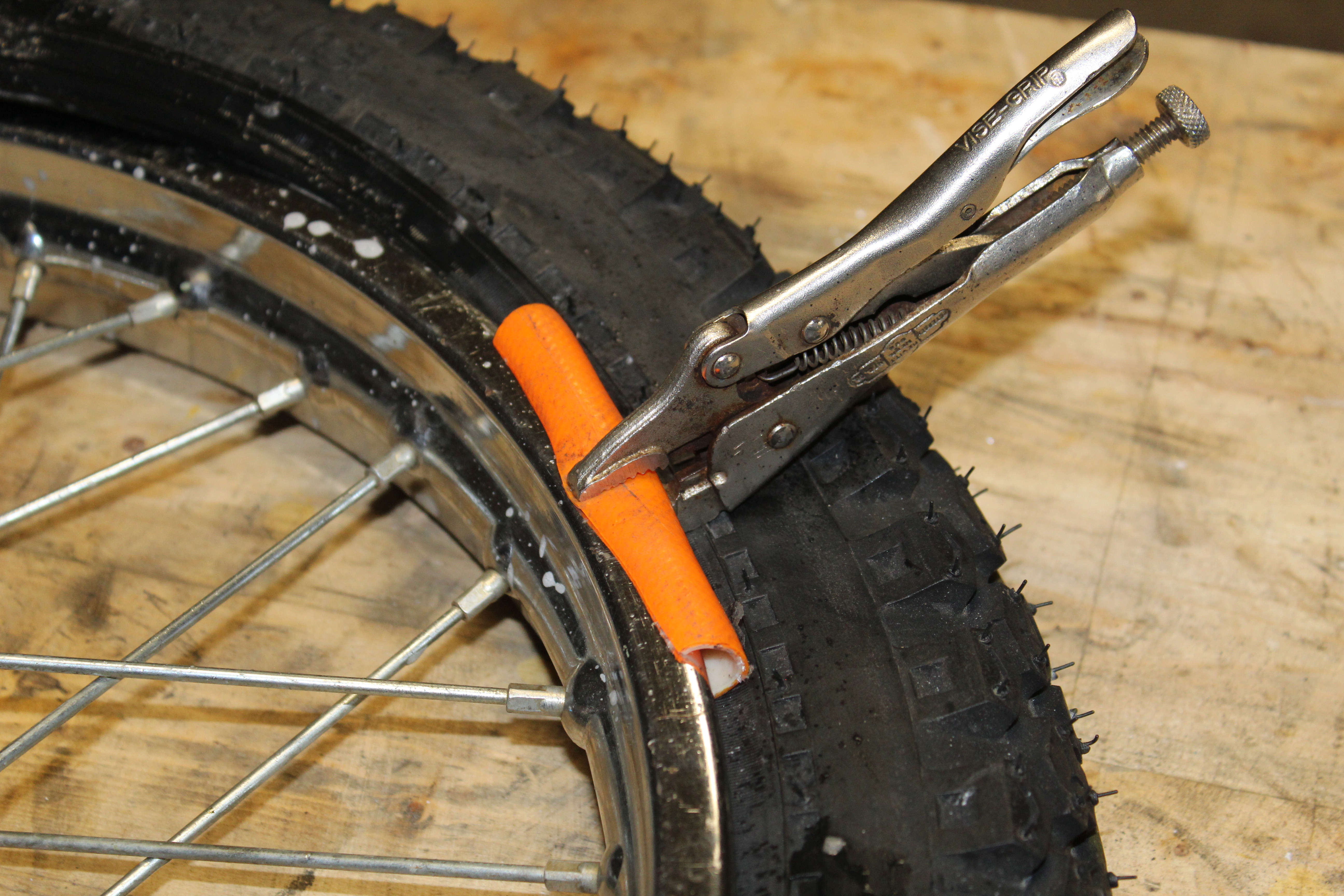

The old tire has now been removed and the new tire is part way on.

Aah! Thanks Victor! I think it was confused thinking I was seeing mud catcher shadows or whatnot. The new picture clears my misidentification up perfectly. Great looking wheel too! No dings on at least the port side. Nice!!
Yes. And I misread Dale’s post. With the black hub,it’s a Model 98 Super Rat front wheel. But I cleaned the black paint off with some carb cleaner and a brass wire brush on my drill!

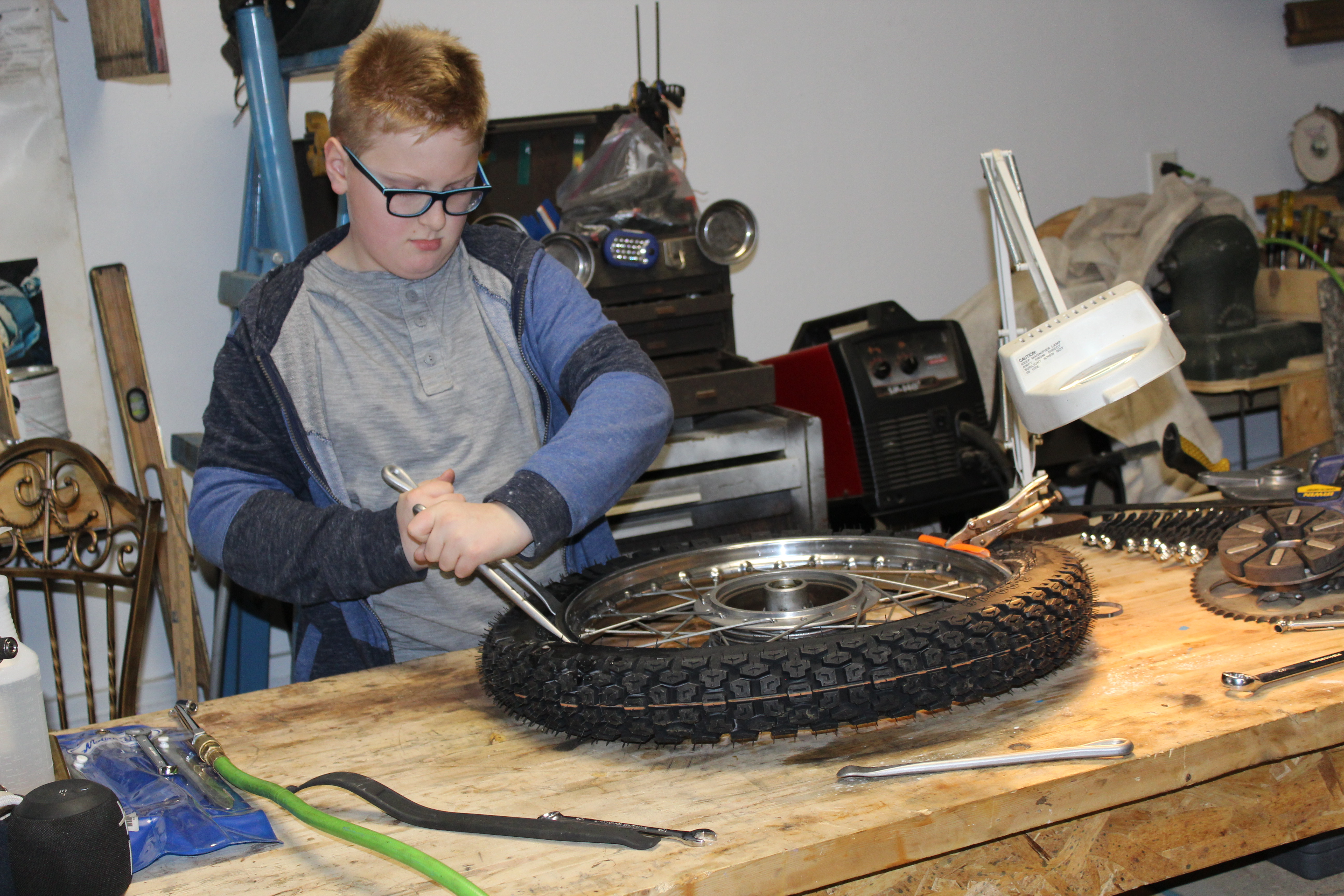

Son in law came over this evening and helped me finish mounting the tire. Those tires sure do have a tight bead!!! I can do everything except bend over these days! Victor

Get a Baja "No-Pinch" tire tool and a couple Bead Buddies. Makes tire changing a snap. I can do a complete tire change by myself in 30 minutes or less depending on how warm the tires are. Not 6-Days speed, but quick enough with a lot less busted knuckle action. I think Kelly has published a video on the technique.

Hey Victor, I think you'll really appreciate the way the Baja tool takes away a bit of the PITA of tire changing. They are available as a kit with multiple spindles so you are good to go if you also wrench on your street bikes. As I recall, the green spindle is the one for Hodies.

what really helped me out was a bead buddy . i kinda did a makeshift one with a piece of air hose and vise grips dont tighten the vise grips till your blue in the face just snug and with that holding the bead down you can use both hands to work the bead down and use lots of soapy soapy water and put a little air in the tube any way thats how we did it and 10 year old grandson did it with minim help from me, lots of guidance thou ......albert

I like Albert’s home made Bead Buddy! Will probably copy that and I’m also going to make sure the tire spends more time in the sun before trying to mount from now on! Victor

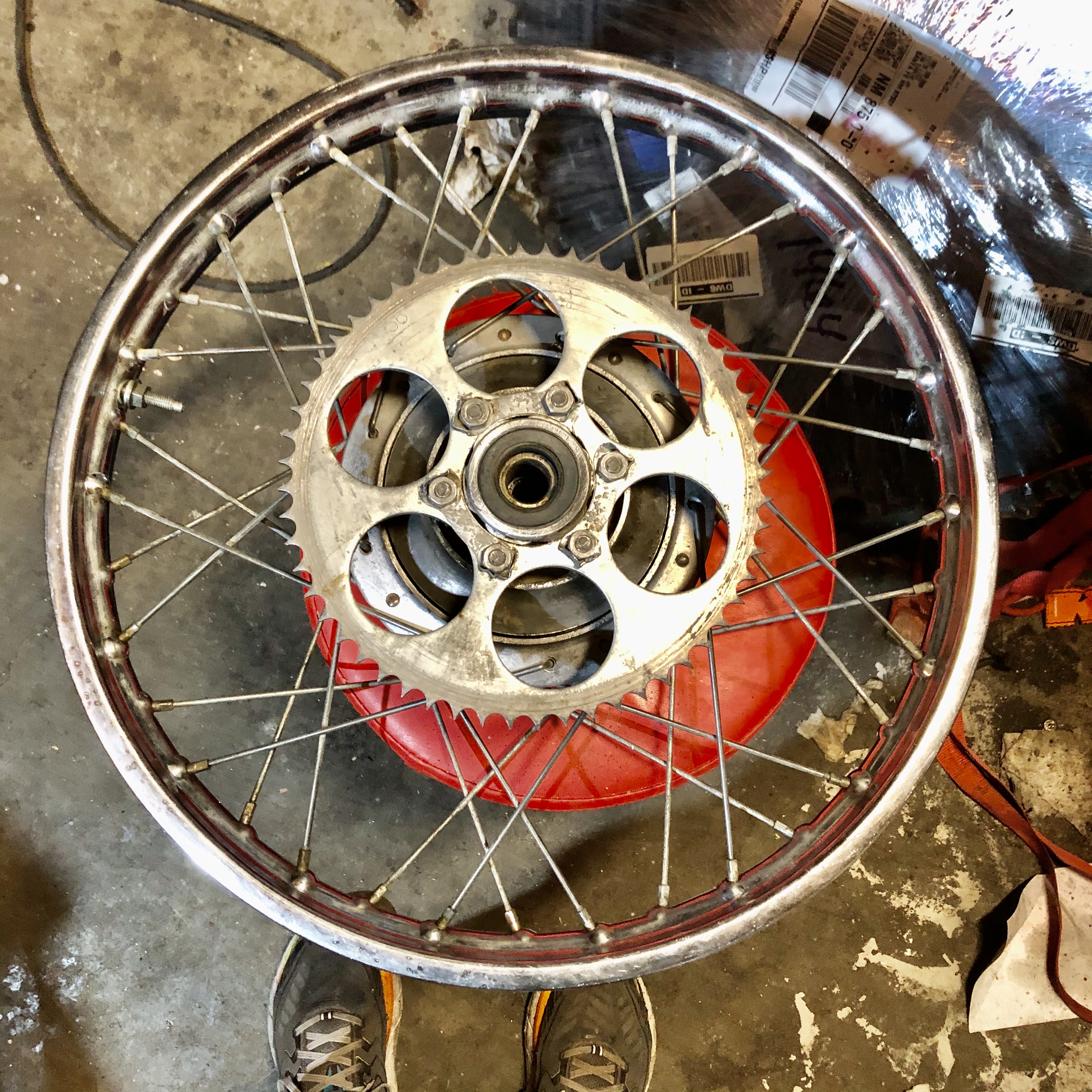

Well I did a lot of dirty (literally) work today. Wire brushed the rear axle assembly parts (still have 1 chain tensioner to go!), removed rear sprocket from the hub, hoping one of the 4-5 others I had would fit. Nope. Cleaned sprocket & hub and re-assembled. Packed grease into the bearings as well.
Removed a spoke needed from another rim which I found loose on that rim this morning. Had to remove 3 spokes to install the one inner spoke, but took my time and then tightened all the spokes from the inside of the rim with a large screw driver. More tightening will come when my spanner wrench arrives.
Cleaned chrome on the steel rim & polished with 3M polishing compound and the conical Mother’s sponge buffer on my drill.
Started about 3:00 and quit when wife came home with burgers & fries, at around 7:30 pm.

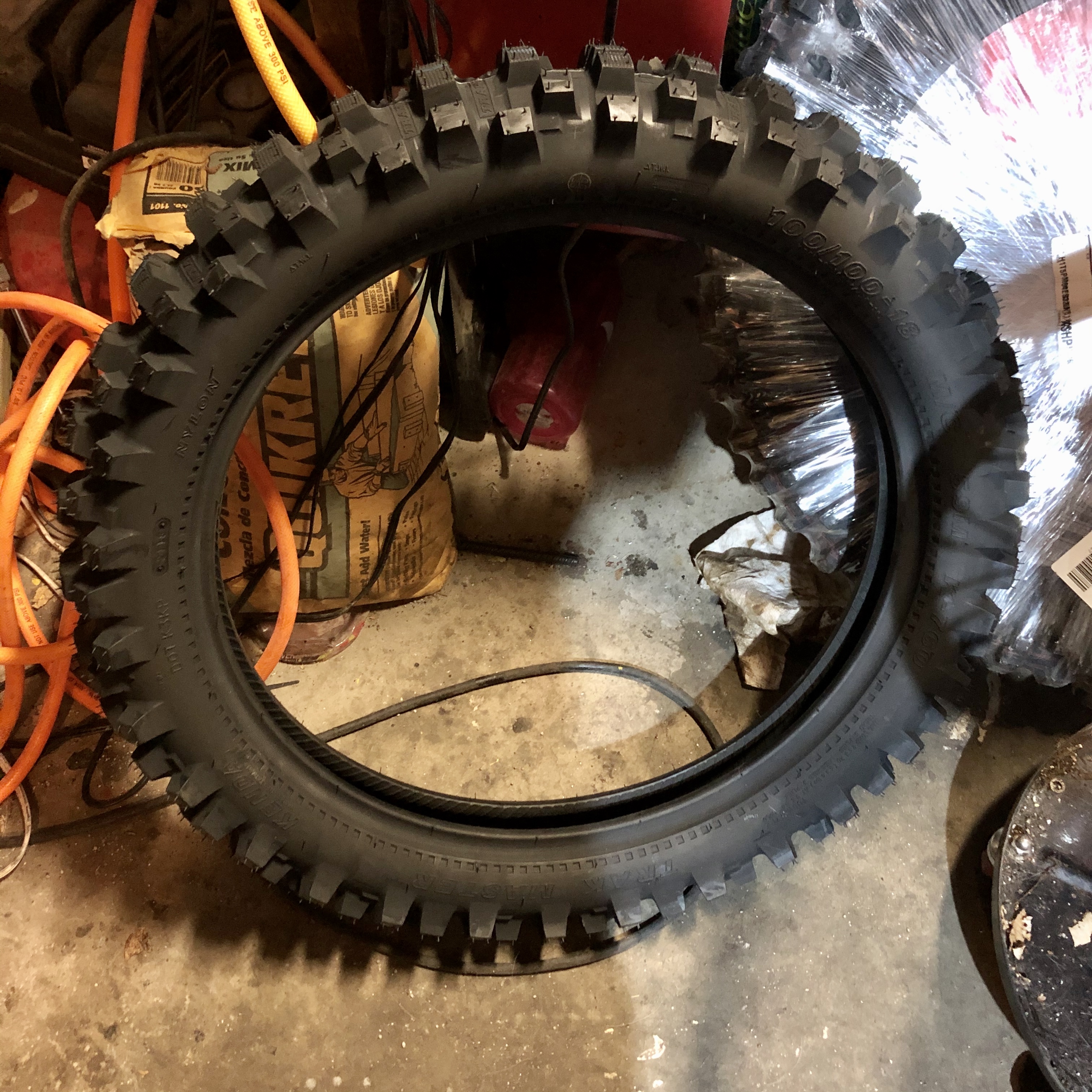

Here’s the cleaned up rim, and also the Kenda rear tire going on it tomorrow. May order a new rear sprocket with a new chain. So now I’m ready to mount the 18” rear knobby tire! Got a really good deal on Kenda MX tires on BikeBandit! I think the whole set was $95 shipped including tubes and rim liners! Victor
