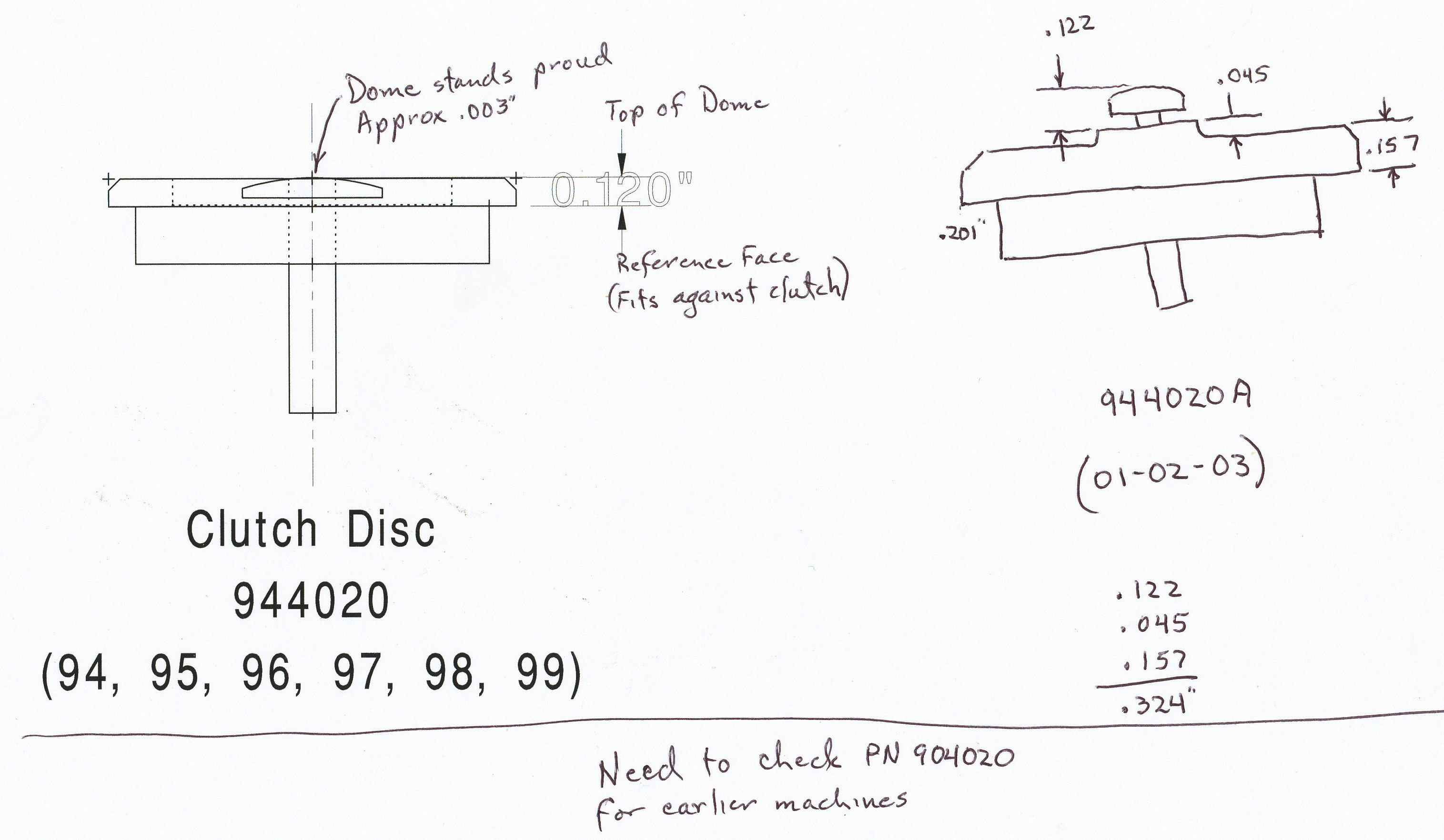

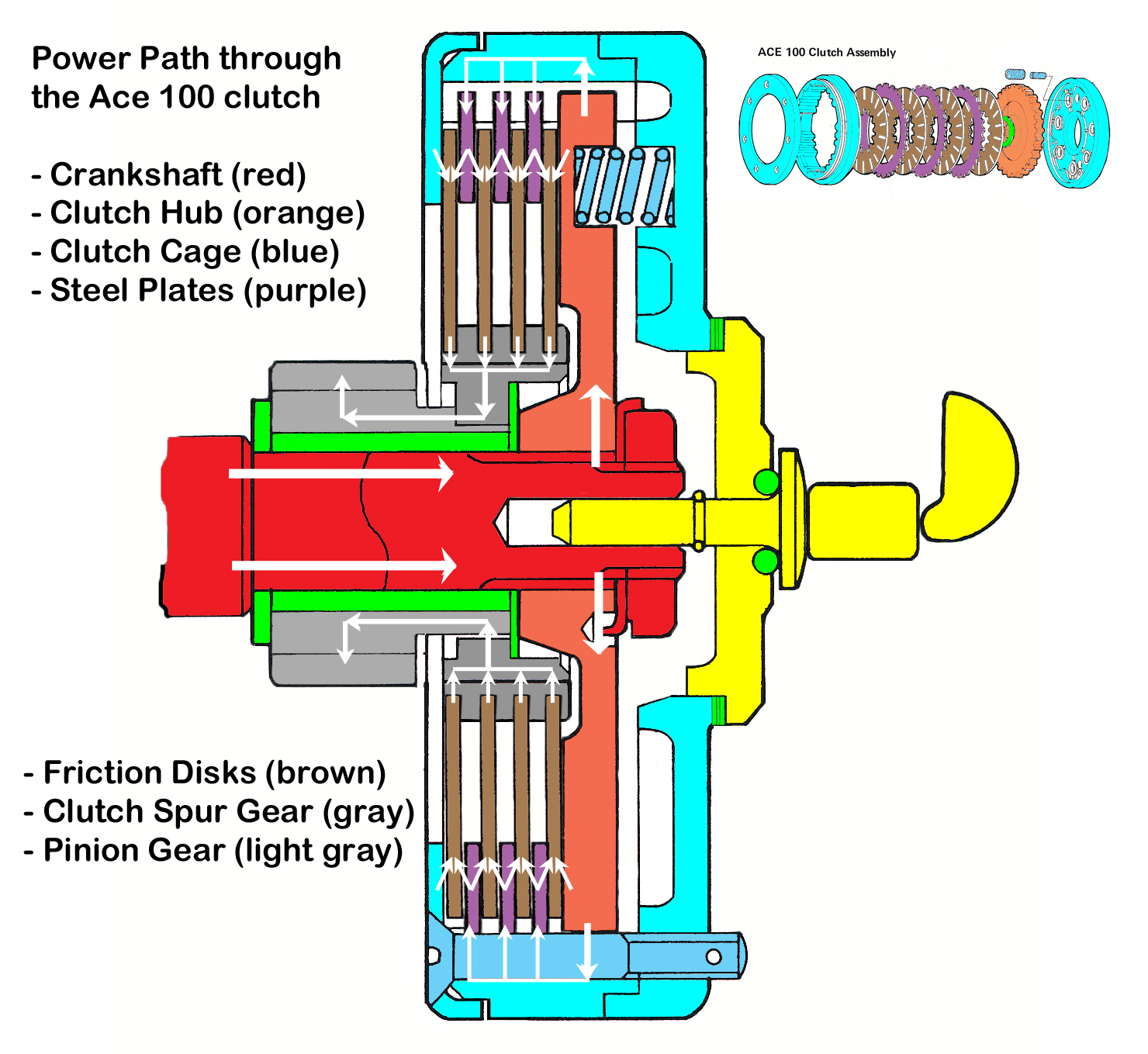

I recognize that it is totally counter-intuitive . . . but the outside face of the clutch moves "out" (from the center-line of the engine) as the friction disks wear. So . . . if you have a situation where no clutch disc (throw-out bearing) shims are needed to achieve some free play at the engine clutch lever, you have something going on which has "moved" the contact point of the clutch disc (throw-out bearing) "out" - or possibly the pressure piece is too long. You may not have used the proper number of steel plates? If so, put the missing one at the "inside" of the pack shown in the drawing - NOT against the iron hub. The photo/drawing is of the ACE 100 clutch. While details vary for the various 125cc era clutches - the basic operation of the clutch is exactly the same. The second drawing illustrates dimensions of clutch discs (throw-out bearings) which may be important in diagnosing this situation.
