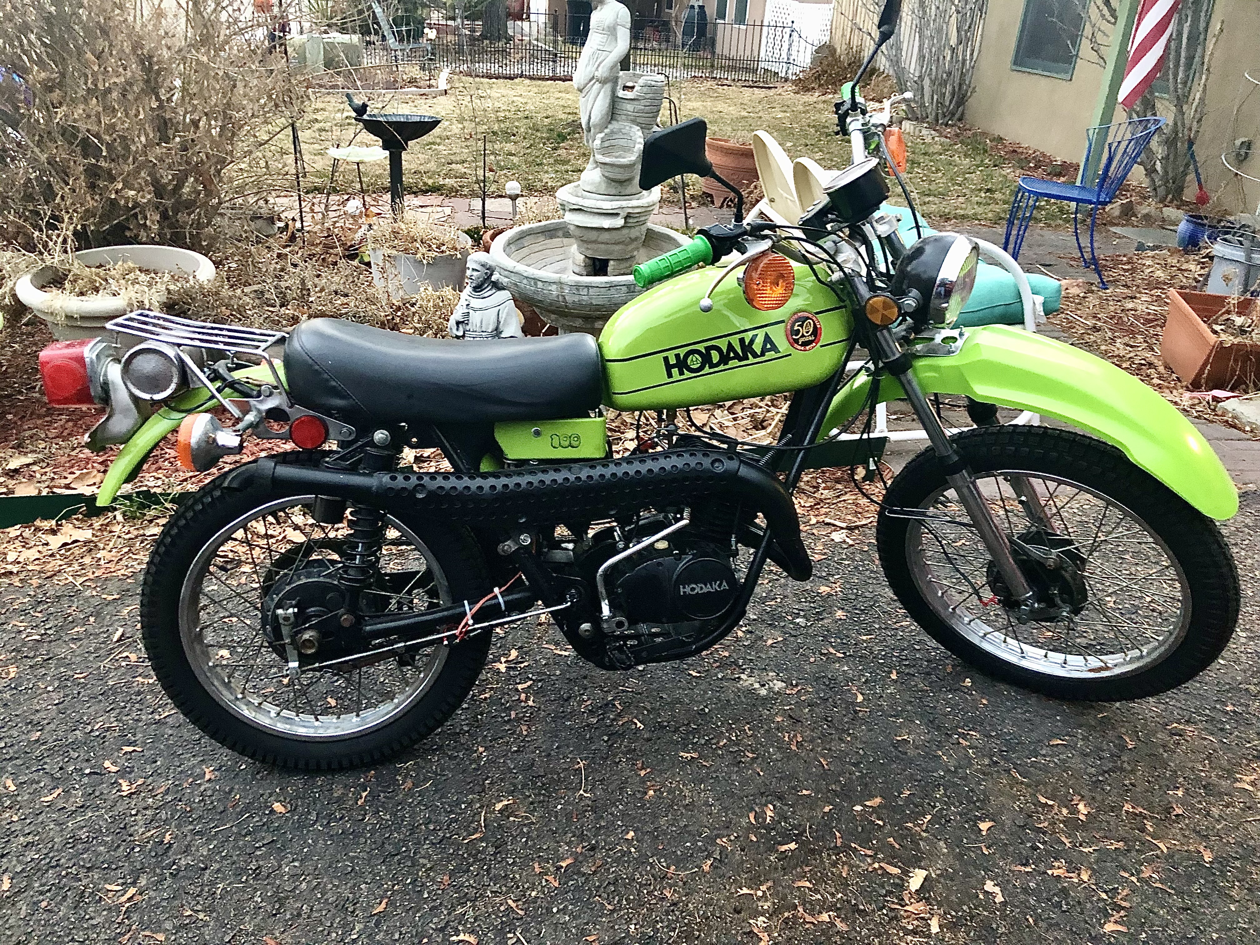

I have restored 2 Toad Toads. Both were set up with a points gap at .013 based on the .012-.014 listing. They both run great.

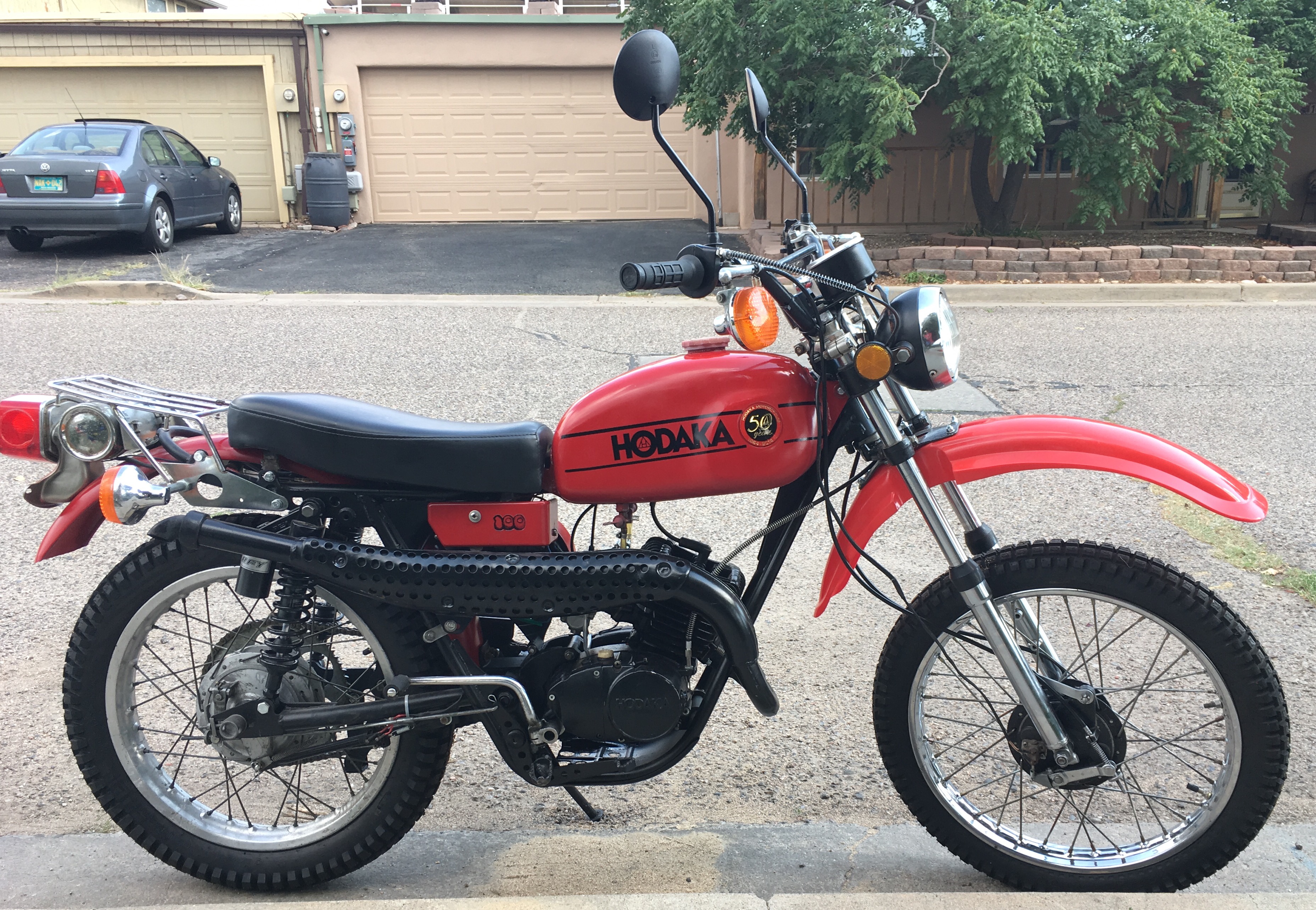

Victor ..... our tanks are different, mine is a 76, maybe a newer style? Also different are the kick starters, mine does not have the loop in it, just a straight arm. For some reason I can't figure out how to post a photo. When I click on the add a photo icon, I just get an [img] showing up. I often think it could use more stroke on the down kick, starting engagement point seems a bit low.

Re: Road Toad contact points setting puzzle .....
Yes. The 1976 is a Model 02 Road Toad, while mine are 1975 Model 99 Toads. 1976 was a tank change year for the Hodakas, leaving the toaster tanks behind and going to a more coffin shaped tank. The 02 Road Toad specs for the carb are what I use for jetting & tuning. This was recommended to me in the past.
