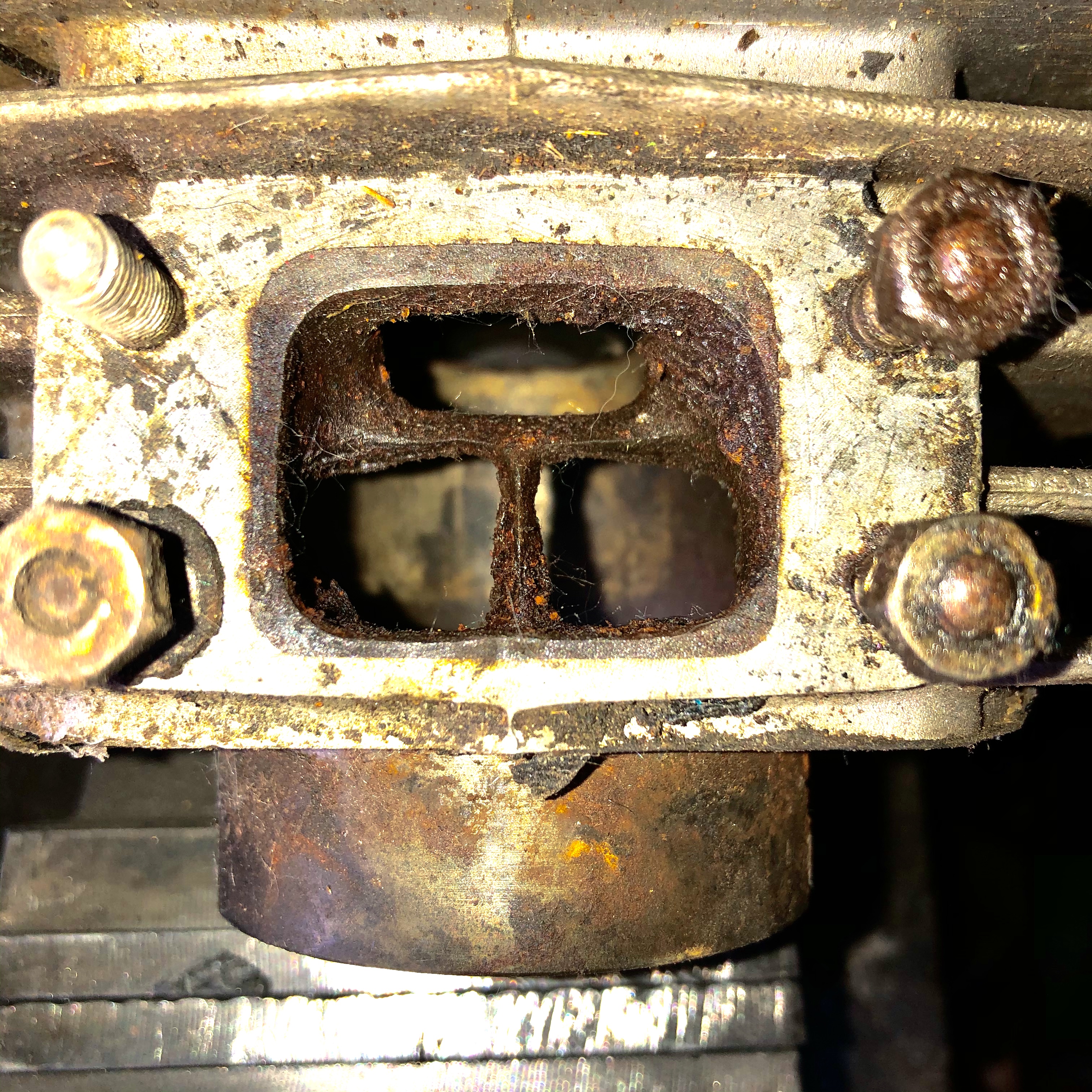

Ed Chestnut confirmed, via photos on this forum, that the cylinder had been ported for reeding. So I have no starting point from which to record changes in performance.
Given this information, the fact that this motor has been ported for reed valve, has a reed valve assembly & a Model 97 piston, where would you likely start? I know it can depend on exactly how the porting is done.
Looking at the intake ports, I’m guessing it was an owner porting job. Here’s the same photo again, which was the photo show when Ed confirmed it was ported for reed valve. And this picture was before having the motor both soda blasted and vapor blasted, which will happen soon.

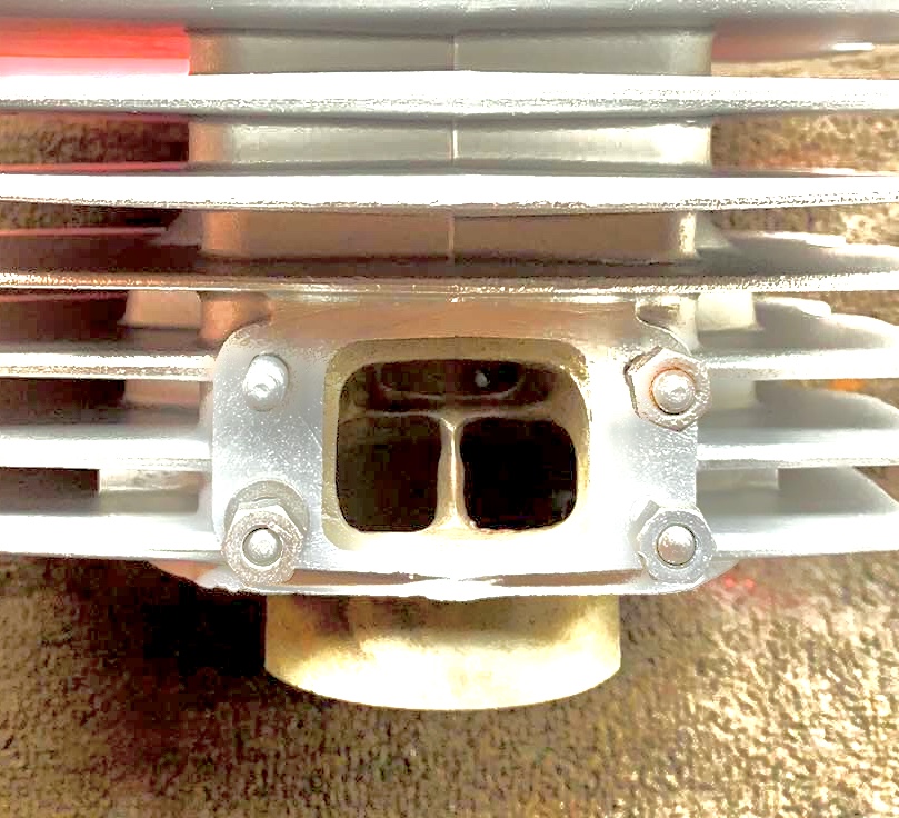

Well, the motor parts are back in the mail. Here’s a photo from Alan, showing the intake ports after vapor blast “clean up!” I had to adjust the photo to make the top port visible, so excuse the brightness. As soon as the box arrives, I will give the measurement Ed requested. Victor
