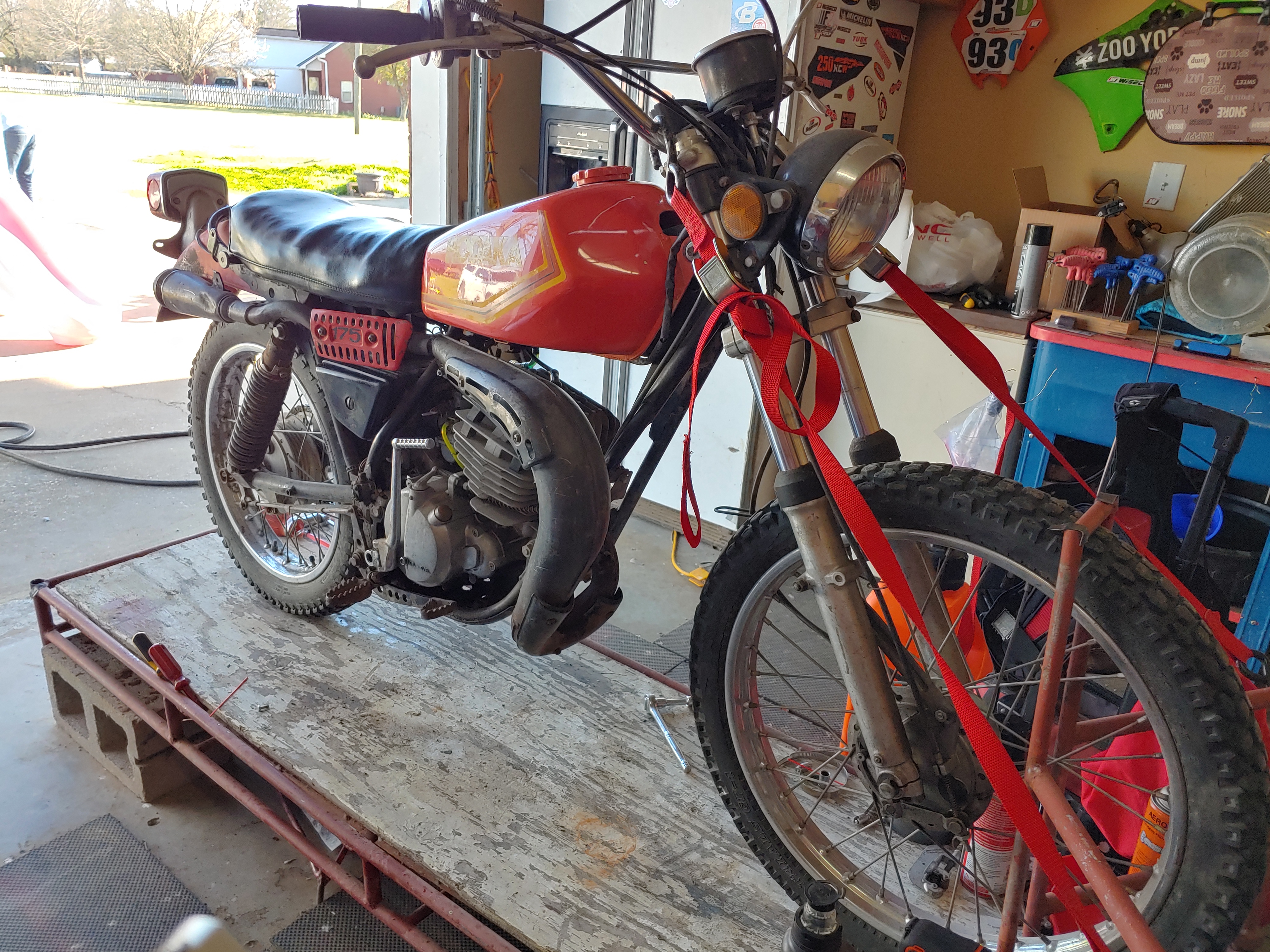

Picture of project 175 VMX bike I'm starting with.
Here's the bike I'm starting with.
