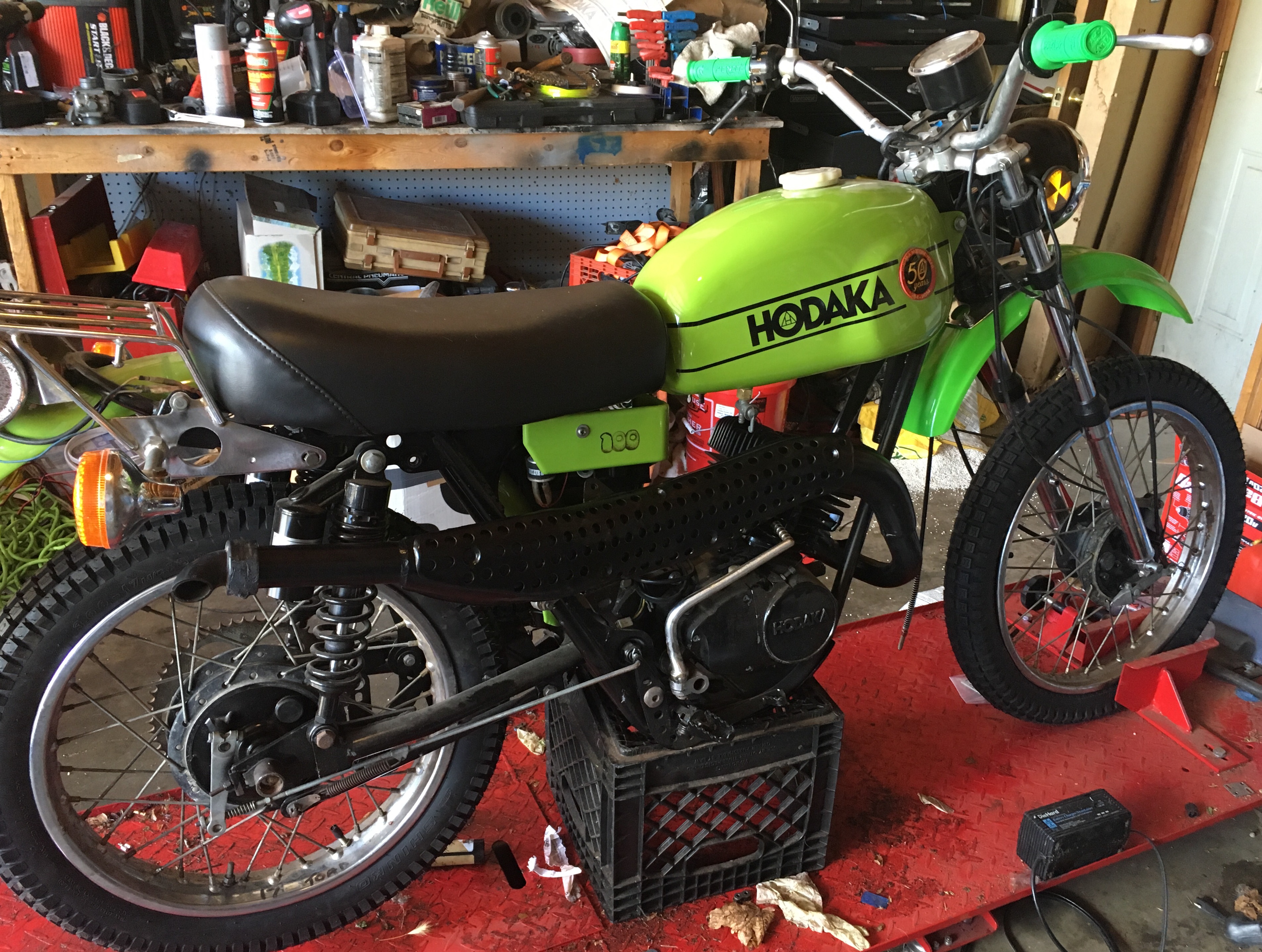

Hey everyone!
I'm new to the Hodaka world, but not to enduro bikes. I've been riding for 6 years, and my first bike was a '72 Honda SL350. The Toad is a featherweight compared to that bike. My new-to-me Toad would be tough to put back to stock, so I'm going to make it more trail-ready. Possibly some vintage motocross in my future. Looking forward to the journey!

Welcome, that bike doesn't look that far from stock, might be easier than you think.

thrownchain wrote:Welcome, that bike doesn't look that far from stock, might be easier than you think.
I think this angle is a bit deceiving. The air box, oil injection and rear turn signals are missing. The tail light is smashed. I think the exhaust is off of an Ace.

Hey, starting out with a runner puts your Toad way ahead of most project bikes. Just a few odds and ends here. Rear indicators and tail light lens can be fairly easily acquired and for not an insane amount of money. Many people removed the oil pump in favor of the guaranteed oil delivery running premix provides and you might wish to do the same. You will likely want a stock air cleaning system - if for no other reason than its insanely cool and really iconic. You can run a pod for now but stay out of the water and mud. Now would be a good time to get acquainted with Terry and Bruce of Hodaka Parts, Inc and Hodaka Parts Idaho, respectively. They are our main parts houses and really great folks who do this for the love of the brand. I know that Terry is in the process of launching a used parts division so you might be surprised at how easily and reasonably you can bring that baby back to stock trim. Check them out. Finally, I agree - you are leaving lots of power on the table with that exhaust system (which I'm not sure if it is even a Hodaka pipe- me thinks not). Anyway, its presence illustrates an important point. There is a wide range of parts interchangeability with Hodakas so only after you do a full inspection and inventory will you know exactly what you have. That's all part of of the fun of vintage bike ownership and of all the possible marques you could have scored, you picked the best and most well supported of them all. Post lots of pictures and ask lots of questions. Folks here are very helpful.

Your Toad has an Ace 100 or a Dirt Squirt motor. That's likely why the exhaust was swapped out (the original exhaust won't mate up to the Ace cylinder). Without the original motor it's not a candidate for a restoration, but it well make a good little trail bike. You could probably strip all the lighting and other bits off to save some weight.

Good eye, didn't notice the motor was the wrong one. But yes, would make a nice little trail bike, or could be roadable with a little work. Not super fast, it's only 100 cc.

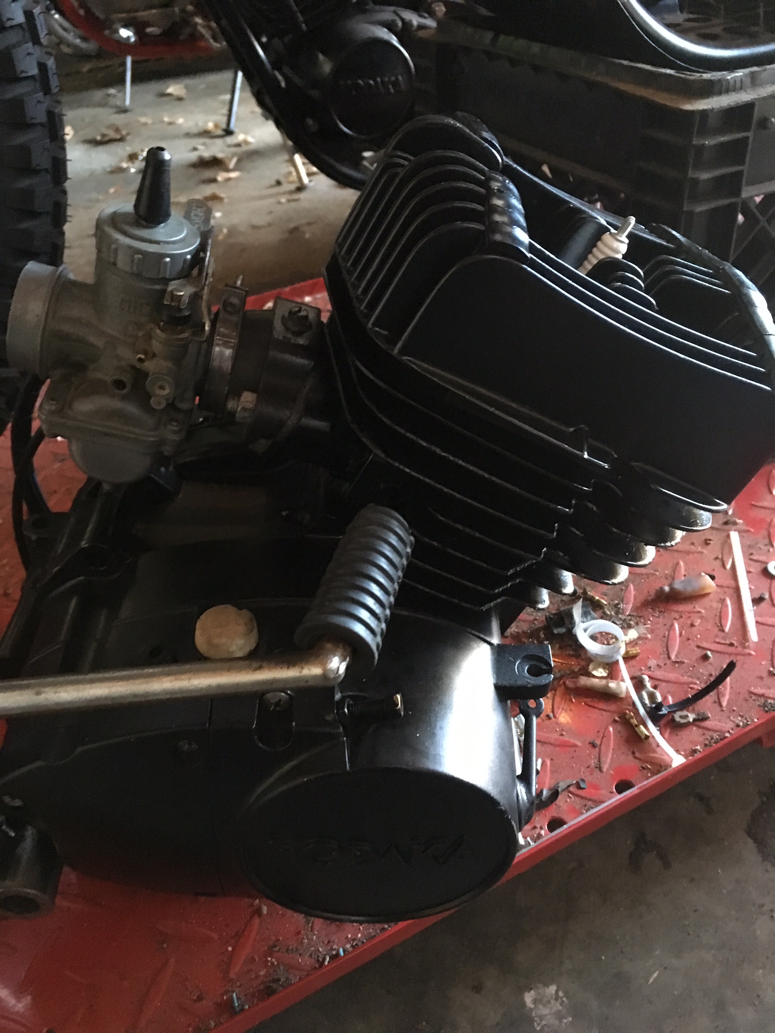

Hi! I’m finishing up a Model 99 Road Toad like yours right now! They are correct in telling you it’s not the correct motor or pipe. The 1976 Model 99 Road Toad has an all black, motor/tranny with reed valve intake. It also has the black exhaust shown in the picture below. This one has the wrong fender up front.And I included a pic of the motor as well.
Bruce Young already said he has turn signals & a tail light lens. I would ask him if he has a rebuildable Model 99 motor and exhaust. And maybe a carb for it?
I know Terry at Hodaka-Parts.com has the air box you need as well. You could also find a Wombat air box & repaint it Toad green!
Lots of ideas and friendly folks here to help out! If you want to go back to an oil tank, I have an extra oil tank and maybe an oil pump I can send you! Options, anyway. Welcome to the Hodaka world! :ugeek: Victor
